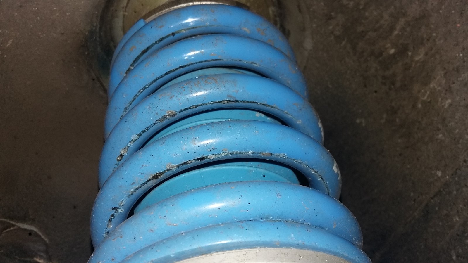

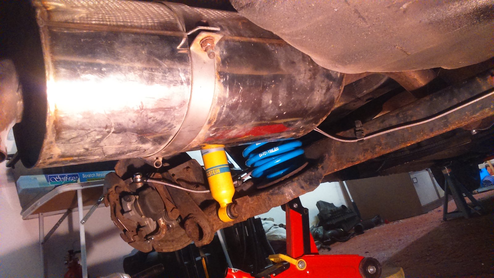

Saying that, the dampers are alright, I was just bottoming out the springs
I need to get a longer, harder spring for the front, and something different for the rear
Aren't they already 400Lb? i have the same on my rally car and find them slightly on the hard side but not overly stiff, i was thinking of dropping to 350lb but a much longer spring..
Definitely longer at least, but it's still odd how they have softened up so much. Since being fitted I have wound them up 75mm and it still goes lower. Only got 25mm of adjustment thread left.
Yeah mine are wound up pretty high now too, i think they lower the car around 30-40mm on full height, because race car and all that. Might be worth investing in some decent springs like Eibach ones in the hope they wont settle as much, which should help avoid the coil bound issue.

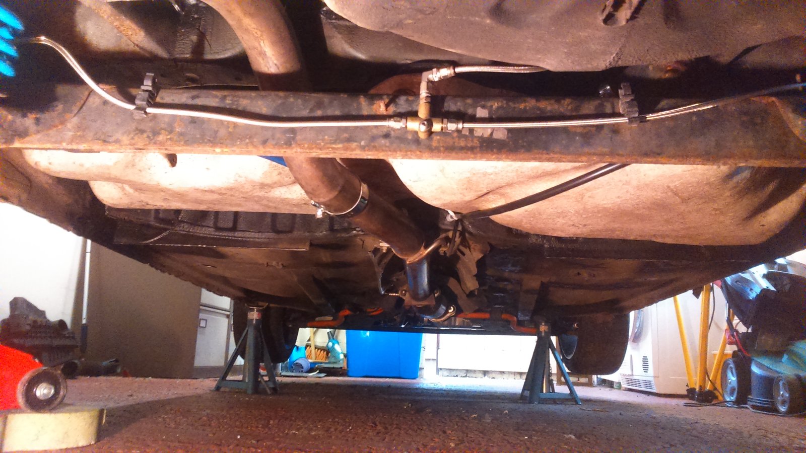

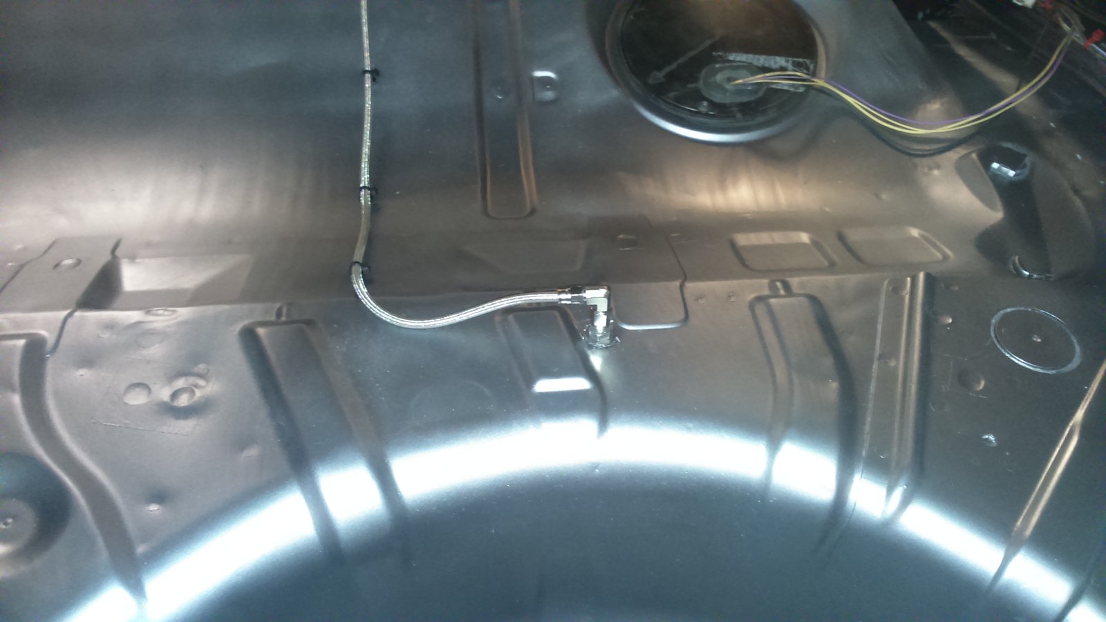

Busy afternoon after wasting a couple of hours trying to get the correct handbrake cables after the 1st set were too short but a trip to eurocarparts in Chester managed to get some.

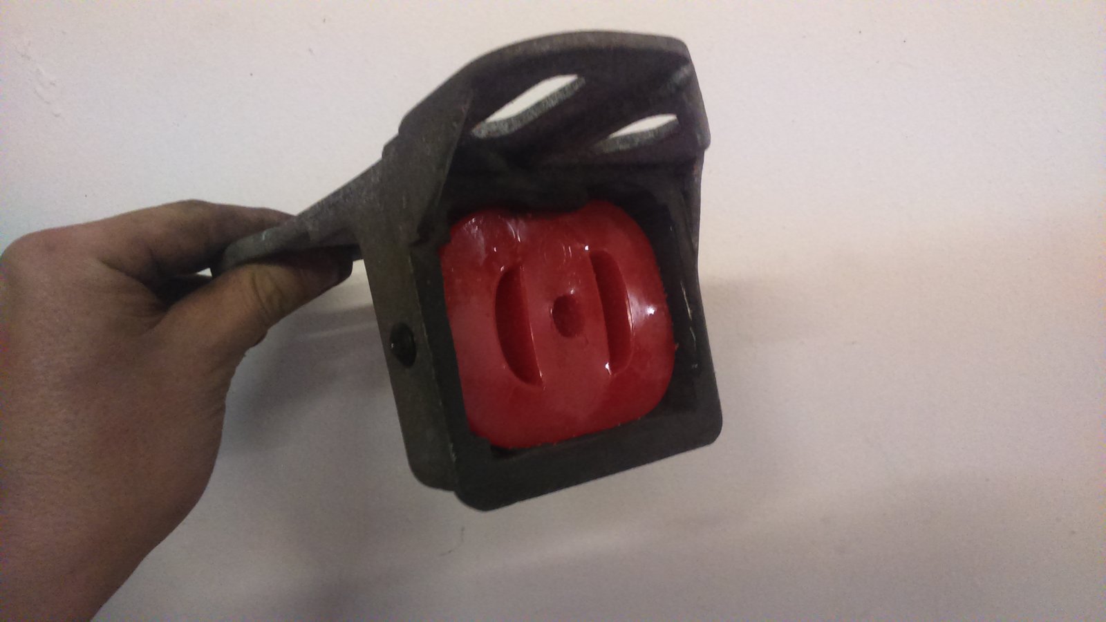

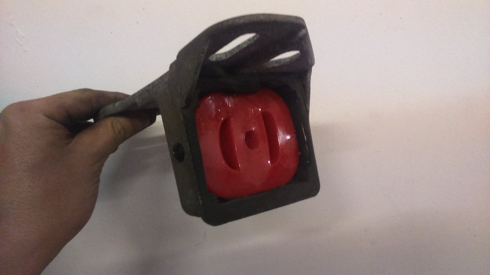

Once back I fitted them, refitted the heat Shields, then fitted the rest of exhaust including fitting a powerflex bush into the rear hanger.
Whilst under the car, I looked at how to fit braided brake lines to the rear beam.
I used an existing hole in the floor for the bulkhead fitting and attached the line from the hydraulic handbrake.
Mounted a T piece in the middle of the beam and attached a hose up to the bulkhead fitting. Then made and fitted 2 hoses to go to each caliper and fitted with banjo bolts.
Just need to bolt on the front calipers and hoses and the braking system is complete.

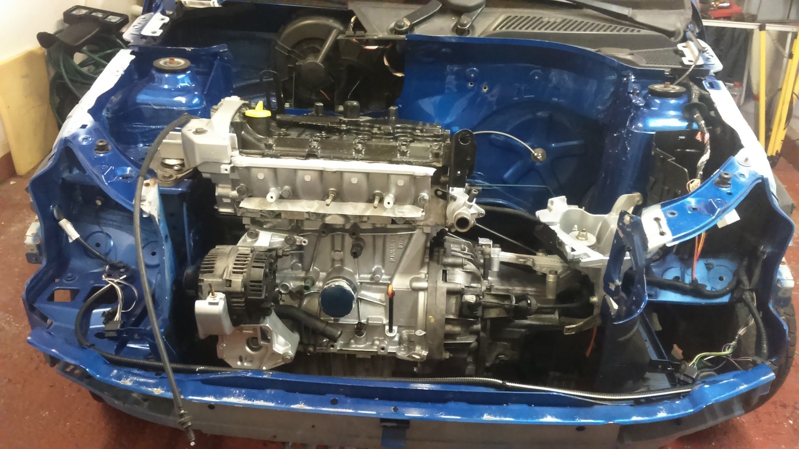

Had a couple of hours in the garage earlier and got a few jobs done.

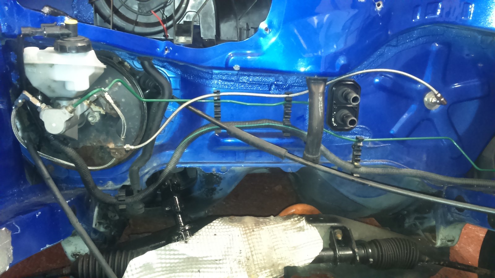

Did the rear brake lines from the master cylinder to the bulkhead fitting and fitted the throttle cable as it's a lot easier to do before fitting the engine
Then I have dropped the engine and gearbox back in as my brother needs the engine crane tomorrow
Getting there slowly!
Paul, i'm looking at the first picture where the rear brake lines go into the bulkhead ; have you made a T-section from where only one line is going through the bulkhead towards the back ?
Standard setup has two lines going all the way to the back ?
Pauleds
  Merc Dueliner sport
The rear lines come out of the m/c, to a T piece. Then a single line to a bulkhead fitting. From that to the bios valve, then hydraulic handbrake, to the rear of the car. Bulkhead fitting to a T piece on the rear beam then out to both rear calipers with banjo fittings.
