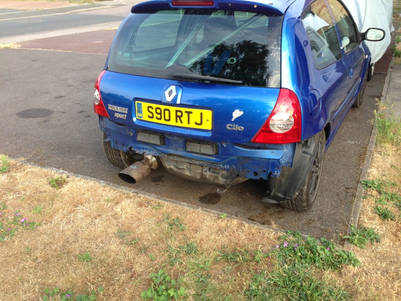

i got punted up the arse by a 17 year old which halted all my plans....see this thread for pics
http://www.cliosport.net/forum/showthread.php?703068-Write-off
I've just got he car back with a straight and very happy. Boot is nice and straight and I've got a brand new bumper ready to go on once I sort my exhaust out.

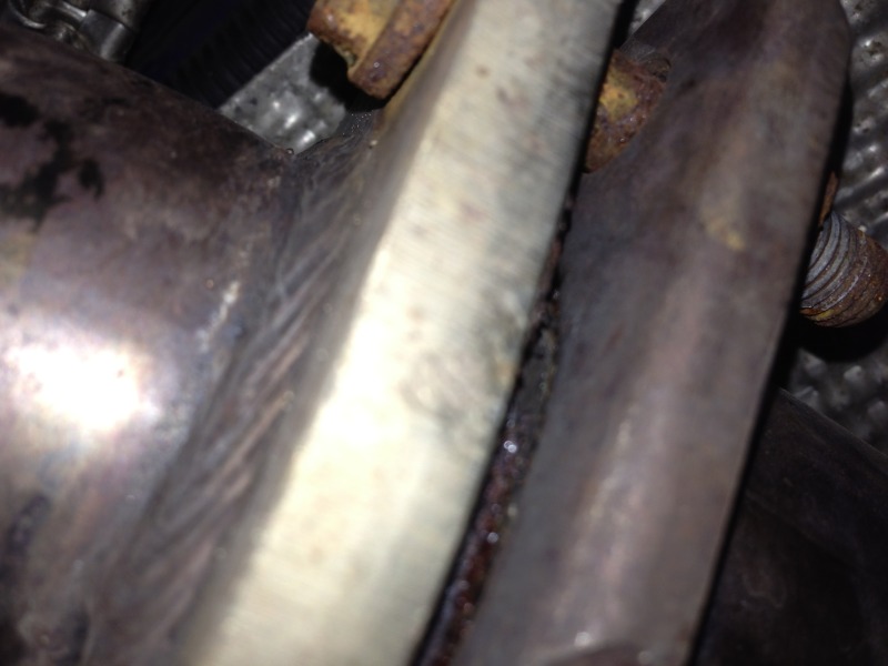

Found a potential culprit for the problems I've been having....
That's the turbo downpipe connecting to the exhaust - about a 1cm gap. The exhaust is so noisy anyway that I couldn't hear it blowing. I think this maybe the cause of my boost spike issues.....maybe....who knows!
Just need to find time to get it to a garage so they can fit the new system I've got. Attempted to do it yesterday but when the exhaust was put back on when the engine swap happened, somebody has used the wrong bolts (not the spring manifold kit ones) and they are both different ways round, plus they were done up with an air ratchet so I haven't got the guns to undo them!
It continues...
That should be a flexible joint with exhaust packing. It is to allow the joint to move on the 172 decat or cat section and prevent cracking of the down pipe.

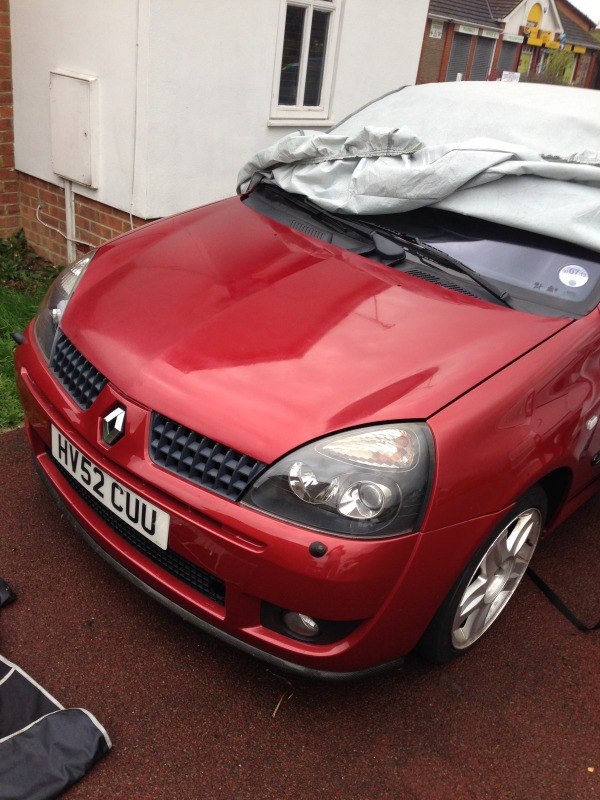

The before shot after I got it back from the body shop, still with that mega shizen exhaust
To what is it now…1010% better, still needs a bit of a tinker to get it to sit perfect in the space, but I’m much happier and sounds so much better.

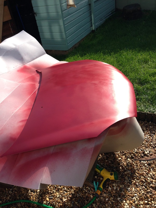

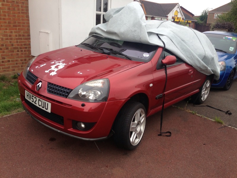

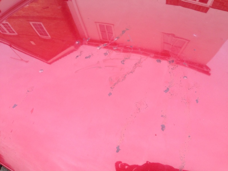

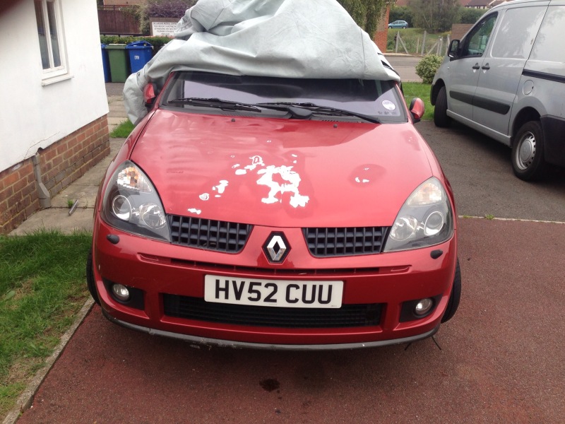

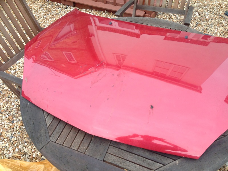

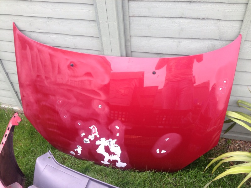

I bought a silly cheap bonnet on eBay and it arrived this week, the guy said it needed a re spray as it had some extreme bird droppings on it, I hoped that it would polish out but it was past saving and does need a re spray. So I started the prep work today, sanded down all the problem areas and just need to go over the rest of the bonnet now, then ready for paint. I'm doing it all myself too to keep costs down. Here's the bonnet before
and how it is at the moment
another hour or so of rubbing down needed then I'll get onto primer and colour

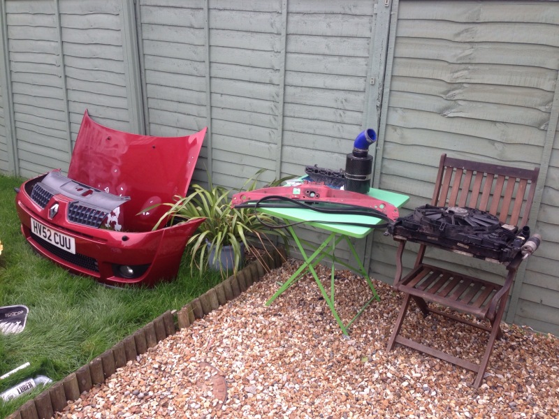

Because this has gone over some time, various different spares and parts are in all different places so decided to have a stock take to see what has gone missing, luckily nothing and managed to track everything down.
After closer inspection of the rad, it'll actually be ok, it wasn't rad weld after all, just some gunk it had picked up from being in my shed for ages, a quick clean and all was fine, filled it up too to make sure there was no leaks and luckily good as!
I've now bolted the air con pump back in and loosely fitted the pipes so I could get an idea of what goes where. Also fitted a new map sensor.

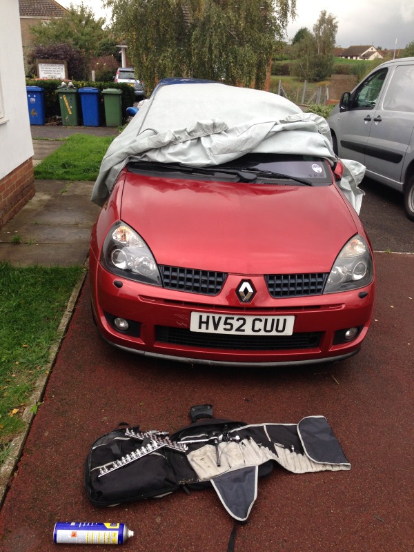

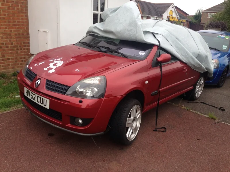

I was was quickly running out of room so decided to put some bits on the car to save space in the shed. When I finished, I had something that vaguely resembled a car! I remember what it used to look like now!

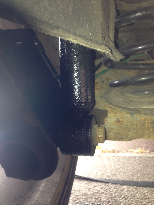

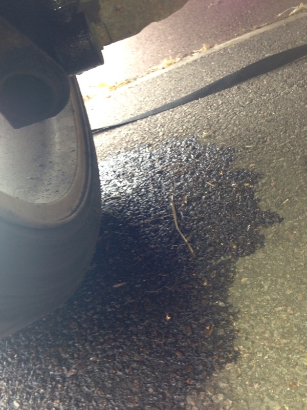

I covered the car back over and started tidying up. Unfortunately I then spotted a problem. A pool of oil under the NSR wheel, wondered WTF it was and then found this...
Yup, shock decided to piss its contents out onto my drive! Doh! Although not a big deal, still one more thing to add to the list as I cross others off! I'll be scouring eBay later this evening! Kind of glad it's happened now, as I can make sure it's perfect ready for when I start using it over winter, then for he new owner in the new year. Don't know why I'm so bothered really as I'm just going to sell it, but I like to do things properly!

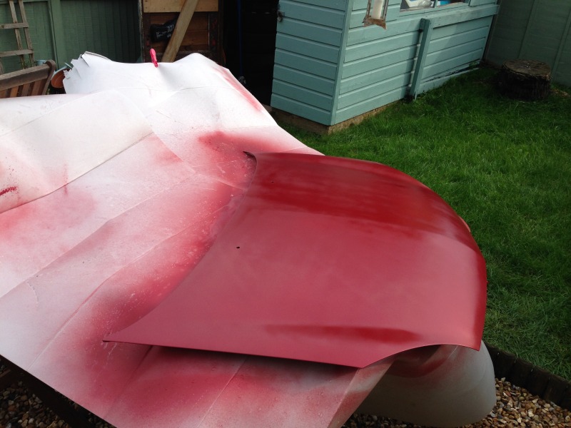

I've nearly finished the bonnet too, some before and after pics. Just needs a few passes with some compound and a machine polisher and it'll come up good!

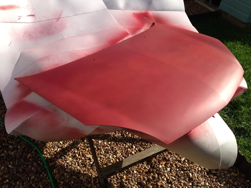

All primed up ready for sanding and paint
First coat on...
....and then onto lacquer and clear coat

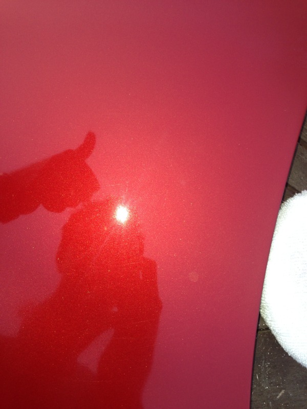

Left it to dry inside for 24 hrs then broke out the wet and dry and compound (all done by hand but I'll machine the rest) to test an area to see what the finish is like, pretty impressed...
Not a bad colour match either...
Like I said, not perfect, but after a few passes with a machine, it should be all good!

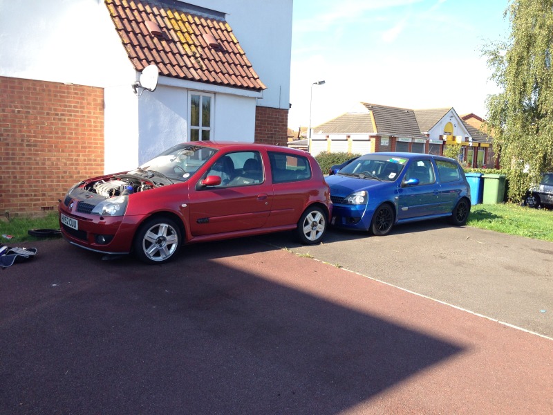

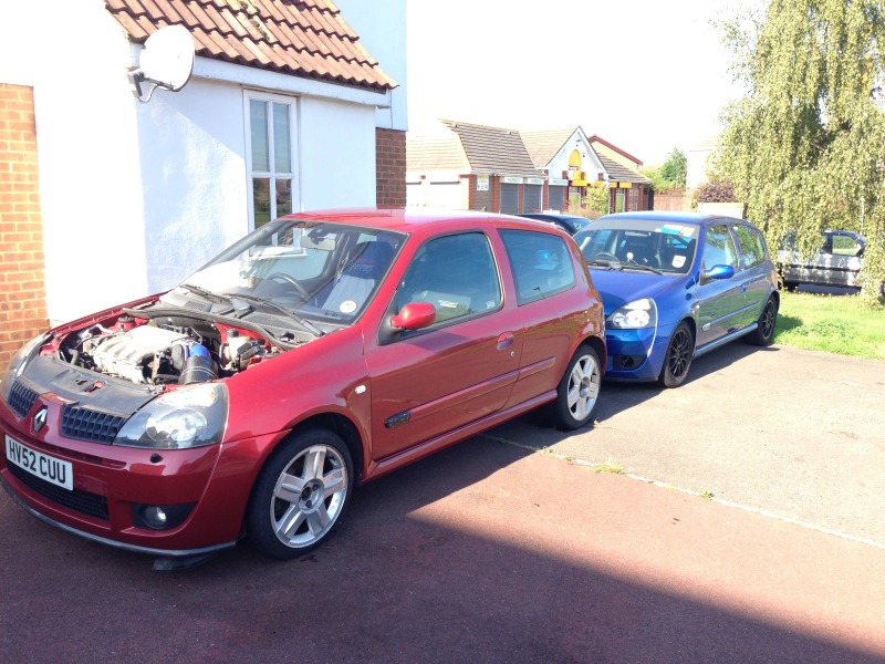

Finally got the car on the ground after 6 months or so, bolted up all the aircon pipes, coolant hoses and clipped all the various sensors back in. IT LOOKS LIKE A CAR AGAIN!
Swapped the UCH's and keys over as well, tested and they seem to unlock the right cars, so that's a start. Not sure if I need to swap the decoder rings over as well, but i'll wait and see if they start, if not, that'll be the first thing to check!
Plan is for this weekend to finish it off and see if she starts.
