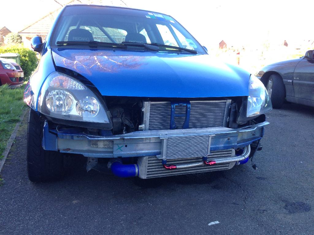

Is there room for it under that cross member behind the intercooler? air coming through the cooler will still be nice and cold, although I think it will work ok where it is so long as you have the number plate off (and lets face it on the road its unlikely to really need the cooler as you just cant hammer them the way you can on track with these turbo clios as they are quite quick)
  Cup Turbo, Flamer
i don't think there's enough room behind the inter cooler, good point tho and worth a look
That was my thinking too. On the road it won't need the air as I doubt it'll need cooling, on track I can just whip the plate off and then go at it!

Or get a thermostatic plate? :) I have just put mine behind the top vent, about 4bars of the 13 are visible and the bottom corner in direct wind contact! What size is your cooler?
  Cup Turbo, Flamer
It's a 16 row
I couldn't find a thermostatic plate with ports for gauges! I know I could have double decked them, but that made me think more that could go wrong lol!
incy-spider
Ah yeah you won't get that up there anyway, bottom corner behind spot light or as chip said behind, in front of the intercooler, being that big without a thermostatic plate you won't need to worry about air flow much/if any!

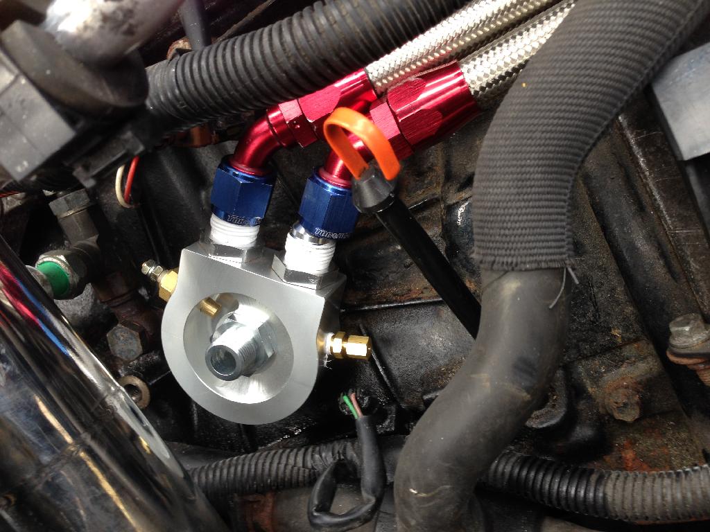

I've cut all my oil cooler pipes to size and test fitted the sandwich plate which all seems to fit well. My auto electrician mate is coming round on Sunday to help me wire up the gauges to make sure I don't do anything stupid! He's also linking my fan to a switch on the dash so I can have control to put the rad fan on if need be.

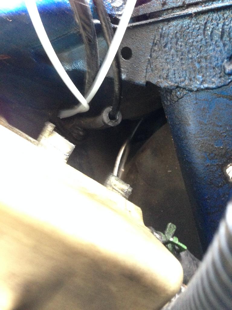

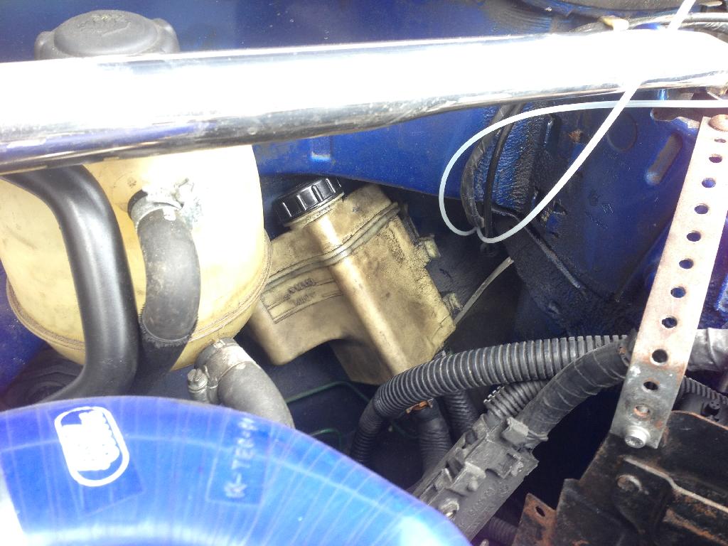

test fitted the oil cooler pipes, perfect length and fit perfectly! I've gone a bit OTT with the ptfe tape but I really only want to plumb this in once and wilt any issues, so hopefully should be ok. Here's some pics
Managed to rope the boy in for some help lol!
You can see in the pic above where the gauge pic up points are. Both fitted with ptfe tape.

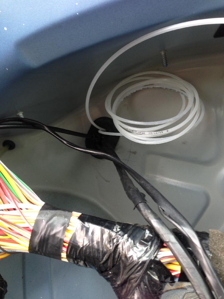

i then went about feeding the gauge lines through the car, this was so easy! I thought I'd be ages trying to find a way of getting the feeds to the dash. All I did was pop off the power steering fluid bottle, and just below it is where the bonnet release cable runs through the bulkhead, so just used the same route for the pipe.
I fed the pipes from the inside to outside, found it easier this way
All ready to be plumbed into the gauges. These are for the Oil pressure and boost gauges. There'll be another cable added tomo for the electrical temp gauge.

You don't need any ptfe tape on an fittings as its not the thread that's doing the sealing, just the clamping. It's the cone face at the top that meets with the same angled face and creates a seal. You'd be best to get rid to ensure you tighten the unions enough.
Went for the same sandwich plate as you for the gauges. Doesn't look as free flowing as the mocal one I had but should do a job.
Cracking advice that mate, thanks very much! I'd only done the sandwich plate so far, so easy to sort.

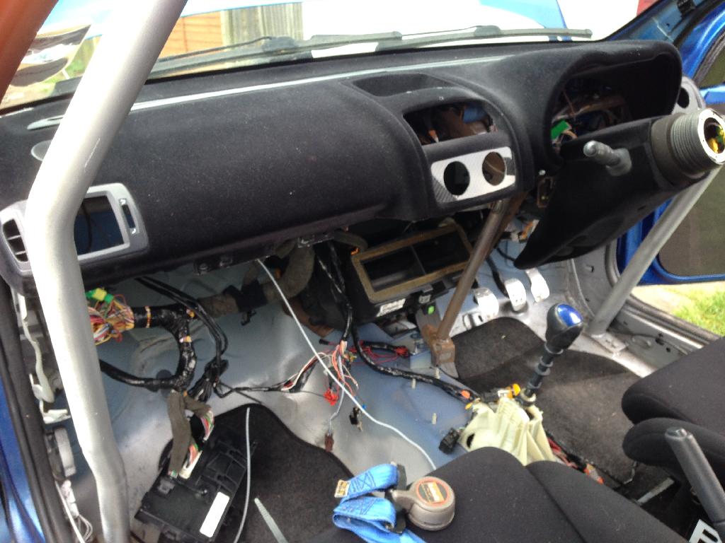

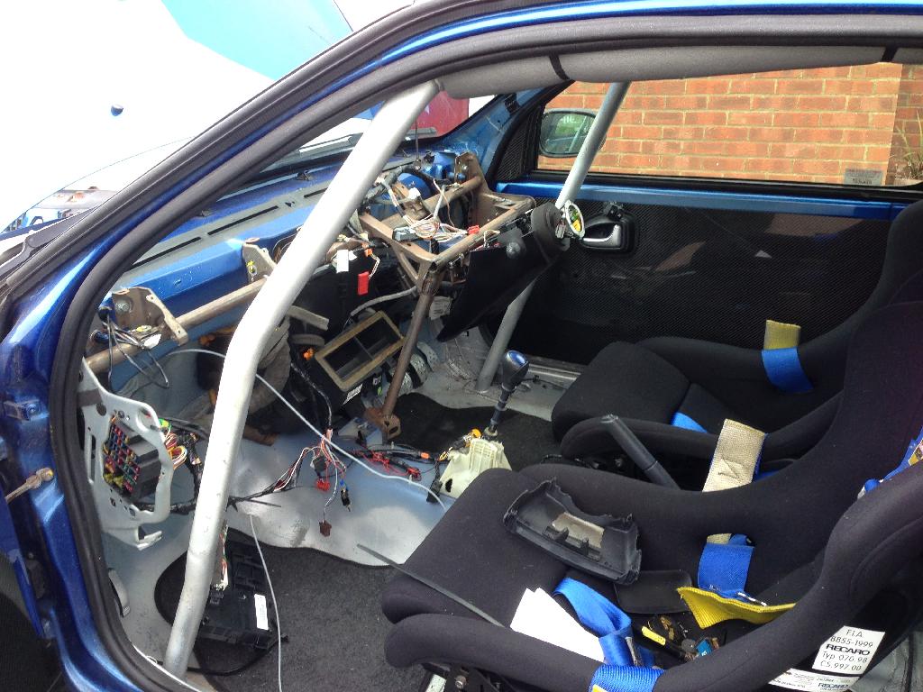

Got the dash back in, managed to snap the heater control of so a bit of no more nails has come to my rescue!
Also text fitted the centre console to make sure that still had a good fit.

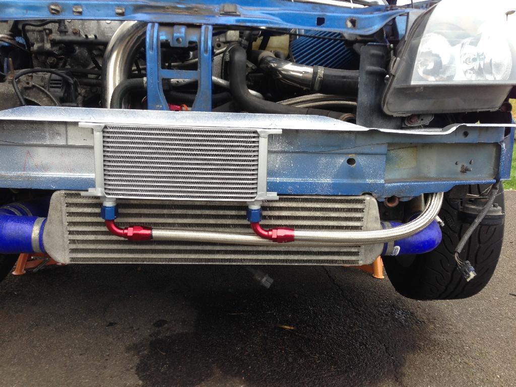

Here's the 2 of them together, match made in heaven in turns out!
  R5 gtt, R27 F1 team
Put the oil cooler with the hoses to the top mate, how is it going to bleed itself like this!
Coming along nicely. Just a small observation, I know you're tight for space, but it may be a better idea to relocate the oil cooler behind the front member, in case you have a knock, last thing you want is for the oil cooler to spit and drop its oil.
  Cup Turbo, Flamer
Put the oil cooler with the hoses to the top mate, how is it going to bleed itself like this![/QUOTE
Do you need to bleed it?! Didn't know you had yo!
Very good point, and one I hadn't thought too much about! Hmmmm, I may have to move it at some point then!

First up was to tighten up the an fittings on the sandwich plate, I removed the ptfe tape as advised by cupman, just to make sure they made a good seal.
I then set about fitting the gauge hoses to the sandwich plate and tightened that up to the block. Once all the oil lines were tight and the gauge hoses were tight, I set about fitting the new rad send fan. I had to cut a bit away of the fan plastic just so it wasn't squashing the power steering pipe behind it. This wouldn't normally be a problem, but because the rad is double the thickness and I've got a boost pipe behind that, room is a bit tight!

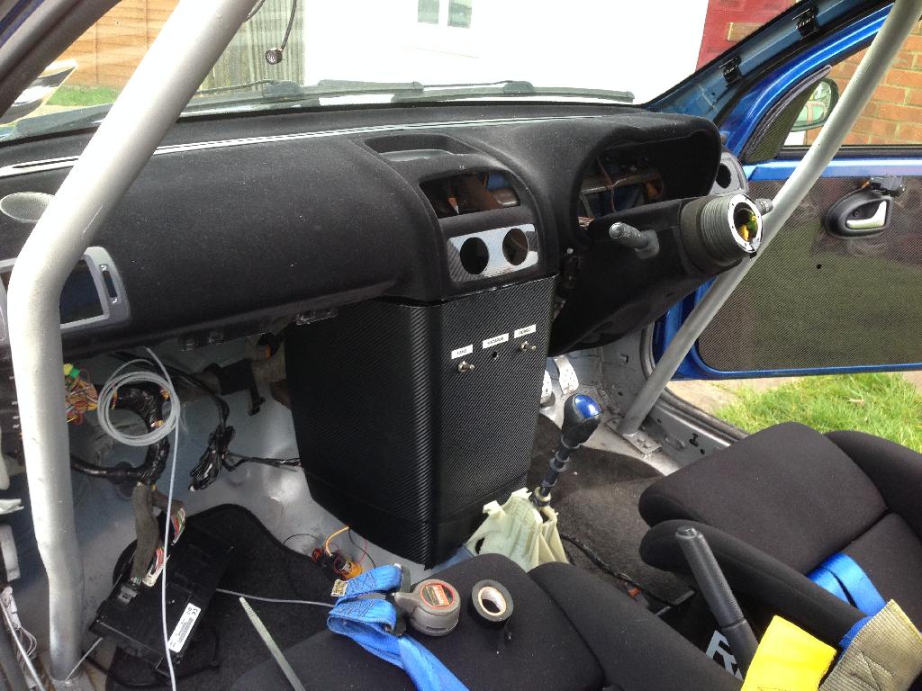

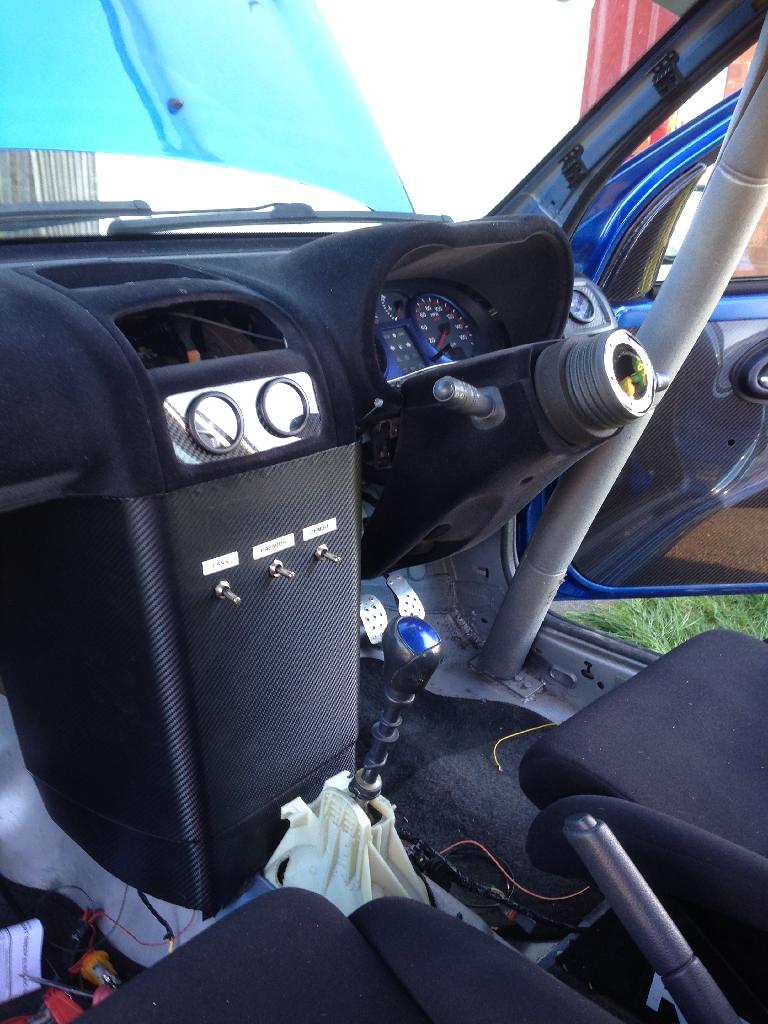

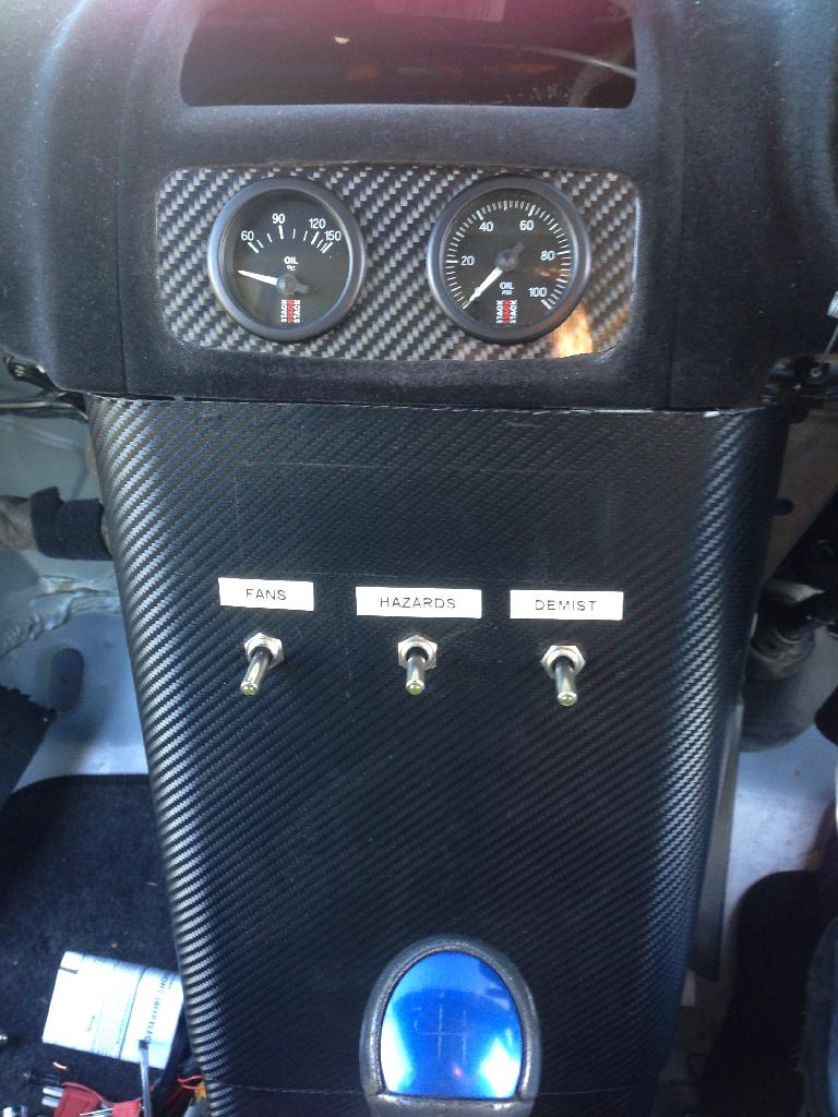

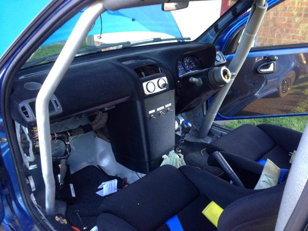

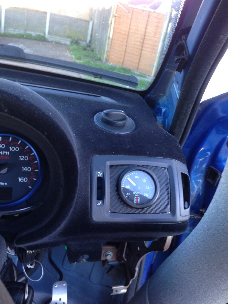

With the engine bay sorted, we turned our attention to the gauges. I say we, my mate wired in all the gauges in literally no time at all! The 2 oil gauges diet in the middle with boost on the tight.
I also asked him to wire in a switch so I can turn my rad fan on as and when I want you, and he also wired in the reSr screen demise switch too! So they are now all fully working.
This is how she currently looks too

Agree with Tutuur, you will find it difficult to bleed the air out of the oil cooler with the hoses to the bottom. Is there a bleed nipple on the opposite side to the hoses?
  Cup Turbo, Flamer
Looking good mate! Love the gauge setup and centre consol.
I really didn't know this! I don't there's a bleed nipple anywhere, need to think about that then. Is it imperative to bleed it?

I would spin the cooler otherwise if there is no check valves then you run the chance of having oil drain away every time you switch it off. It will then take a minute to bleed again which will or could starve the engine of lubrication at one of the most important times. Start up.
And for ease of mounting just spin it 180 deg and notch two pieces out of the slam panel for the inlet/outlet, route the pipes under the headlight and that way you can use the already drilled fixing holes and keep the hoses you have made.
Also solid mounting an oil cooler or any delicate cooler is not good practice, if you check eBay you will get small threaded bobbins for a few £'s which is a much better solution, especially on a road car that will see miles.
  R5 gtt, R27 F1 team
There's no bleed nipple and you don't have to bleed it, if you put the fittings to the top air will come out by itself.
also to avoind any oil pressure drop at first start fill the cooler and hoses prior to connecting them. Could get a bit messy but could save your engine.
friend of mine didn't want to listen and spun a bearing the first 100m he drove....
  Cup Turbo, Flamer
I'm getting a bit confused mate.....same theory as bleeding a radiator I'm guessing? Back off the nuts slightly, let the air bleed out and wait gorgeous oil to drip out?
Ive already started the car too since fitting the cooler and all seems fine, that was without filling the cooler first?
  R5 gtt, R27 F1 team
If the fittings are placed to the top you won't have to bleed, as air is lighter than oil it will naturally fill the cooler with oil
as i said, you could be lucky. My friend was unlucky and had to rebuild his engine again....
  Cup Turbo, Flamer
I found this on the mocal website under their FAQs...thoughts?
ill be changing the solid mounting, but the last sentence is interesting!
Mounting on bottom brackets alone will suffice up to 13 row coolers after that all 4 brackets should be used, a system of spacers and long bolts tying in all four brackets will spread the load. The cooler will expand with heat so allowing someflexibility in the mountings will prolong cooler life The weakest part of the plate type cooler is the brackets, breakage of which often damage the whole cooler. if fitted to any vehicle that may be subject to vibration or twisting of the mounting platform, consideration should be given to abandoning the brackets and mounting in a cradle, locating with cable ties or an elastic strap should be sufficient as the hose will provide some restraint. Oil coolers may be mounted anyway up and are self bleeding, the resistance to oil flow through the matrix means that tanks will fill up evenly pushing out the air before the oil flows through.
  R5 gtt, R27 F1 team
Interesting, it might not be a problem then afterall but i like to over-engineer stuff just to be safe

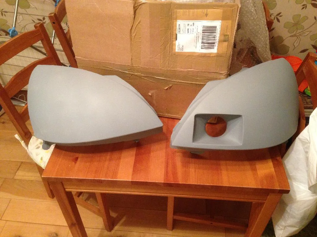

I purchased some headlight blanks from CMComposites, highly recommended, and great quality! I'll be getting them sprayed gloss black, I would do them myself, but after the hard graft doing the flame red bonnet, I really can't be bothered lol!
I'm also taking the car to 519 tomorrow and leaving it there for a week. Plans are to sort the mapping out, I've got a gearbox leak where the selector rod goes in, so hopefully that's just a seal and an easy fix, and to also sort out my terribly bad blowing exhaust, then the fun can begin and I can actually drive it!!!
I've also looked into track day evenings in May at Brands hatch, so I can finally get back on track and see what it can do!
Here's a quick un-painted pic of the headlight blanks
