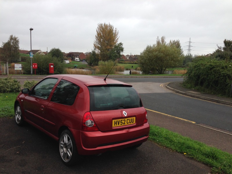

The red car lives!!!

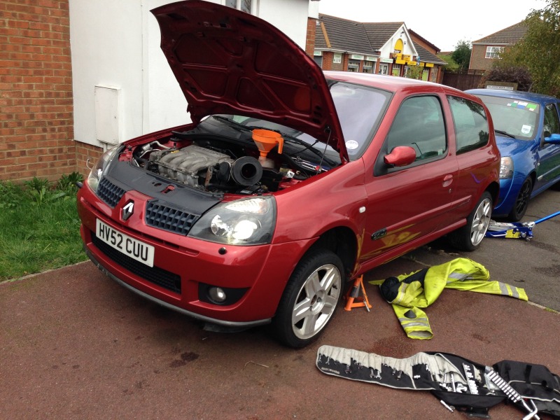

i cracked on early yesterday morning, finished tightening the exhaust up, has new gaskets/bolts/clamps all the way through. It was then time to stick some fluids in and see if she started.
Stuck 2.5 litres of water in, and waiting 30 secs to see if any came out...it did! Heater matrix pipes weren't clipped in fully, clip, clip, done! Another wait and nothing so filled the rest up with concentrate coolant. New gearbox oil in. 3.1 litres exactly before it started to dribble out, done! Engine Oil changed too! That's now a full service including new aux belt kit done!
Battery connected, lights on dash, turn key, boom! First time start! Perfect! Left it running for a good half hour, topping coolant up as it ran through, checked heater and that was pumping out hot air nicely too.
Topped up power steering fluid and done a few lock to locks to bleed it through, check! Good to see that after 30 mins nothing seemed to be leaking so all good!

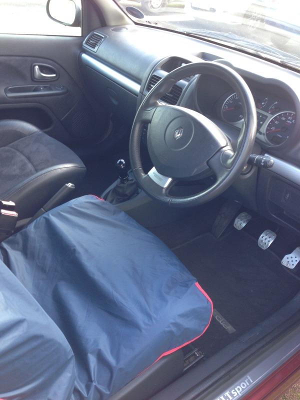

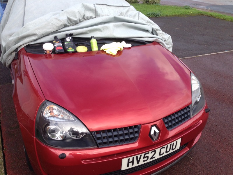

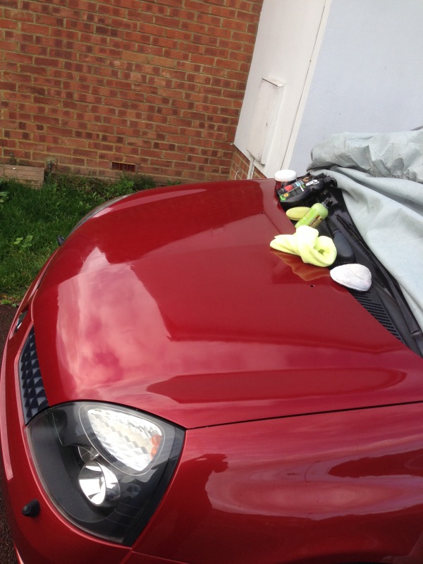

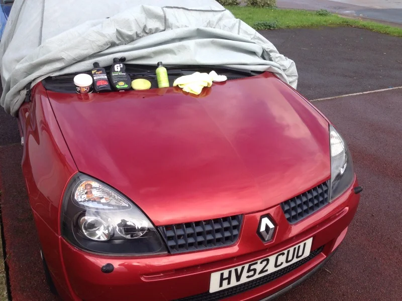

Couple of pics below of the finished bonnet re spray and how the car looks at the minute plus some pics of the interior it's mint for an 11 yr old car!
Gonna be a real shame to sell this!
Bonnet all done!
It's alive!
How she looks this morning

That's an awesome finish on the bonnet for rattle cans!!
Thanks! Never painting anything myself again! Took me hours to get that finish, plus by the time I purchased the various sandpaper grades, polishes, paints etc, wouldn’t have worked out much cheaper than getting it done properly – plus many man hours saved haha
Hahah that's the experience I've had with painting in the past, done it myself and it's ended up as much as a bodyshop lol
Still it's a good feeling to get a finish like that yourself

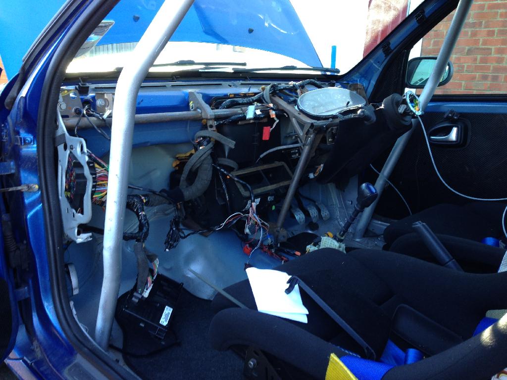

As the sun decided to make an appearance today I thought I'd have a go at at few bits on the turbo. I've been needing to get dash out for ages as I need to sort the cabling out and install all my gauges properly, that way once it's in, it's in! No more pissing about!
so out came the dash and here is the current state....
ive still got all the pre-tensioner sensors etc running under the seats, so they'll be going and I'll just be tidying everything else up.

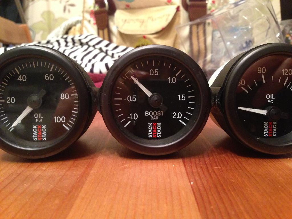

The in-laws got me a oil pressure gauge for Xmas so I'm just left with oil temp to collect now then I can install them all, I'm thinking here, but need to make sure it'll look good.
I'm going for the 'fresh out of factory look' so all gauges and other controls must look OEM as much as poss. I'm properly picky about that, I hate people who just screw pods all over the dash, it looks s**t!

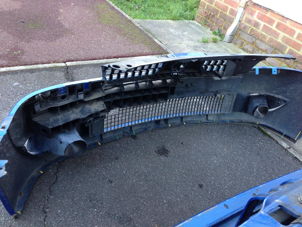

So good to see the car again after 3 months under cover, got me motivated to start work on it! I decided to take the front bumper off and test fit the brake ducts I've had in the shed for ages
As with all the ducts the fit is terrible! They'll need a fair bit of work to make them fit and looks good. Came across another problem on the passenger side duct though, boost pipe in the way, b**ch!!

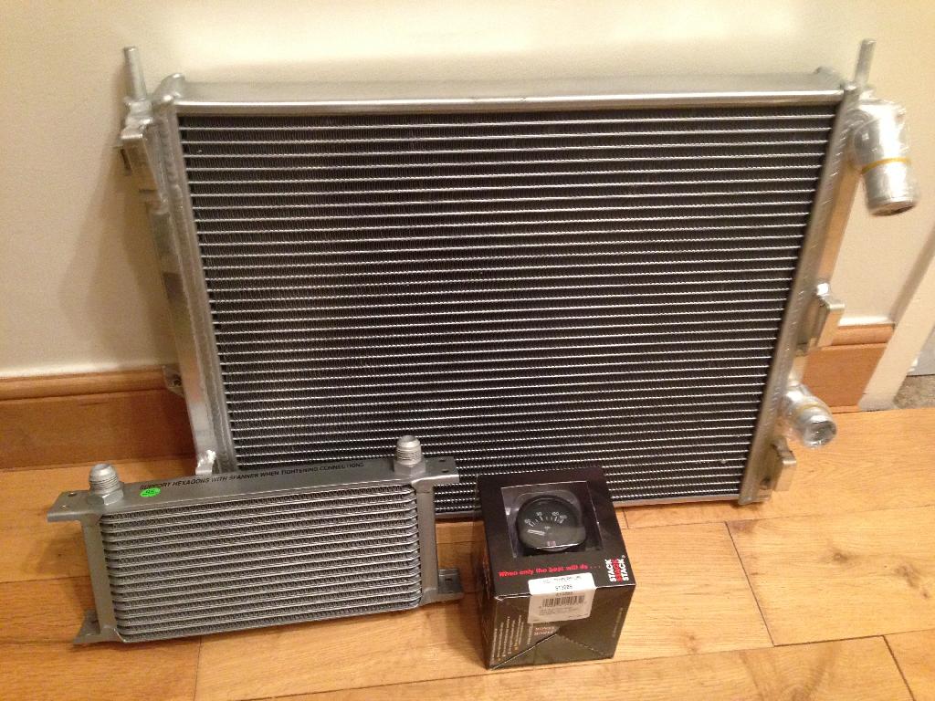

I've collected some parts through out Jan. Managed to get an alloy rad, 16 row oil cooler and the last in my trio of gauges, oil temp!
Next on the list are hoses and connectors for the oil cooler. Got an auto electrician mate booked in at the end of Feb to help relocate the battery from the boot to behind the passenger seat and install a cut off switch. Also to help me wire in the gauges too.

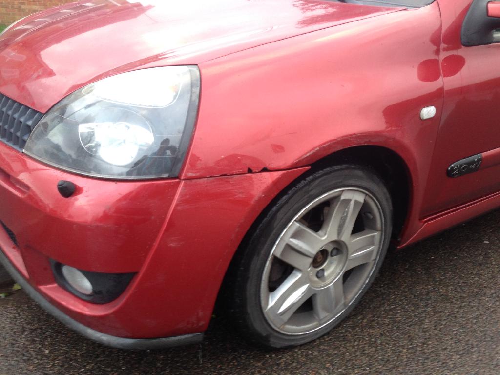

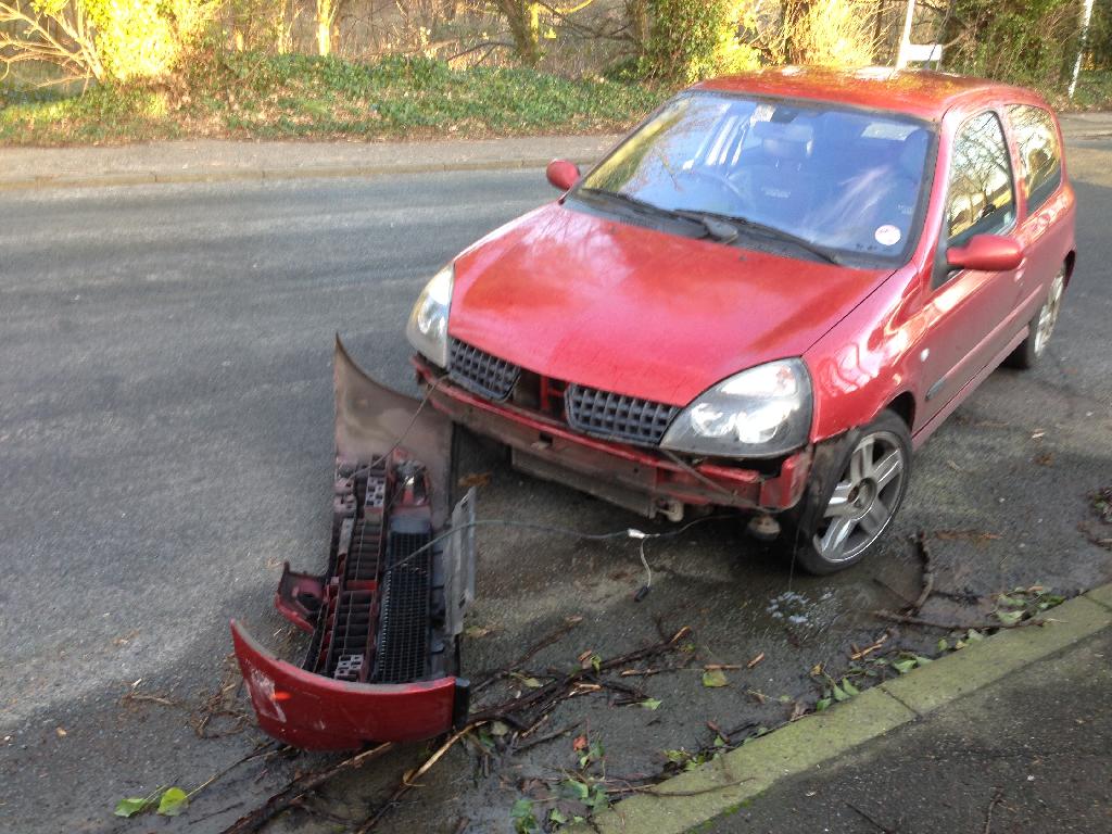

Well having this happen wasn't in the project brief. Totally gutted considering the time and effort that went into it! All that hard work on the bonnet too!!
Old man not looking when pulling out of a junction = busted car. He's admitted full liability and I have witness statements so all is moving quickly.
After it happened I hoped that the bumper would just pop back on, so I popped the bonnet and the rest of the bumper fell out, that's that then eh!
I thought it would be close, but still shocked they have written it off, only needs a few panels!!! :( Needs bumper, light and wing, plus a wheel refurb if you're picky. So that means more admin, more time spent speaking to people when I could be getting on with the blue one!

Yeah very minimal! That's why I'm surprised they decided its a total loss. It only needs a wing, light and bumper, easily sourced on ebay, CS etc!

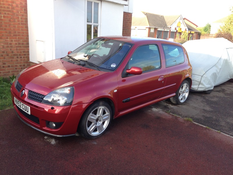

It’s been a shocker! Obviously from the above you can see the crash I had. Fine no biggy, I got paid out from the other guys insurance company (as he admitted liability), car is a Cat D now.
I popped all the body work back on, cleaned the other cars paint off and I’m left with a slightly scratched/battered car that really isn’t that bad. I thought I’d just continue to use the car as a daily as I bought it back from insurance.
Was fine for a week, then the starter motor packed in, unfortunate I thought, but managed to get a new one and fitted on Saturday just gone. Again, fine, started with much more force and was sorted!

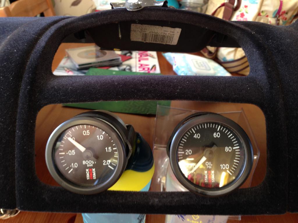

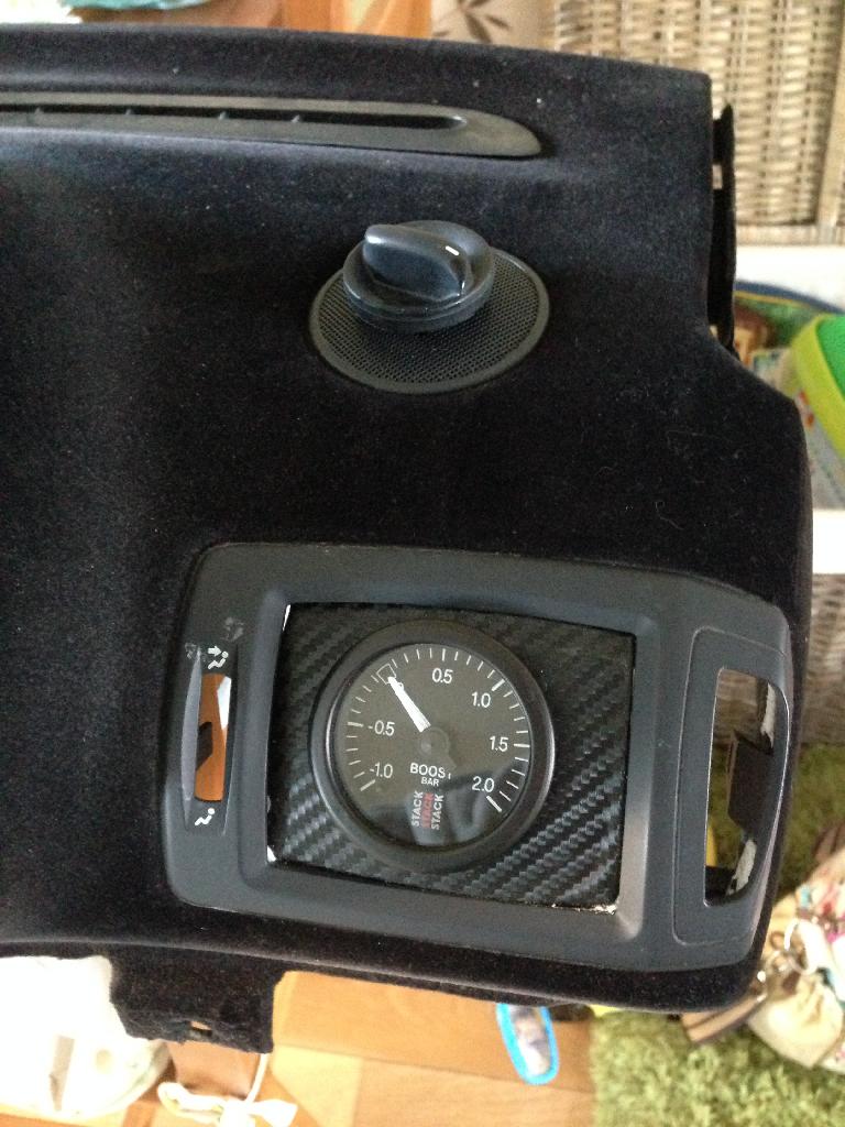

As mentioned before I’ve been collecting some shiny bits and took my dash out to fit the gauges and tidy the wires and cabling up!

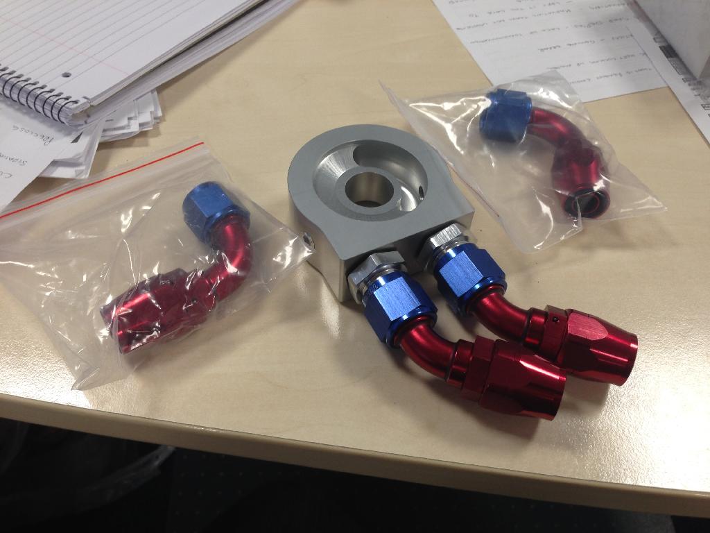

I ordered a sandwich plate for the oil cooler and gauges, I’ve been reading lots about using sandwich plates for gauges, some swear by them, others hate them. It’s the most straight forward answer so I’ll start with the sandwich plate and see how I get on. I also ordered some AN fittings and some braided hose for the oil cooler, so should be able to get that installed when I don’t need an arc to go outside!
Oooo shiney bits!

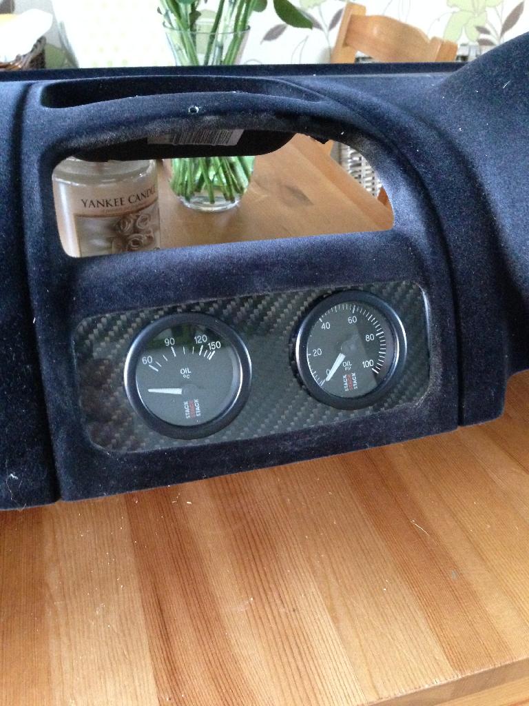

I set about installing plates for my gauges next. I ordered an A4 piece of 2mm thick carbon sheet (genuine) and cut it to size so it would fit exactly in the gap where the old central vents were. As said before I want it to look as factory as possible, or at least as neat as possible. So I’m going a bit OCD on detail. Here’s some pics of the outcome.
I managed to get the carbon plate pretty flush with the dash, so quite chuffed with that, holds the gauges nice and tight too! As you can see I relocated the fan speed switch to where the tweeter used to be, I wanted to keep this as I gave me flexibility still on hot/cold and fan speed etc. The boost gauge is now nicely sat where the old vent was. Unfortunately that’s still wrapped not genuine carbon so looks a bit out of place and doesn’t match. When I find a spare 5 mins I’ll take it back out and replace it with a some genuine carbon so it matches (told you, OCD!)

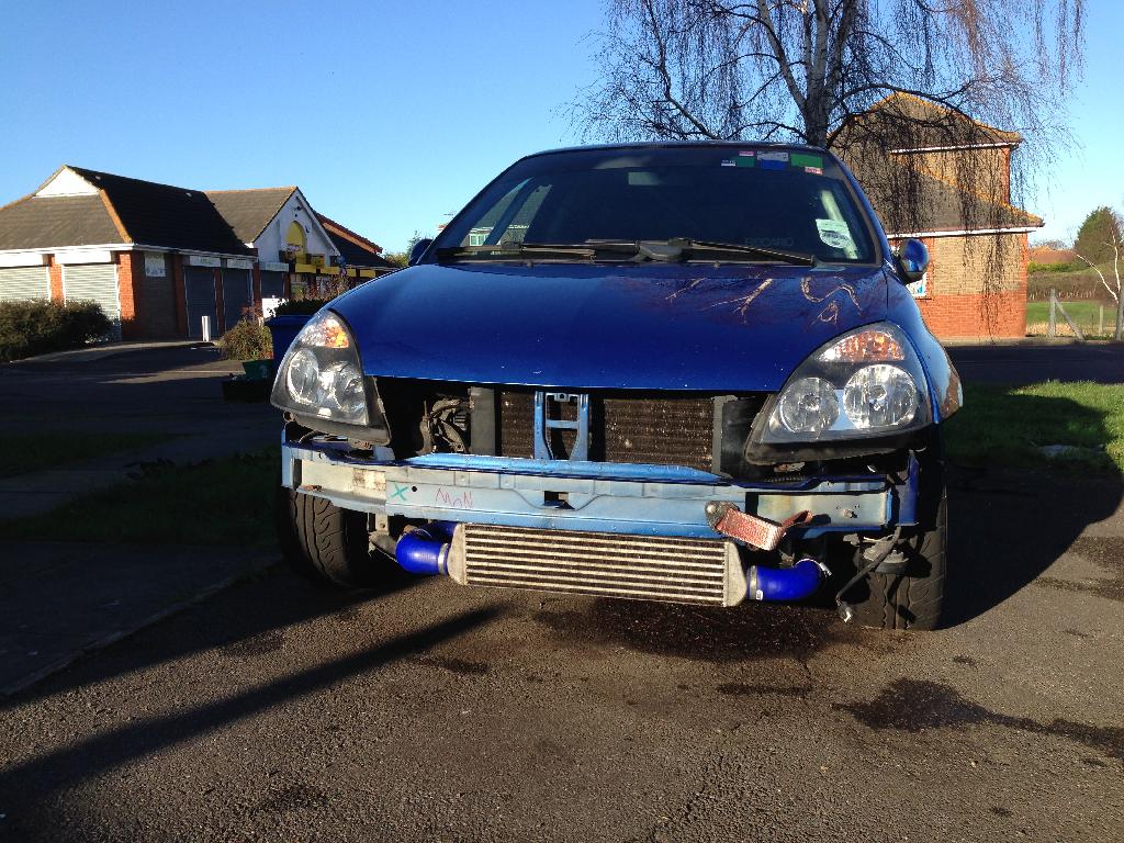

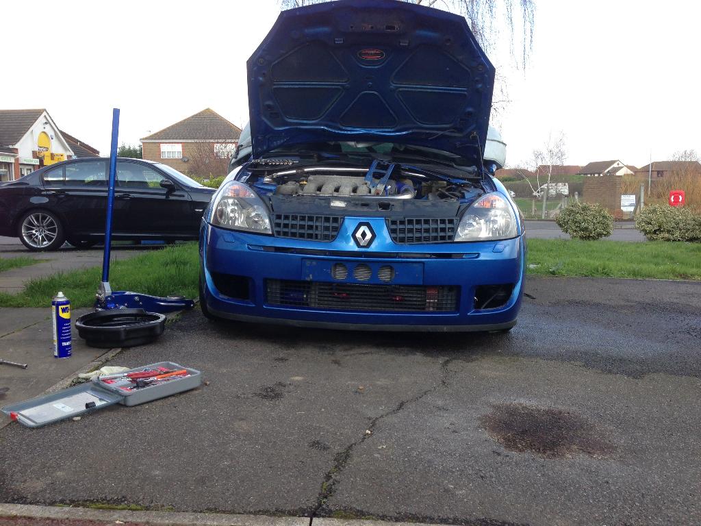

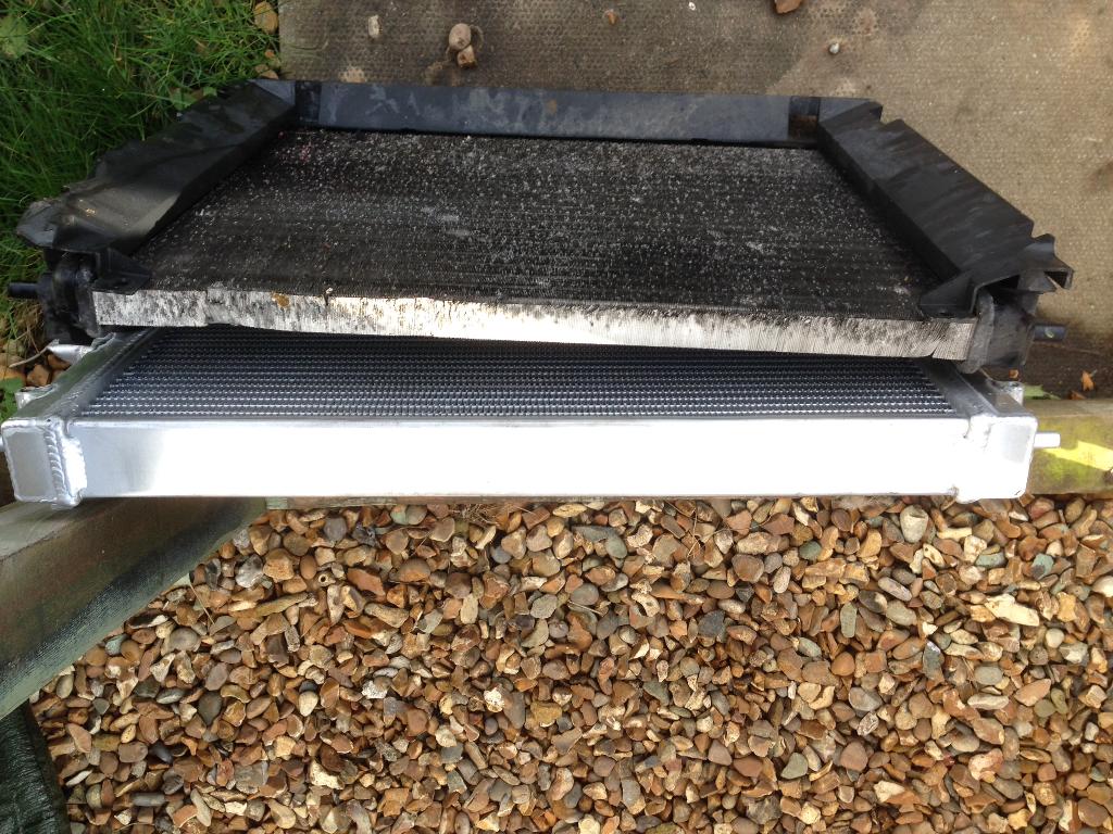

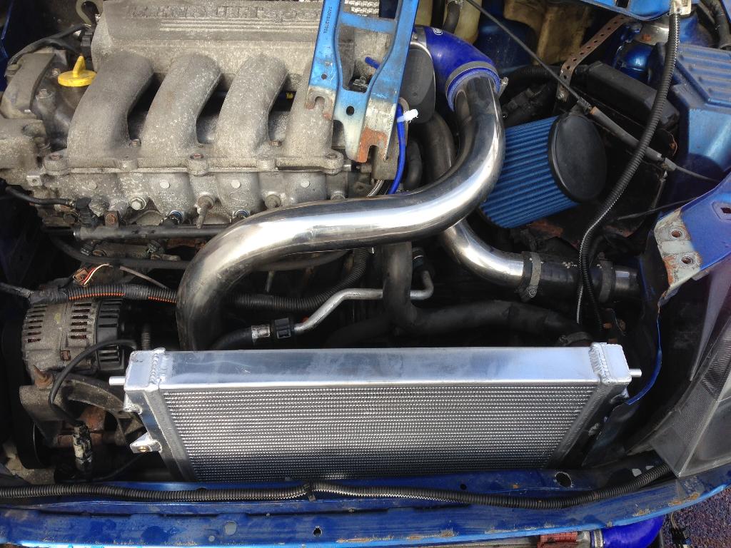

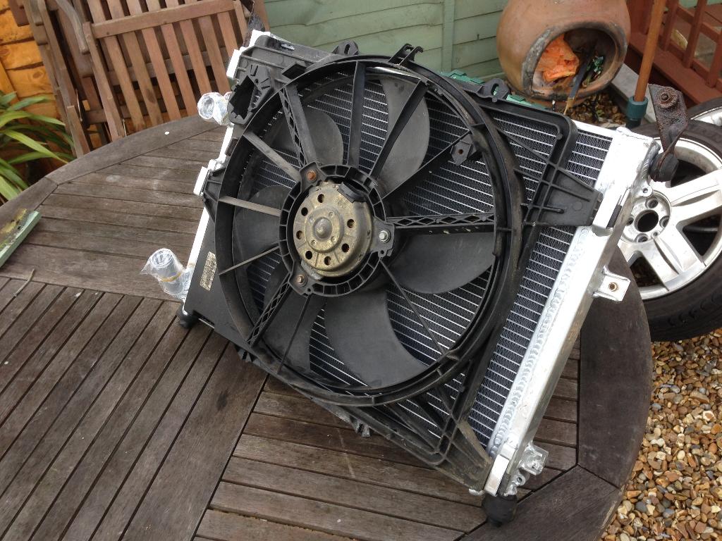

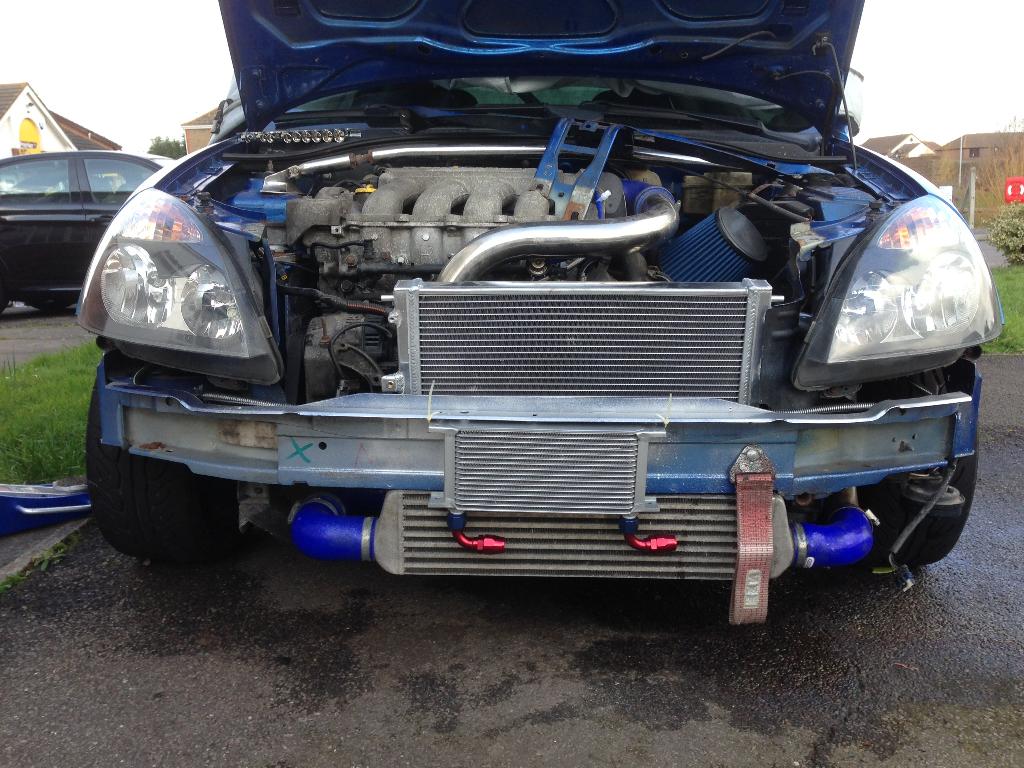

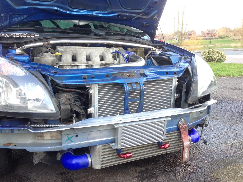

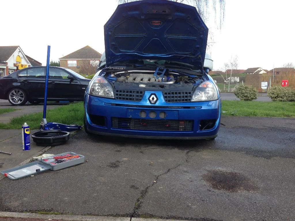

Done a bit on the cup today, test fitted the rad. Which I'm really surprised is a great fit, and a straight swap! You can see from the pics below its about double the thickness so should do the trick.

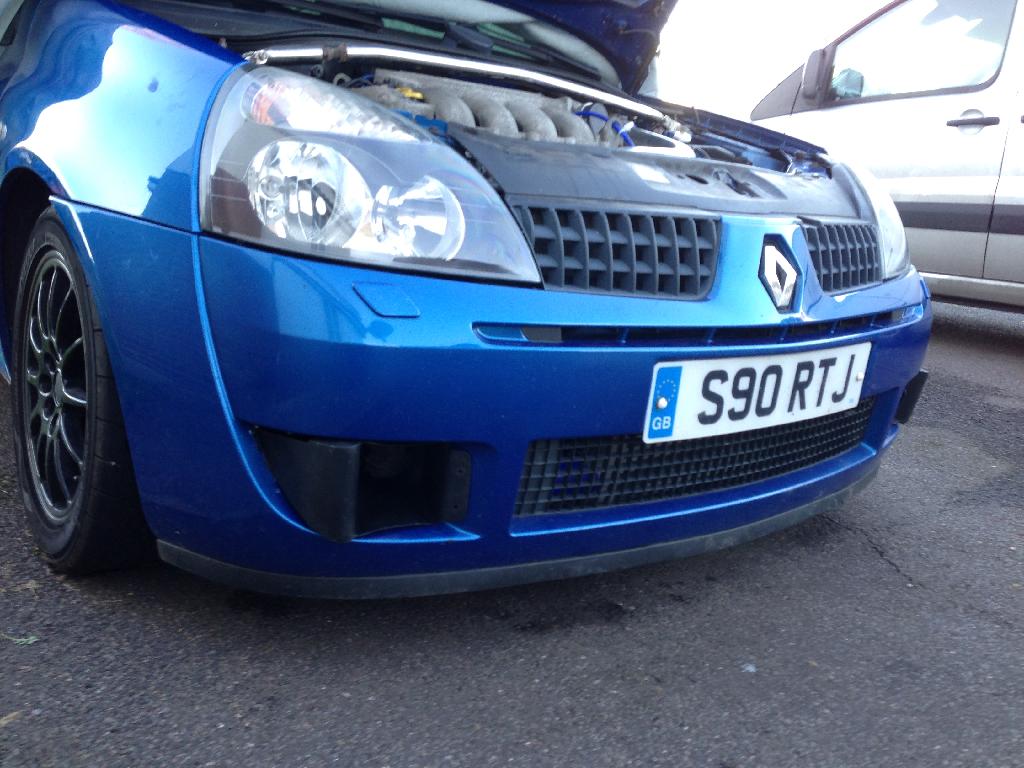

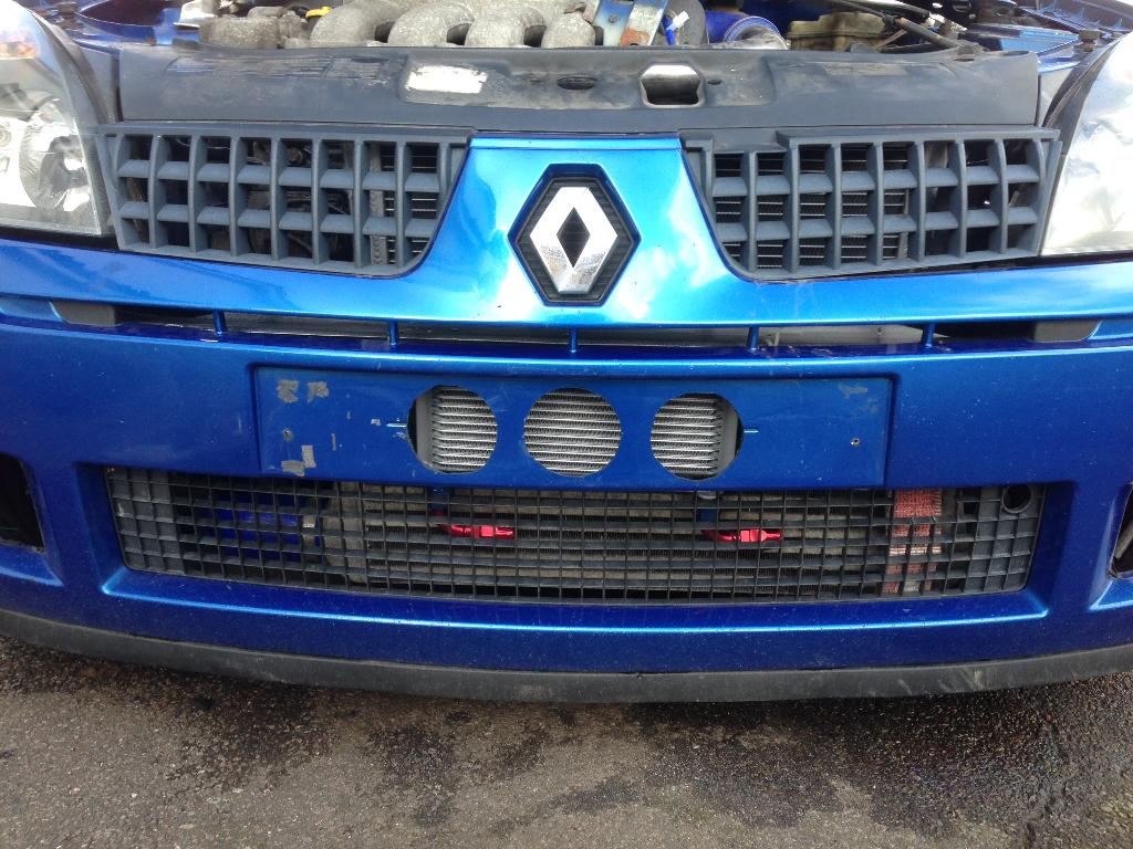

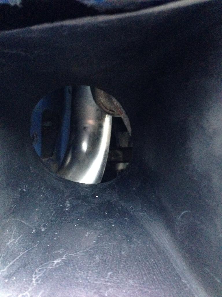

I also test fitted the oil cooler, I've decided to stick it behind the number plate and drill some air holes so it gets some ventilation. Idea is, on road, cooler will hardly be used, on track, whip the plate off and loads of air! I've used an old scrap bumper to drill some test holes, these ones are far to big, so when I come to do the new bumper they'll be smaller.
Need to route the braided hoses and get them cut to size and then plumbed in. Then I can get the dash back in and plumb the gauges in!
  Cup Turbo, Flamer
That oil cooler won't do anything unless you make holes in the cross beam behind it
It's got a good cm or so behind it, so should be enough gap for air to flow through, if not, it's all part of the project, finding out what works and what doesn't. If I'm finding oil temps are too high I'll relocate somewhere else
  182FF
Fair enough, it is a good idea having it switchable with the number plate.
Even with the 1cm air will simply go round the front of the cooler. It's the significantly easier path. The cooler will still have some effect but I'd guess at 50% efficient compared to being behind the square grill.
How much distance between bumper and cooler? If that's close to zero it'd work better than a few CMs
