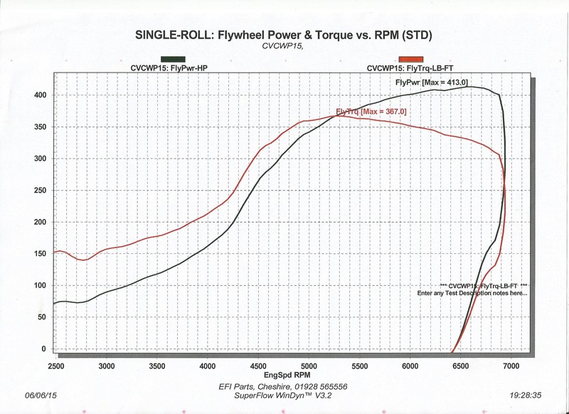

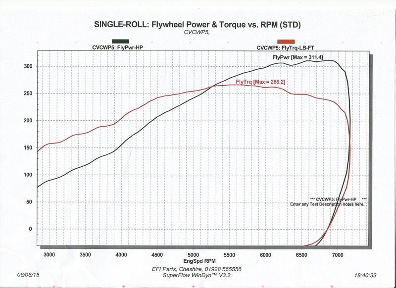

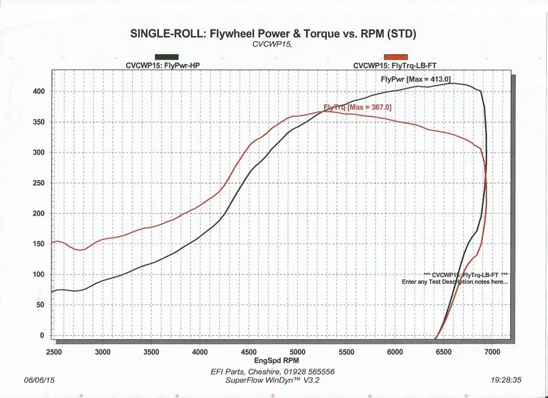

Mapping day brought all sorts of problems, seized lambda sensors, exploding coolant bottles, popped heater matrix pipes, self loosening power steering pipes, fuel leaks, front bumper continually popping out at the side from scrubbing issues. Im am shocked i managed to get it back to Bristol! Even worse i didnt have break down cover!
Chris has done a pretty epic job at mapping it, im usually very picky in the most minor of faults but genuinely cant fault it, the car has never ran so smooth, no hesitation, no cold start issues, no accell fuelling issues, good on fuel, and for a very reasonable cost. So naturally he comes highly reccomended from me!
If you have free'd some cash for a 02m, i have a complete package for sale with epic specs if you ask me.
Great job mate, would of loved to of seen what you made with 1 Bar, so far only Blightly and you have been in the ball park figure to what I made previously.
413bhp is really impressive, my EGTs were going mental at 380 so we turned the boost back down to 1.2 and 374bhp. Start buying spare gearboxes
Yeah EGT's are always a worry, i dont have a sensor so i dont know what its reaching, im very much playing the game of "there no gauge on my dash to worry me, so i wont worry". :D . I have some sort of reassurance, in that my friends Mk1 with F7P Turbo (2871'd with with the log also), which makes 375bhp but required 2 bar of boost to get there, and i know that give its driven hard (many many 150mph pulls), and touch would he hasnt melted any of his exhaust valves into oblivion. Its all a game of chance though really.
