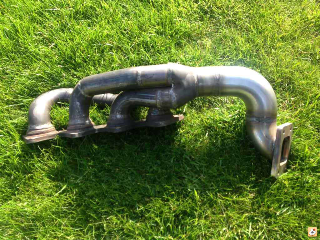

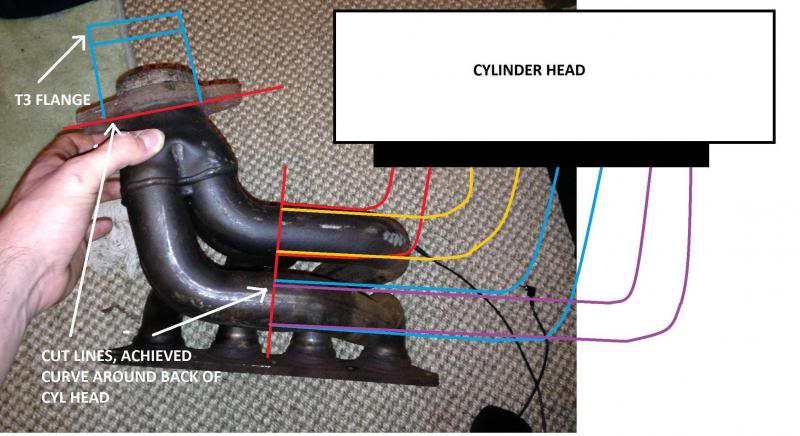

I think it would be quite a big ask to try and get equal length plus the turbo above the gearbox. Where you'd need to loop the shortest runner to gain length is where the starter motor sits. Plus the downpipe needs to be ran back through there as well so its really tight on space. I wonder (if you were using a custom inlet) if you could use the RStuning megane manifold and have the turbo on the top instead?
http://www.rstuning.co.uk/exhaust-s...d-p-201.html?zenid=adi85f7h2qjefnjh5mmh18hgu5
  172 cup, Impreza P1
IMO on top is the way to go. Keep the hot stuff away from thing that dont like it.
Nice manifold the RS tuning one. Might try and make something myself like that.
  182/RS2/ Turbo/Mk1
Yeah the RS Tuning one is lovely, I'd quite like one but not sure I can justify the cost given my relatively basic turbo with internal gate.
321 is a decent grade too.
Wonder if its nortech made or if he is getting them done somewhere else, looks lovely either way.
  Trophy,R26,GSXR1000
I think even using that you would struggle to get a 3" downpipe back past and squeezed between the manifold and bulk head. Lets be honest if you go to the extent of a tubular manifold you'll be running a gt30+ and will need a big downpipe. Fives have a lots of space at the back of the engine as normally it has both the inlet and exhaust running off the back of the engine plus they don't have a flat bulk head like a clio.

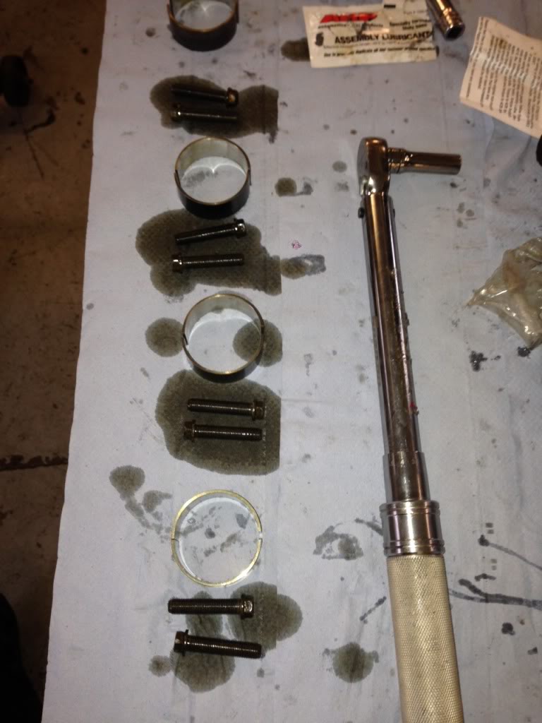

Got a pic from my mate of the big end bearings we took out. No hole in these either...
As I mentioned earlier mate the hole is in the bearing journal on the crank, not in the shells for the big ends.
Oil flow goes:
Gallery for mains
through main bearing shell
through main bearing journal
through crank
through big end bearing journal

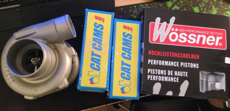

Some shiny bits appeared :)
There may be an opportunity to get a GT3076-WG turbo, rid it of the T25 flange and fit a T3 one, but because it started life as the "WG" turbo it has a slightly compromised 56.5mm 90 trim turbine instead of the normal 60mm 86 trim turbine, but they may not be a bad thing. But it might not happen at all anyway. None the less, exciting :)
