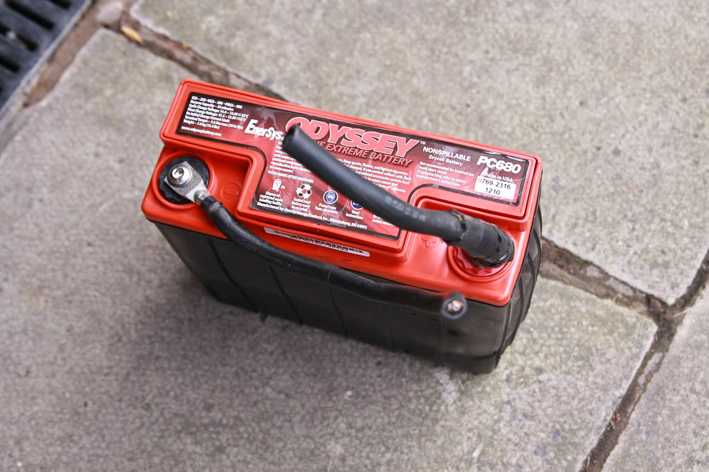

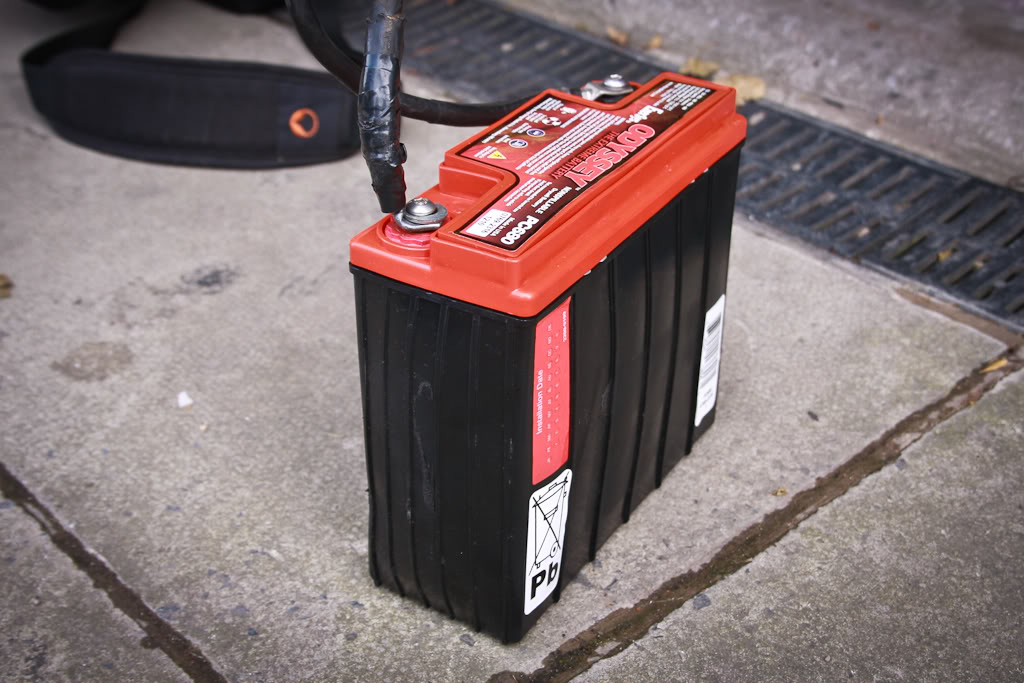

Took the Mk1 over to Cadwell Park on Wednesday with a group of people from here, risked it by only taking slicks with the rain being on and off on the day. Only managed a few dry sessions before my month old Odyssey battery nearly exploded...
Lucky I came back in when I did or it could have been a different story. My ECU is fried also, all down to a new alternator being faulty :dapprove:
Now time to fix it again :dead:

Why did it nearly explode? *just read it was a faulty alternator* Nice quality on the video though too, I like

It was new around 18 months ago, its actually an Espace diesel unit. It was fine up until a month ago when the bearing got noisy, so I took it to a local place who rebuilt the whole thing with a 12 month warranty. Fitted it and it was fine at Mallory etc, as I checked its output to see if it was charging OK after fitting it....

Espace diesel altenator? Are they supposed to be spun by an engine at around 6-7000 rpm??:dead: Hehehe!

Probably less, but I ruled that out after it was fine for like 18 months if not more.... Took it back and the guy confirmed the regulator was faulty, so had that swapped over. Also knocked together a small LCD volt meter to put in front of the clocks so I can turn off if I spot it going daft again!
