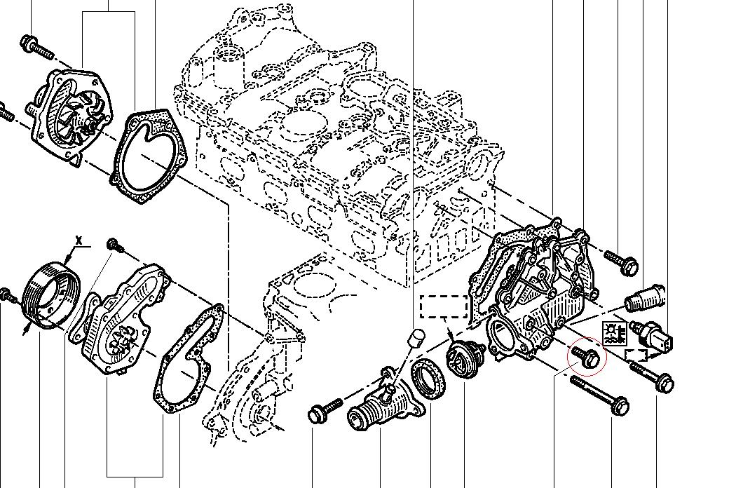

-Do i have to open the bleed nipple on the thermostat too? If so where is it on pic below? (pic stole from ben_p :p)

Circled is bleed screw.
When refilling fill up till the coolant bottle is full then don't forget to get the engine hot, hold at about 2000rpm for 5-10 mins so the thermostat opens, then you'll have to put in even more coolant.
