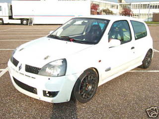

I don't have many photos of the car originally, but here are a few of how Palmer Sport kept it before I took delivery of it.
Car Outside PalmerSport

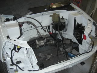

Main Shell Changes: -
Had New Roll Cage Door Bars Fabricated and Welded in Place
(pic to follow)

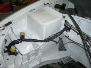

Removed Engine and Box For Tuning and Rebuild
Seam Welded Front of Shell + Re-Sprayed

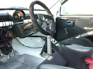

Co-Driver Seat Rails Welded In
Co-Driver Seat and Foot Well Fitted
All Race Spec Suspension Removed

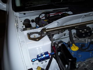

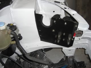

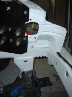

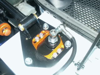

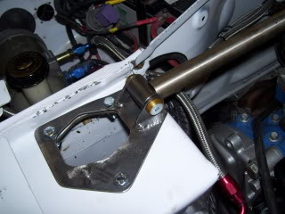

Fabricated and Welded new Strut-Tops
New 3-Way AST Dampers Fitted Front and Rear
New Strut Brace Fabricated and Fitted
Mud Flaps Fitted
Kevlar Under-Floor Protection and Tank Guards Fitted
Geometry'd at AST Workshop
High-Intensity Horns Fitted

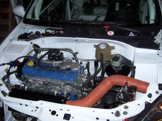

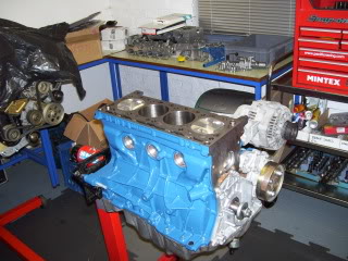

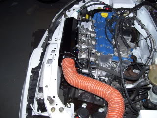

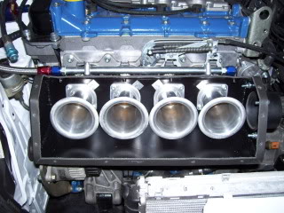

New Engine Built and Installed

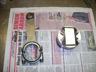

Wossner High-Comp Pistons
H-Section Forged Rods
421 Cams
Double Rated Valve Springs
3-Angle Valve Seats

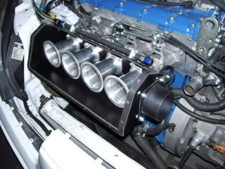

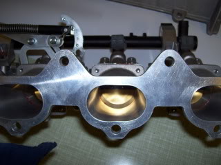

Polished and Ported Jenvey Throttle Bodies
Balanced Bottom End

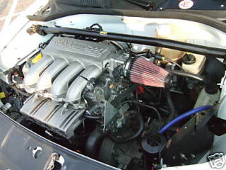

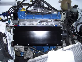

New Air Box Fabricated and Fitted
Smaller Cooling Fan Fitted and Rad Mounts Extended for Throttle Bodies

New Lighting Wiring and Switchpack
New AIM Digital Dash Fitted and Wired (new sensors fitted to engine)
Co-Drivers Horn Button

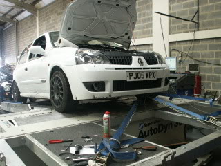

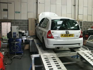

Engine Re-Map (at GDI)

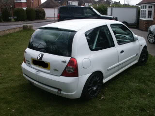

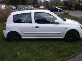

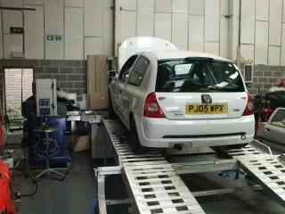

The Car As It Stands Today, Ready to Rally!: -
If anyone wants any more photos of any specific part of the car then just let me know, and I will stick them on as soon as possible!
Once the guys at GDI had worked their magic, the engine produced 221 BHP and 165 lb/ft of Torque. This was at the first time of asking, with 0 miles on the engine at the rolling road. The Sadev Sequential 6-Speed gearbox only eats up 20 BHP, and when they did the run-out test is showed 201 BHP at the wheels!! I'm pretty chuffed really, it's taken about 6 months from start to finish, and as with everything - there's always room for improvement when the bank fills up again! :approve:

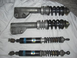

One question. The race spec suspension you removed (I'm guessing its the cup race car susp)
Why have the rear shocks got coils built into them, no seperate springs ? did you just leave the seats empty ?
I'll give you £100 for the old susp :D
That's awesome !
Coilover rear sus on race cars.
You wouldnt want to use it on a road car, its like driving with fixed rods instead of springs and dampers mate.
I was more thinking of selling it on for profit and then buying some AST's with the funds :rasp:

What power did the engine make?
Managed 201BHP at the wheels! I will be using the torque more though....!

Bet that sounds awesome on full chat going through the gears. Did you do all your own fabrication or get someone local to do it? Nice to see a car with some different ideas, is there much benefit to running the throttle boddies inside a box like that as apposed to a sausage filter?
It sounds fantastic on full chat, especially if it's coming towards you with all that intake noise ;) :D
The reason that it is in a box is that rallying tends to involve water-splashes, lots of dust if you catch a slow car etc. so it keeps all the crap out. Socks tend to let stuff like that in!

Cant wait to see the vid, any reason why the turrets where rebuilt? more strength or to make the ASTs fit?
Yeah more strength, plus I could then use BM M3 top mounts = a lot more adjustment and also a lot more strength. All in the name of motorsport! ;) :D

who built the engine and that throttle body set up?
The engine was built mainly by Iain Swan at SMD in Kent, he does a few rallycross cars and then I fitted the TB's myself. My Dad and I have done a few rally cars in the past so most of the fabrication and set-up we did ourselves!
What happened to the old track suspension? For sale?
I've sold the track suspension already - sorry! I'm currently trying to get rid of the Renaultsport Race seat, its on ebay at the mo!
