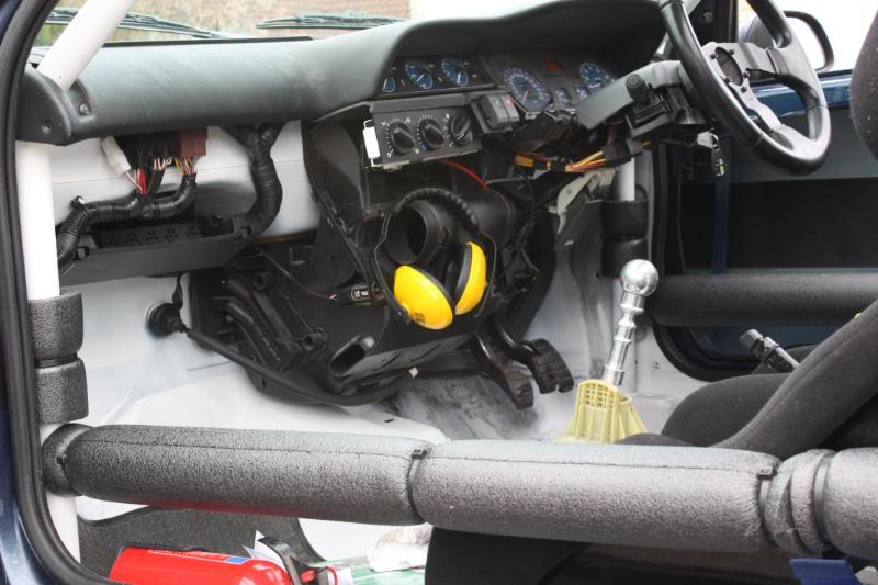

Very impressed with how the dash has turned out mate. Looks very neat but minimalist.

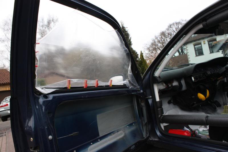

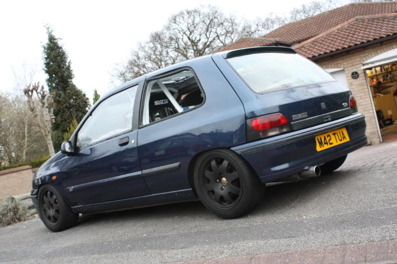

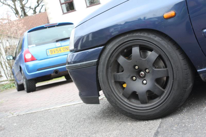

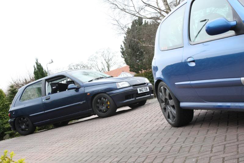

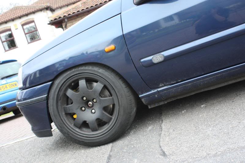

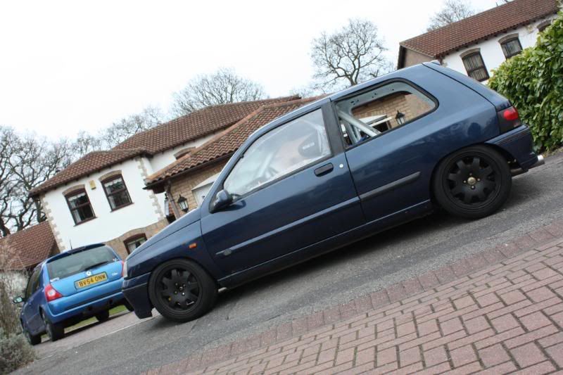

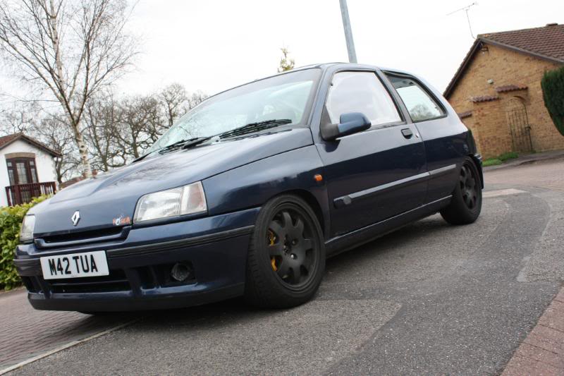

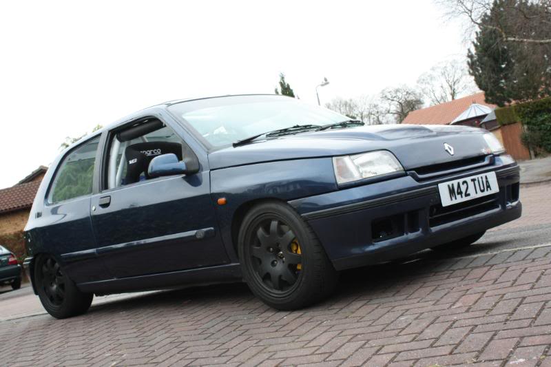

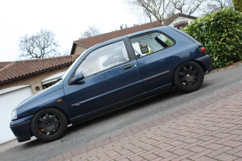

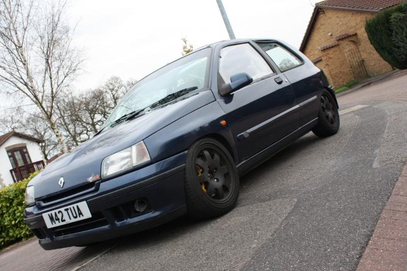

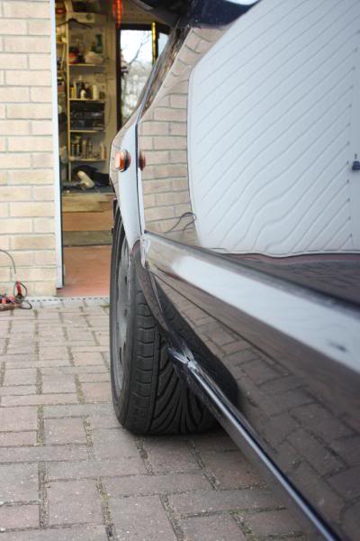

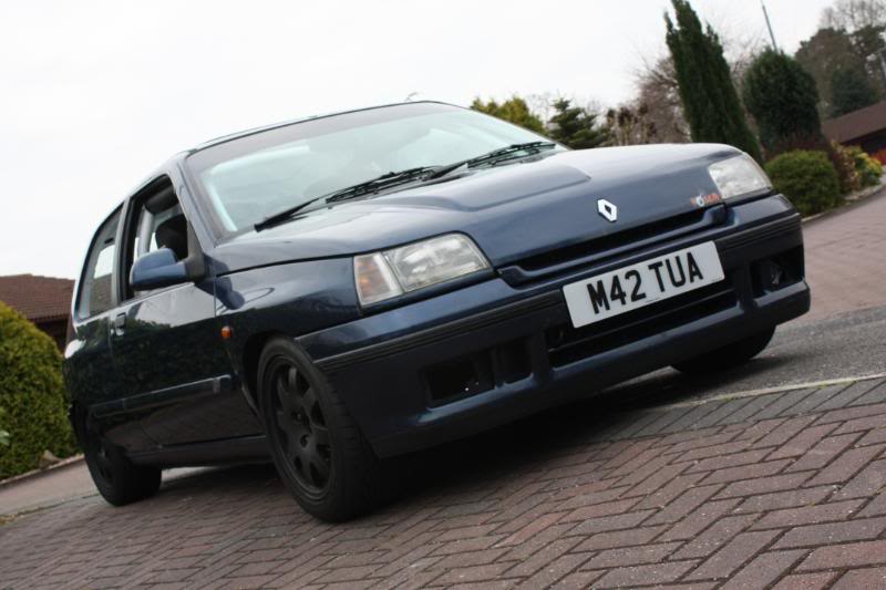

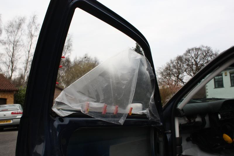

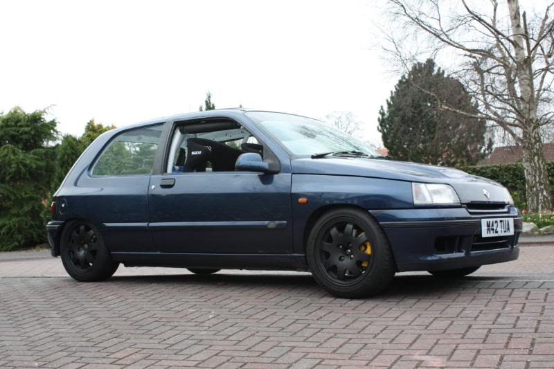

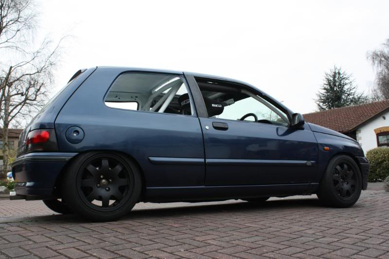

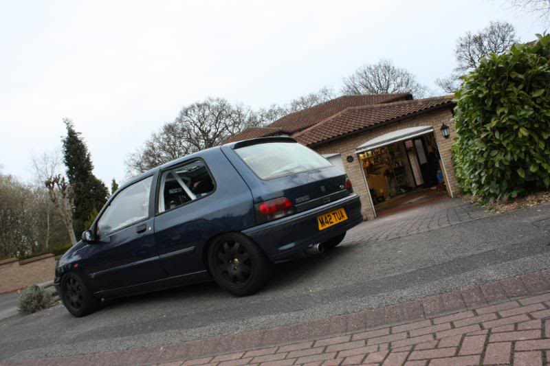

To celebrate near road-worthiness I took a few (read lots of) pics. Got the Williams wheels back on, way better IMO. One window bonded in and currently setting, hence all the rawl plugs holding it in place. One will do for now :clown:. Enjoy
Wide much?
Re: Valver Track Car Project Thread
Looking really awesome.... quick turn around too :D
Where did you get the polycarb from to make your windows and how much if you don't mind me asking? :)

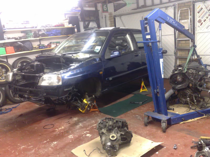

Box on and engine back in. I've been roped into Alton Towers tomorrow so will get it all connected and bolted up on saturday and go from there.
Well...
Gearbox has now been changed, point8 motorsport :clown: item in it's place. Bought some more gearbox oil as the old stuff came out like silver hammerite, put that in, all back together. Cool i thought.
Took it out for a drive and the f*cking thing still vibrates like mad when turning right as it did before.
A bit of a look around and we decide that the driveshafts are too long. I'm running 19 16v wishbones, which are the same as Williams. Quick text to the fox and he's running 172 wishbones. Measure ball joint bolt to wishbone bolt on mine and a 172 and we have 5-10mm difference, 172 being longer. Bingo. I need a pair of 172 wishbones before next weekend.
Mk1's :rolleyes:
