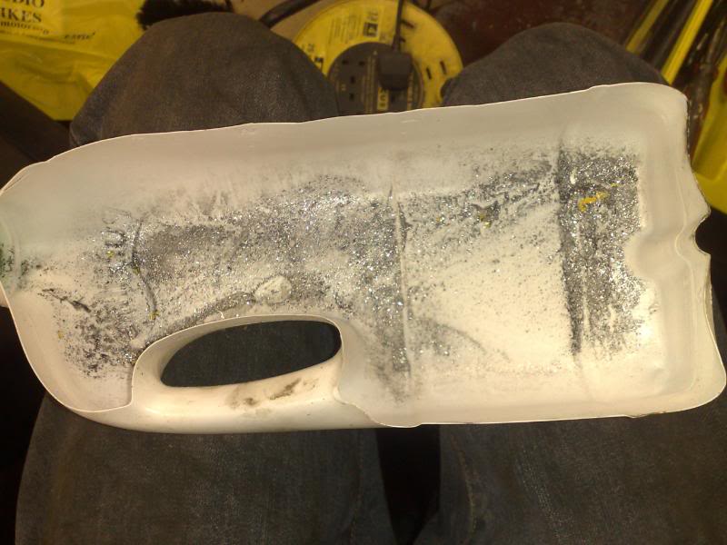

Gearbox has now been changed, point8 motorsport :clown: item in it's place. Bought some more gearbox oil as the old stuff came out like silver hammerite, put that in, all back together. Cool i thought.

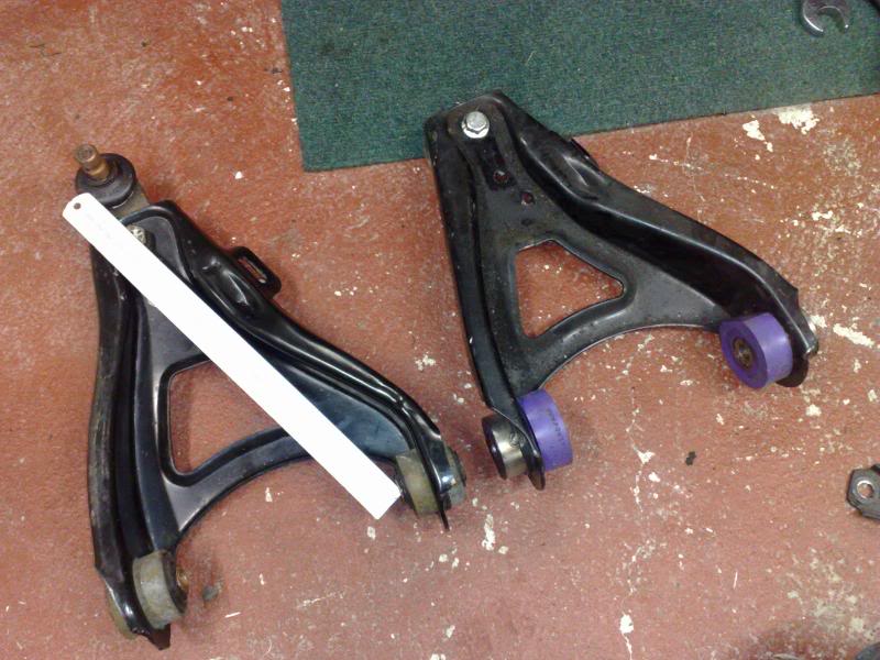

A bit of a look around and we decide that the driveshafts are too long. I'm running 19 16v wishbones, which are the same as Williams. Quick text to the fox and he's running 172 wishbones. Measure ball joint bolt to wishbone bolt on mine and a 172 and we have 5-10mm difference, 172 being longer. Bingo. I need a pair of 172 wishbones before next weekend.

All CV joints are fine, definitely length that is the problem. Although 3mm does seem minimal, that'd make a hell of a difference when it's as tight as it is.
I'll get a photo up showing the difference (praying that there is one!) between the 172 and 19 wishbones later on.

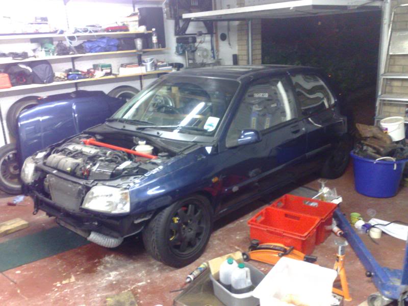

A few phone pics ive taken over the past few days but havent got round to posting:

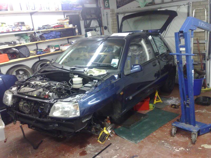

Engine and box back in having been changed

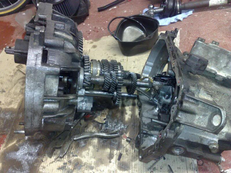

Old box, taken apart for sh*ts. The silvery paint looking stuff on the cardboard is infact my old gearbox oil. Nice!
This is what i cleaned out of my driveshaft gaiter, shavings of metal
All connected back up and dropped back down onto wheels
182 wishbone on left and 19 on the right. I did take a couple of pictures with the ruler in to show the difference, but they failed quite hard and I couldn't make the numbers out, definitely different though by a good few mm.

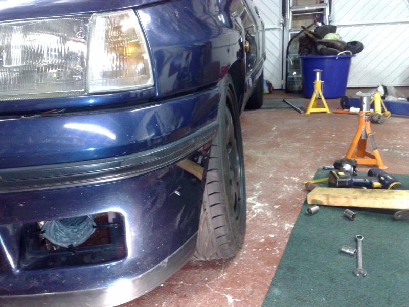

182 wishbones on. Camber much?
I've not been able to try it yet as I glued the last of my windows in this morning so I'm waiting for that to dry. Will give it a go after work tomorrow and fingers crossed it'll all work.
:hail:
