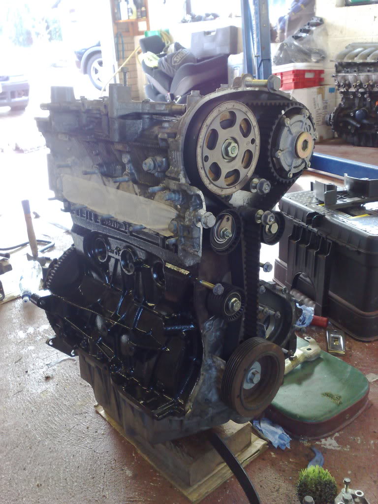

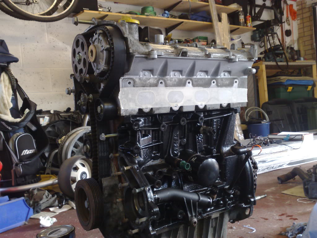

A bit more on the engine last night and today. Plenty more painting and a few other bits you'll see too.
Had a Gates cambelt kit turn up from Pete@Auto-Nation the other day, excellent service and great price; highly recommended.
f0xy is stopping by mine on Monday afternoon on the way to Cadwell and timing the engine up for me with the new belt/tensioner/idlers etc.

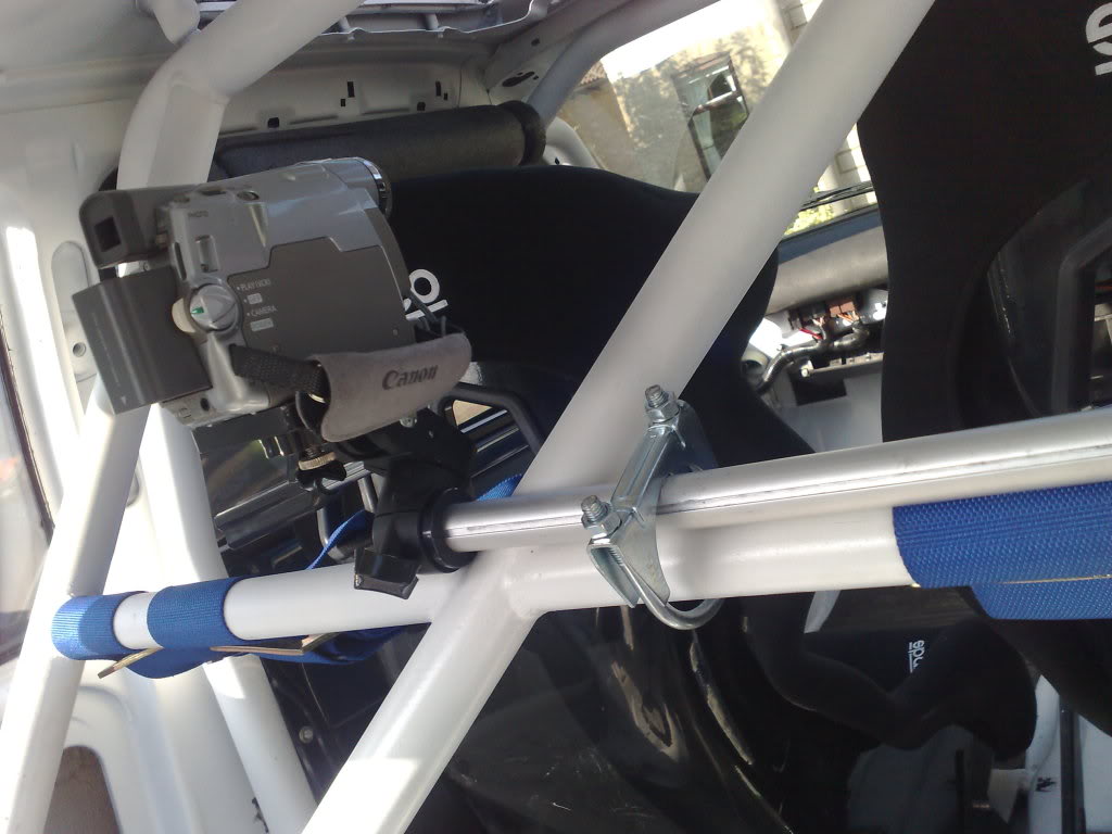

Decided to replace my camera mount due to it not being all that great before. It vibrated loads and the bloke at Cadwell last time wasn't too pleased with it. So i made this up to mount on the cage using my tripod and a couple of exhaust clamps. Hopefully it'll be better and get some half decent footage

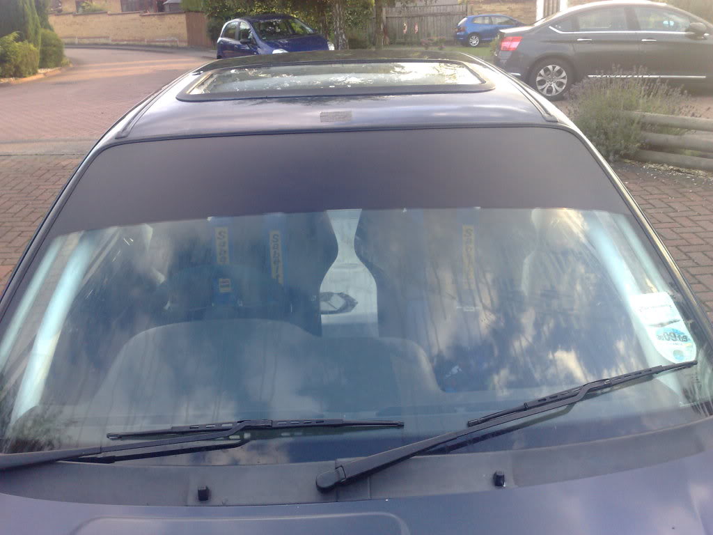

Also got a new sunstrip after having a new windscreen fitted to replace the old cracked one. Black again, but more of a satin vinyl than gloss this time, looks better. A little deeper too

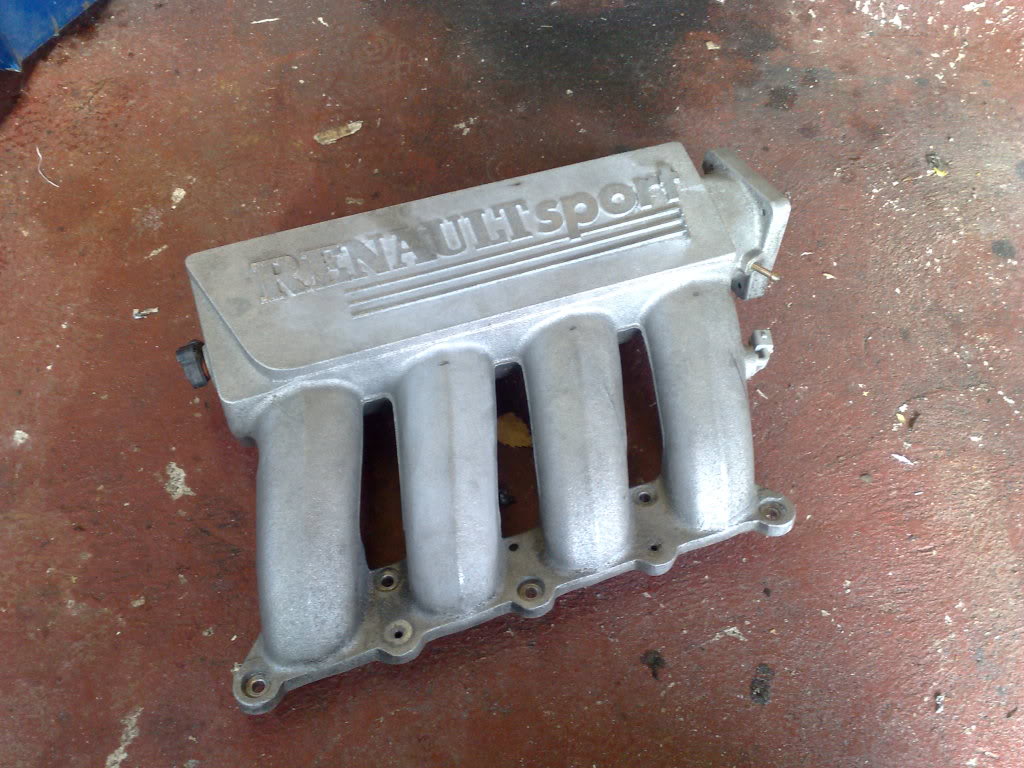

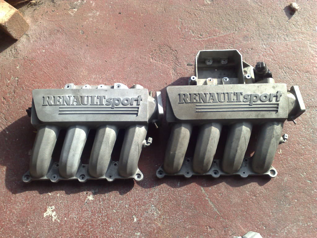

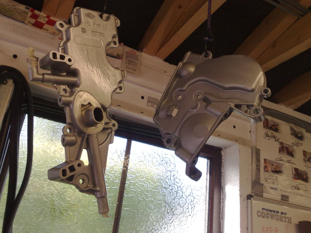

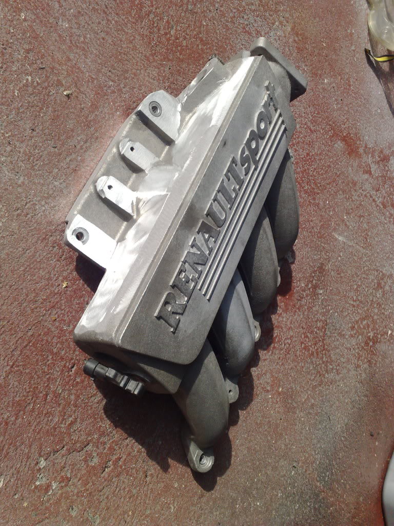

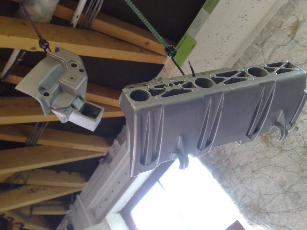

Spent a bit of time on my inlet next...
You may wonder what's different...
Coilpack bracket chopped off. Firstly because it looks crap, secondly because it sits right under the bonnet vent. I could have blocked the vent up, but I'd sooner try and mount the coilpack elsewhere, probably near the thermostat housing somewhere.
Then some paint. Stripped all the cambelt covers off in preparation for monday and painted them. Also painted the fuel rail guard and rocker cover breather
You may notice a black and silver theme appearing.
Also painted the back of the block which I didnt get round to doing before

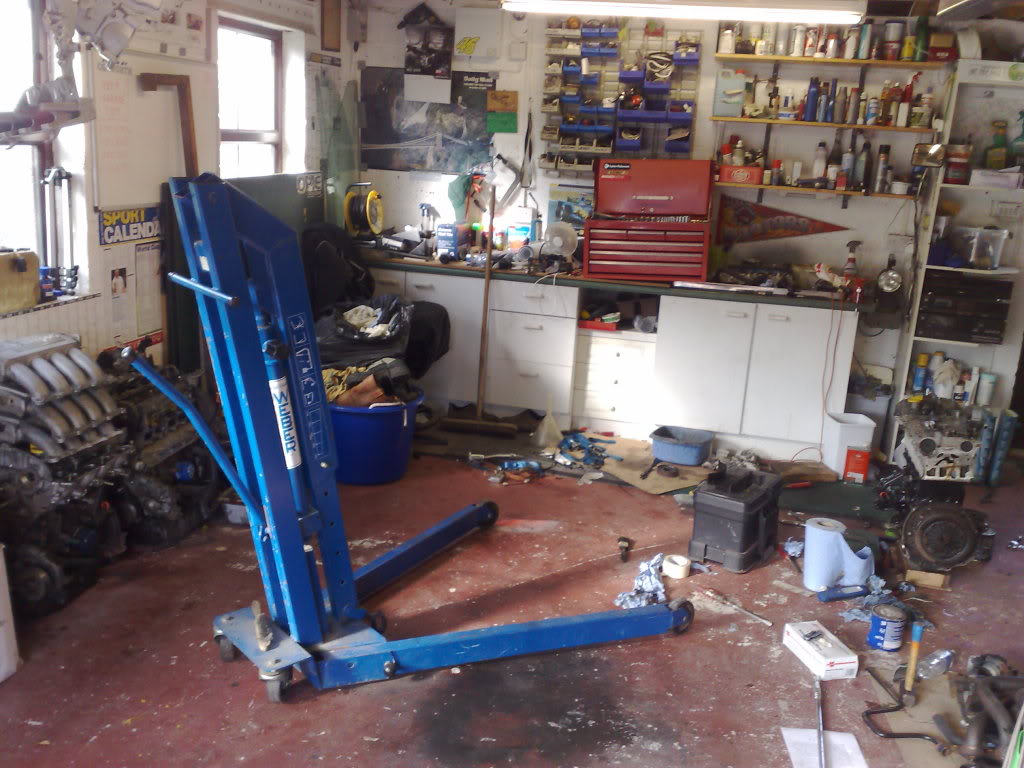

Tidy garage as always!
