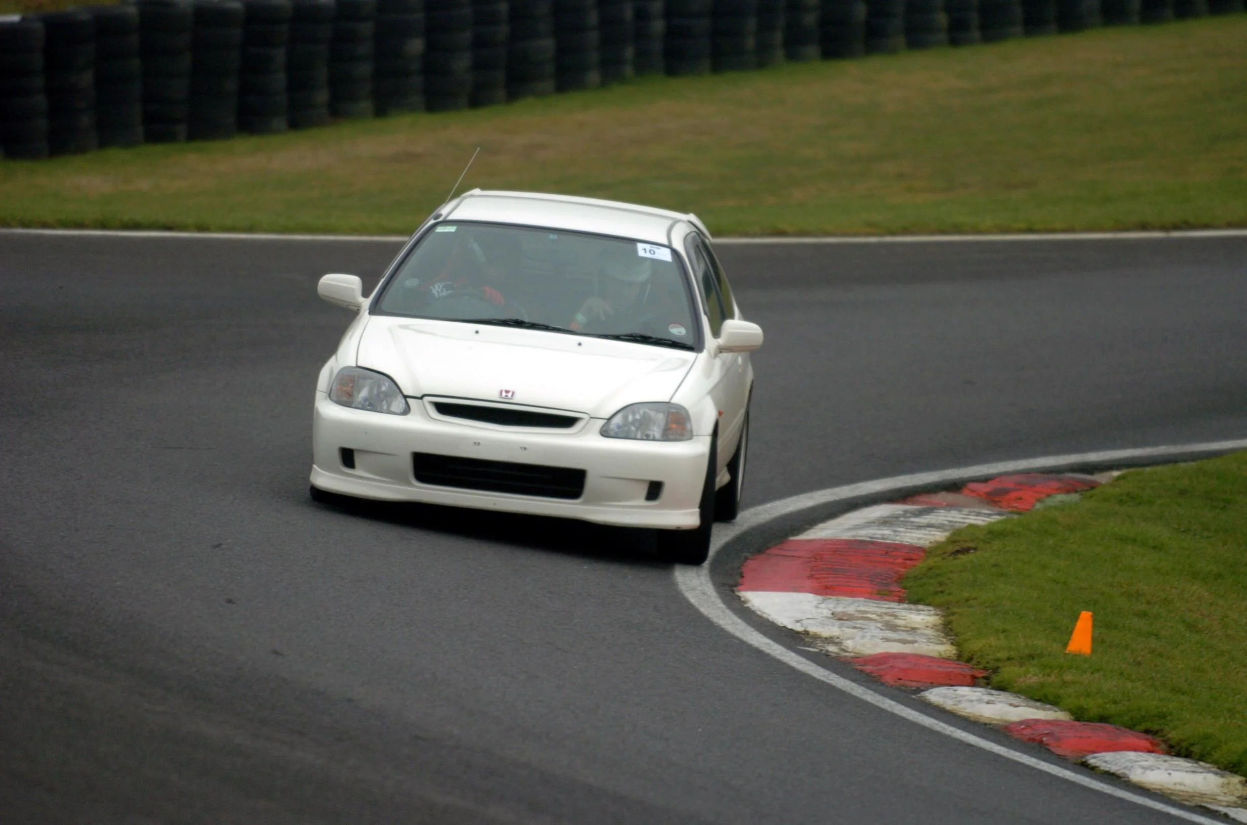

just completed a b20 engine swap into my ek9, for those that are interested the normal output of the b16b in the normal ek9 is 182hp and 110lbft odd from 1.6l - very impressive. I got some bolt ons and a gucci standalone ECU -
and it made this

not too bad seeing as we dont have 100 octane fuel here, enough for a 1:51 around cadwell on oem suspention anyway!
