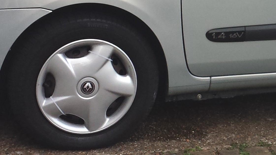

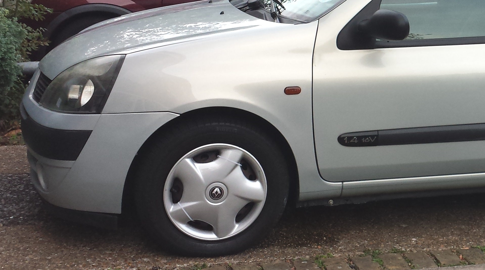

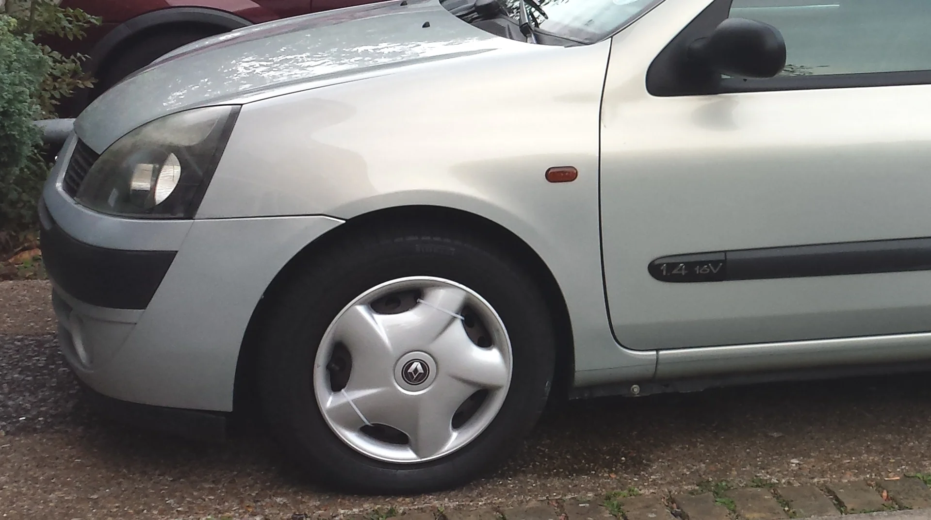

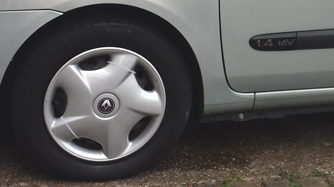

Bought the Clio (Mk2 Ph2) just over 3 weeks ago… 1.4 16v (K4J) engine, 4-Speed (DP0) transmission, trim level ‘Expression’…
Work done so far:
  1. Full valet inside & out. Including upholstery, dash & door cards.
  2. New wheel trims with Renault centre cap decals (OE 14“ steel rims).
  3. Pirelli tyres up front & Avon’s at the rear.
  4. Fitted new wiper blades & windscreen washer motor.
  5. New ‘BOGE’ coil springs front & rear.
  6. New OE lower (dog bone) gearbox mount.
  7. New CV boot (n/s/f).
  8. Replaced air filter (OE Panel filter).
  9. Wynn’s ‘valve lift’ oil treatment & Redex injector treatment.
  10. Waxed whole car ‘top to toe’ with original Turtle Wax (twice!)… Paintwork looks immaculate and water just beads off like new. That’s it for now (plenty more to do)…

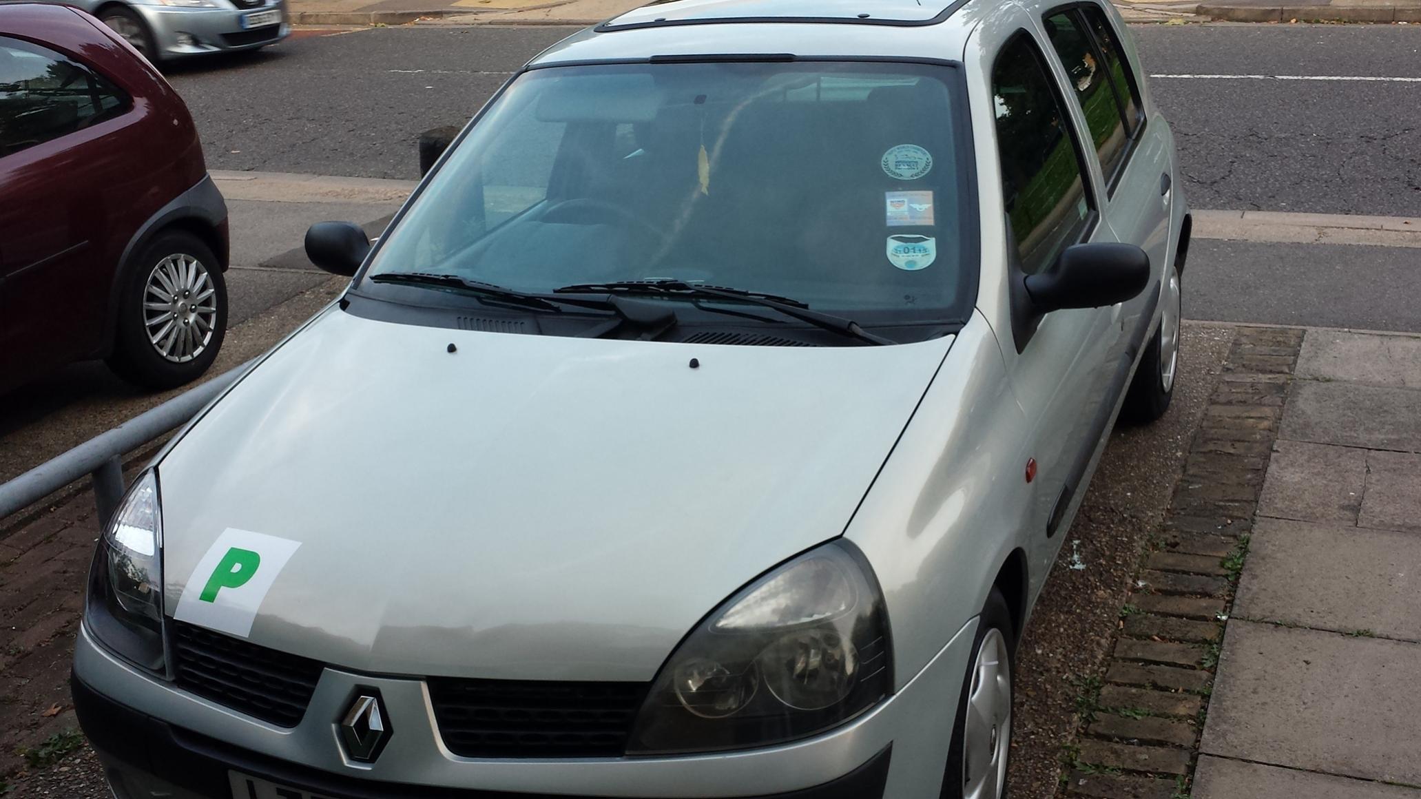

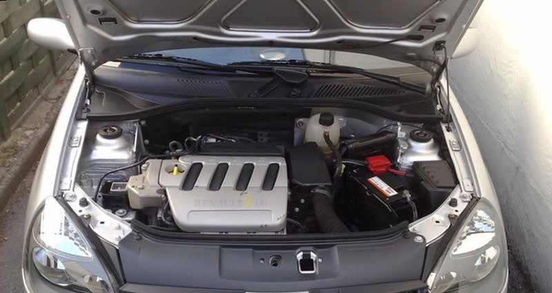

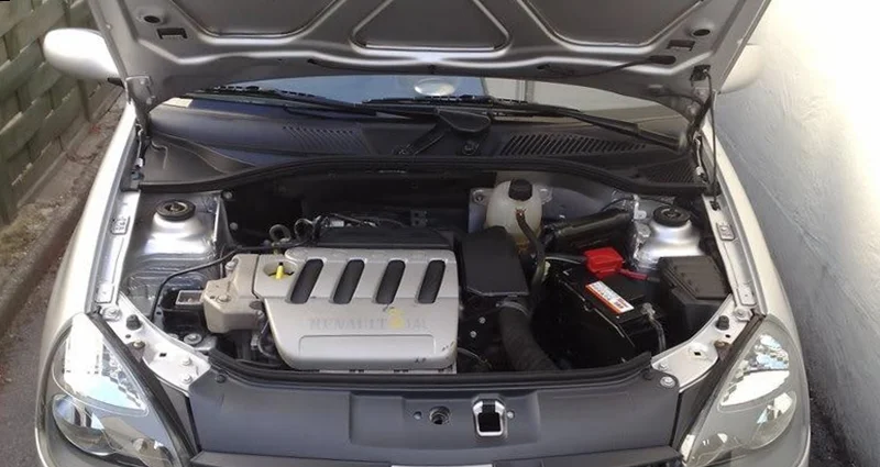

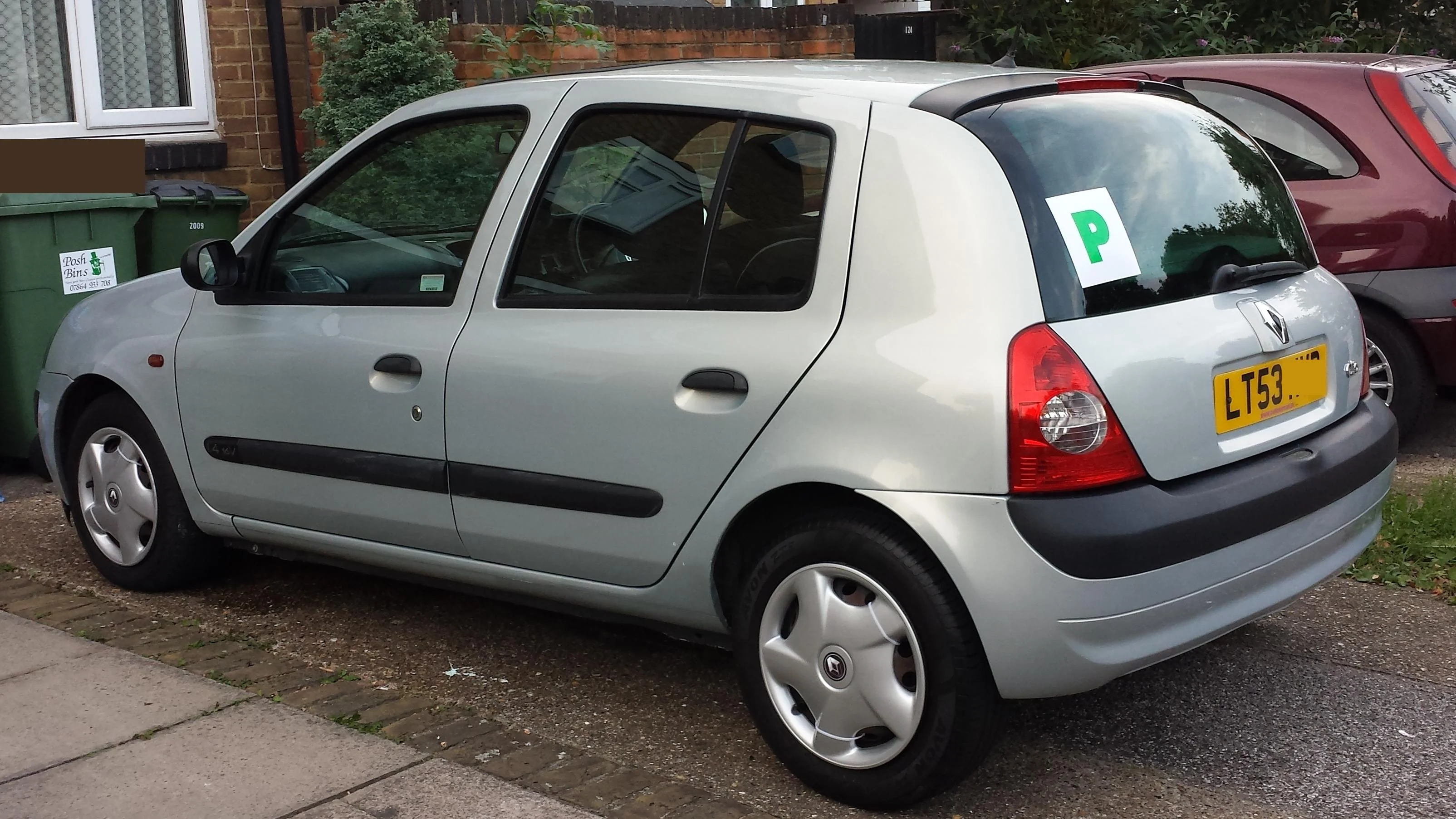

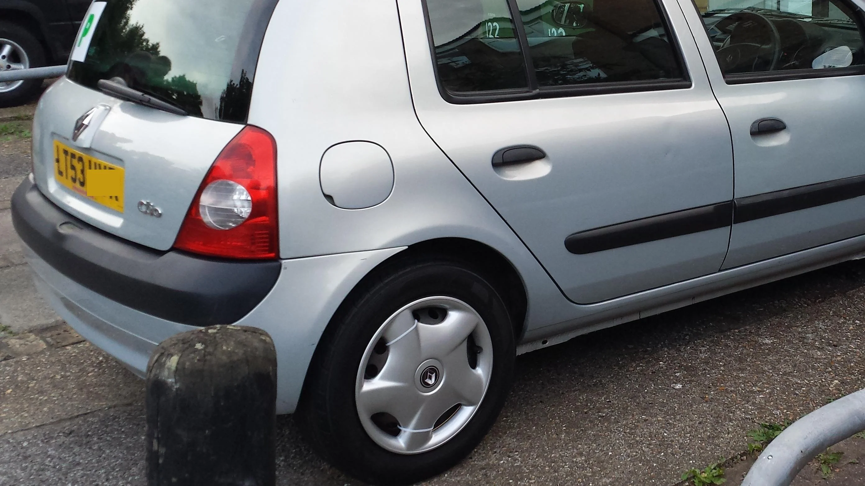

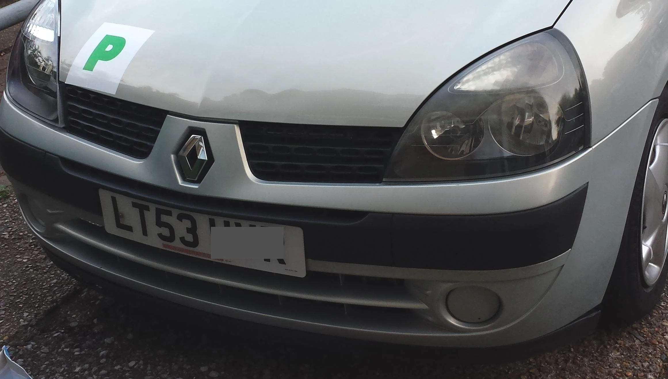

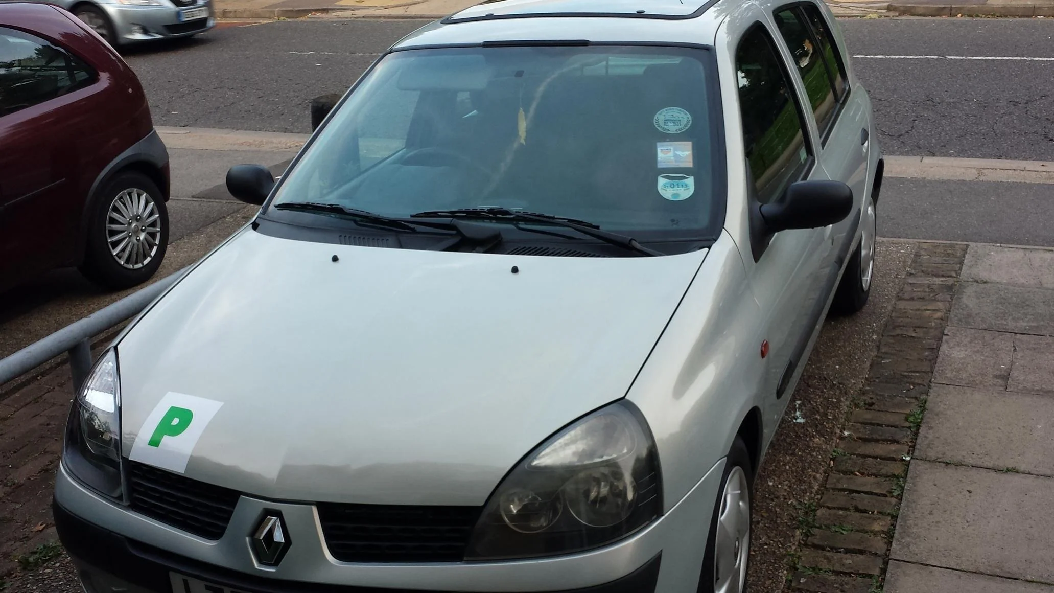

Pics of the K4J wearing ‘P’ plates below...My better half has just passed her test (car sharing!) ;)
Pics...

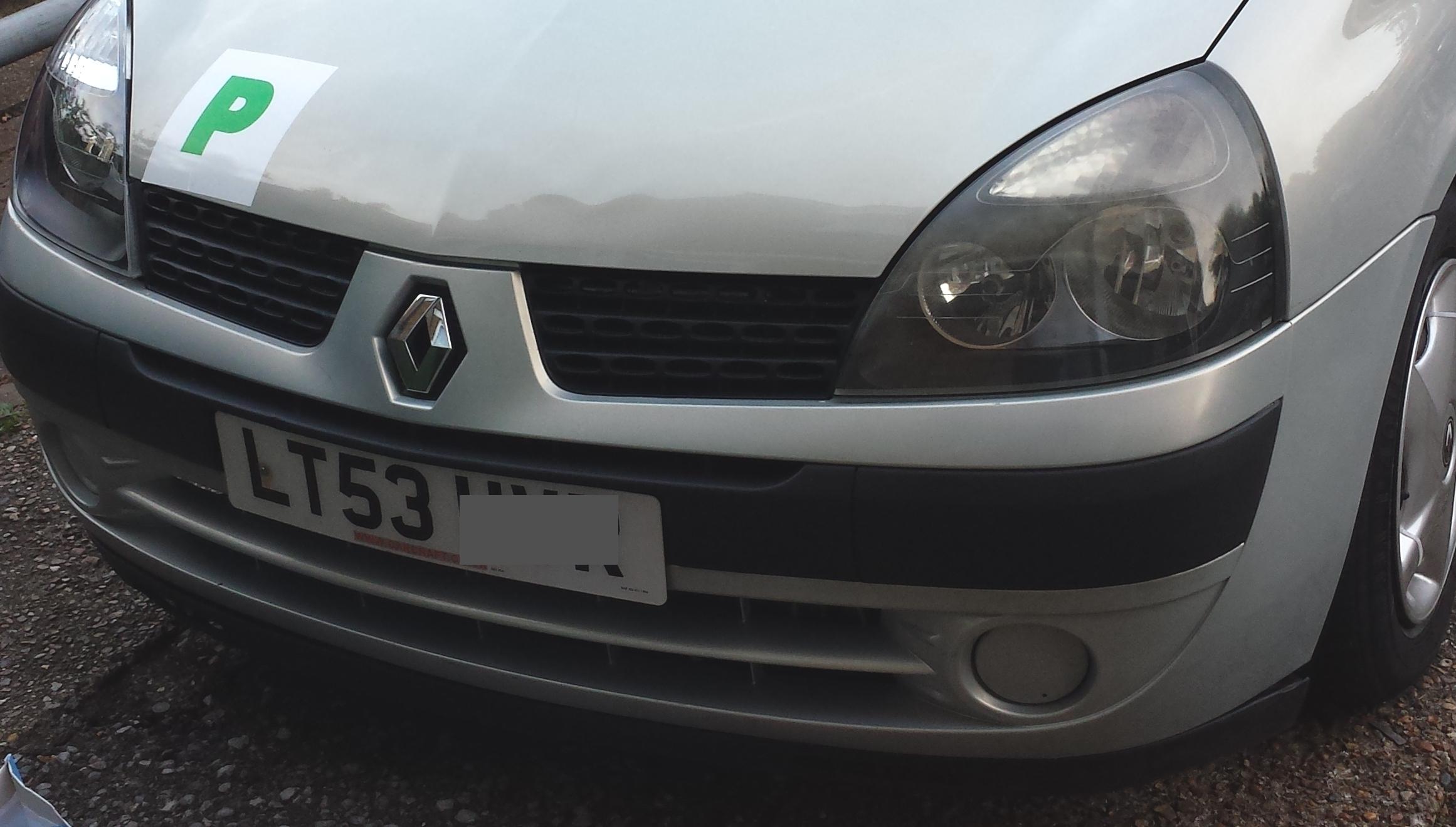

Fully restored passenger side front headlamp.. There was a rough cloudy film of oxidation giving the headlamp a yellowish brown appearance. Used 2000 grit wet and dry paper (wet) in circular motions until the surface of the headlamp lense felt smooth to the touch, then rubbed down with turtle wax 'safe cut' scratch remover several times, buffed off the residue & finished with turtle wax 'hard shell shine' wax polish to seal the lense. Amazing results, mirror finish just like new! Also t-cut, polished & waxed the bonnet. I'll get some pics of the restored headlamp & post them on this thread..

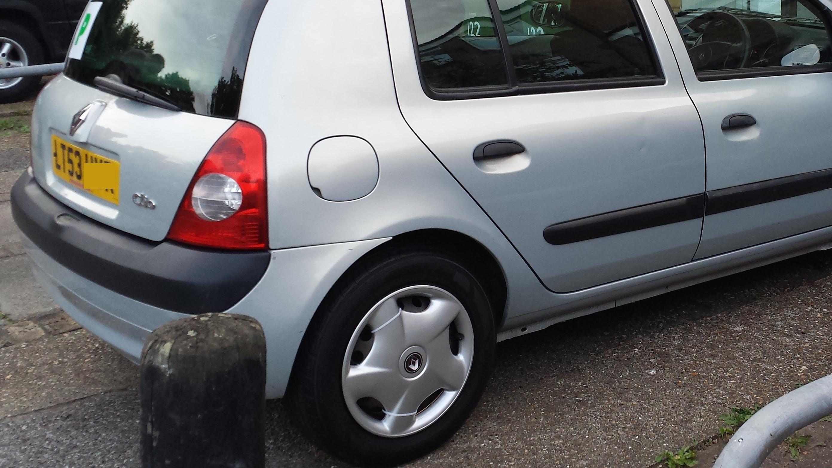

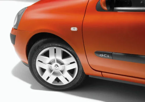

Happy with progress so far, just need to fit the new OE 'Caroli' wheel trims (above) and give all the rubber seals a lick of universal grease before the bad weather kicks in.

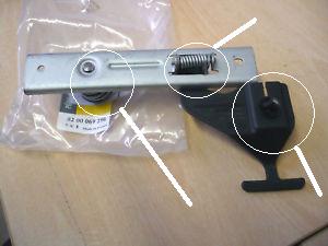

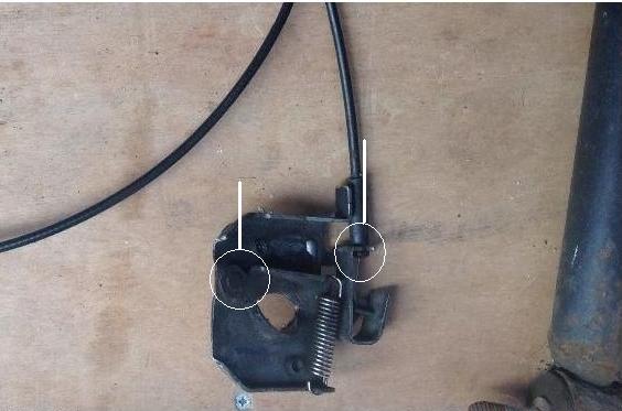

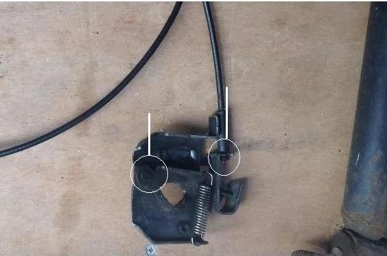

Removed the front grille (at night, pitch black with a flash light) because the grille was getting caught by the bonnet striker spring, each time I opened the bonnet.
2 x plastic rivet clips each side (top of grille) and then hand right down where the bottom of the grille 'clips' to the bumper (there aren't any clips as such, it just pulls away!). Managed to cut my knuckles to shreds, but it comes out quite easily :wink:
While the grille was off, I took the opportunity to remove and service the slam panel bonnet catch. Just 2 x 10mm bolts and it slides out from the little recess in the slam panel. Cleaned all the working parts with WD40 (carb cleaner would be better). Then coated the working parts (see thumbnails) with "DuPont Teflon" (fluoropolymer) grease... The best stuff ever imo! Although white lithium grease would suffice.
Replaced everything and refitted the grille properly (I have big issues with previous owners... all previous owners!).
If you do remove the slam panel bonnet catch, be sure to re-align it properly before you nip up the 2 x 10mm bolts! There's lots of room for play with the bolt holes because it's French.
Moved on to the upper bonnet catch. Same process... Cleaned all the working parts with WD40 then sprayed with silicone grease just for good measure, before coating with Teflon grease (as above).
Most importantly, lots of grease behind the black plastic safety catch handle, where it slides against the metal of the bonnet (see thumbnails).
Mine wasn't returning each time and it's meant to be the secondary safety catch!?

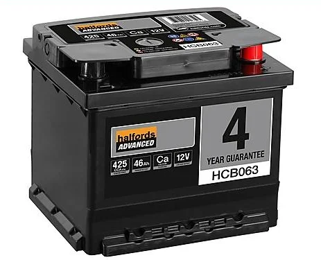

Recently had more 'starting' issues... So I bought a new battery from Hal-frauds HCB063 (Calcium, maintenance free type). Only £10 more than the standard HB063 Lead Acid type.
Fitted the new battery and clamp (properly). The previous owner had put the clamp in first! So the old battery was sitting on the top lip of the clamp, tilted to one side. The edge of the clamp and bolt were visible, so I guess the MOT guy missed it!?

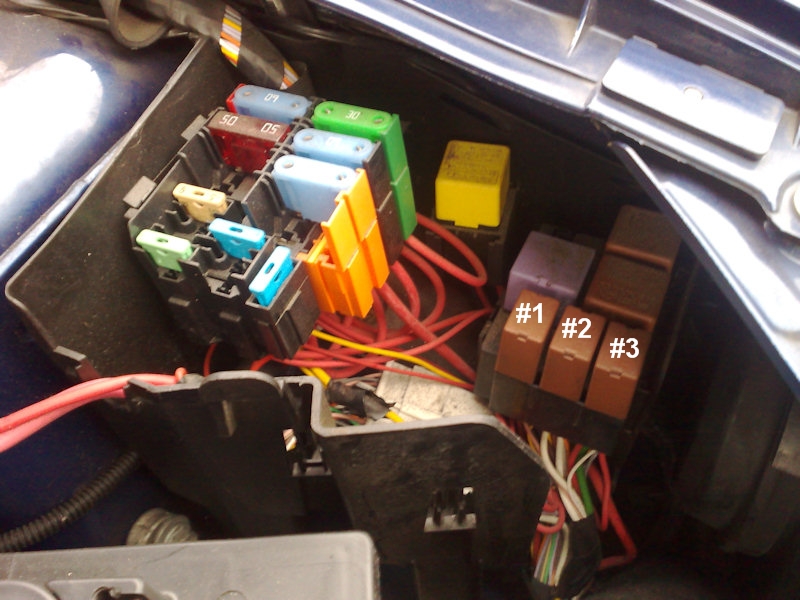

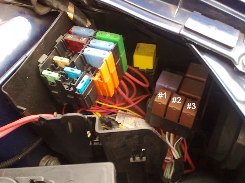

Also suspected there may have been a fault with the engine control (injector) relay.. So I carried out the following remedial procedure.
So, there are 3 small brown relays (black on some models) in the engine bay fuse box. The small relay nearest the engine is the engine control relay. The middle of the three brown/black relays is the starter motor relay and the one nearest the wing is the engine coolant blower motor relay. All three relays are on one black connector block. You will find that all of the relays pulled out will have corrosion on the pins and the engine control relay is the one that stops the engine from starting. The middle relay if corroded stops the engine from cranking and the one nearest the wing if not connecting properly will make the car overheat as it should operate the blower motor. Cleaning all the pins on the relays and the sockets (contact cleaner and a toothbrush or some emery paper), should restore operation.

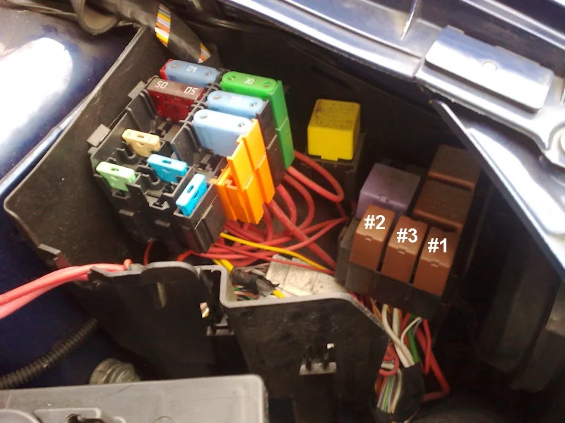

Having cleaned all the relays & sockets (as above) I replaced them but swapped them around for diagnostic purposes. Knowing that the starter relay was working properly, I placed it in the socket for the engine control relay.
Here's a thumbnail with the original layout...
And a thumbnail showing the swap...
New relays on order, just in case I still have any trouble. The OE part number for the
small brown relays'(difficult to see, until you wipe the dirt off!) is 8200263345
Lastly a pic of the new battery...
