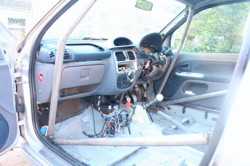

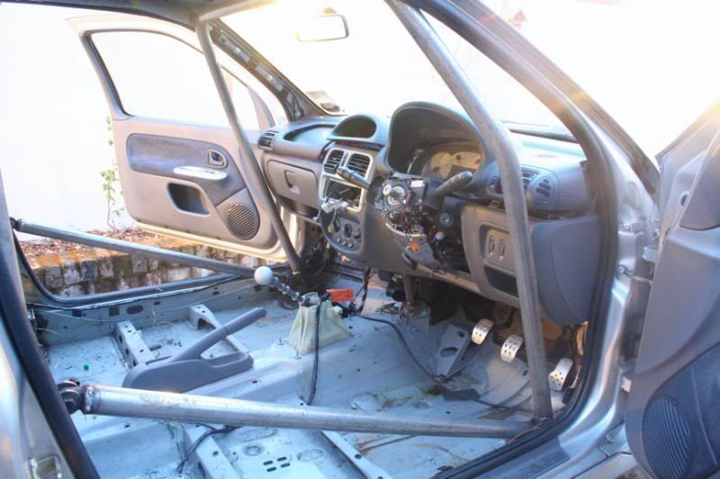

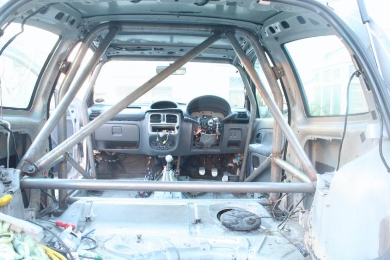

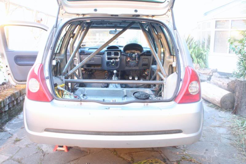

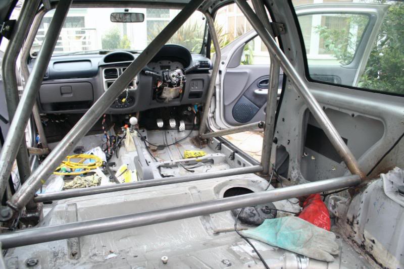

Cage is 99% done just need to tidy the welds up and run two beads round the doorbar stubs! Will upload the rest in a bit y0
  C63 AMG, F430 & 172

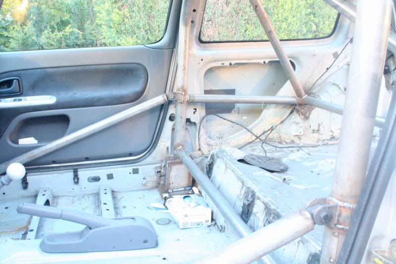

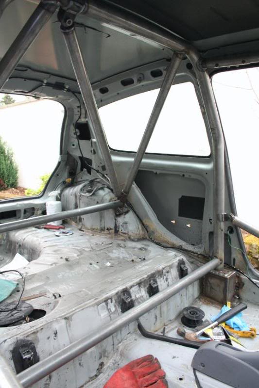

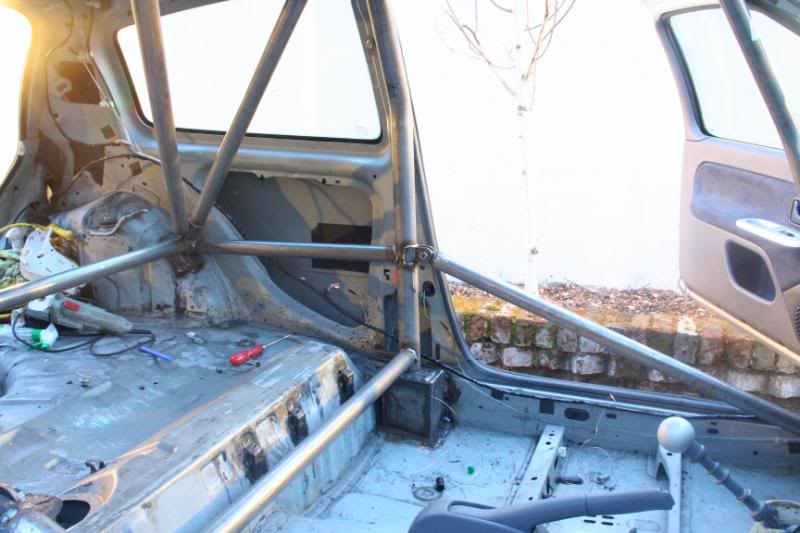

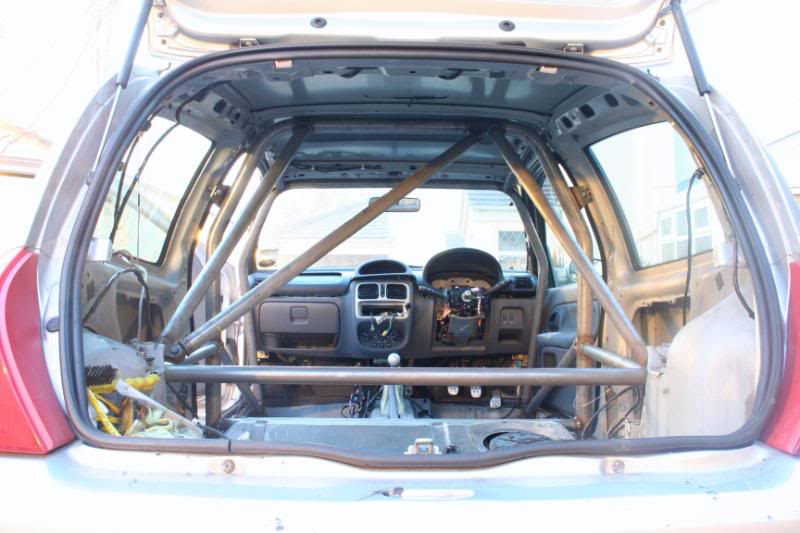

So what I did.

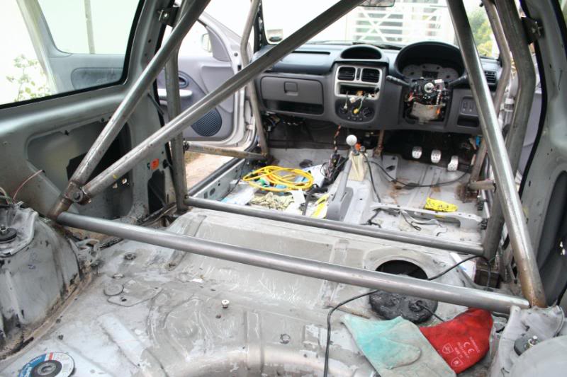

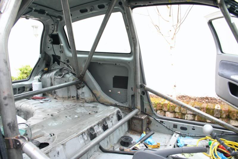

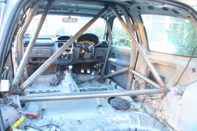

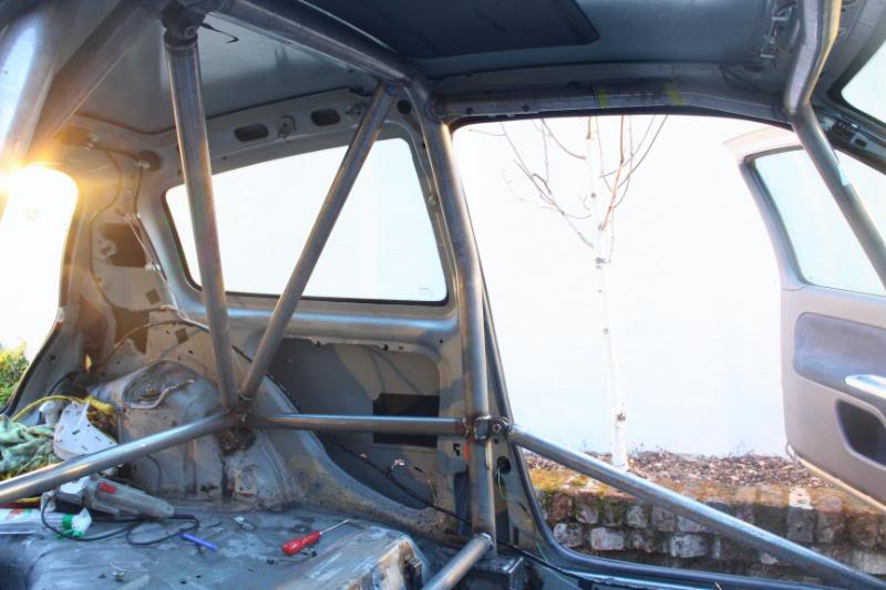

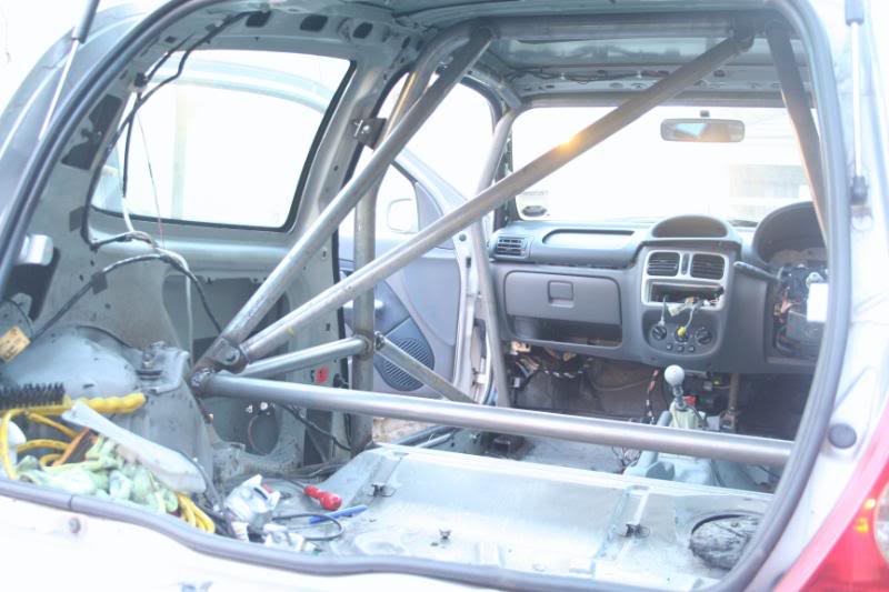

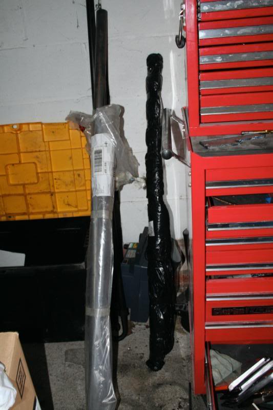

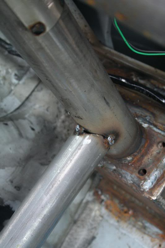

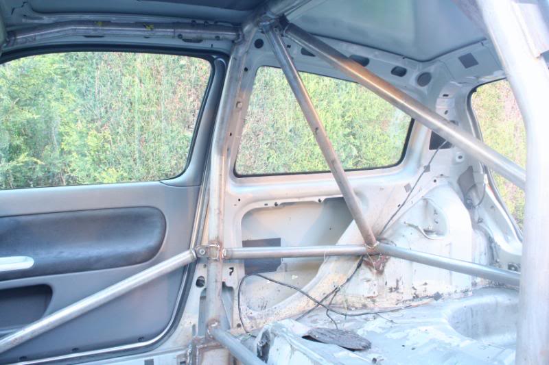

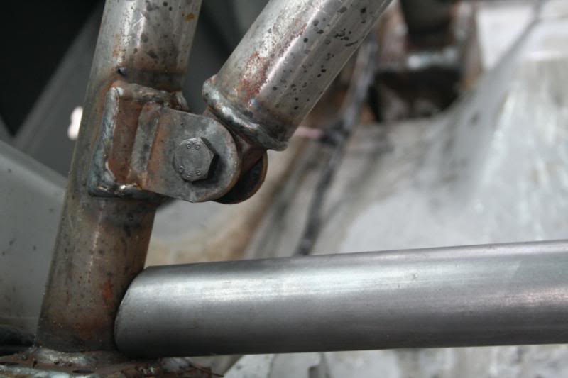

Bought 3 lengths of CDS 40x2 from custom cages, I wanted to add a rear harness bar/brace, main hoop lower support and a mid rear stay for extra support if the harness bar was ever needed ;)
Measured up the tube and profiled the ends, then I ran out of bloody gas! So i tacked the tubes in place with no gas just to hold them *shocking lol.
Few shots of them tacked in, I have no pics of the stays tacked in.
Then about 4 hours later they were all welded in and the rear mid stays had been added! MINT! Also got the door bars welded up! :cool:

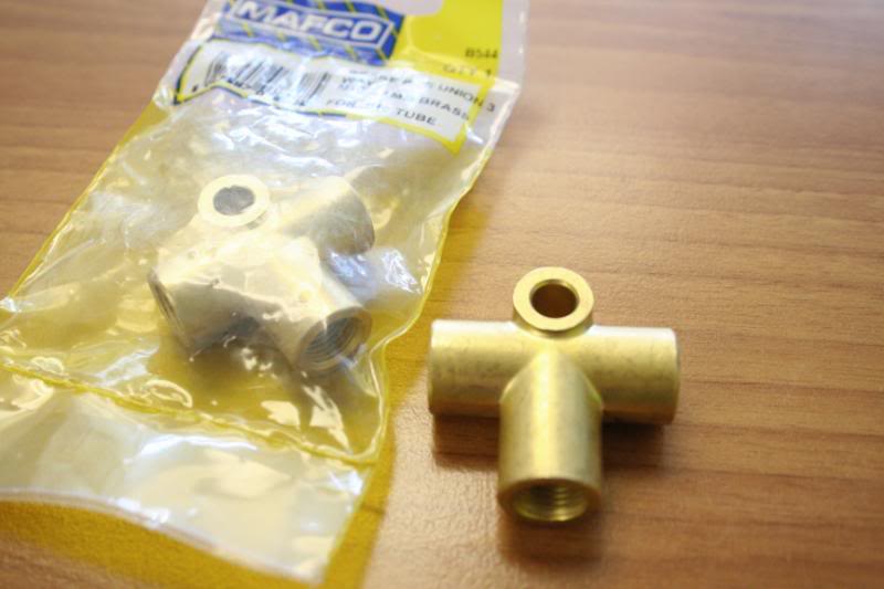

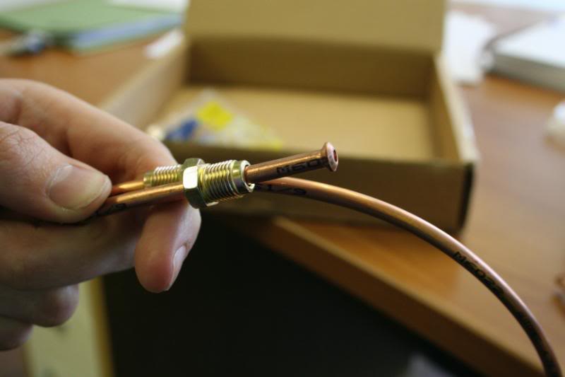

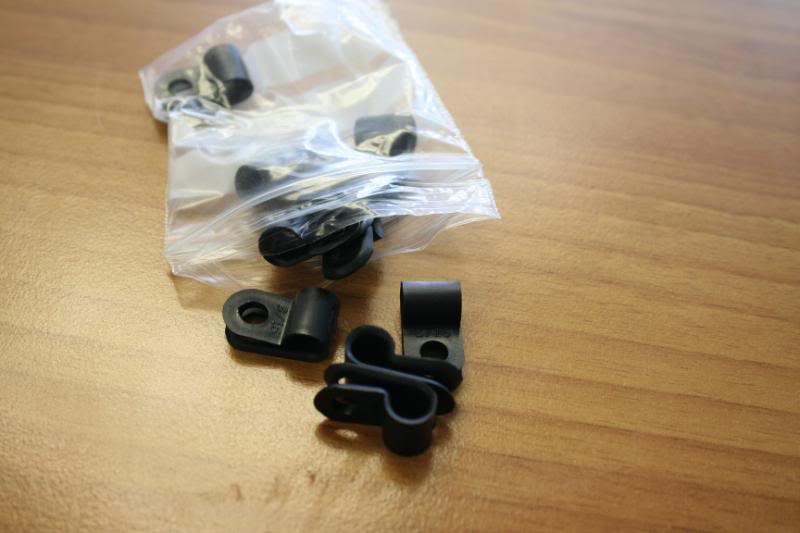

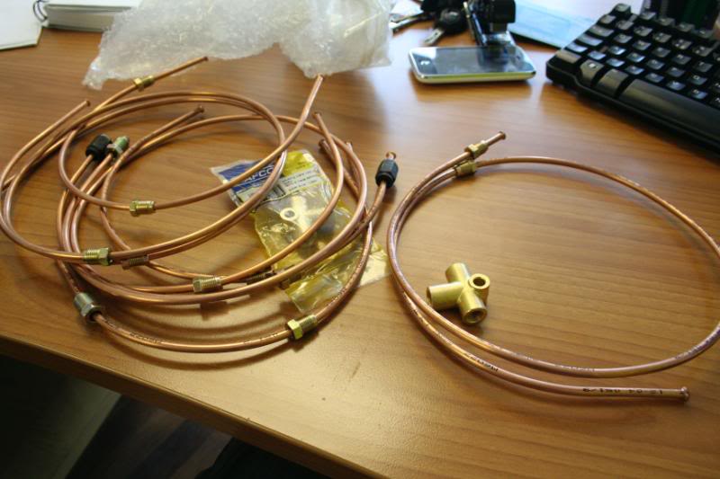

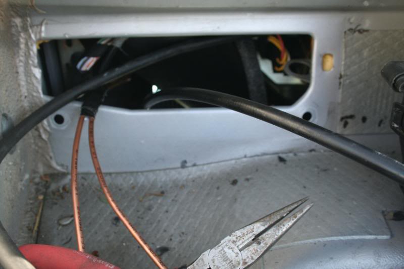

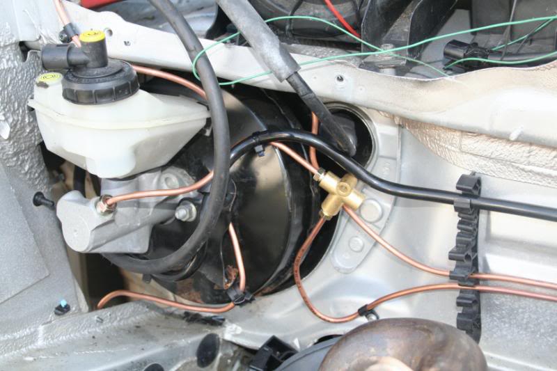

All my custom brak lines turned up with new unions for the ABS delete, also got some P-Clips and 3 way splitters
  106 GTI
cool
When I was making mine (fell through, wasnt happy) I cut 2 45 deg angles then filed the 2 points off, worked quite well although only for right angles
  C63 AMG, F430 & 172

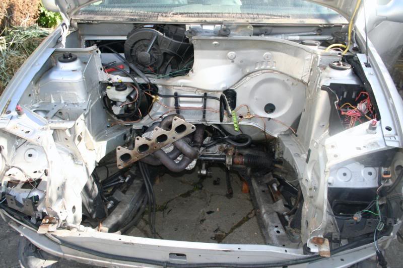

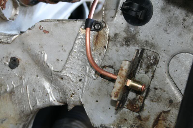

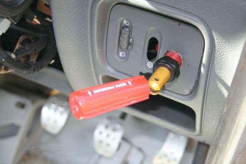

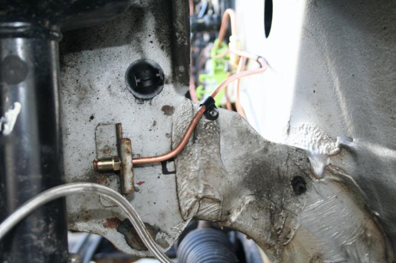

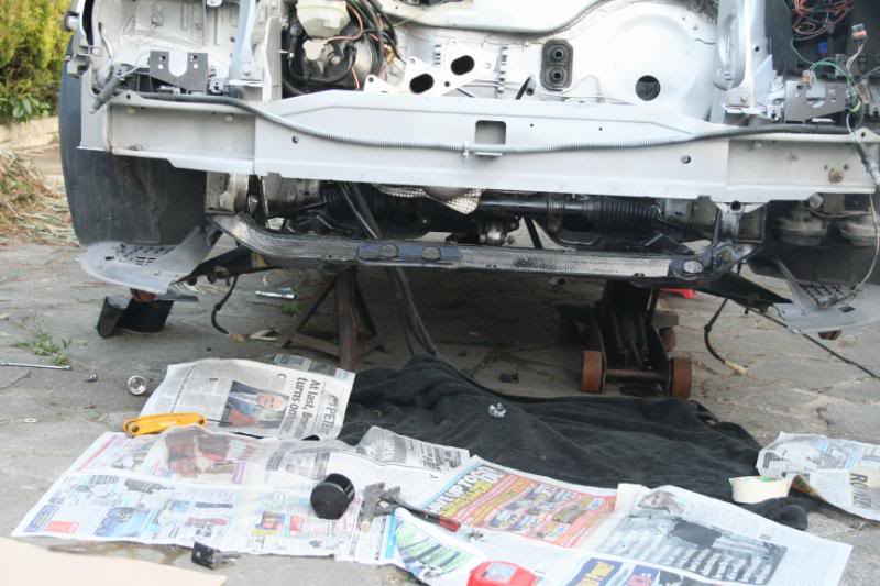

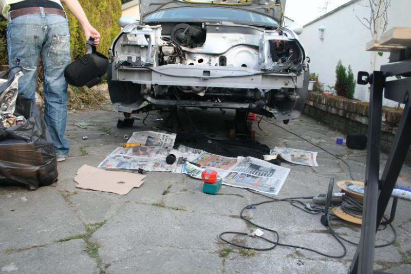

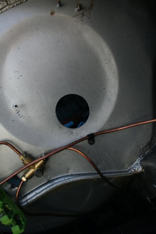

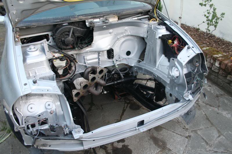

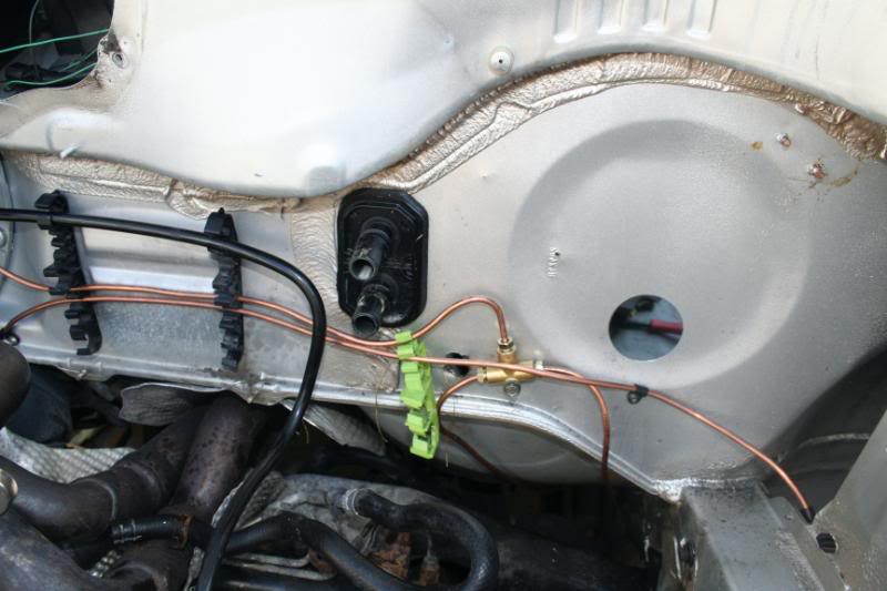

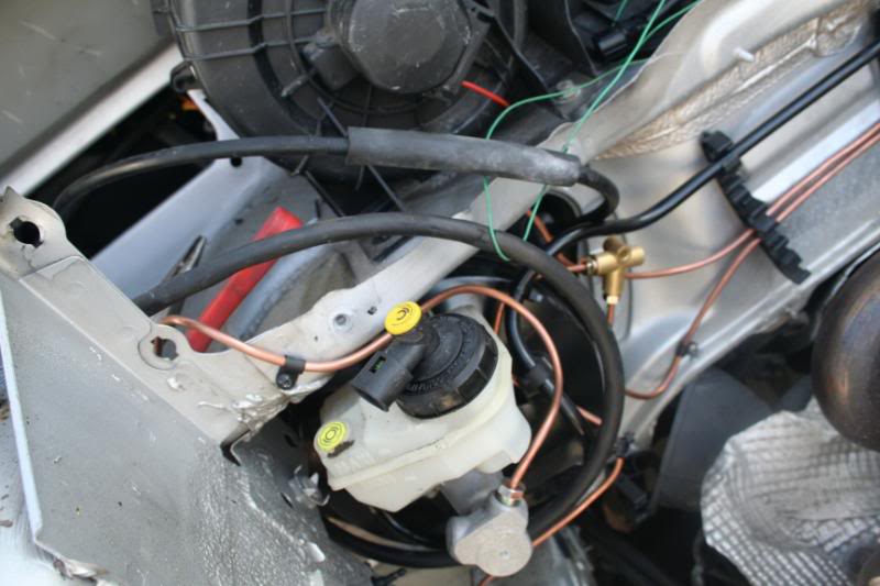

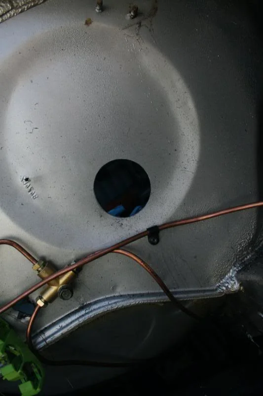

Got round to fitting the brake lines, bias valve and secured it all with P clips. Took fooking ages to get them all shaped and secured right! Still need a bolt to secure the valve to the panel. I will be changing to a screw type valve when i get chance as this one will get knocked when getting in and out of the car.

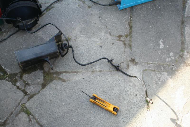

Also removed the carbon canister

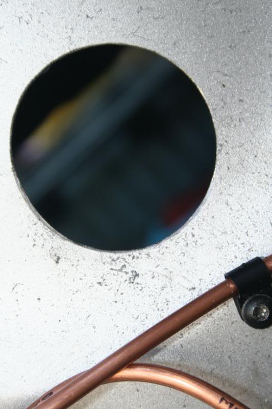

Then drilled the hole for the omex relocate to the dash ( need a grommet for it )
Removed the interior sound proof (fooking hard work )

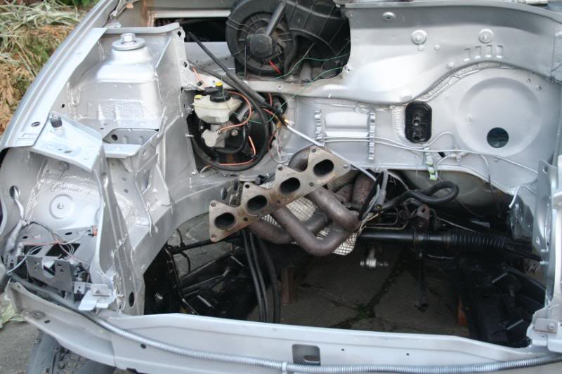

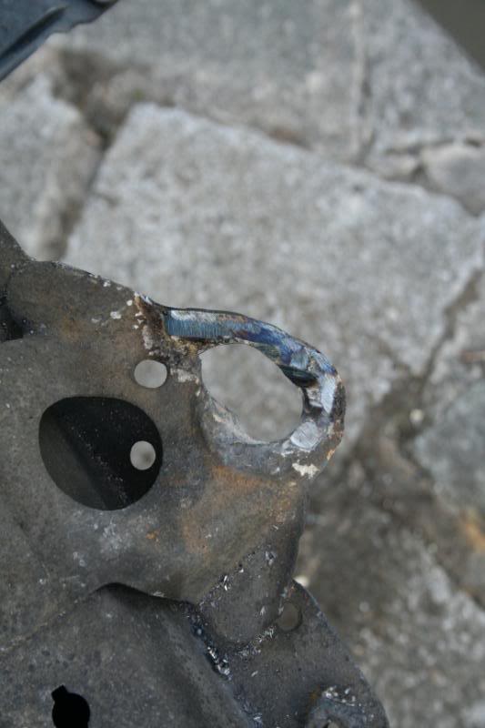

Welded up the bracket for the rad (i had to shift it 10mm to the left and the metal was looking weak)

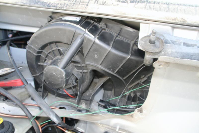

Next up was fit the 1.2 heater as i removed the aircon unit! Got it for £9 on ebay BARGIN.

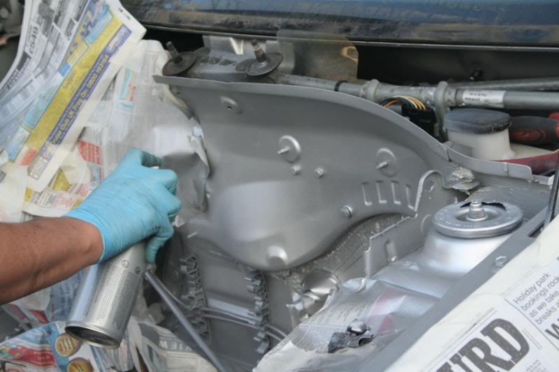

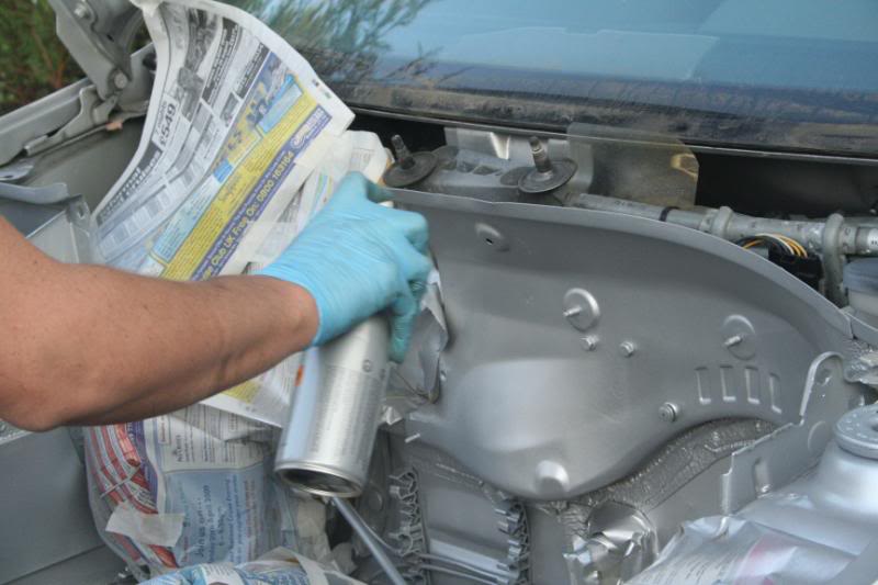

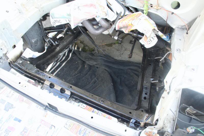

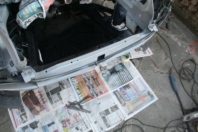

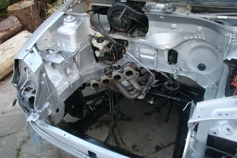

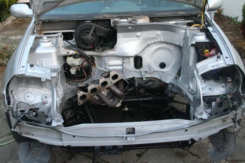

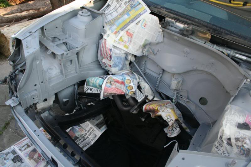

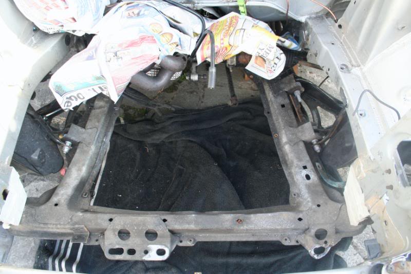

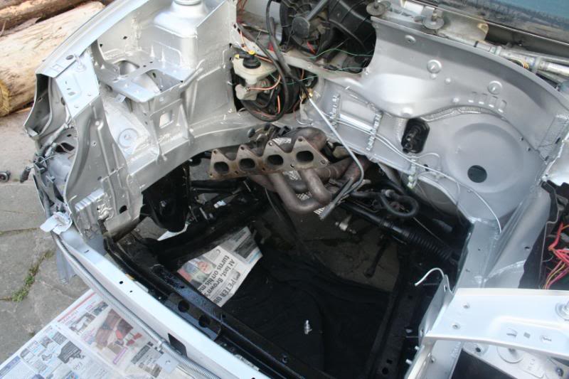

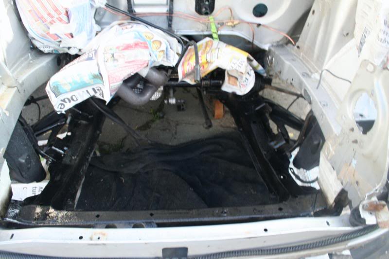

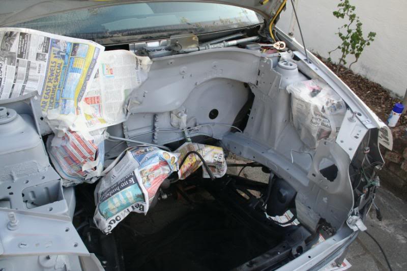

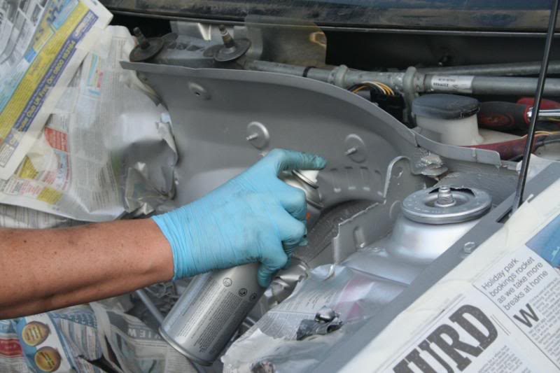

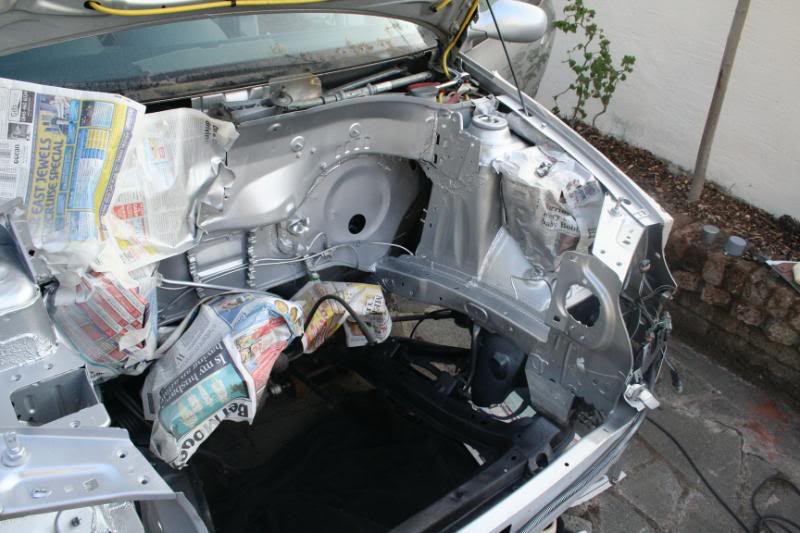

Then I painted the bay and subframe. Got a can of 647 made up at halfords, some acid etch, normal primer, panel wipe, masting tape and lacquer .
Prepped it all and gave it some love.

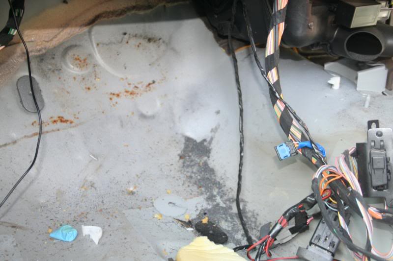

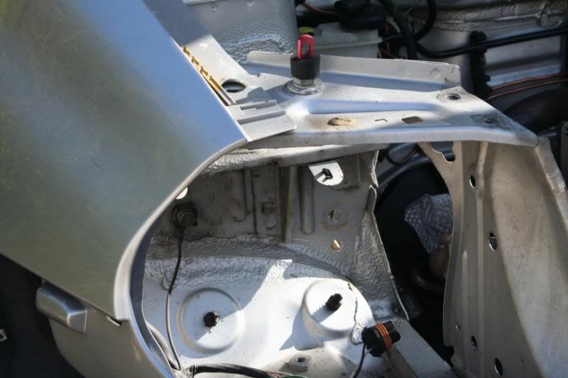

Before ( it doesnt look to bad in the pic, but it was a rite state!

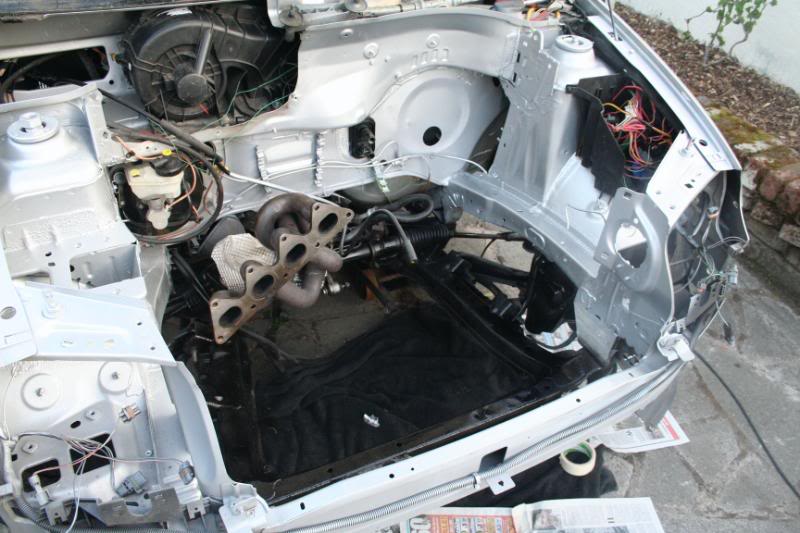

during

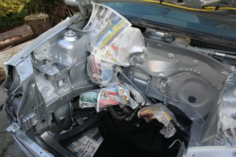

Primer on

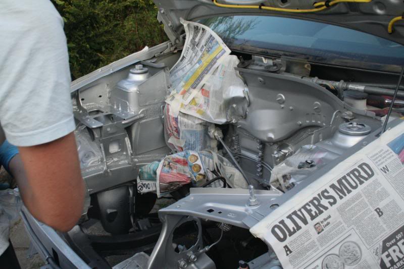

silver on
Lacquer on and job done

awersome job with the lines mate. Very nice. Can't wait to see the whole bay done if you're doing everything to that level.
  C63 AMG, F430 & 172
Aye I'm happy with them! Need to leak test them all yet!

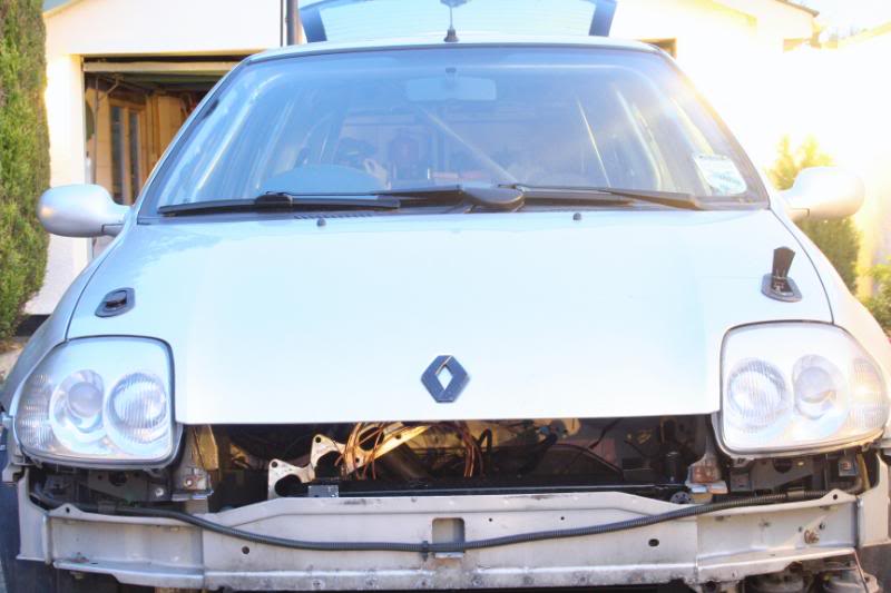

Got to get the nibus heat shield on tomorrow and seal up that hole in the fire wall and the bay prep is done!
