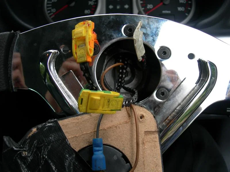

Had my momo wheel fitted today but dont like it so im going top be fitting the original 1 back on i think now as the steering seems so heavy i dont know if the garage whos fitted it as fitted it properly or not.

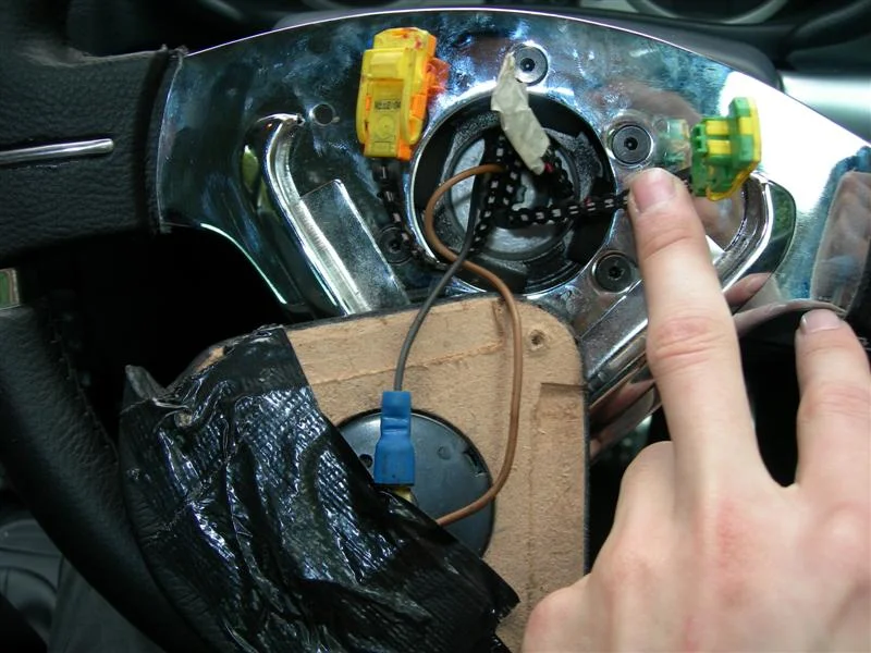

Im also unsure if hes cut any of the wire on the back.....Ive got a green plug and yellow plug connected to a sorta figure of eight cable...and the other 1 seems to have the plug taken off...any ideas on what this is for?....with it being a 182 there is the cruise control buttons as well but im unsure on which is which.
Also theres a brow and black cable which hes connected up to the horn on the steering wheel
Any ideas guys on what the green and yellow connector is for connected to the figure of eight cable also what the others for?
And how the original horn wired is there any kind of plugs connected to the brown and black cable to begin with as it looks as if these have been cut?
Also the traction control lights on and airbag lights on ....i know the airbag light would be on as ive left the resister out but didnt think the esp light would be on is this normal for this to be also?
Sorry know its long winded but worried now incase it been knackerd :dapprove:
Any help would be much appreciated....Thanks

oh dear..... that didn't work out did it lol! well on my cup (no traction) the x2 'figure of 8 cables' are the airbag ones...... the horn was red and black

Heressome pics just worried now incase it cant be put back:S
Gonna give them a ring for them to do it tomoz hopefully if it can be put back

orange and green connectors are for the airbag, the 'scabby' black and brown wires are joined to a red and black somewhere as they are not reno clours lol!!!
stop being a puff, be a man, the steering is just right lol!!! ;)

so hows the horn connected to the original wheel ?...is it some sort of plug?......as i think hes chopped some cables and want to fit the original wheel now.
Just hope to god i can get the reno one back on......just dont like the look of the tape over 1 of the wires :eek:

the horn, from memory is connected via a connector on the back of the steering wheel..... which then plugs into the back of the seperate airbag unit....
with my momo i had a connector that just plugged into the orignal horn connector block.
if that makes sense lol

Ahh ok ....the wheel i had just had a a metal stalk thing which is why hes made up a cable to connect it up........Do you think it can be put back?
Also anyone have any ideas as to what the other connectors for with the tape on?
Thanks mate

other connectors must be cruise, as i dont have them on the cup lol

You've got an ABS light as you've gone and knocked the wheel sensor out of allignment Cups don't have it hence Gt_gaz had no trouble. This is the same why ESP is on.
Serv light is on since the ABS and ESP systems have resistered a problem with the stearing sensor and it needs to be fixed.
Some of the swicthes are for crusie control.
