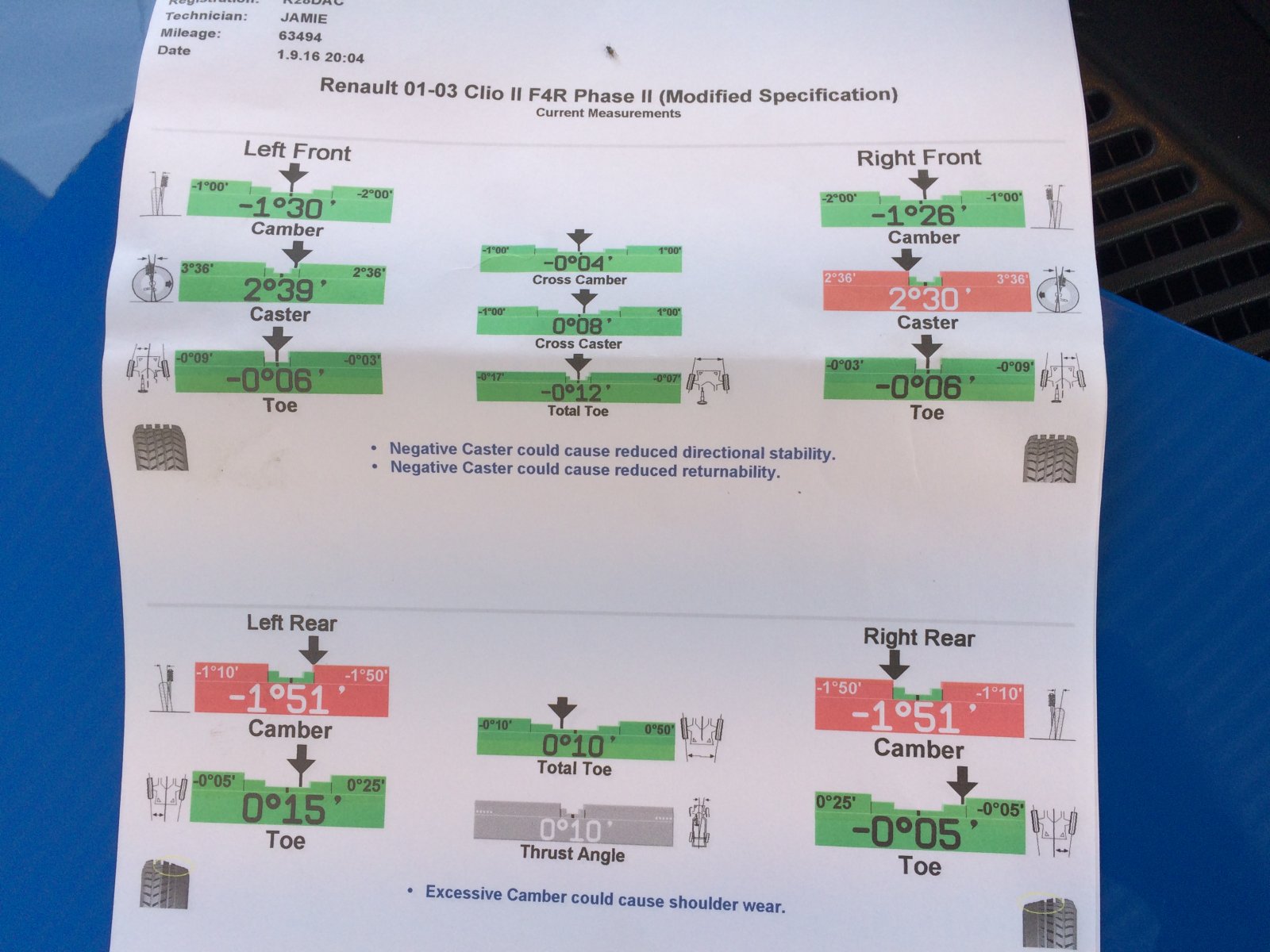

Has been in and out of quick fit 4 times now and they can't seem to resolve the pull...even though I've seen them align it up spot on against factory settings to be approx 0.06 toe each side. Camber and caster readings were tolerable.

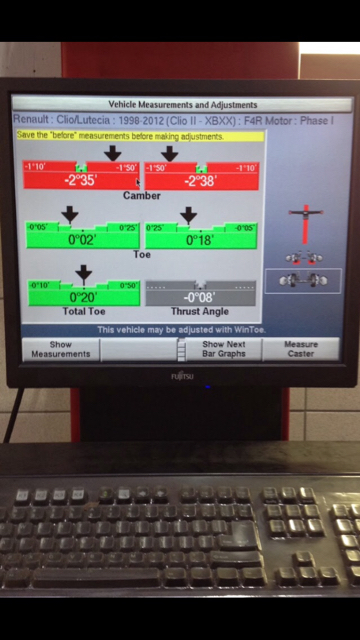

Cheers bud. This was mine the other day..

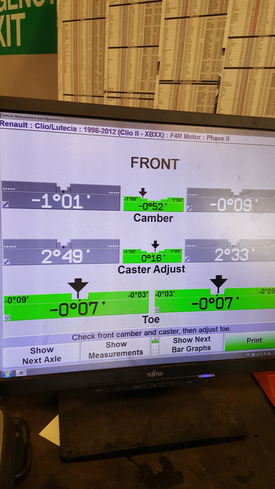

Only toe is adjustable, is that right?
Would need camber bolts to adjust camber I presume?
And castor, no adjustment possible there?
Need to get my facts right before I get my alignment checked......thanks!
