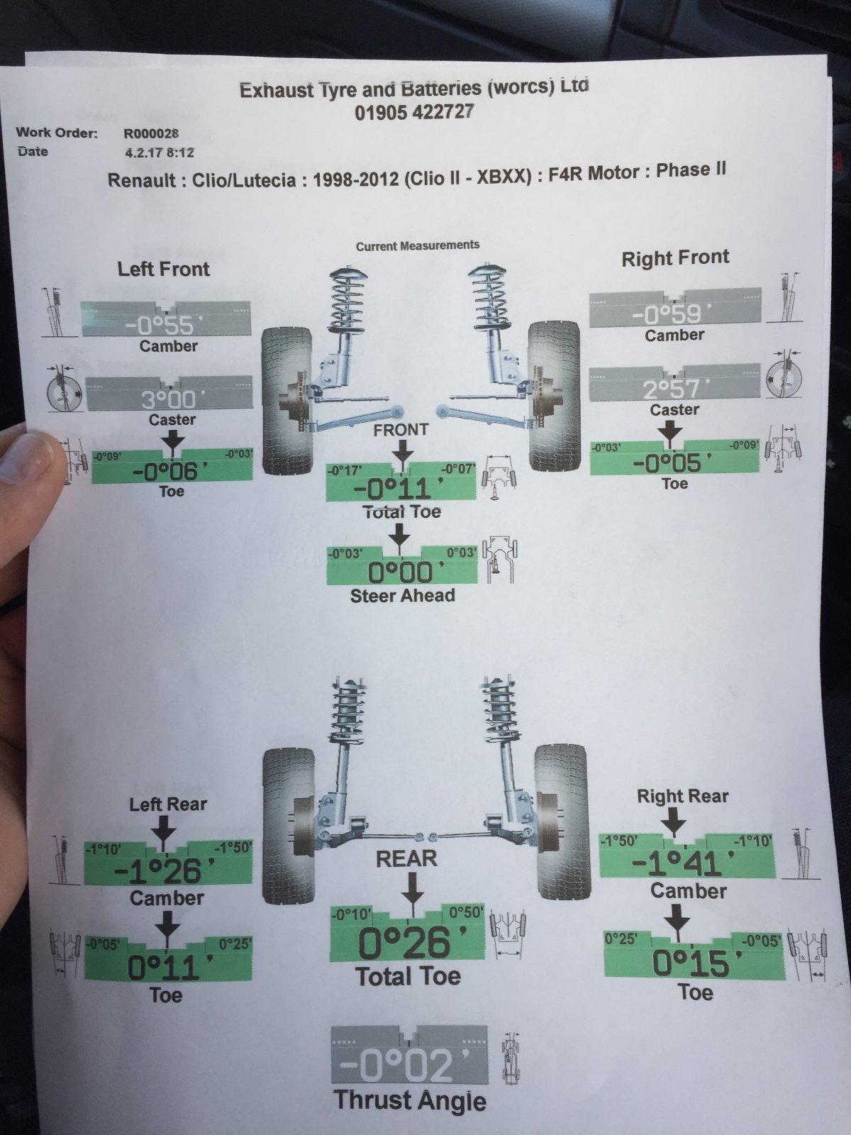

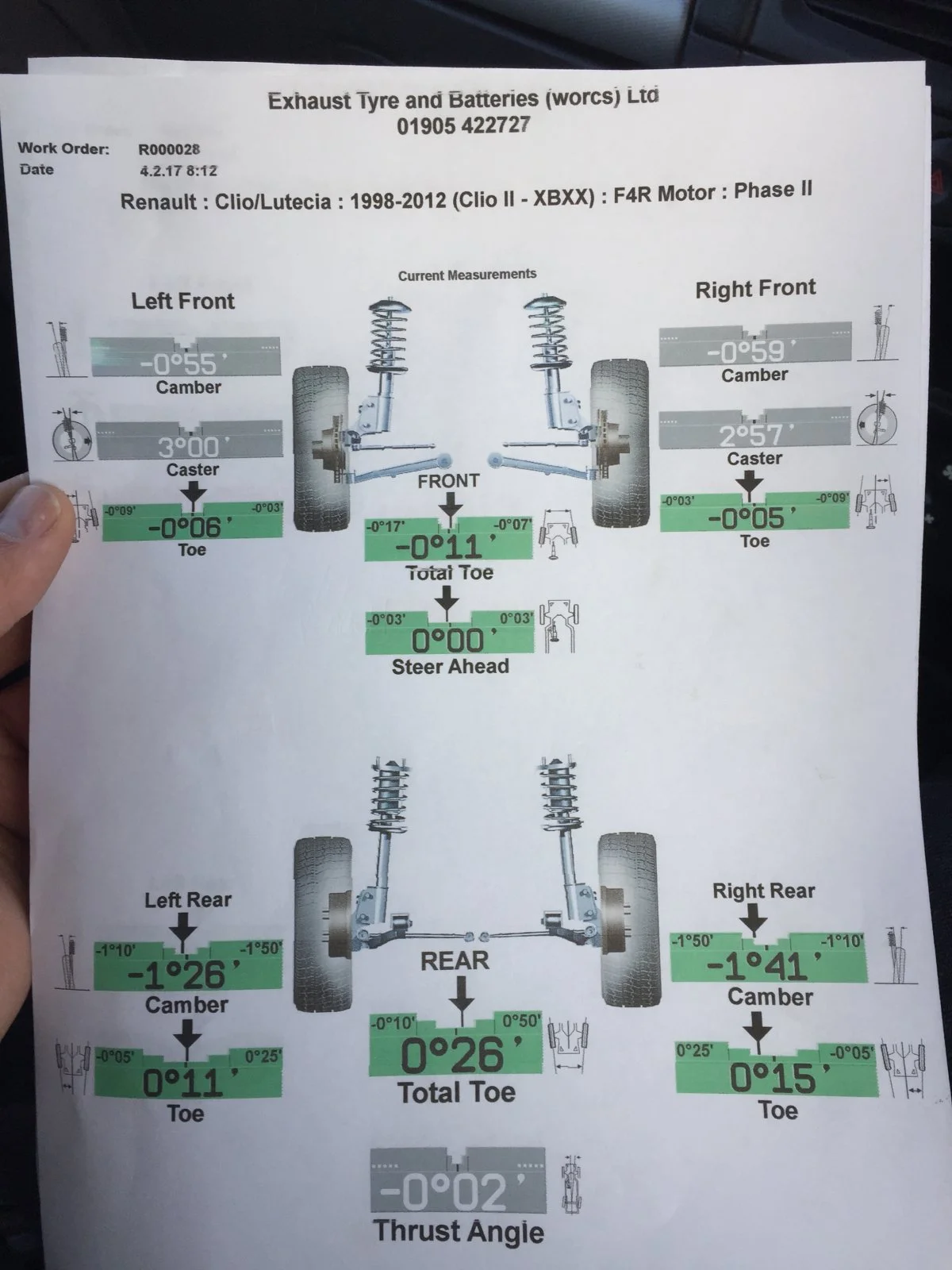

Just took my car for an alignment, asked for -2 camber and 5minutes toe out and got what's said on the print out. the guy said he could only get -1.5 Camber, but that reduced when he put in the toe settings. Now I'm confused cos I've paid £60 and have hardly any camber. Should he have kept on adjusting until the right settings were sorted??
Ps, I've got bilsteins, pms top mounts and camber bolts on a 172.

Take it back and ask for it to be adjusted if you haven't got what you asked for. You've asked for 2 degrees, and been told you could only get 1.5 and drove away with 1.
Assuming your camber bolts an accommodate 2 degrees, the eibach ones I have are up to 1.75

Some garages allways say this, I assume because they can't be arsed with the hassle.
Is it a road car?
Thank so for the advice. I take it to get the right settings takes a bit more time to fine tune.
I'll be paying them a visit

One possible explanation is tie rods have become thread bound in the track rod ends before the toe setting was attained, and the neg camber was reduced so that the toe out could be achieved.
This could be because the wrong length inner tie rods have been fitted, or the track rod ends are after market & not threaded for the full length.
I'd go back for a more thorough description of the problem.

One guy said the camber bolts were turned as far as possible, then they made the toe adjustment. He said they won't go any further for neg camber, so doesn't know why I'm back.
Before I go to a-line to prove them wrong, and demand a refund, can someone tell me I've got it set up right. My Camber bolts are on the upper of two bolts on the strut, is this right?

I have the eibach bolts but I'd assume they are the same....run 2.5 degrees, on max negative camber just over 3 is achievable, with 10 minutes toe out.
Before adjustment the steering wheel wasn't straight, So when the steering wheel was straightened one wheel was toe out by 30-40 minutes and the other toe in 30-40 minutes. I think they set the camber at this point to max which was -1.5. They they changed the toe, and obviously didn't re-try the camber.
