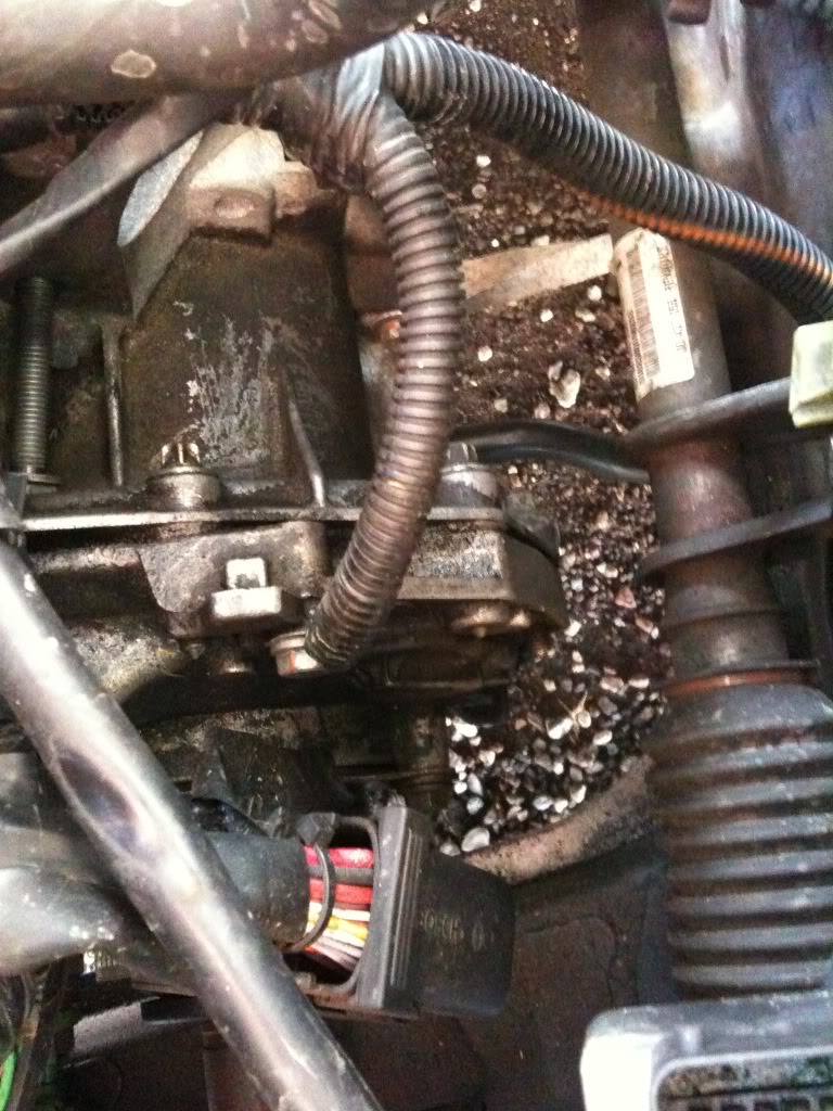

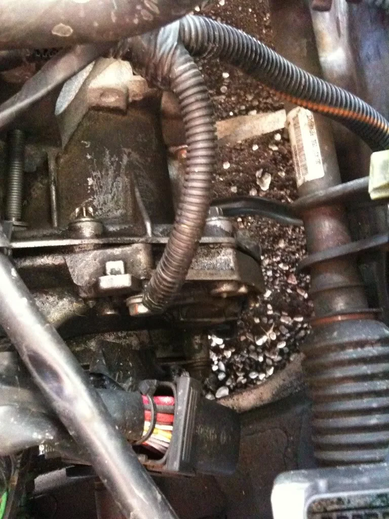

number 3:

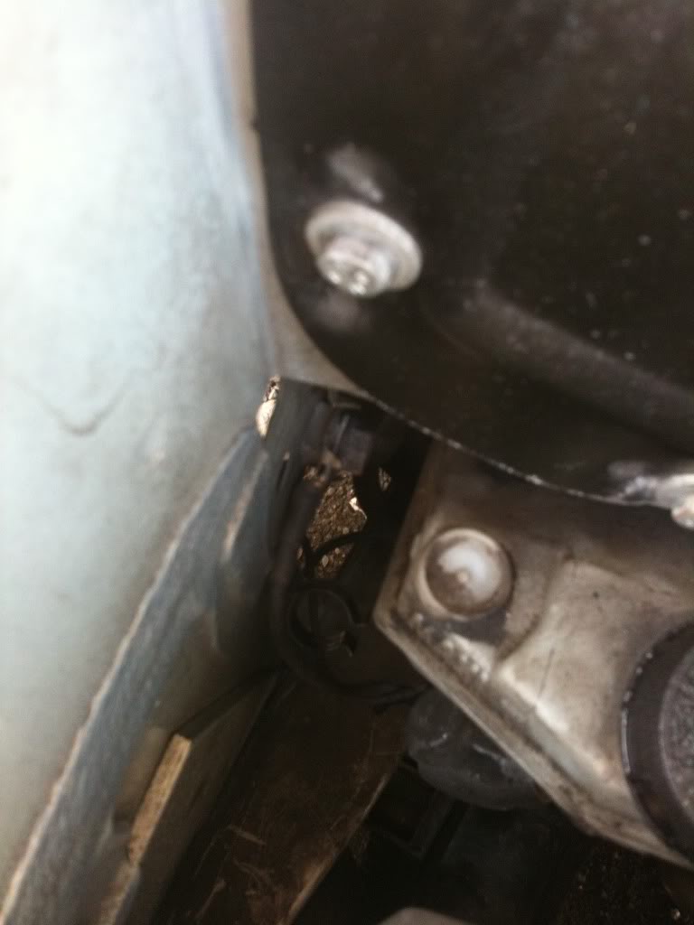

number 4:

had a wuick check, defo got number 3.
Number four though... Wheres is it from and where abouts on the chassis does it go to ?
