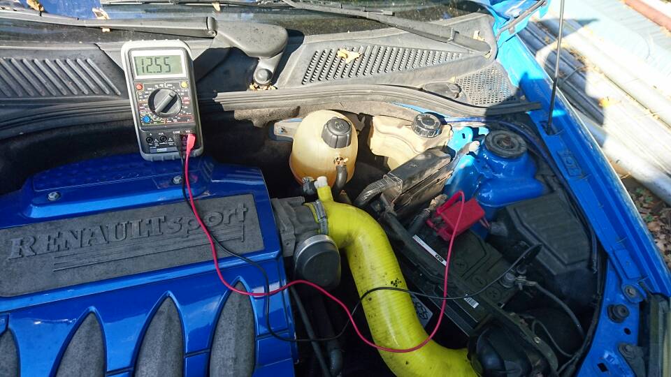

Hi,
I have the stop and battery light lit on my 182. I have done voltage drop tests and it's all within spec. The battery reads as below when off and lowers to 12v with engine running and lowers to 11ish volts when revving to 2000rpm

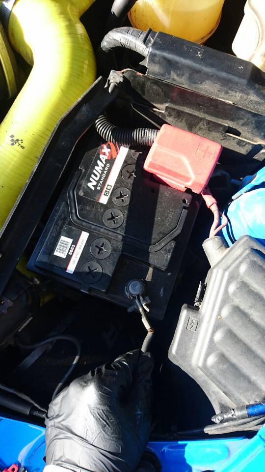

I did continuity tests, I have a beep showing no breaks on the negative side but no beep on the positive side. Is there an in-line fuse on the line between the alternator positive and the battery positive?

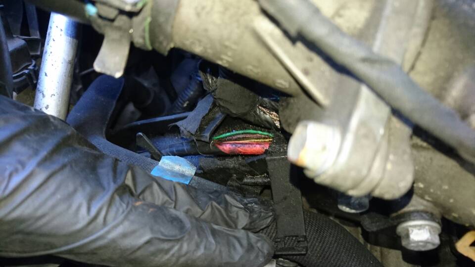

The wiring looks like it's been messed with before
I'm guessing I can test the wire being the issue by bridging another wire for now, what gauge wire should I use? Or am I on completely the wrong track here?

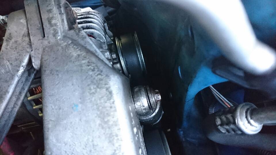

The belt also looks like it has a chunk taken out the side of it. Am I right in assuming this needs replacing? It's a bit of a b**ch to get to but the belt tension seems ok.

I'd say that the alternator is dead, what voltage is coming out of the alternator directly?
Also don't drive it when the aux belt looking like that, if it snaps its likely to wrap round the crank, goodbye engine!
The voltage drops when the revs are up. No difference in voltage when the engine starts so alternator is not charging at all. I assumed as there's no continuity on the wire from alternator to the positive post it's a break in the wire?
I will get a belt to be changed, it's not being driven with no charge going to battery atm anyway but I'm guessing the belt is a b**ch to change as it's in such a small gap.

Yup, the battery should be reading around 14v or a bit more when the engine is running. I had this issue last month, 30 pound later and a second hand alternator and it's now showing 14v. I would change that belt asap too. Very very easy to replace.
All you need is a 70-90mm jubilee clip around the tensioner, tension the tensioner and you can change the belt over in around 10 mins easily.
Yeah the ring connector is connected fine nice and tight, but no continuity from the ring end of the wire at alternator and the end of the wire at the positive battery terminal which is what makes me think it's a break in the wire rather than duff alternator (at the moment) unless there is an in-line fuse?

If I remember correctly, there should be a fuse. And even if u can measure no continuity, when the car is running can you get a voltage reading from the alternator positive pin versus the car body (ground). To see if the alternator is putting out anything. Just to eliminate any possible error done during the continuity check... ;)

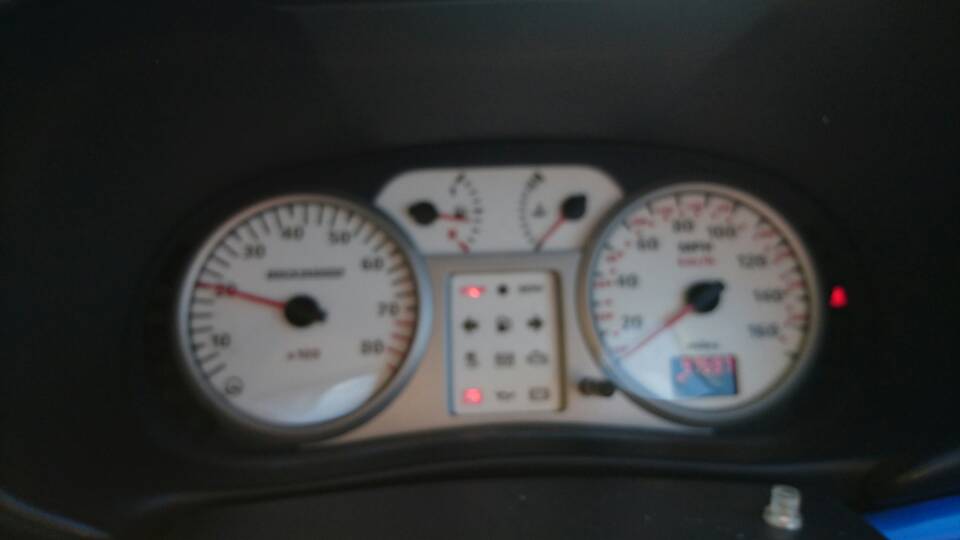

I had no idea that the dials should look any different? I quite like the white dials.

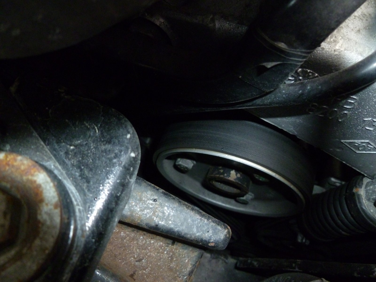

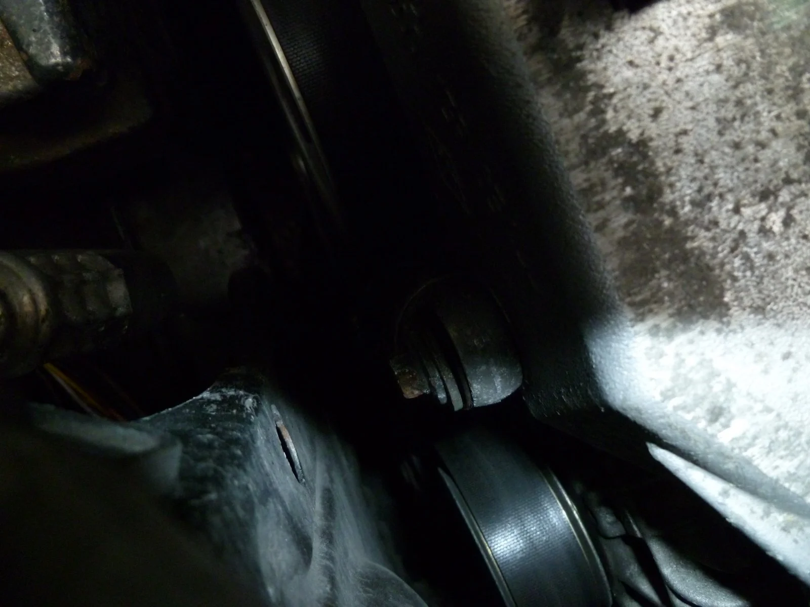

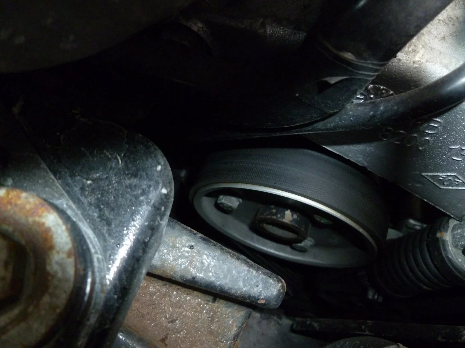

The reason the aux belt has started to split is its 1 rib off on the pulleys so the edge cuts into the belt.
That will be down

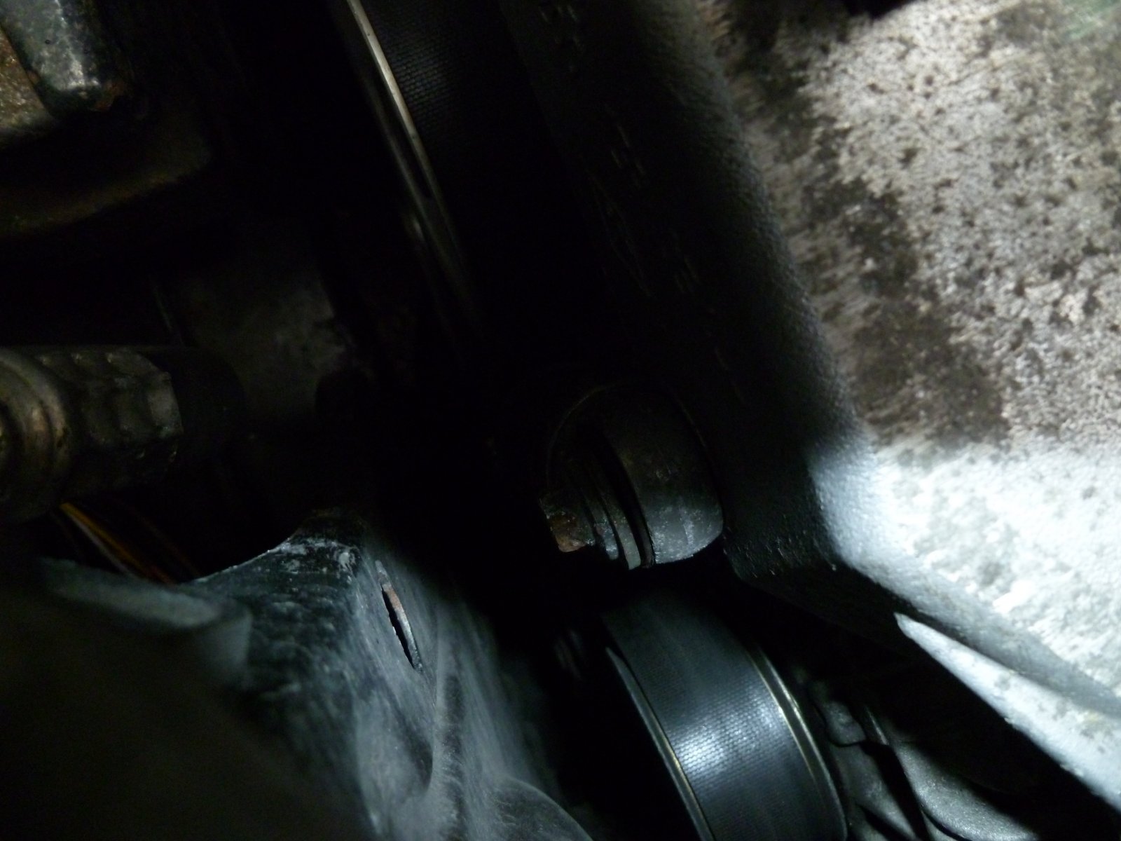

The reason the aux belt has split is that its 1 rib off on the pulleys.
The lip will cut into the belt,its caused buy the wancer who last fitted it.
Should look like mine.

Can upload a better picture of the dials when I am at my pc if you like.
