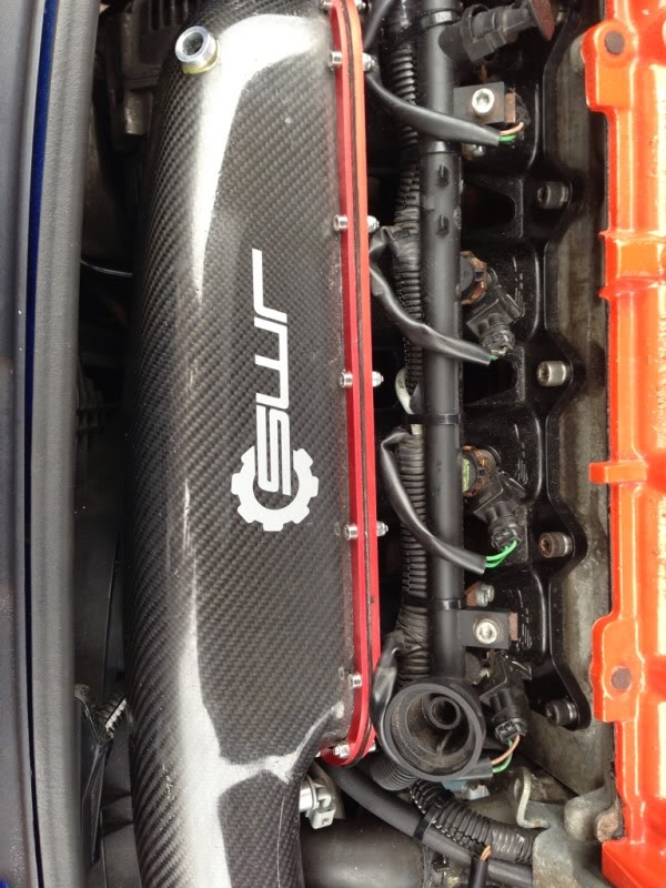

Looks great dude, great idea with the heat shield in front of the brake fluid reservoir think I should do that.

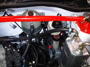

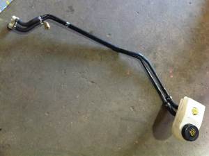

Just get a Megane set up (pipes), it moves the reservoir over to the other side. Straight fit.
Got pics, looked through your blog but nothing?
Yea good idea i did the same too, but left the left side open (when viewed from bonnet) to allow airflow.
My fluid was coming out the cap ever since I fitted the ds2500's, never had a bother with the oem brembo's.

Oh it's there,
The pipes run along the bulkhead, behind the heat matting and fit straight in to where the original ones went.
Strut brace is a little in the way for filling, but it comes with a nice easy rubber strap, we just undo this and pull the res forward a little.

Piece of pi55, took me 10mins and Jay 5min. That included the time for me to find enough washers to space the bracket out, and Jay enough time to fit the 'P' clips to hold the pipes together.

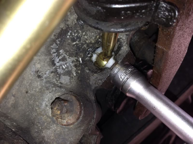

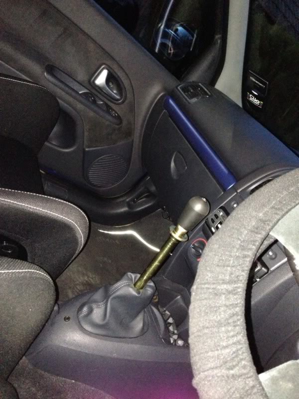

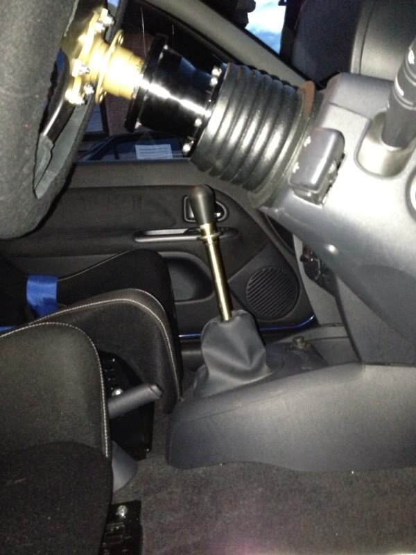

I have fitted mine with no issues what so ever, great bit of kit. I have yet to be for a thrash but its great. It took me just over 1 and a half hours from jacking the car up to putting it back down. The only complaints are slight knock on the tunnel going into reverse (this doesn't bother me in the slightest and could be resolved partially with slim head bolts) and the other was some of the plating on mine was missing/badly done (again doesn't really bother me as its not that bad)
I set the linkage by myself but I was up and down like a fiddlers elbow. I have set it up with 2nd at the rearmost point it can be without the spherical running out of movement. The shifter has allowed me to move the seat back two clicks back to the furthest possible distance on the seat sliders I have which I couldn't before. I'm chuffed there are no fitting issues like had been said and thanks to Phil for organising and Pure for making yet another quality product.
I took a few pictures and I have rubbish video's too.
Instead of using silicone like Pure recomend I used sticky back foam as mine will be coming out from time to time.

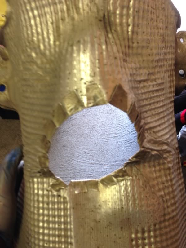

Snipped and bent back heat shield to avoid contact.
There's no mention of it on Pure's fitting instructions but you actually have to cut standard selector boot to be left with this.

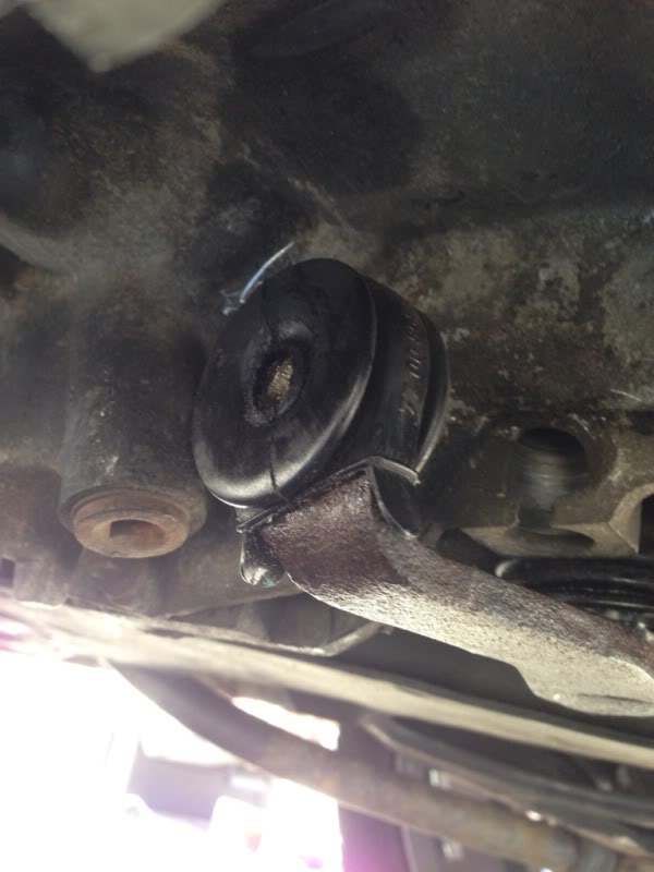

Some had complained of circlip falling out, the end of a 3/8's extension is perfect for seating the circlip (no need for bottle jacks Phil lol)
Quick video from inside. For all you Jessie's that complained of it not returning to centre, mine has started to after only 30 mins of playing.
[video=youtube_share;Ob0n0RYXajI]http://youtu.be/Ob0n0RYXajI[/video]

Shifter looks very nice but why use it on this car and not the race car??
It is for the race car, after all the commotion of them not working etc I had to try for myself. It takes an hour to fit so it will be swapped when its required.

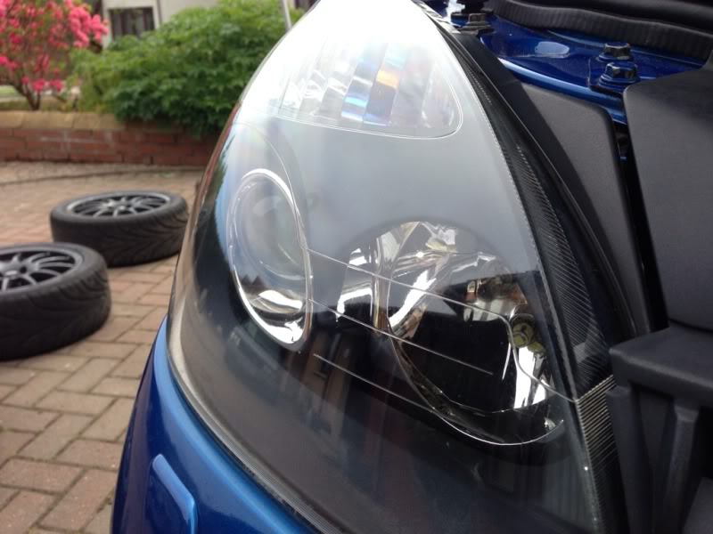

Gave the xenons a quick buff up while I was doing the jeep.

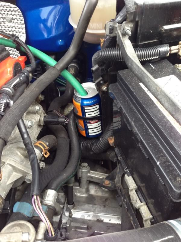

Fitted Scotland's finest as a breather tank.

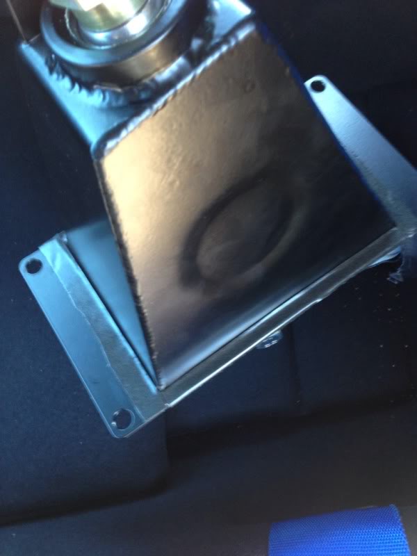

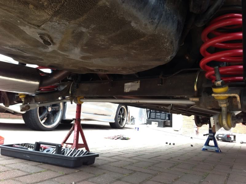

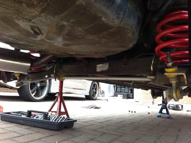

Spun the RARB L brackets round to make it sit up higher.

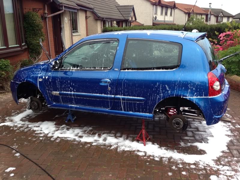

Wheels off, full spanner check and then quick wash.
Hoovered the inside, checked the fluids, torqued wheels and set the pressures, rain x'd the windscreen as its meant to rain and thats it all ready to go.

Good idea regarding the L-brackets, will this change the rear geometry at all?
No won't change the geomatery with that little movement mate, the closer you get to 90 deg from the beam them it would start to affect its performance.
Thought that was the normal way to have the brackets on the white line? :S
I presume it is as its closest to the axle but its easier to get the bottom shocker bolts yarked up the other way but I had nicked a few speed bumps recently so thought I would swap.

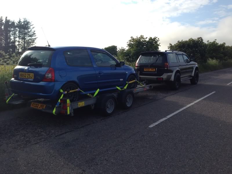

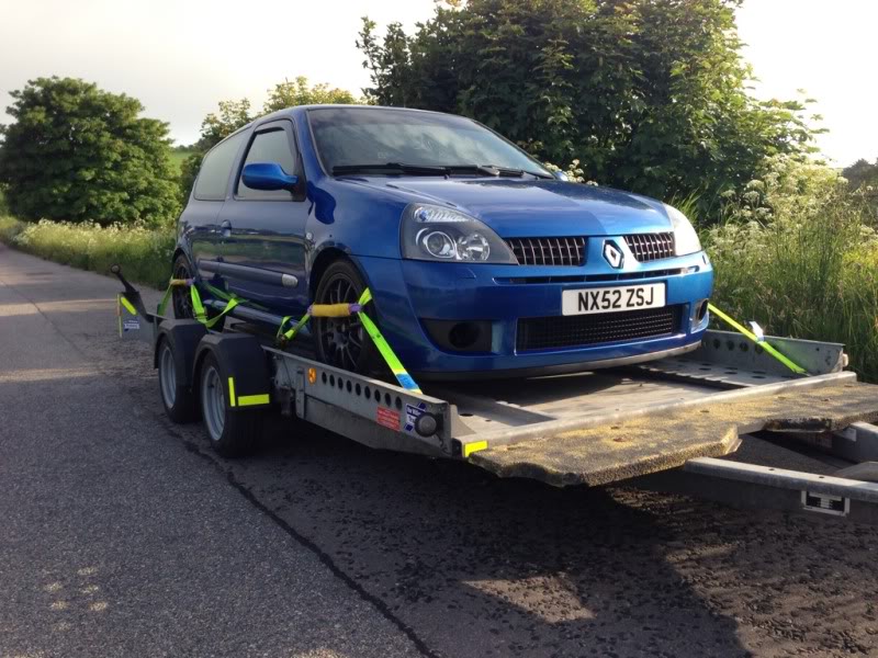

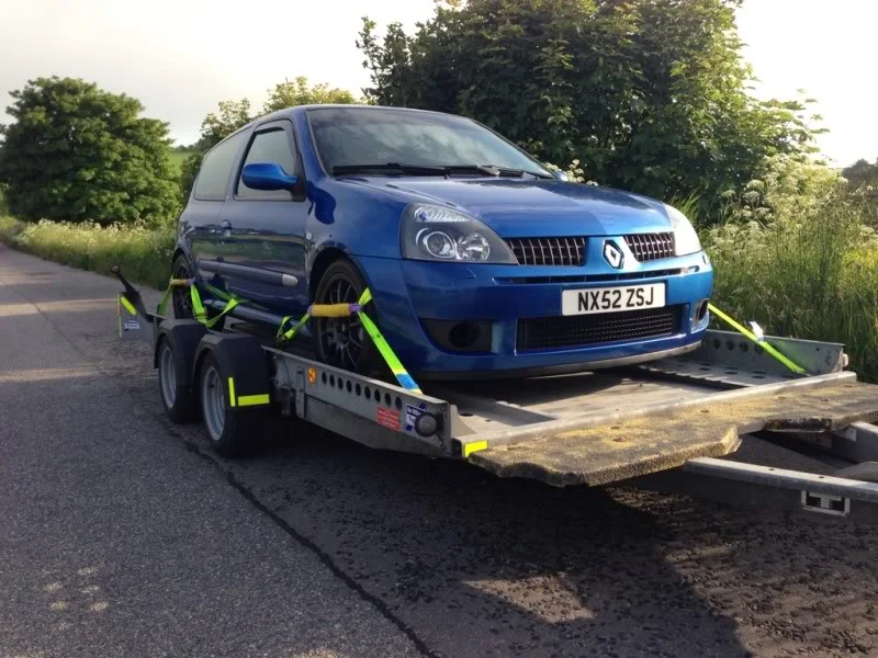

Yeah I'm sure that would be fine, I got soaked last time putting on 4 straps as my mate put a seed of doubt in my head....Cnut. Is that all you ever use?
I'll grab a photo of how I do mine in the morning when I go out to the trailer. I basically just use one strap for each axle and both meet towards the middle of the car so one pulling the car forwards and one pulling it back.
  Cup In bits
Just put the handbrake on and leave it in gear.
I was SO tempted earlier just for a test but I had a final destination thought of the car exeting stage left barrel rolling after it turned my jeep into a shogun sport spider.
