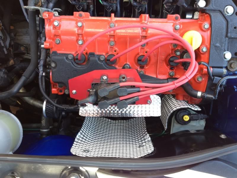

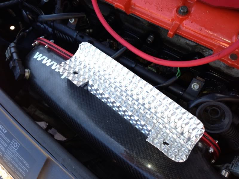

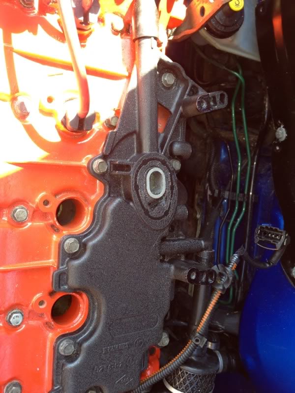

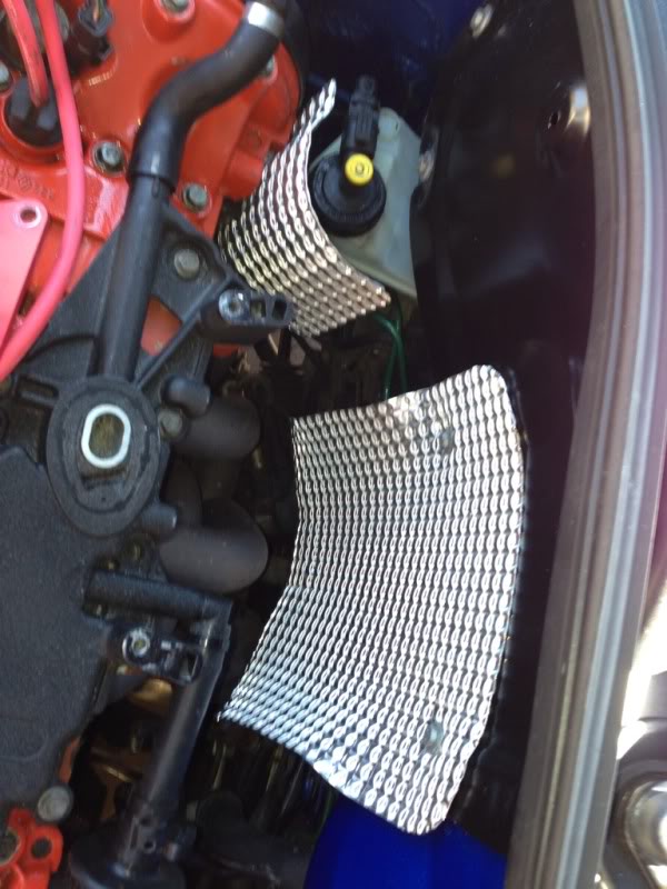

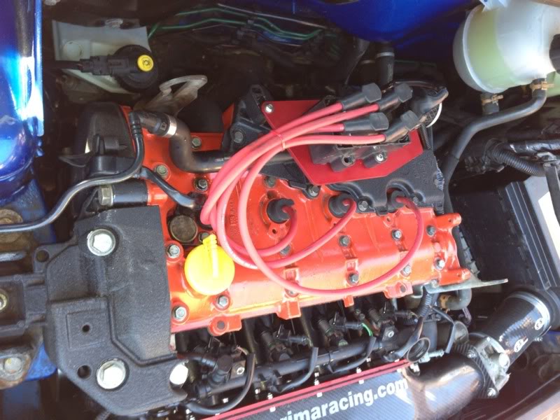

Went a bit heat shield daft today as I'm convinced my coil pack was getting warm hanging over the manifold and the brake lines and bottle take a roasting on track and in traffic.
Chopped down breather plate
Spun coil pack mount round away from mani
Made up some heat shields
Finished article, should see any heat soak now and the clutch feels 10 times better too as the cable isn't getting roasted.
Looking good Morgan, good old Nimbus heat shield comes to the rescue.

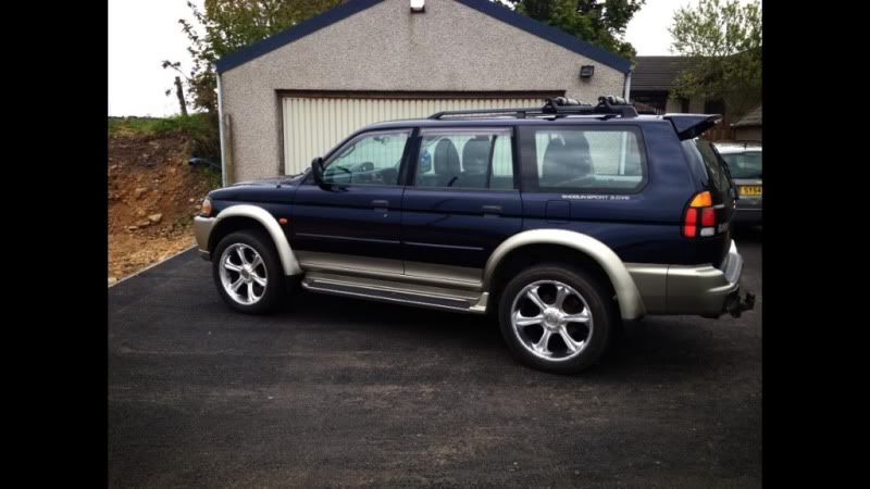

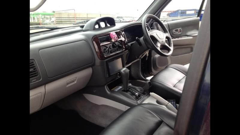

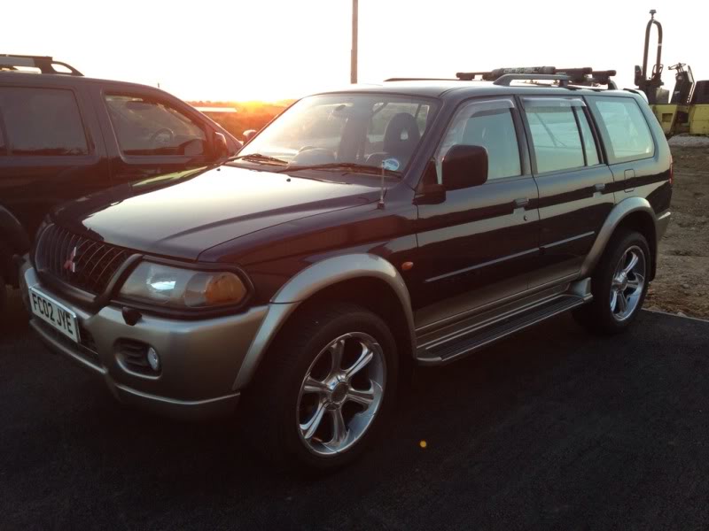

Finally got myself a tow bus off a friend to take this and the race car to track/race days. It was a bit of an impulse buy but couldn't be refused for cash she wanted.
Shogun sport 3.0 V6 elegance
100,000 miles
Tax until Aug, MOT July.
TV/DVD
New shocks all round
New brakes all round
Full stainless exhaust
Full service
IAT sensor
Fuel control solenoid
All parts fitted within the last 8 months and I bought it for less than 90% of Clio 172's :D
Excuse the dubs and spacers they will be coming off come time and the lower half will be painted body colour.
