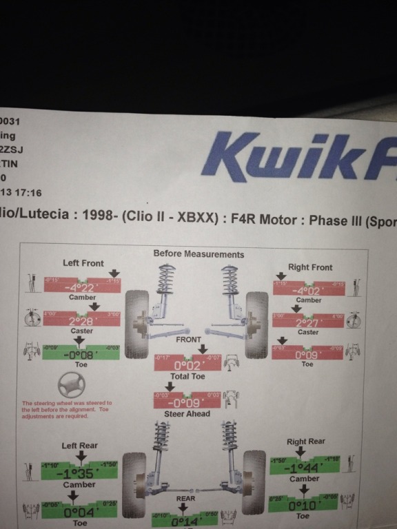

Rear beans are normally toe in, surprised to see it out!
Yeah most are,TBH it could probably be doing with going more towards parallel as the rear is eager to come round, a bit more stability at the back would improve lap times but do nothing for the :D
​This was the printout the first time I had it setup and the rear hasn't changed.
(ignore the front toe settings)
Yeah 4 degrees pap on each side (that old printout went all to pot after setting it up) I was getting as much as 4.5 out of camber bolts but stuck with 4. Look at the outside of my tyre Sunday, its sat off the ground
It need's the 4 deg too with the amount of body roll on standard shocks/eibach springs.

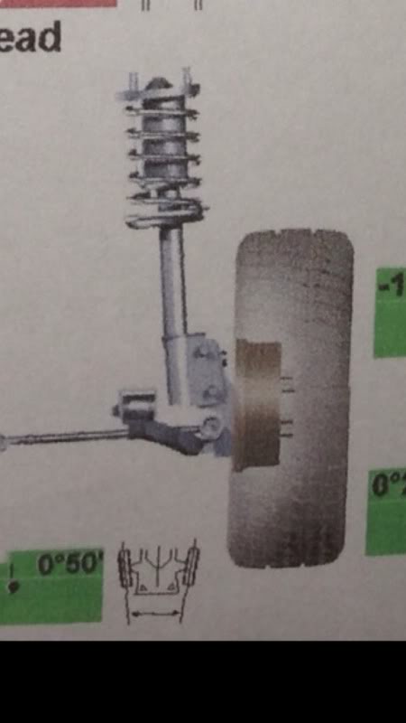

Positive toe is toe in. You're running 14 minutes of toe in.
Are you sure? Thats not the way I read that printout.
If you look at this symbol the the 14 minutes is measured across the rear half, the opposite from the front.
That's just a misleading symbol showing it's the rear not the front. It's a hunter printout, and they use positive toe as toe in which is standard practice. I spent 3 months on these machines at work, we have 6ish
You'll know better if you have done the course then haha, it's just the way I read the printout.
The rear beam is still pretty good for standard :)
How did you get so much? I run camber bolts and couldn't get more than -2.7 on one side and -2.1 on the other! Perhaps it's just me!
Because Cup....
Seriously though I suppose its because it is a cup and has more static camber to begin with and caster (dynamic camber) for that matter. The type of shock can affect the camber figures, it depends how the hub bolt holes are drilled on the shock casing (I have standard shocks)
The most important bit is when its being setup, make sure to have the lower standard shocker bolt slack enough so the hub can pivot easily, with the top camber bolt you have to keep pushing the top of the wheel in while setting it up and the tab on the Eibach bolt has to be in the right direction too.
Nobody EVER does this and just expects the bolt to do the work.
Because Cup....
Thanks, my car is a cup too, but I'm running GAZ coilovers (yes, I know.) I slackened off the bottom bolt but perhaps not enough! I think I should get someone with more skills to do mine :-)
From memory It will also depend how thick the metal is that's used on the strut to hub mounting. Too thick and the cam on the Eibach bolt will hit it.
Would make sense as the lobe/tab couldn't move around enough. Thanks for your help anyway, I may change the suspension out to a better set that allows for camber adjustment
Probably not needed, I quite rate Gaz suspension having had them on my mk1 xr2.
5 mins with a die grinder and you'll have 7 deg.
