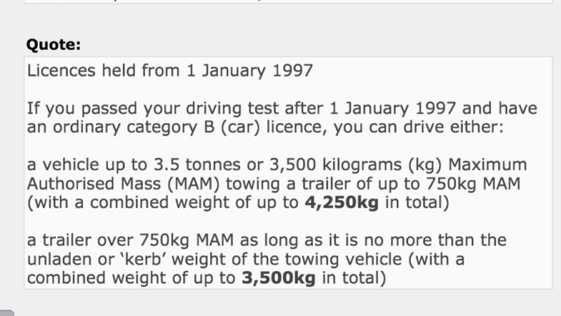

Nah Sonny I ain't done my test yet but want to so I can tow my trailers full capacity if needed. I just go by this which is a snippet off the DVLA's site, I have asked a couple of Grampians finest traffic cops and they agreed so I'll go by this for just now. My trailer and load is always well within the safe allowable braked weight for the vehicle I use, basically don't be stupid and you should be fine.

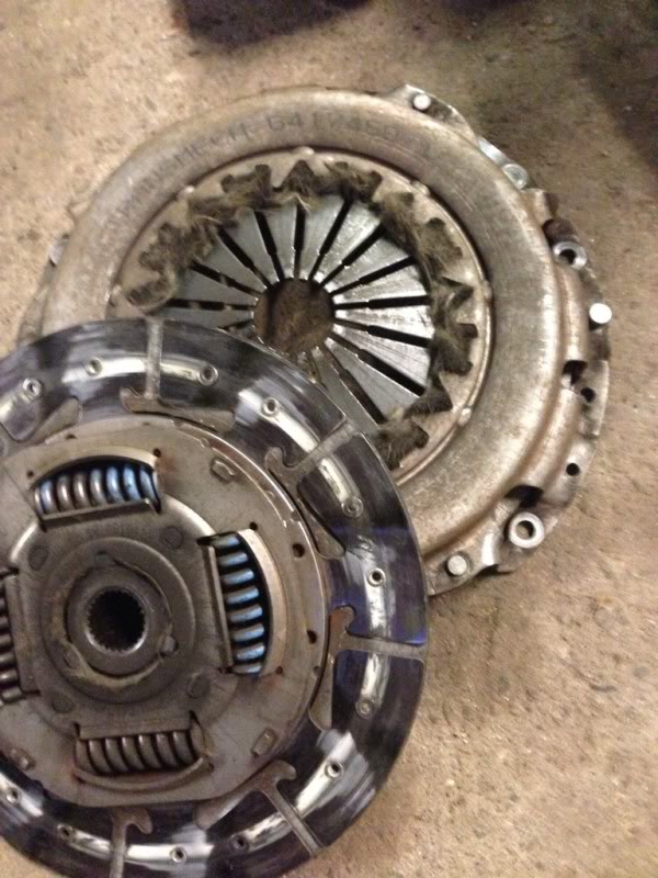

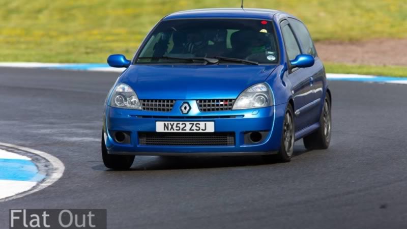

Well... had another good day again, had loads of fun and a few spins. The weather was shocking at points and the track constantly greasy with constant 4 wheel drifts :) The clutch failed 40 minutes from the end so got a good run. The g/box is needing a recon too which was known, 1st synchro was non existent and 3rd didn't like to be rushed on up shift. I was struggling for gears as the day went on putting me deep in corners sometimes and out of sync.
Fraser still no feckn lap time on Harry's, no idea what I'm doing wrong. Too wet for a good time anyway, only use for hooning.
Two videos to follow, was having way too much fun I forgot to switch the camera on half the time.
Morgan I think you will be towing illegal. Your jeep will have a mam of at least 3 tonne? And the man if the trailer must be what about 3? It's stupid but its the maximum authorised mass not the actualy weight of what your driving/towing. I didn't want to risk it so just done the test, can't go wrong that way!

Yeah I am looking to get mine done as well but two different officers confirmed that quote was right. Jeep kerb weight is 2510kg iirc trailer 2800kg with 500kg kerb Clio 1000kg ish so well within that guidlines. I see what your saying about MAM but they said it would be the weight on the day. Its one of those grey areas that loads do illegally.

Your not pushing if you ain't going off.... On a serious note I just enjoy having this thing in all sorts of shapes, its so much fun for a car with springs and RARB. I could go around all day with the rear in check but wheres the fun.
Pics and videos from yesterday. As said it was the slickest I have been out on, a few couple if cars dumped oil round the whole circuit early.
First of the two videos I remembered to film, full spin half way through at Duffus, don't know what I was up to looking back at it. First session after the oil being put down so I'll blame that.

Thank you, they are Megane 225 or Clio 197/200 callipers with custom brackets to suit the standard 280mm disks. 197 braided hoses and longer caliper mount bolts.

Nice driving there Morgs, track looks greasy. What tyres you running?
Just the Federal RS-R's mate, great all round tyres. You can see how useable they are in that shocking conditions but are also a ball hair away from most R compound tyre in the dry, in fact i think they last better than a 888 does. The track was never really totally wet or dry (in scottish terms) most of the day and finding out later there was fuel and oil put down a couple of times, a few said it was the slickest they had seen.

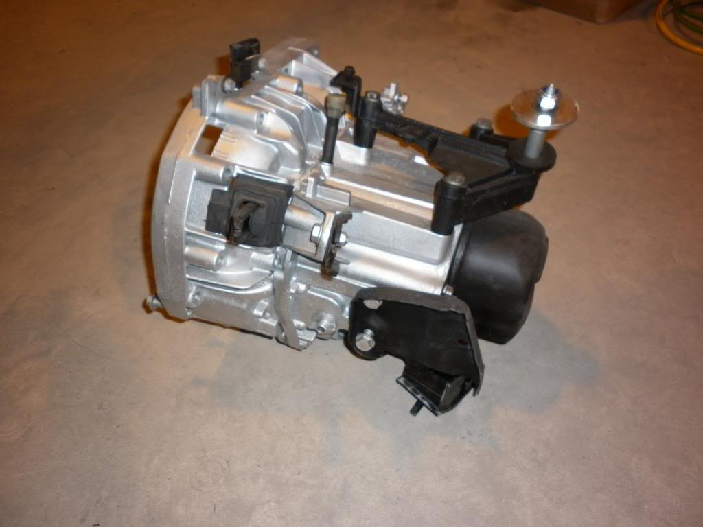

Does anyone know the manufacturer of the original clutches????? Im pretty sure this box has never been out in the near 108'000 miles its been going.
Still got some life left in it yet
Good effort there Morgan!! I'd imagine the original item is a Valeo mate and they seem to come highly recommended as an oem replacement by a lot of people on here.
I thought the same maybe but that box felt like it had never been out, just the way all the bolts came out/looked. That's a transmech clutch, it has pony straps on it that Burpspeed have broke before.

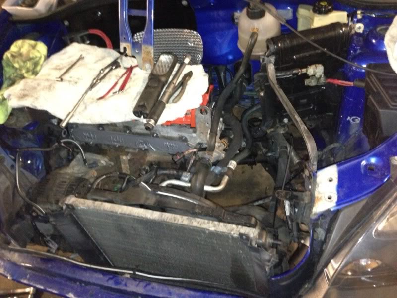

Swapped out the gearbox and clutch from the racecar on Saturday for the upcoming track days this fri and sun. Its back on the standard inlet and the RS2 is sold.
Finally fixed my glass rattle with a cable tie through the slider guide.
Just needs fuelled, gbox oil changed and full spanner check to put my mind at rest and its ready to go.

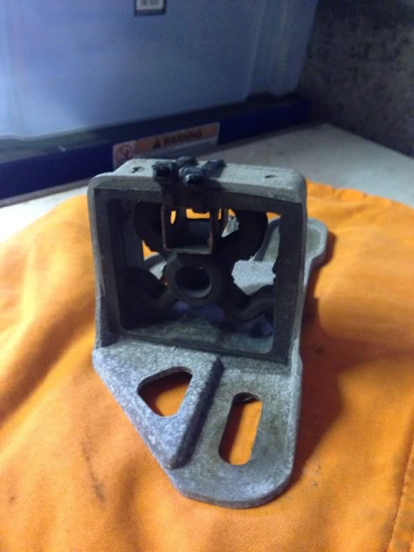

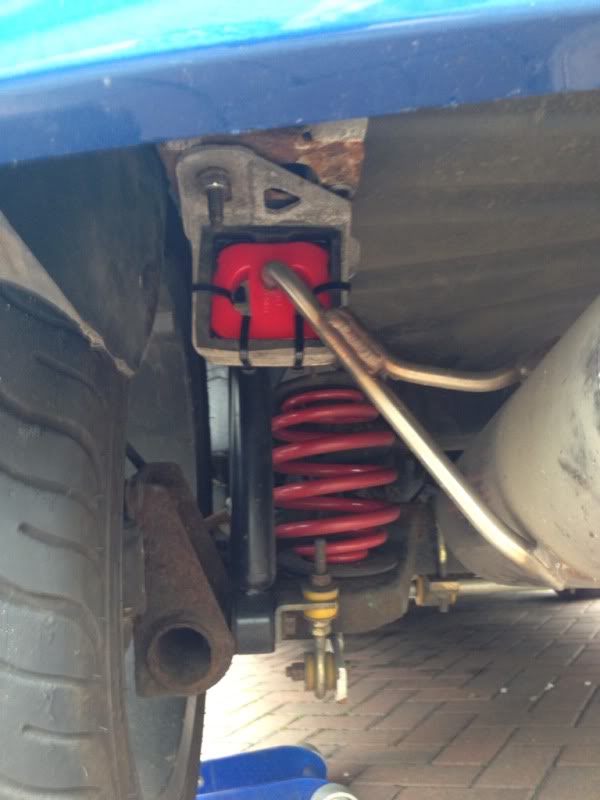

Since then the cars been fine the 30 or so miles I have driven it, the only thing that was annoying me was the exhaust mount, it was sagging and I bodged it previously to stop it knocking on the axle. Exhaust mount mod done and wheels swapped front to back to even out the wear on the RS-R's edges, full check over done and I'll wash it today and its ready to go for Sunday at PFC Knockhill.
