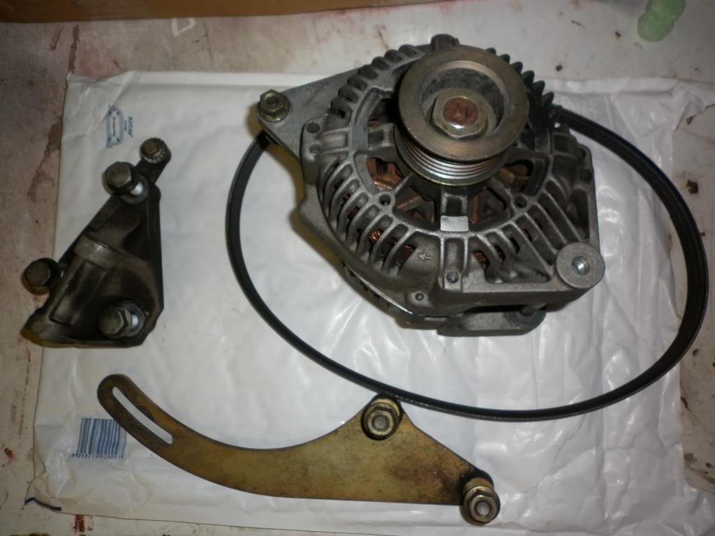

Yeah send it over please Ash, just to compare now really. I have managed to find a cup racer alternator setup now, I got fed up of looking for the right Volvo bracket to suit.

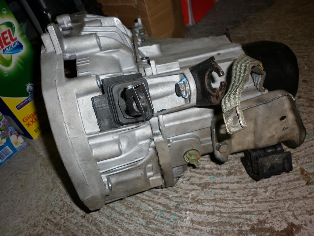

The subframe has mountingpoints welded in for the cup enginemounts.
Only the rear is not a direct fit to a JC5 gearbox, but it's an easy fix though, only need to flex the 2 spacers out and you'll have cup enginemounts.
0.0 comfort though with these mounts. if you ever consider, send me an email :)

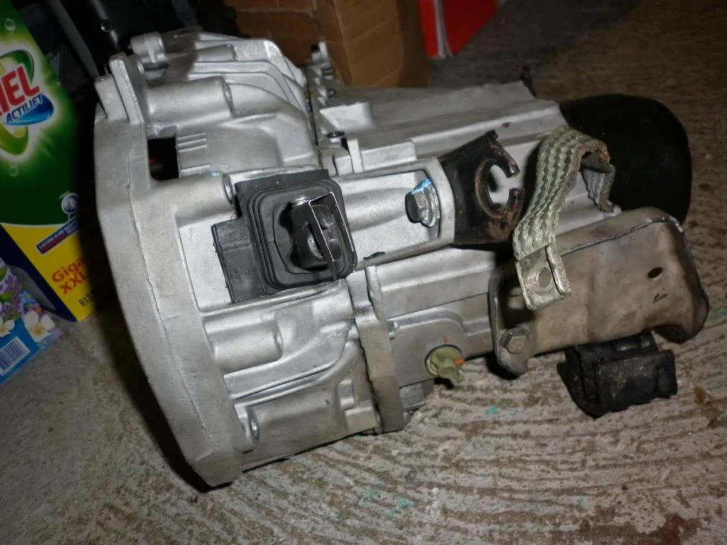

Gripper'd box with lower FD
When I fit the box later on after im bored of it spinning wheels out of corners, I will fit this.

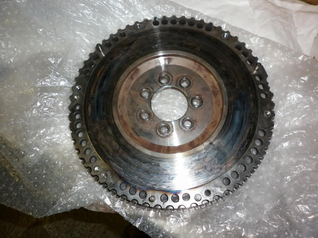

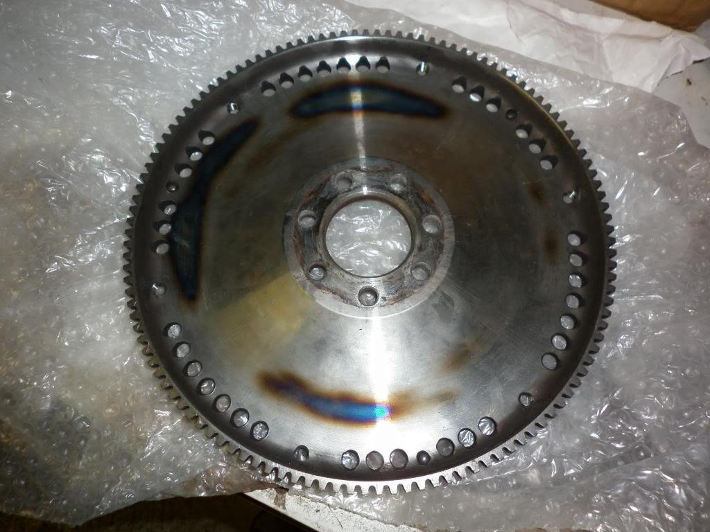

Slightly worried about the heat spots on the flywheel as there quite bad, I hope it hasn't tempered the metal too much???? Ill get the face skimmed just to freshen before fitting.

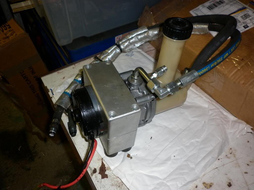

After a few peoples words of warning about running no P/S I thought I would get another option in place if im not keen on the non assisted steering.
Got a hold of a cup racer alternator setup from Martijn to give me some more room with the the alloy radiator. Looks to be a cup alternator and top bracket the racer's used but I still have to compare to my cup setup, hopefully they are a match as I'll keep the new alternator as a spare.

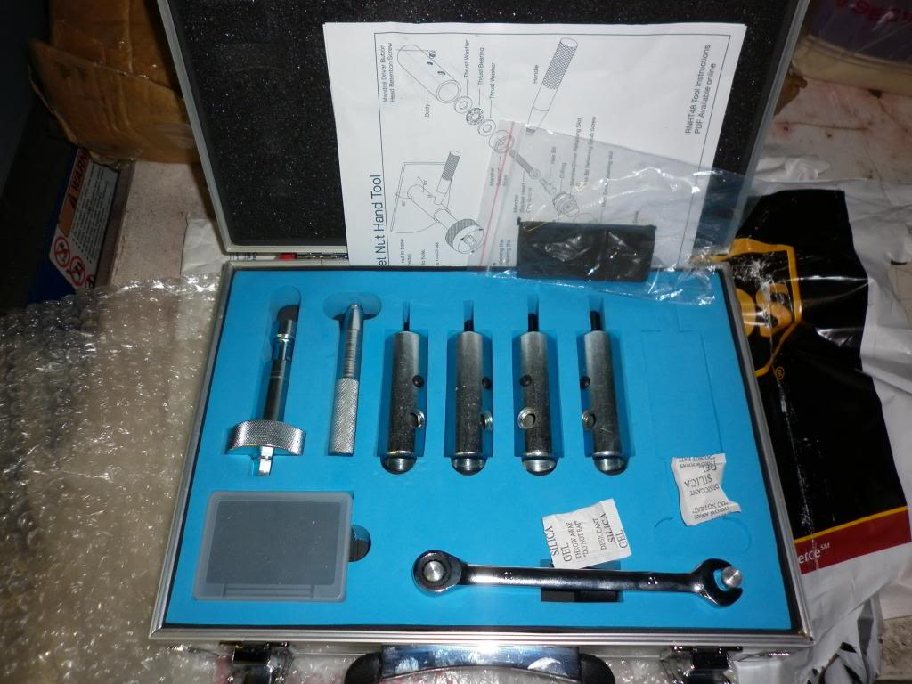

After breaking my cheap rivet nut tool, it only lasted about 5 rivet nuts before going wrong. I went for a memfast set which should last me all my days and the mandrell's are only high tensile socket cap bolts so easily sourced if worn or broken.

Cheapo rivnut tools seem to be a common pita just now, James mentioned the Memfast kit too, does it turn the cap head bolt in the rivnut to draw it in?
I try to avoid rivnuts if I can but some things there's no alternative, they usually work ok for a while but always find vibration gets to them eventually.
Flywheel looks like it's seen a fair bit of heat, was that from Icemans car too? Just reminded me this is something else I need to buy :(

Its one of those tools that there really isn't a cheap alternative. Yeah just relies on the bolt to pull it in, there's bearings inside to assist. I haven't had a chance to use it yet but it will be good for the tighter spots and seem's well built with good reviews. Yeah I have used cheap aluminium rivnuts in the past and they just react with the bolts and lock solid, im going to use steel or stainless to avoid this hopefully.
Yup flywheels from Iceman as well, scarily thin where its got heat spots. Must have been having a good old bit of clutch slip on his. I still have to check if its compatible with a paddle cover tbh as there a fair bit stiffer than normal I have been told and it just seem's paper thin. Mark said it was a k-tec jobbie.

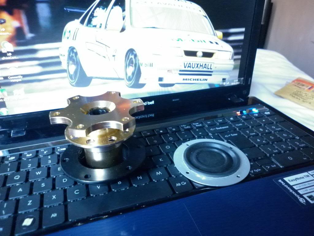

New bolt on quick release boss that I can't decide whether to use my OMP weld on or this and one of the most grudged pieces I have bought so far. Seals it grommet at the insane sum of £23......

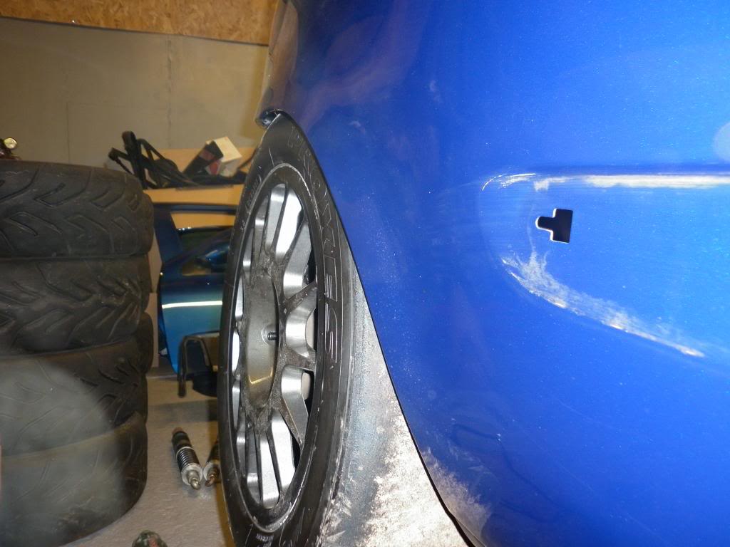

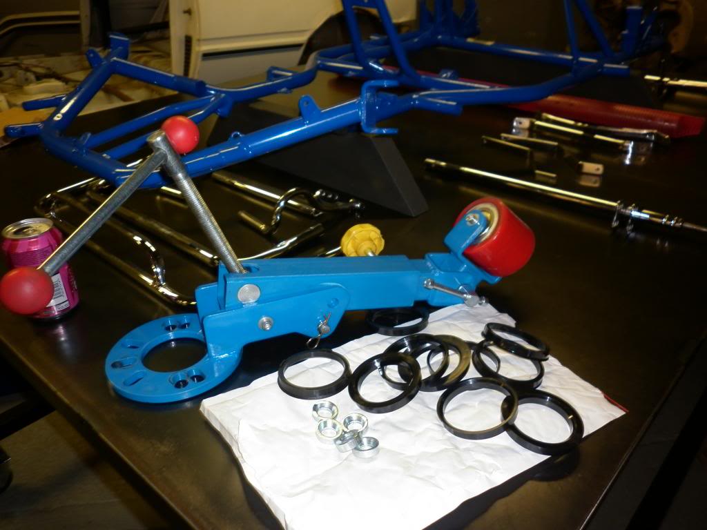

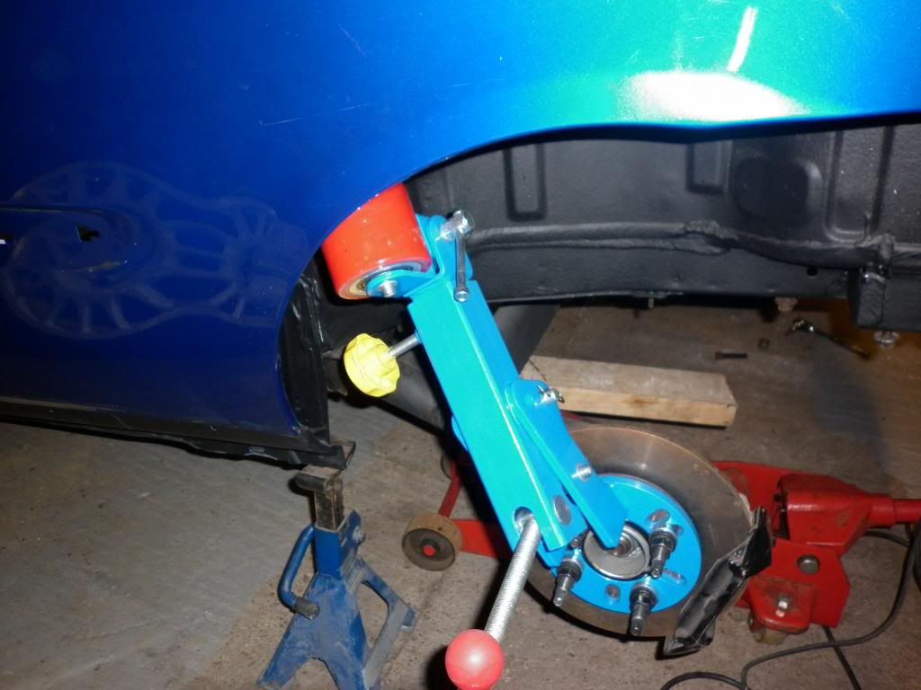

So I received my arch roller finally after returning home from my trip.
What I started with.
During.
After.

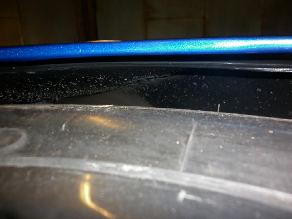

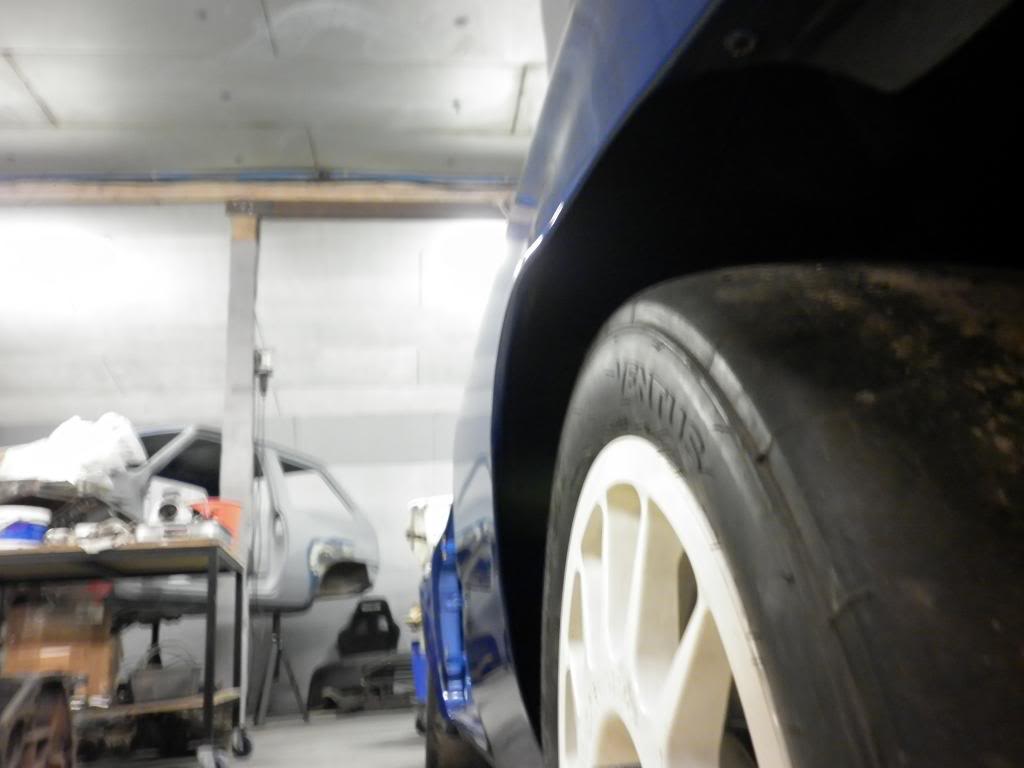

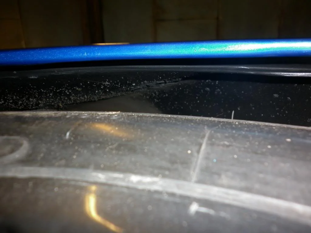

I gained around 15mm at some points and its hard to see from the pics but the swage line is almost gone and the arches are quite flared.

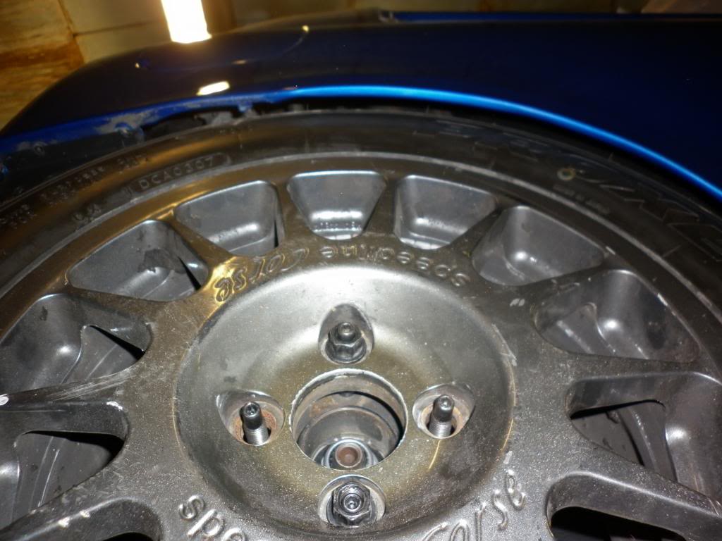

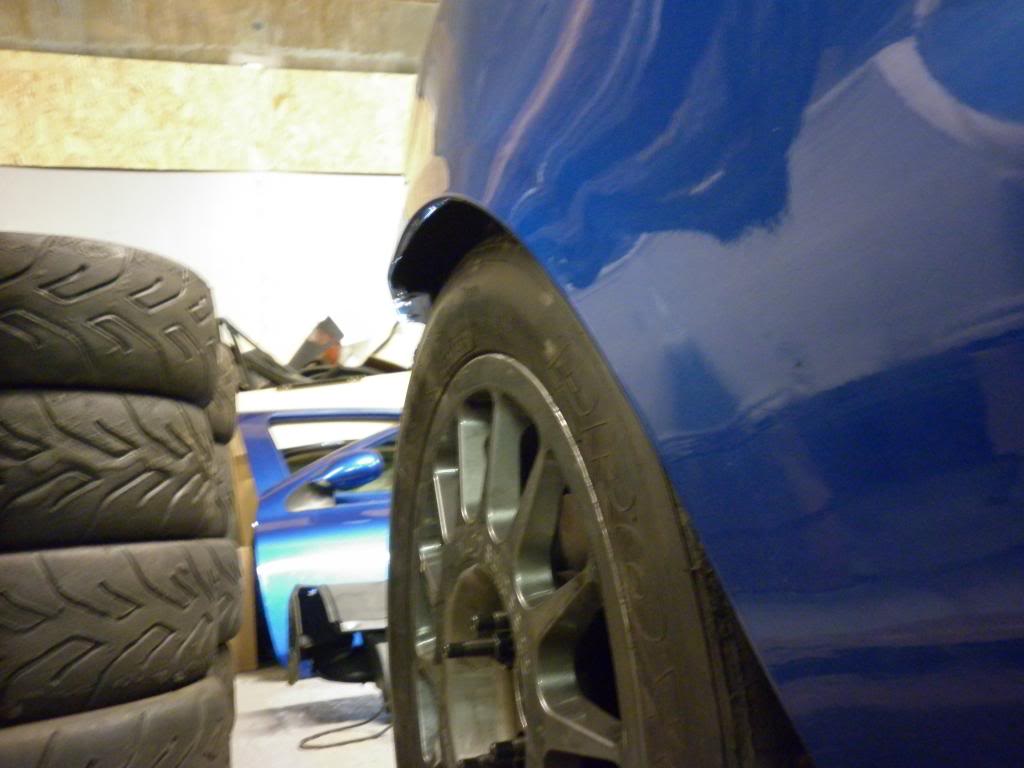

I then mocked up with some washer's to give me an idea of what size spacer and camber I will get away with. Im going to have some 30mm axle spacers made up with 1.5 degree so that should total around 2.2 degrees when complete.
Few pics of what it will look like when the spacers are fitted. Looks pretty mean :cool:
  172 cup, Impreza P1
The arch roller looks the business. With 30mm spacers and with your wheel offset you will have gained about 40mm track on the rear if my calculations are correct. That must be one of the widest rear tracks in a clio. Good on you for going that extreme. I have the spacers cut, just need them machined with the camber now but that shouldn't take too long.
Good luck on your ARDS test!
Good stuff!! 30mm in total or 30mm each side? Most I could get was 15mm each side with ET 35 wheels - with 195 (fronts are 205) and used the same roller you bought. Remember to cut the inside of your rear bumper away as it will rub for sure - only need to take away the lip and leave it flat, I went past the first retaining screw hole too.

Yeah your right, should be around 40mm wider than a 172 cup with turinis. That's perfect, I have PM'd you about spacers again Steven, changed my mind.

Thanks, yeah 30mm a side Pete and that's with the equivalent of 205's in slicks used. I think that's with around 2.5 degrees camber maybe a little more. Yours will only be 17mm in thinner in total with your wheels and spacers. Tbh I haven't even tried the bumper on yet :S .....but with my suspension being so hard ill be lucky to see 30mm deflection in the rear shocks so I can afford to run things close.

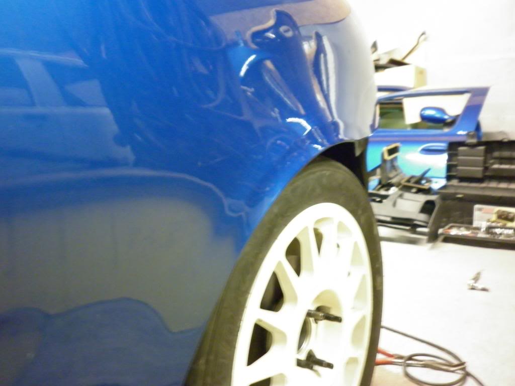

Yours turned out a LOT better than mine did a few weeks back. Have you made any modifications to the rear bumper bracket? I think my slicks rubbed on it so i cut them a bit.
Yeah I took my time, about 3 hours in total to do it. I just played with axle heights and kept it hot with a heat gun and never got any kinks or paint crack, only one little bit inside that had already lifted. I then dollied in the front edges and the horizontal bumper join line to clear as you can see in the last picture it sticks out (that's pic was before I flattened it to the panel) It's a bit of a pita ain't it, my tool is slightly too long for a Clio I would say but done a nice job in the end
