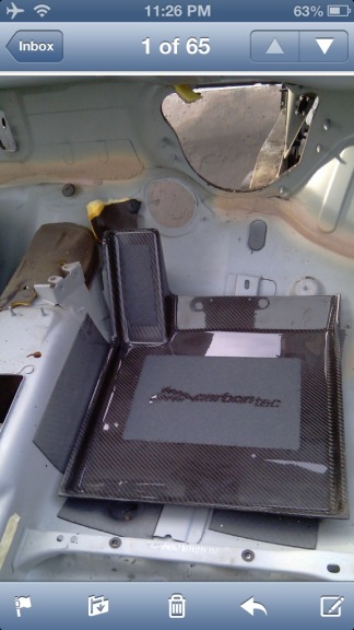

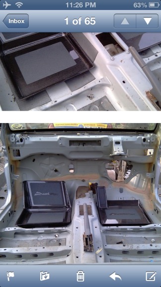

They should be about £250 but I'm trying to get them re-made so the passengers slopes towards the tunnel. They are made for a LHD car. Nice bits though and I think I can get this guy to do anything carbon for good money.
I'll let you know when I'm certain they work ;)
Yeah I have found a few now, more like the s1600 cars though which are like a copy of the floor but in carbon, I actually saw one with an indent for a makita impact gun that I thought was cool but £450 a side is pricey. I just need something to take up the space that removing the carpets lost and to pass all my wires and piping under on the passenger side. It was going to be chequer plate but I can't refuse carbon at that price.
Heres something in the similar price range but unsure if the dimensions suit
Yeah I'd be interested mate. I just use grip tape on the floor pan at the minute tbh, but the passenger side could do with some form of a foot rest for the passenger. I run my wiring down the n/s sill. Main loom on the top part and battery cable on the side. Never been knocked by any passengers either.
Yeah it's just for neater install instead of running everything down the sides of the passenger seat, I have battery cables, brake pipes, fuel lines, extinguisher pipes and wiring, interior loom all to run so could get busy.

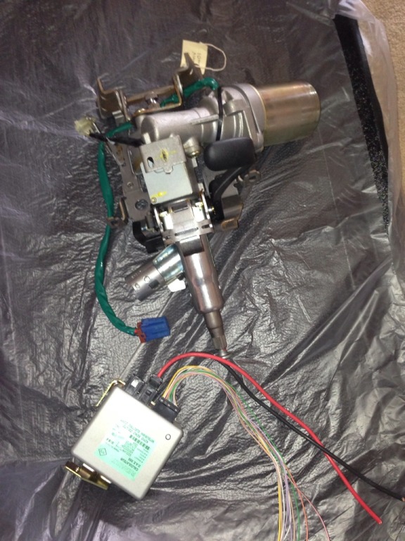

Epas column and box of tricks on its way.

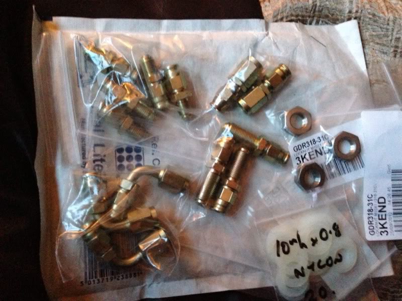

Most of the brake line fittings came, just waiting on the hose, t-piece and tilton lever valve.

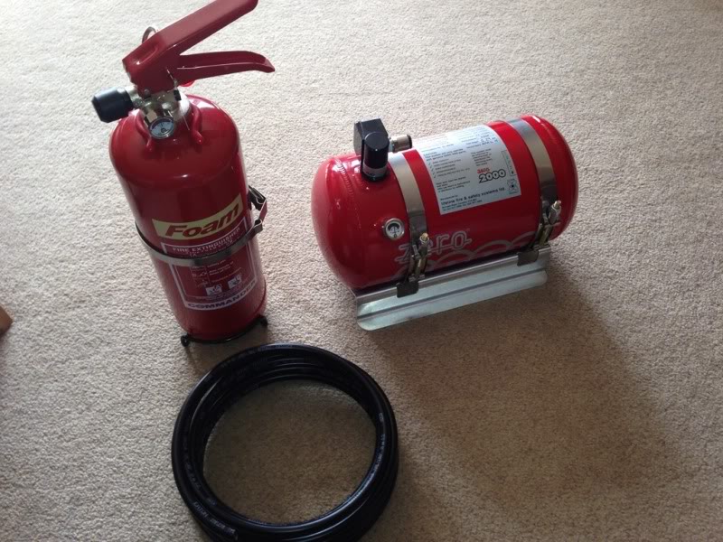

I went for an electric release 4l extinguisher an also a 2l, got a good price on both and a few have advised a hand held now to save using your plumbed system when the worst happens.

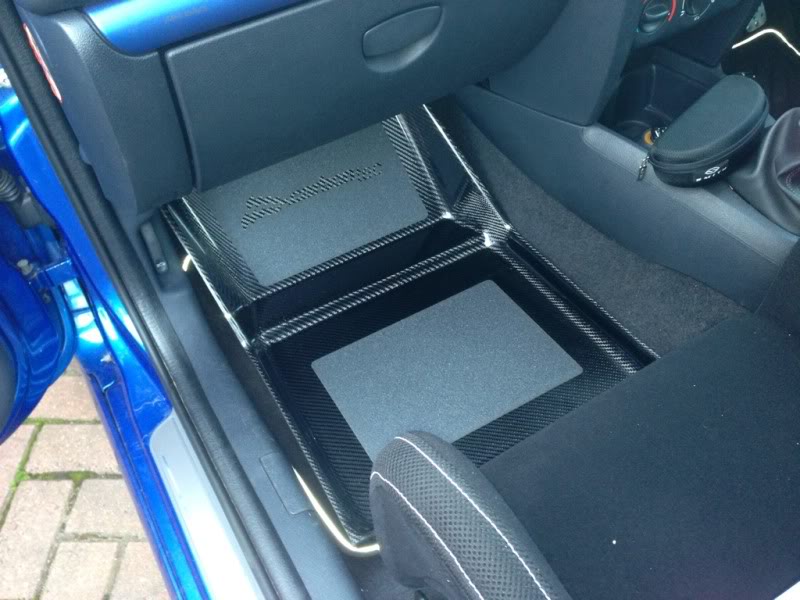

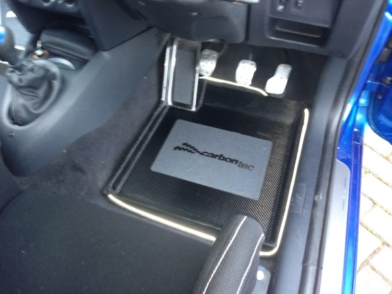

Couldn't resist a test fit picture of my lovely new floors, they fit well around the pedals which I was worried about.
Those CF bits do look great. I'm so glad I finished mine as driving it is a million times better than faffing around with it. I suppose you do have a second cup to keep you happy!

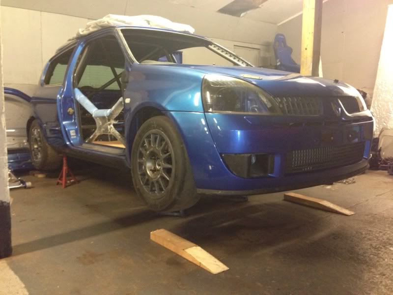

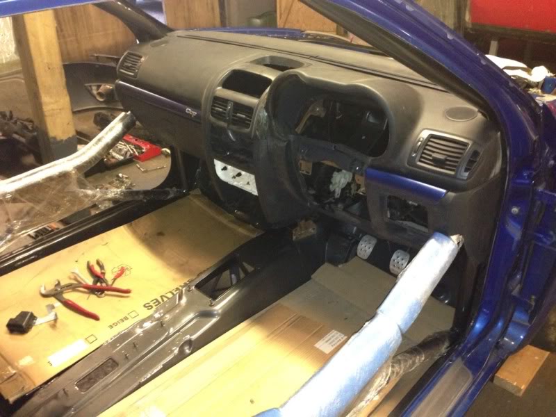

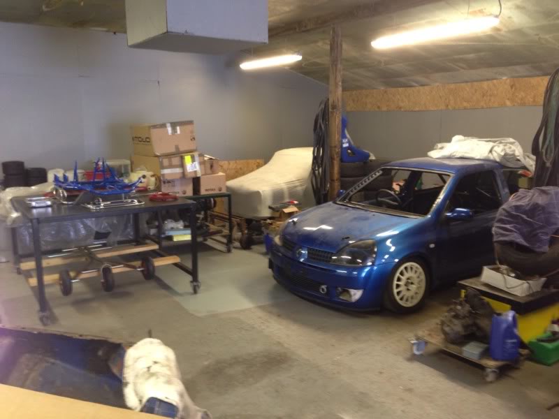

I managed to clear up my lock up which makes it easier to so work do I thought I'd crack on. Put it up on the stands and it won't be coming down until it's going.

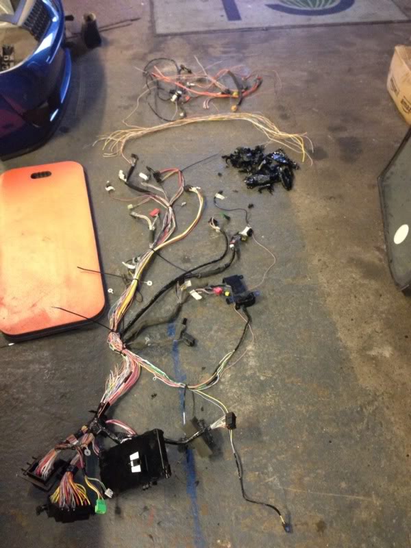

I test fitted the original loom to refresh my memory.

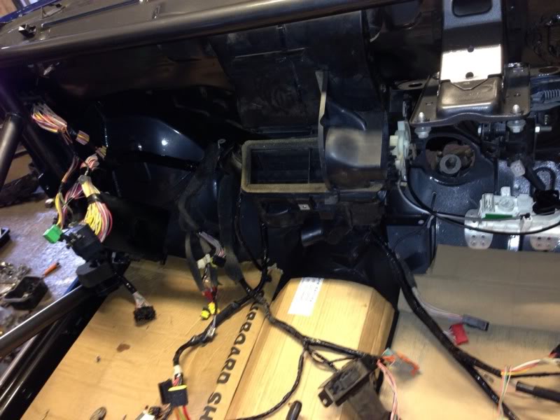

Wrapped the cage to stop scratching, fitted the heater box/matrix/blower motor and dash to try work out where everything will go.
Paired down the interior loom (sore head) Still needs some more taking out and re wrapped.

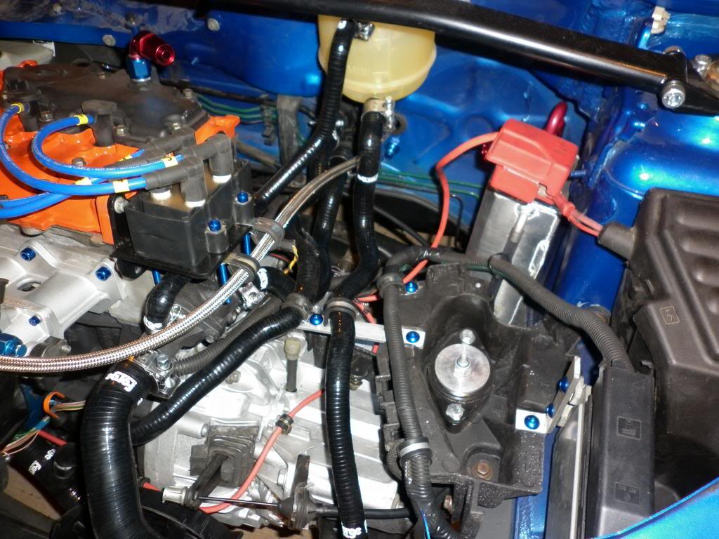

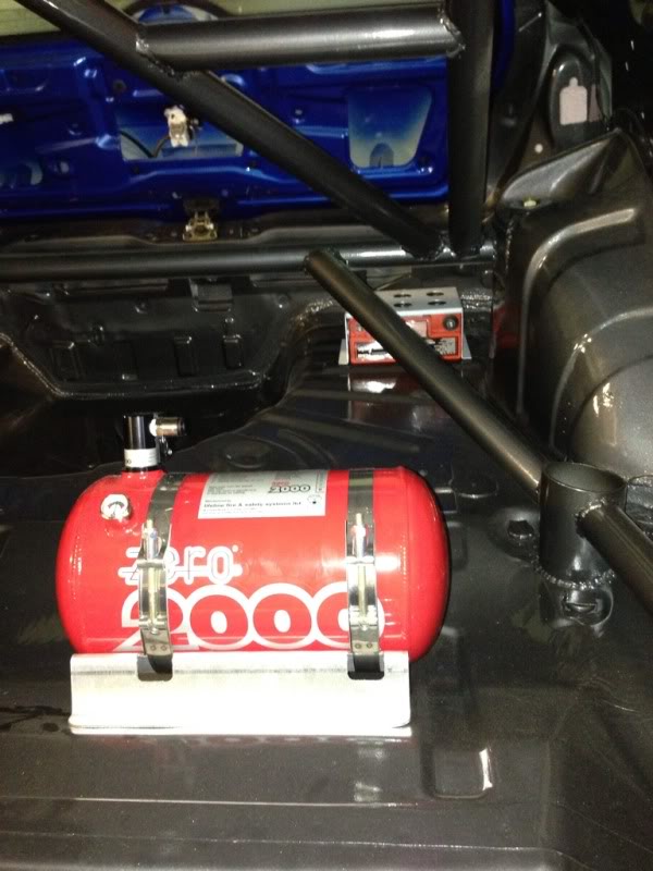

Started toying with the placement of extinguisher/cut off/battery to give the best weight balance and allow me to route the braided fuel and brake lines neatly.

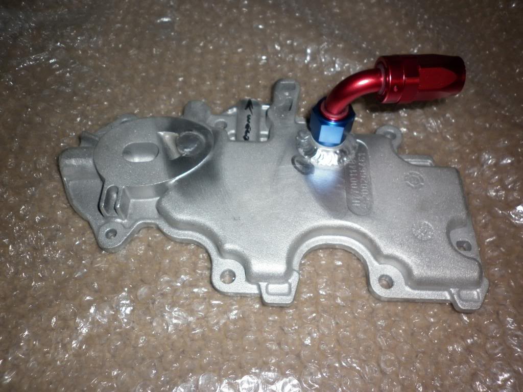

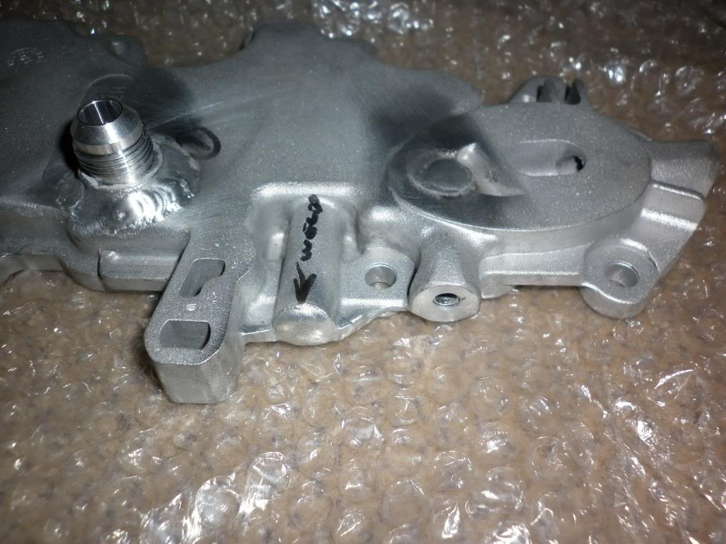

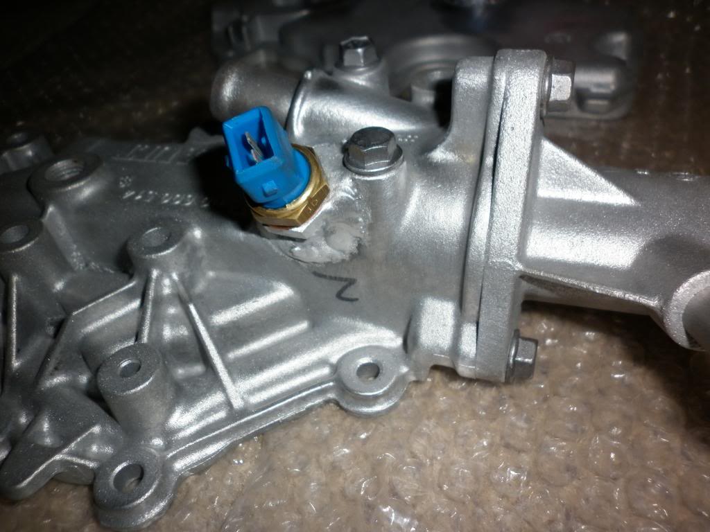

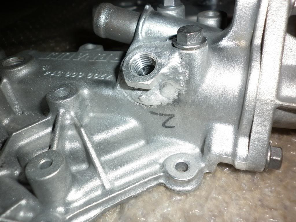

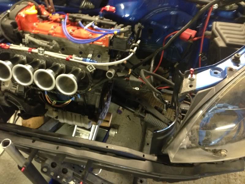

Few pics for those with ITB's that are interested in what I have done to breather plate and thermostat housing. I have seen better welding but it will do with a grind and paint.

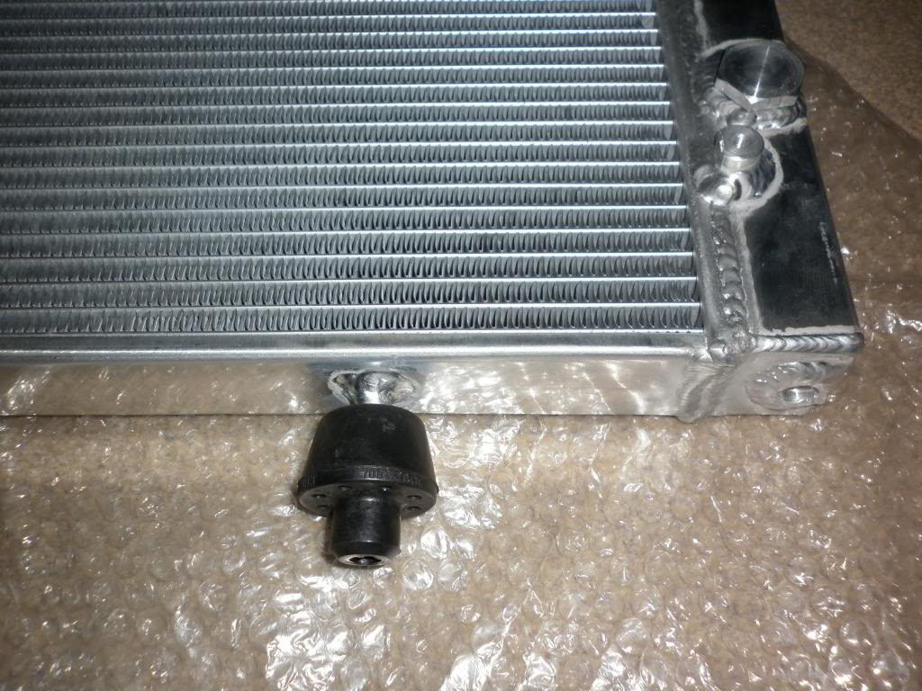

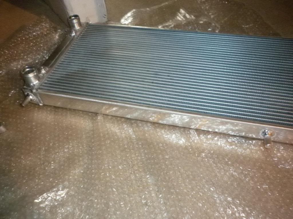

I had some pins welded to the bottom of the rad to use standard mounts.
Where can you get the rubber mounts from.? Mine are missing.
Renault, about £4 each, or somebody whos breaking a car.
I put a cable tie down through mine, so they don't disappear.
As Tony said, standard rad mounts.
James has a good way of fixing it, long rod on the rad that goes through the mount, repair washer on the underneath and then an r-clip to hold It together.
