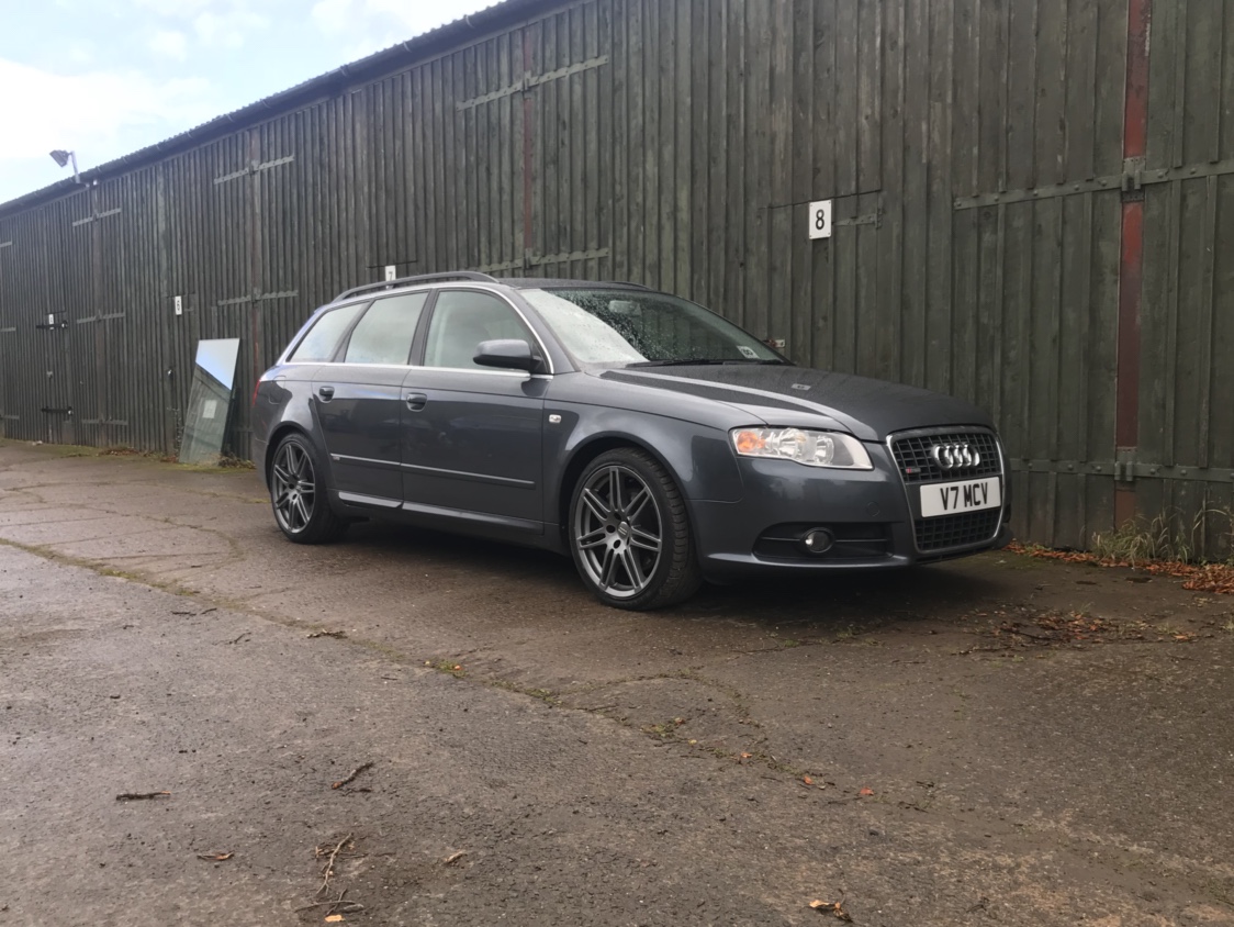

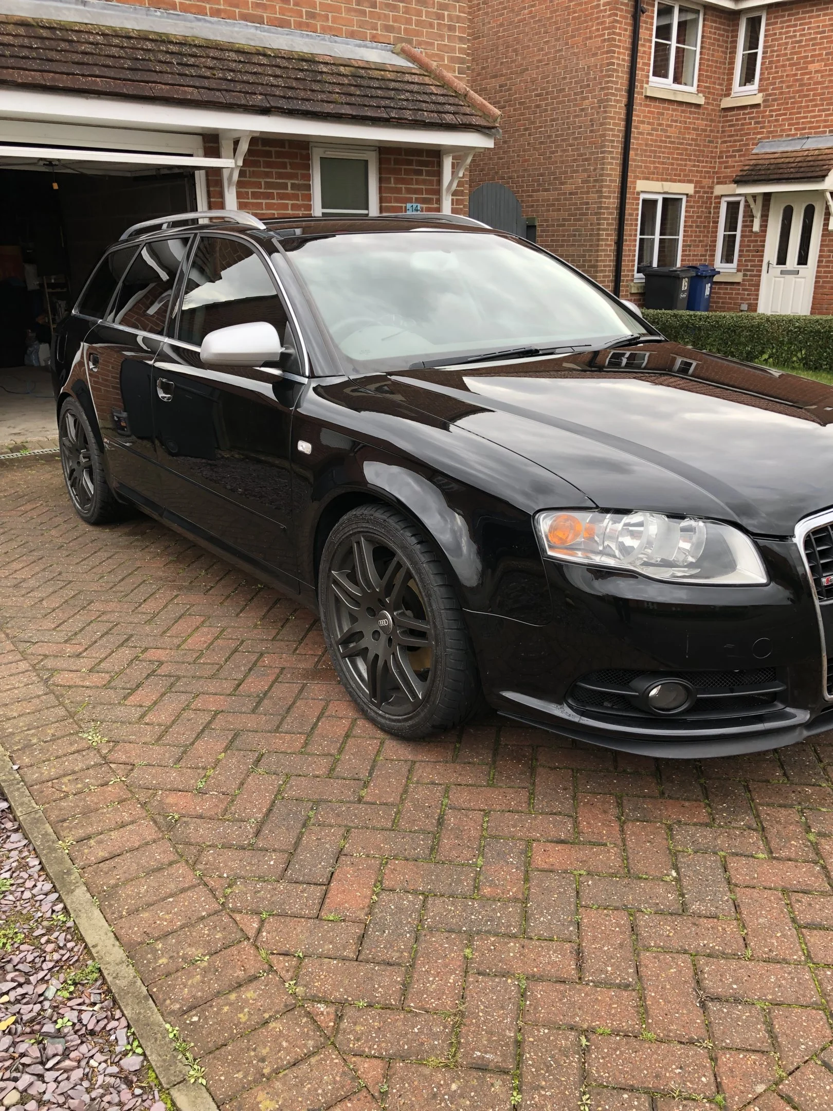

Thought I’d make a progress thread for this as I plan on keeping it longer than 6 months unlike all my previous car.

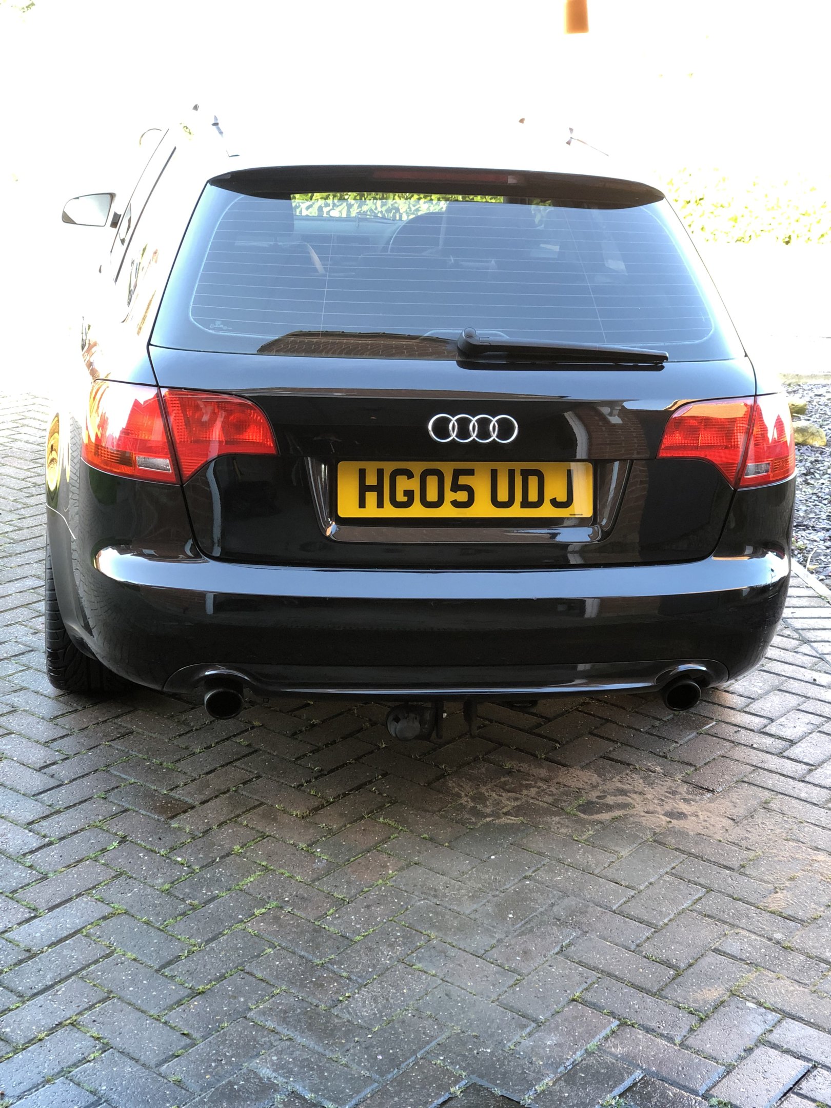

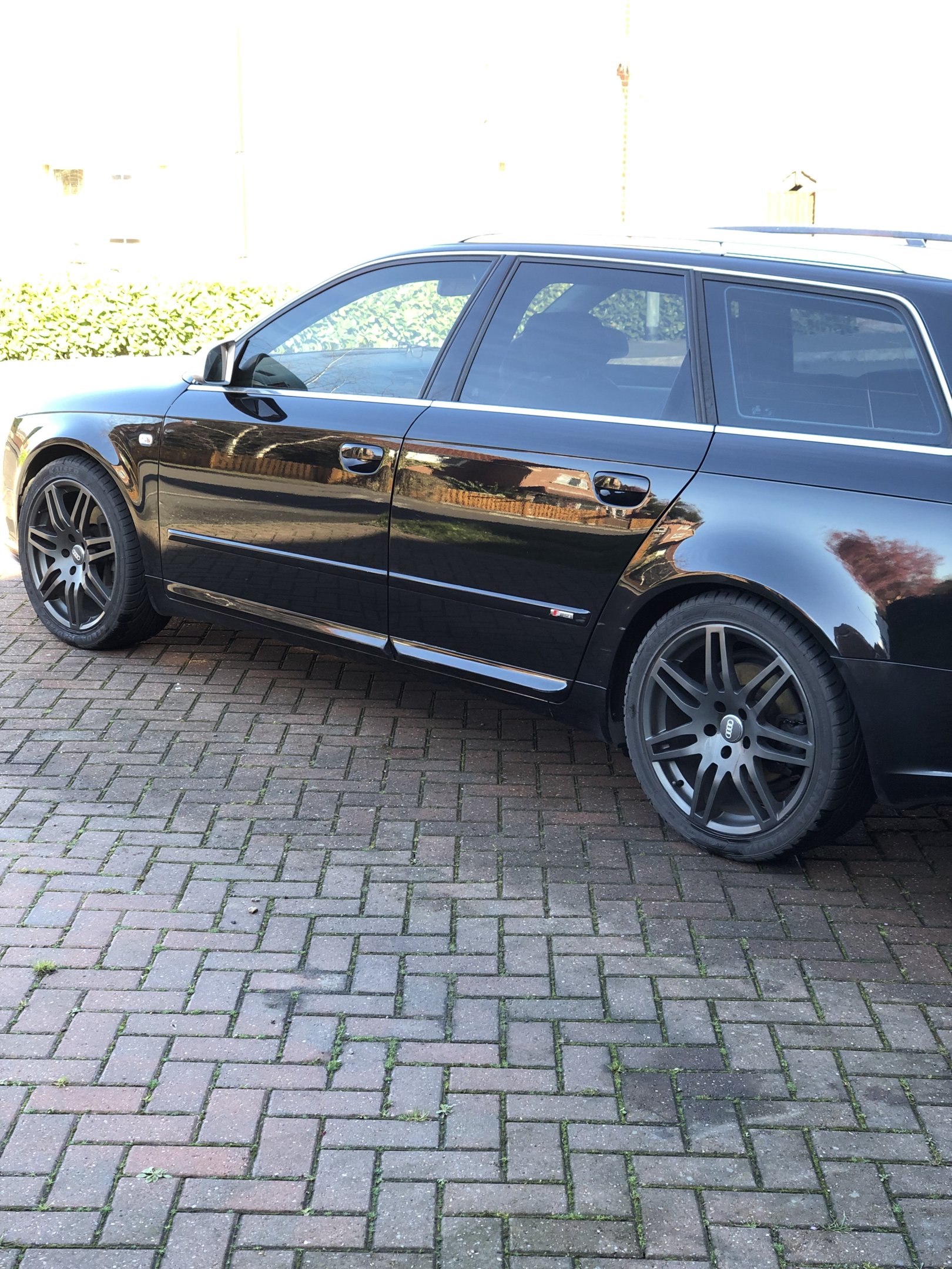

So to the car, yeah it’s 14 years old few dents and scratches but the paintwork it’s stilk in really good condition.
It’s the 2.0 tfsi so same engine as golf gti. Petrol VRS etc
Just over 106k and good service history folder full of paperwork. Also got 6month Warrenty with it thrown in from the dealer I got it from :)
1408231
1408232
1408233
Far as I’m aware mechinally totally standard, alloys and wing mirror caps are only “mods” that’s happened.
So far I’ve had the change a breathe pipe as it was leaking air.

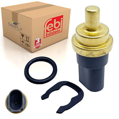

Change coolent temp sensor- got a fault cold for this intermittent signal

Decent mate, these engines really need a remap to bring them alive though. R-Tech are very reputable and cheap for the TFSI. Also if doing the lower coolant temp sensor you should really do the thermostat at the same time, upper coolant sensor is easy.
Ocrlew
Ahh thanks for advice, il look into R-tech for the map then.
Best get ordering more parts then haha! Not sure which coolent temp is erroring, just get intermittent reading fault
Don't think VCDS differentiates which sensor so I'd change the upper first to see if it sorts it, if not you know it's the lower and do the thermostat at the same time. If doing it yourself I can help with how to go about it as I've done it twice now ?
Ocrlew
Yeah will be doing it myself this weekend, any help be great haha. Il try top one then first. I think the engine in these is in different direction to yours tho as it’s in it side so to speak

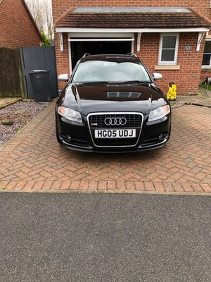

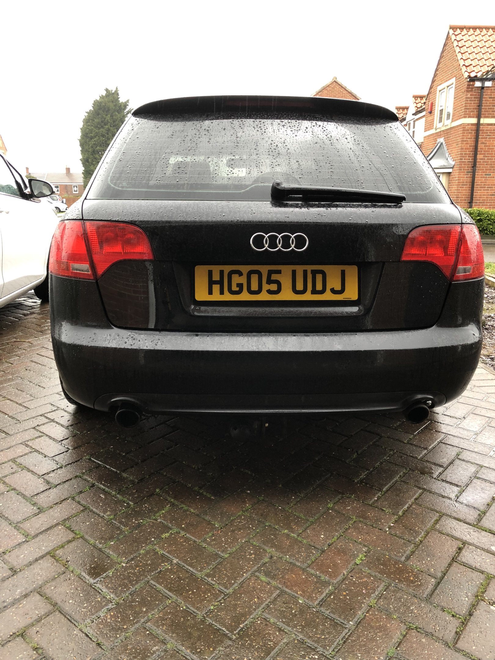

I wasn’t sure, I’m tempted to change everything to full black lol
Good grief no.
Silver, de badge and I'd probably put the mirrors back to standard as it's pretending to be an S4.. however those chrome caps go nicely with the rest of the chrome, against the black.
What are these standard ? ~200 I think ?
See if you can wind the bump stops in a couple of turns and it might help reduce that bonnet gap...

Good grief no.
Cheers for help will give that a try.
Haha tempted drug dealer spec, I think I will change wheels to silver or by a summer set as the tyres aren’t best make, so il see what come up for sale .
Yeah 200 standard so not too bad but as heavy does feel little sluggish

New bits on the way for this.
Forge pcv delete, pipercross panel filter and the coolant sensor.
Should get this fitted this weekend.

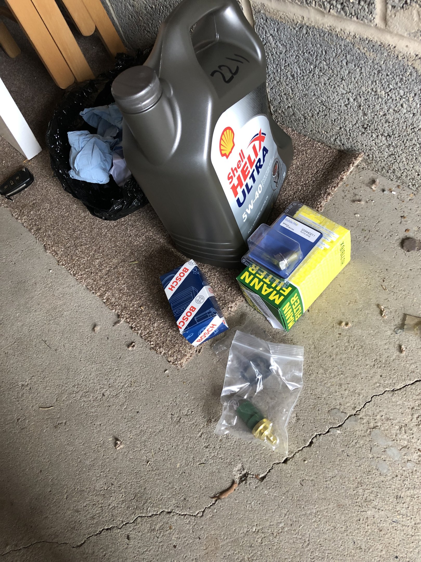

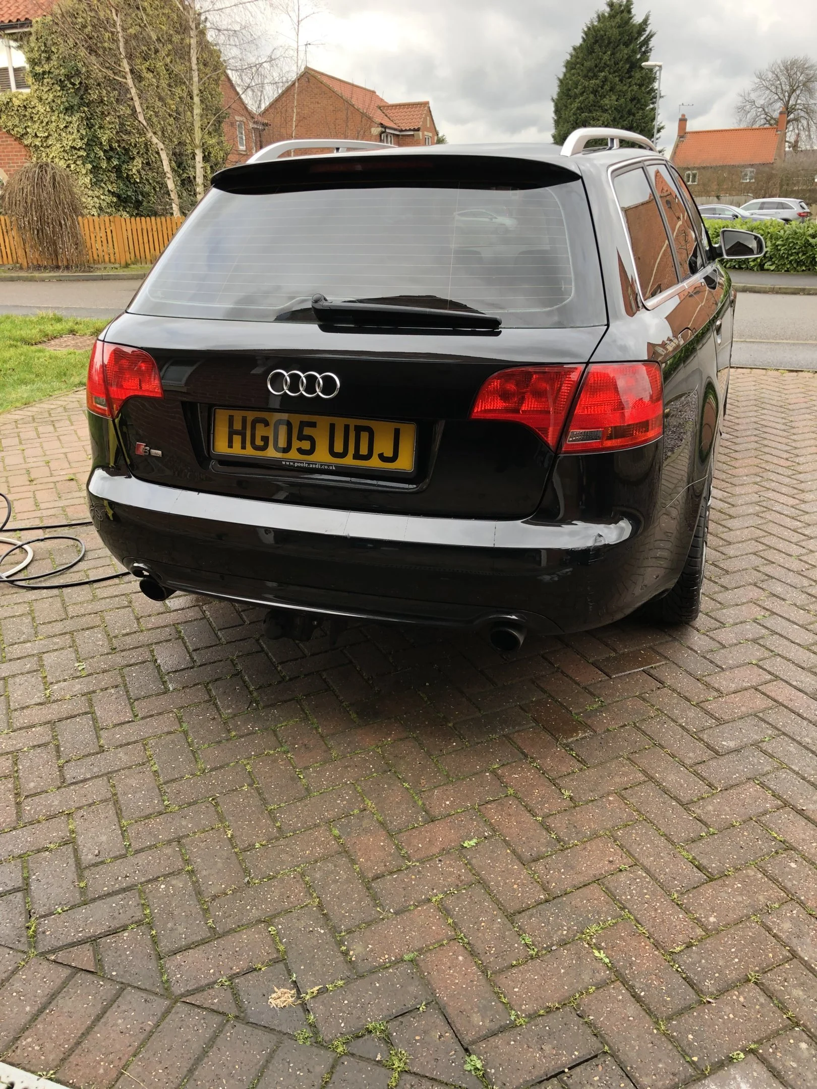

So got done a few bits today. Decided to do more than I thought so oil change and filter too
1408610

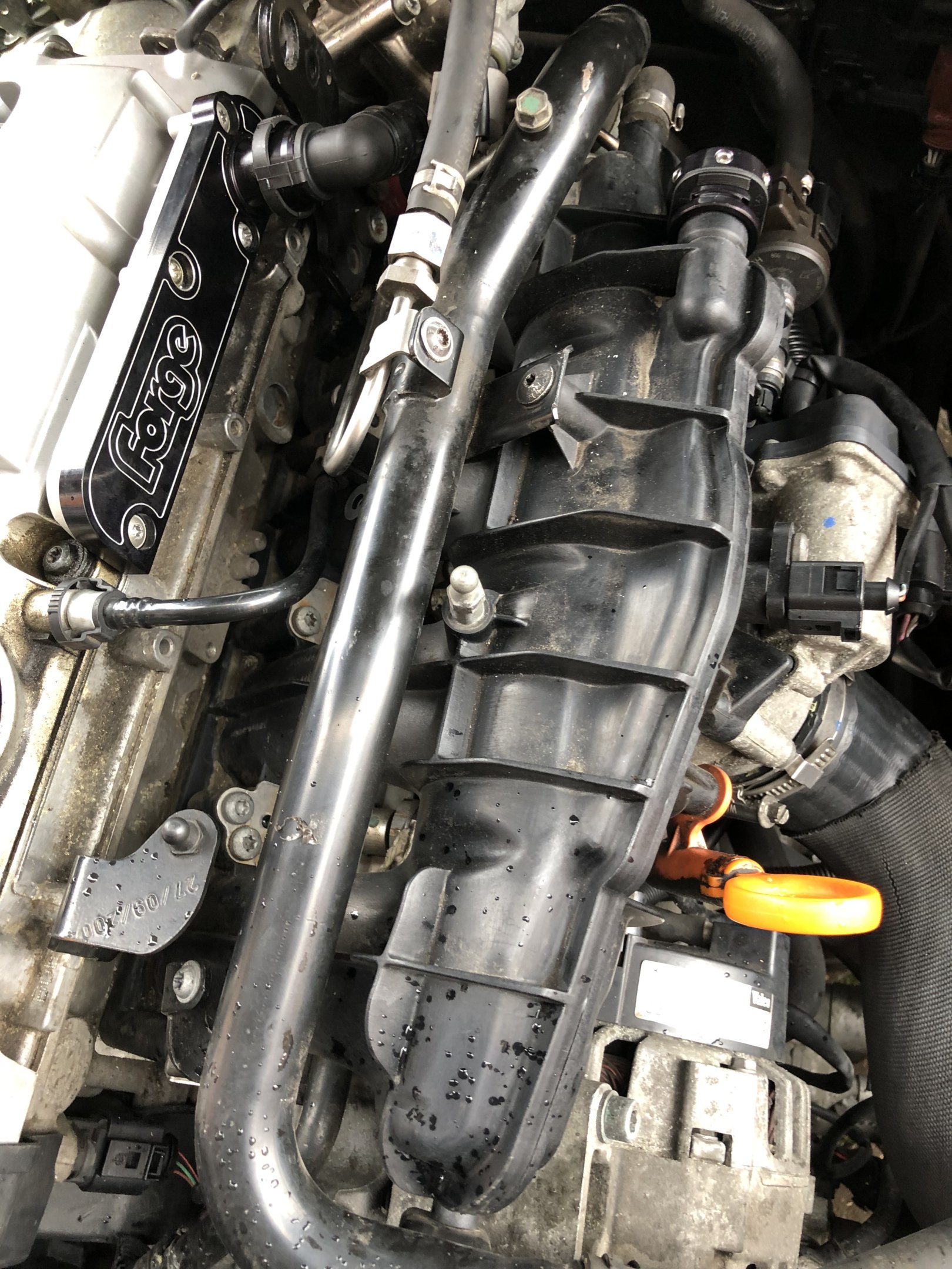

Fitted the pcv delete also! And what a difference it has made! Engine is a lot quieter now! Feels bit more lively too!
1408611

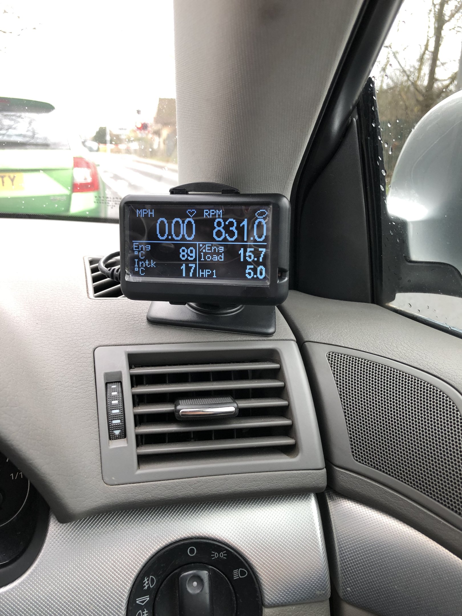

Also splashed out on an ultragauge. Great little bit of kit! Shame as this is an old car doesn’t have all the sensors in place to get the best out of it! But happy with it as can see warning codes etc

Oh and also taking the badge off at the back as! Soo once it’s stopped raining I’m polish it up

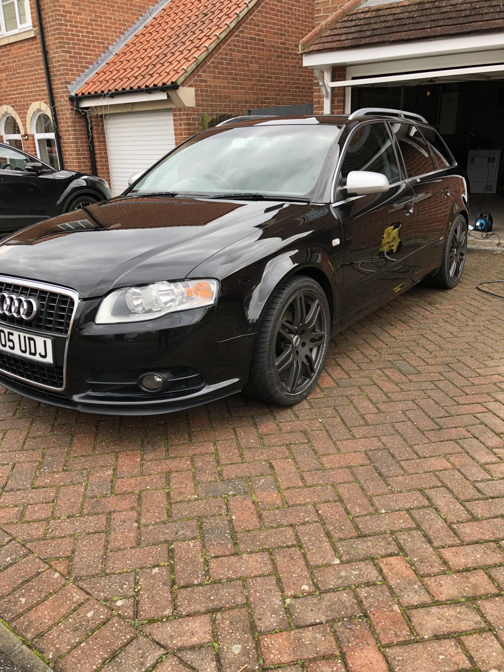

Sorted couple more little things today like the N80 valve and other fluid top ups!
Missed out on a DV+ diverter value :(
Gave it a good clean also!
It’s booked in next week to make it louder ??

Had the mid resonator chopped off and it’s make a little bit of difference, which is good. But maybe want it louder haha.
