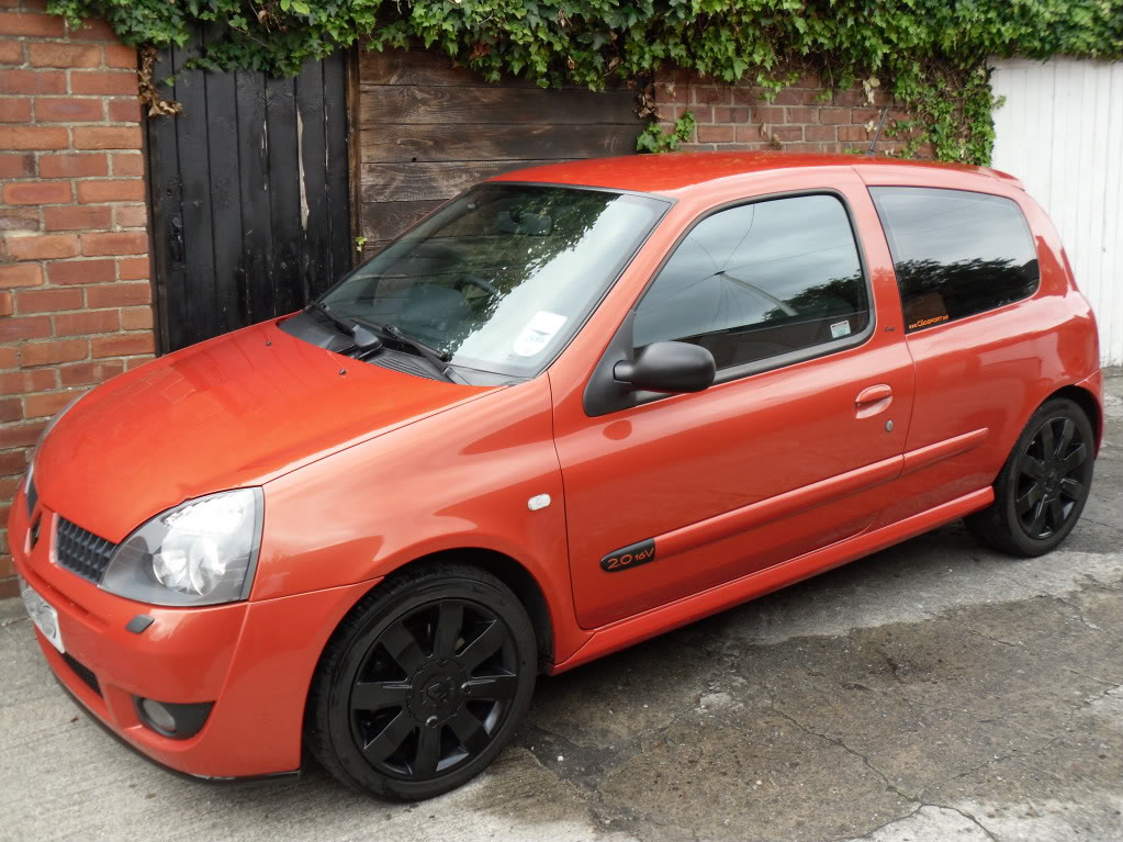

My clio currently looks like this
Due to an unfortunate incident with a curb during the frosty weather one of my alloys is badly in need of a refurb. Cant decide wether to have my original alloy refurbed in satin black again or wether its time for a bit of a change. Cant decide between a refurb and saving for some anthracite Turinis and then respraying all the badges in anthracite as well.

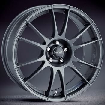

id get other alloys as the 182 ones are heavy and let no air to the brakes. oz ultraleggras look good and different to the usual turini crew.
I like the look of 182 alloys personally I would stick with the black it looks good.
Also no need for turini's etc unless you plan on doing track days.
Without a doubt. Unbelievably light and look the b****cks
15" weighs 4.7kgs :evil:
That's very close to half the weight of the standard 1*2 wheels, when you account for unsprung weight making roughly 4x as much different as 'in car' weight, thats about an 80kg saving..... worth every penny IMO!
Mine are being delivered on Friday ;)
Im trying to save up for mine. 16" which I will be having are only 6.4 kg. Should see about 3kg a corner weightloss on unsprung mass. Superleggera's are the same though. Wish I had the money to buy the ones for sale on here
tbh, I prefer the look of the superturismo GT's. But they're no lighter than the turini's really, so it was a no brainer.
Speedline Turini's weight 8.9kg's in 16x7, guessing that's the same as the renault turini's............
That's pretty bloody heavy!

Lighter wheels is better in every respect, the ultraleggera's are the lightest off-the-shelf non magnesium wheel.

OZ Ultraleggera's
Wolfrace Pro lites
Or any other suggestions, so far the ultraleggera's have been most reccomended :)
