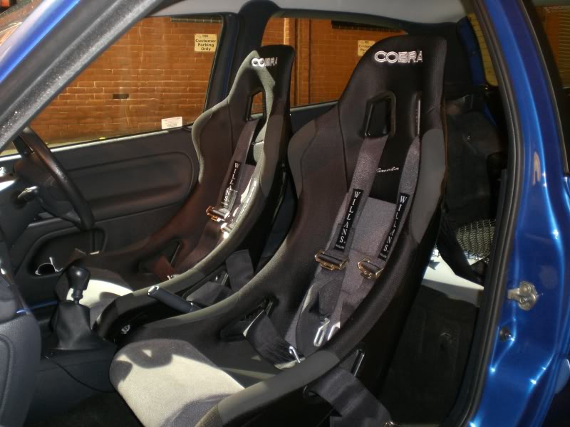

Cobra Imola ;)
I've never sat in the Bimarcos so can't comment on them, but I love my imolas! I do about 16k a year, including a lot of long journeys and I've never felt uncomfortable in them. Comfy, supportive, light and look really nice for the money! Got the Imola S myself which I think has been replaced with the Pro now.
Best bet is to try a few out to see what you like the feel of. If you're going to trax I'm sure they'll be a few people there that won't mind you having a sit in their's :)
