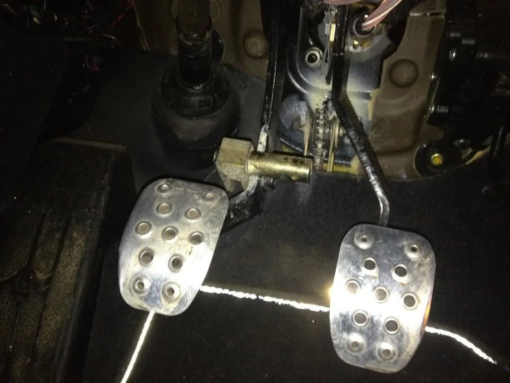

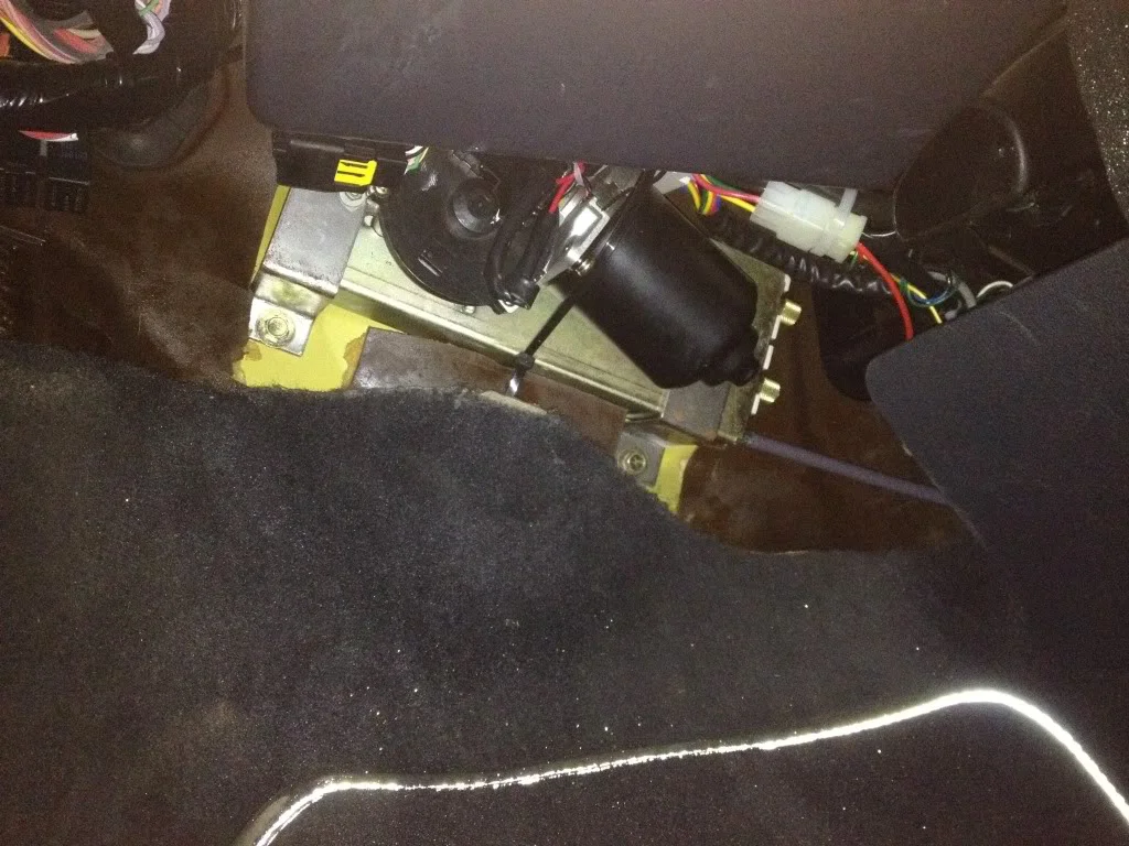

Duringthis inspection we make the first rather odd discovery. A stray sensor on thedrive shaft, that leads to a whole load of weird looking bits and pieces boltedbeneath the dashboard and to the pedals. On closer inspection it would appearthis is a kit to electronically operate the clutch that has been fitted andhalf removed. Perhaps not the end of the world but I would rather not have allthat on my car.

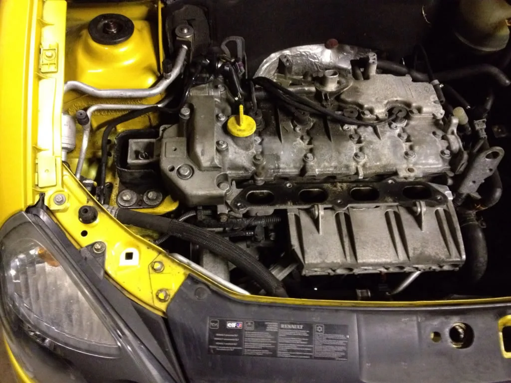

We thenmoved on to looking at the engine bay, which is when Fred gave me the brilliantnews that my 2004 182 in fact had a phase 1 172 engine.

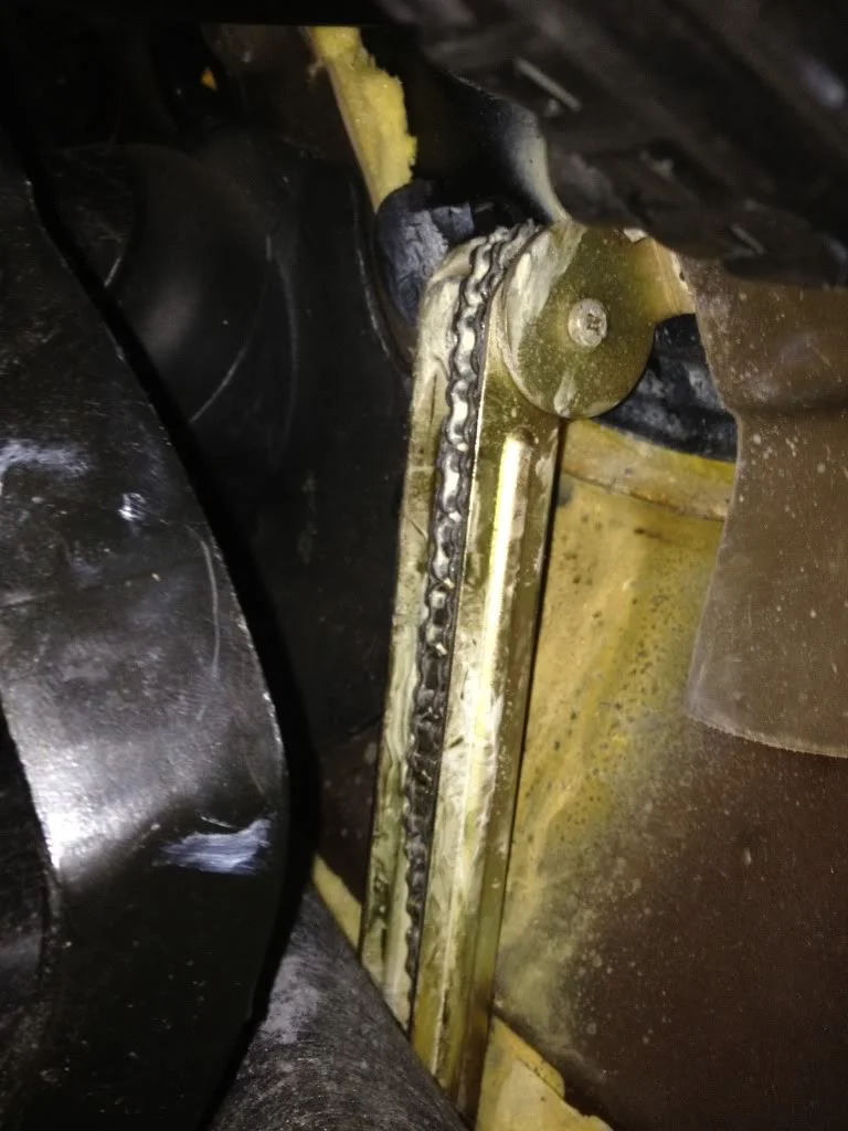

We traced the wire back through the bulkhead into the vehicle and to our surprise found a very bizzare installation under the passenger footwell carpet and strange moddifications to the foot pedal on the drivers side
passenger footwell installation image - http://s200.photobucket.com/albums/... Inspection/?action=view&current=70927ad3.jpg
clutch pedal moddification image - http://s200.photobucket.com/albums/... Inspection/?action=view&current=83640b0f.jpg
chain mechanism behind clutch pedal image - http://s200.photobucket.com/albums/... Inspection/?action=view&current=625bcf4a.jpg
After a bit of investigation we found the car had been installed with an electronically activated "twin clutch" aka - the vehicle at some point had been moddified for disabled user.
The problems highlighted thus far are relativley easy to rectify, removal of the motability unit we estimate at approx 3 hours, a new starter motor heat shield is £48 and takes 1.3 hours to fit.
On further inspection of the engine bay we found a few relativley major issues - the main one being that this 2004/2005 182 (F4R 738 engine) car has been fitted with a 2001 engine from the older 172 (F4R 730/2/6 engine)
as you can see from the following images -
note the raised breather tube in the middle at the back 172 engines had this, 182's did not - http://s200.photobucket.com/albums/... Inspection/?action=view&current=047ec81c.jpg
To compare, a 182 engine looks like this - http://s4.photobucket.com/albums/y116/Fredmrsclio/?action=view&current=182engine.jpg
date sticker on the rear of the block (VO54) ending in 01 - http://s200.photobucket.com/albums/... Inspection/?action=view&current=20982ca8.jpg
Without doubt this car VO54 has been fitted with the incorrect engine and isn't worth anywhere near market value
