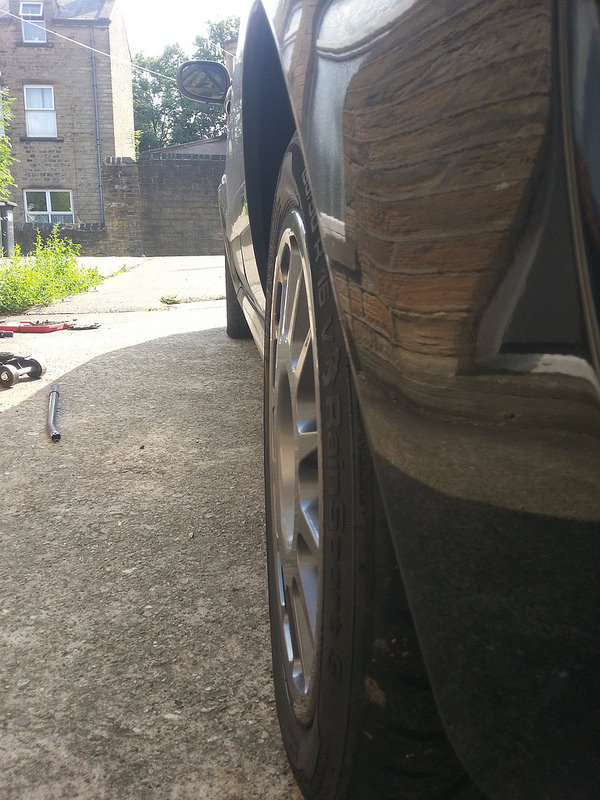

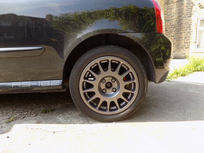

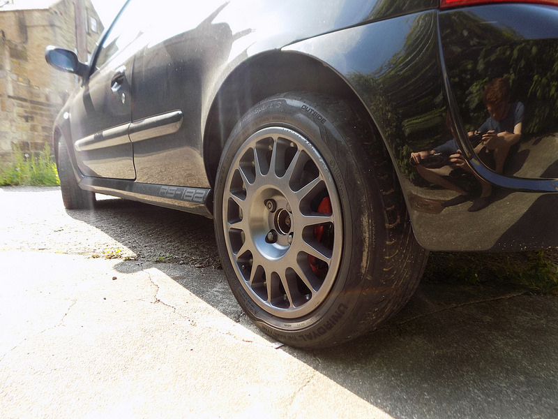

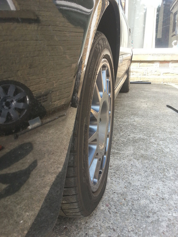

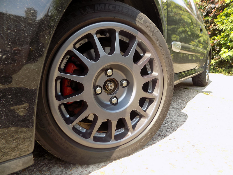

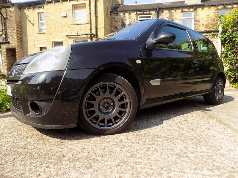

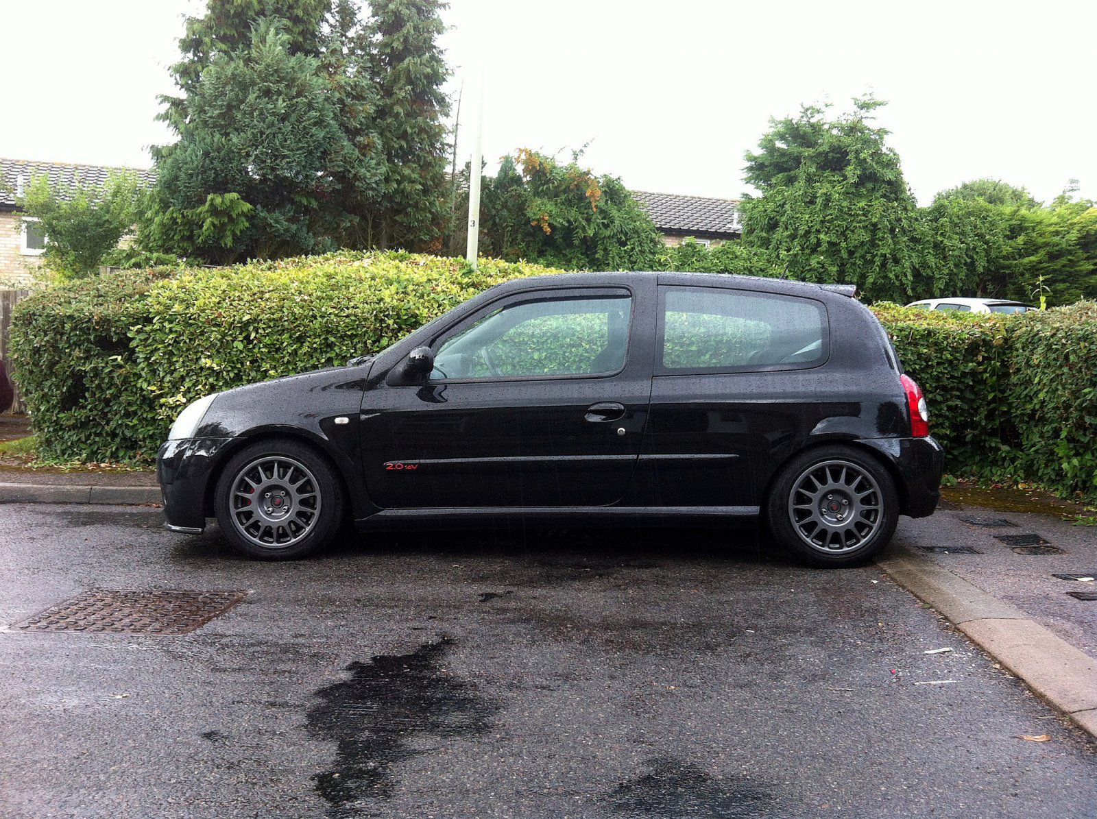

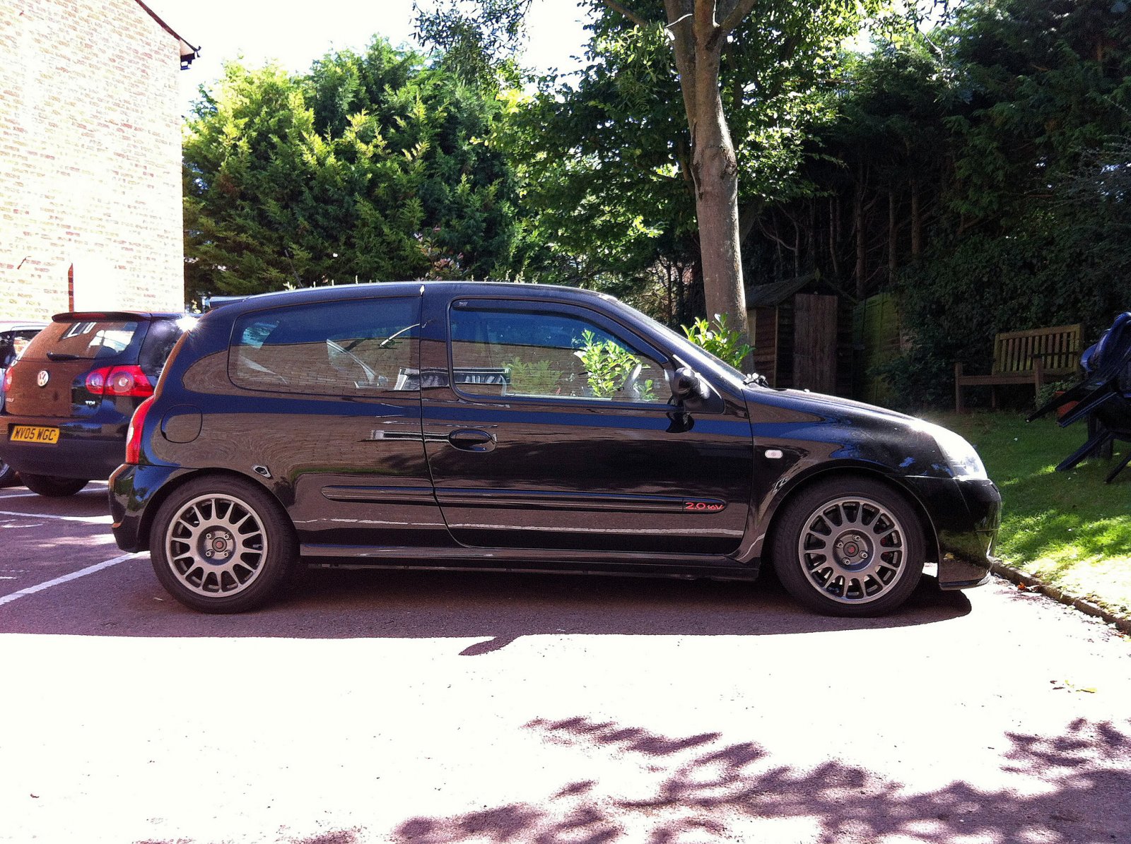

And I am over the moon with them! Excuse the fact you could fit your head in the arch gap and the low tyres but these are things I will be rectifying in the not so distant future. The plan is to get some fresh rubber on them (cheap tyres yay!), fit some rear axle spacers and then lowering springs. I'd love bilsteins but think that'll be a while off. Refurbs of the wheels could be a plan for the future, but they have only a tiny amount of curbing and i'm not fussed as the car isn't minty mint.
Spacer wise, I'm thinking 15mm rear, 20mm front? This is how it looks at the minute, but when lower it'll obviously tuck even more.

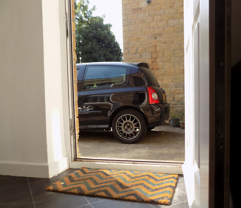

20170619_163649 by Louis Walker, on Flickr
20170619_163715 by Louis Walker, on Flickr
Thanks @cs_dave for the smooth transaction, just got to get remnants of old plastidip off which is proving a pain on the insides.
C+C's welcome!

Dat arch gap tho!
They do look good though, even with your car being that high, they'll obvs look better with lowzzzz.
What ever spacers @Dr Jekyll has got on his to make his final offset, go for that. Although his 2118s will have a different offset to yours so you'll need different size spacers but as long as you get to the same final offset itll be sweeeet.

Dat arch gap tho!
It had just come off the jack in the pictures too, so once settled looked a little better but still mahoosive. I'm not running these anyway for now as the tyres are on their last legs and it'd look silly.
Sounds good on the spacer front as @Dr Jekyll's look great. Believe these are et43 but I know Mark got some super special ones.

@Louis' The car looks awesome on the 2118s. Best colour with them suited on BG :cool: Will you be adding some decals to them? And/or the "center caps" like mine has and also had on my old BG?
I'd be sticking with 10mm axle spacers for yours and 20mm fronts. I have 16mm fronts amd 5mm wheel spacers on the rear (i chose wheel spacers as i have the center caps and I needed to fill the gap as they pertruded a bit, and the axle spacer wouldn't have pushed the wheel out closer to the caps) but as others have mentioned, mine are et38 so stick out 5mm wider. So my 16mm/5mm on et38 would be pretty much the same as 20mm/10mm on et43. Does that make sense?

Always wanted them anthracite as they do look the best on bg! They did come with some centrecaps the same as yours yeah, will probably give them a lick of paint and see whether I like them on or not. Did you hold yours on with silicone? As these looked to have had some on. Not sure on the decals however you can see the remnants of them on the wheel where they've faded. A go over with a DA would get rid i'm sure. Unsure on what colour would suit, unless I just went for a slightly darker anthracite.
Makes sense on the spacers, cheers Mark. I presume I'll need longer bolts if fitting wheel spacers, but would probably just upgrade to studs anyway as I hate having to mess around holding the wheels up when changing them.

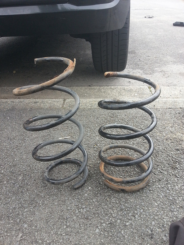

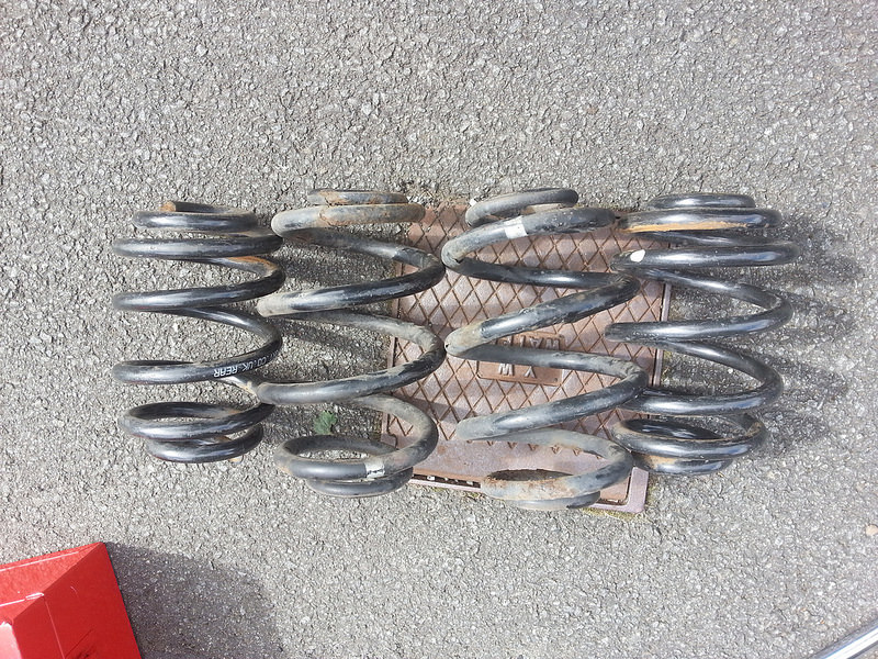

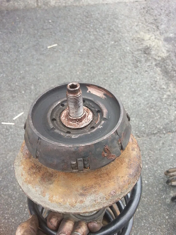

I picked up a set of Cooksport springs, as although I want to eventually make the change onto b14's it made sense to get these in the meantime. It turned out to be a good decision, as upon removing the front shocks i found that someone had replaced just one side with a completely different spring. What I believe to be the 'original' also had a coil missing which isn't ideal.
20170820_151409 by Louis Walker, on Flickr

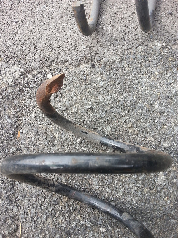

The two front springs together that were on the car...
20170820_151332 by Louis Walker, on Flickr
I fitted the new springs and re-assembled with plenty of copper grease as I had to weld up a tool then use a 2 metre steel tube to get enough force to undo the top mount on one side. Must have been gunned on wayyy too tight in the past and also seized up.
20170820_152518 by Louis Walker, on Flickr
Cooksport and standard springs together.
20170819_113145 by Louis Walker, on Flickr
No pictures of the final stance but it's a million times better now than it was! No scrubbing either with the 16's which is a nice surprise. The car feels a lot more confident during turn in, which wont have been helped by the mis-matched front springs that were on before. Have no complaints about how comfortable the ride is either.

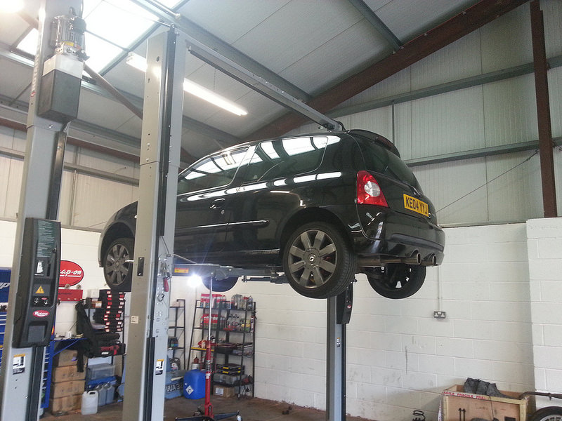

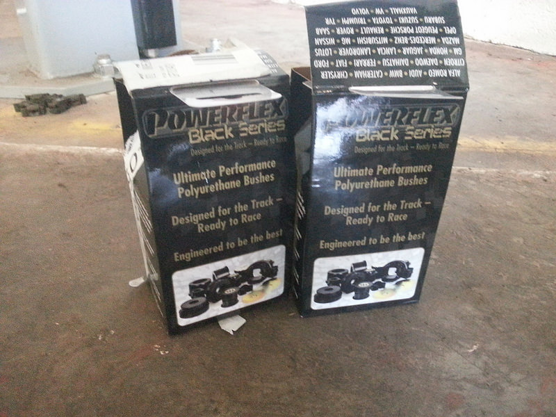

After this messing around I took the car to my brothers work and got it on a ramp to fit my black series ARB bushes. What a pain in the arse they were but after a couple of hours of messing around finally got them fitted and the screws back in place. Crow bar is the best way with these.
20170819_171326 by Louis Walker, on Flickr
20170819_171613 by Louis Walker, on Flickr

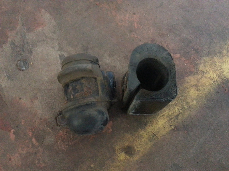

The new
20170819_171120 by Louis Walker, on Flickr
20170819_171101 by Louis Walker, on Flickr

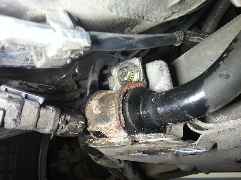

The old
20170819_171148 by Louis Walker, on Flickr

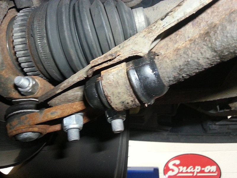

Whilst on the ramps, it was clear the tracking is out on the NS and has started to wear the inside of the tyre. These were swapped front to back, and I have some tie rods/track rod ends on order as both were knocking. Bearings felt fine with no rocking, so thankfully these don't need doing! Spacers and stud/nut conversion to fit too.

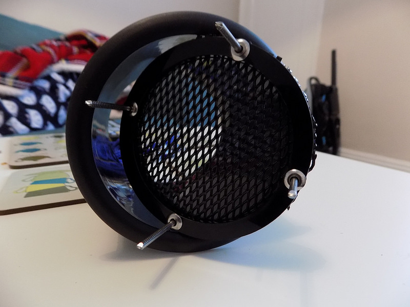

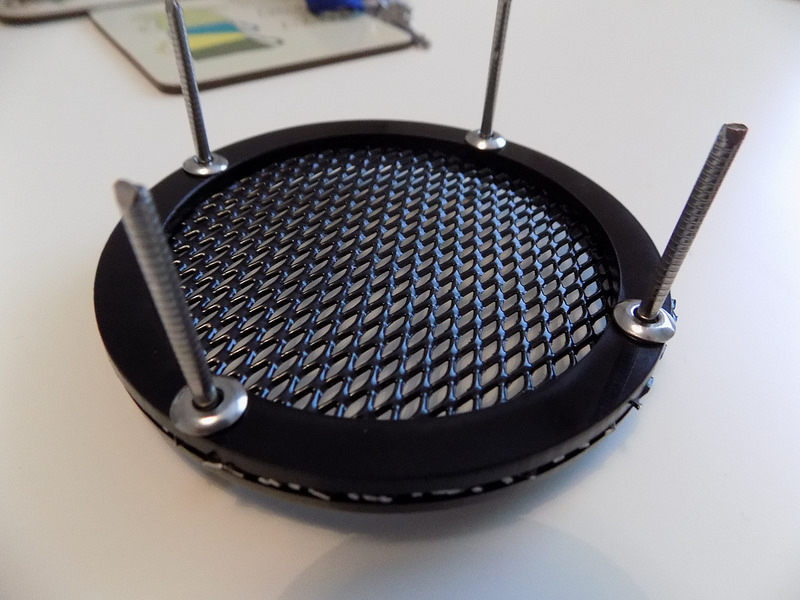

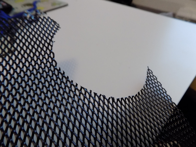

Something else I've been meaning to do for a while was mesh in the front ducts, similar to those of @Dr Jekyll's.

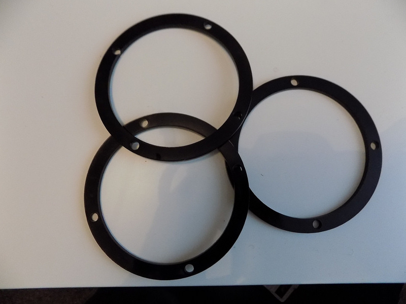

I lasercut some 3mm acrylic framework
DSCN0479 by Louis Walker, on Flickr
Then using that as a template snipped out some 98mm mesh discs
DSCN0482 by Louis Walker, on Flickr
Everything was going to plan when drilling the mesh and lining up my pop rivets
DSCN0475 by Louis Walker, on Flickr
DSCN0484 by Louis Walker, on Flickr
However the rivets were far too heavy duty and snapped the acrylic. I did see it coming, and have ordered some small cap head bolts instead which will hopefully work and look great when all together. Will update as I get them built up.

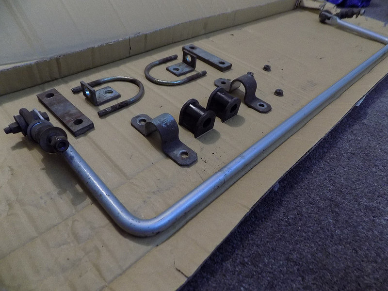

My parcel also finally arrived! A Whiteline ARB with the added bonus of what looks to be black polybushes. Someone please correct me if i'm wrong but they're pretty stiff and look different to the yellow ones I've seen on most. It's been used previously on a hillclimb car but it doesn't look to have seen too much abuse with the original silver coating still in great condition. The brackets are slightly rusted, but I'll be sanding these back and respraying them before fitting it onto the car.

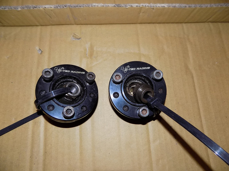

Not only this but I picked up some Ktec solid top mounts to compliment the Cooksport springs. I'll be degreasing and replacing the bearings before fitment making them good as new!
