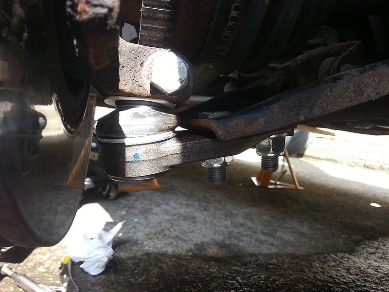

I also changed my front lower balljoints on both sides to some new lemforders which solved the knocking I had been experiencing from my front end. Nice and simple job that has improved the car quite a bit (worth it to get rid of the knock alone).

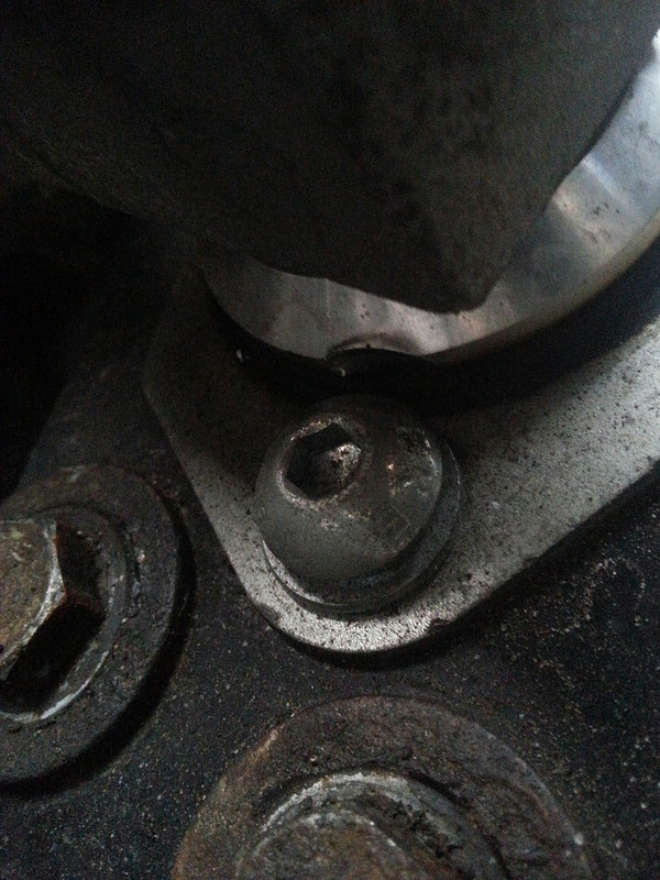

I had also found that my engine mounts were not torqued up properly, and there was no washer/flanged nut where there should have been which had led to chavelling up the mount. I retorqued it all and added a washer, so fingers crossed that is solved. Not sure whether this was recent or with a PO but it had clearly moved enough to dent the mount from the torx bolts.
20170530_203737 by Louis Walker, on Flickr
Is it common for these to become loose with the added vibrations from the engine through KTR mounts? I had my belts done at Micks recently and presumed he torqued it all up correctly?

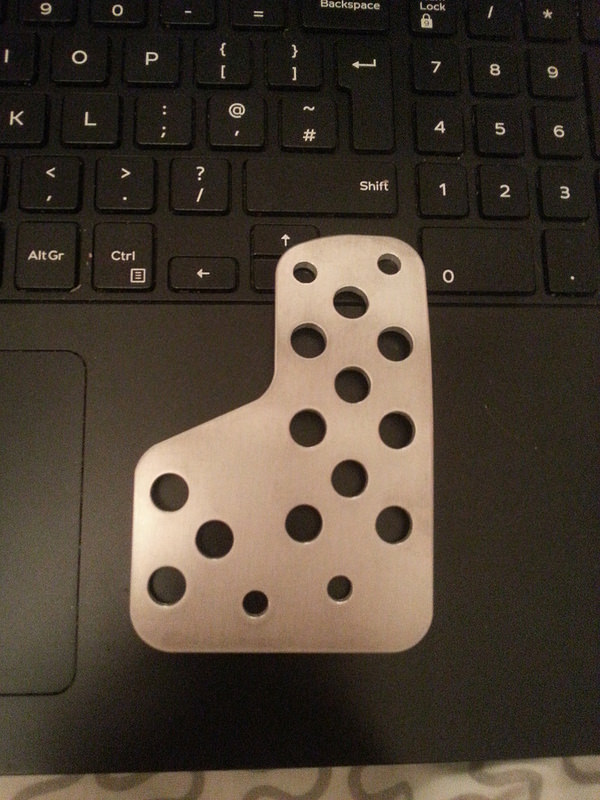

Another thing that turned up today was this lovely heal and toe pedal (that CSOC don't believe exist...) that I will fit when I find my rivet gun.

What type of knocking did you have Louis?
When going over bumps in the road and speed bumps it would knock from the offside quite loudly. The old ball joints felt knackered and had a fair bit of play.
