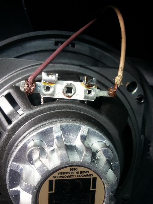

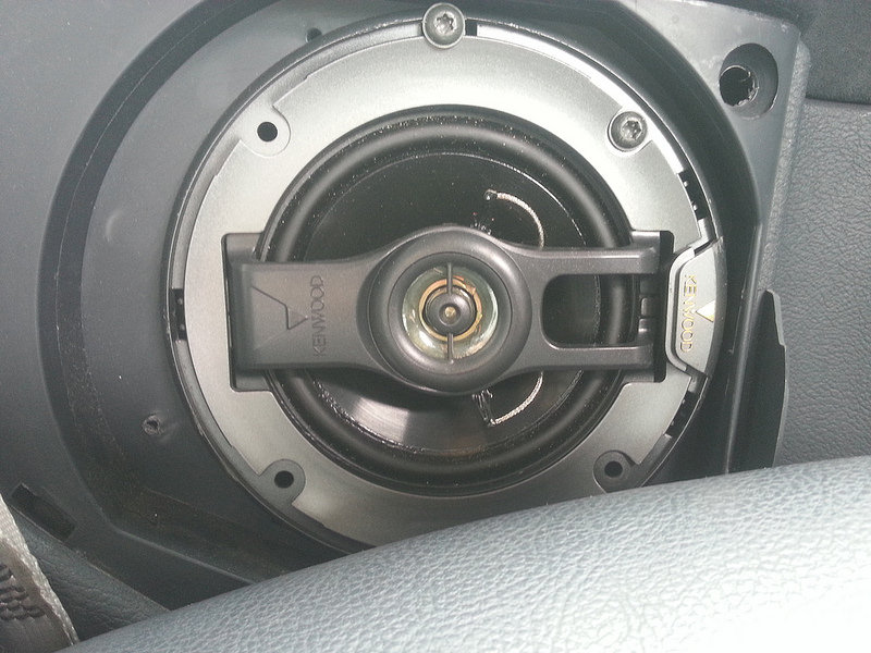

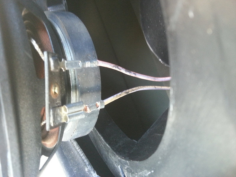

Thought i'd take a look at the speakers at the rear, and found that they were in fact a pair of neodymium Kenwood speakers and not the original renault that I thought. They felt lightweight, but being neodymium this seems the norm although I think they're quite old but they will do for now! What I did discover was that all the speaker connections were just made via twisting wires and after getting a multimeter on each one, found a front speaker had been wired in backwards.
20170613_144656 by Louis Walker, on Flickr
20170613_143812 by Louis Walker, on Flickr
They were also just fitted with two screws and rattled around!
Cut the wire back and fitted spade connectors and the speakers actually sound better together. Always felt like it was wrong as at loud volume it sounded crap and was quite painful to listen to. Sorry for the rubbish pics.

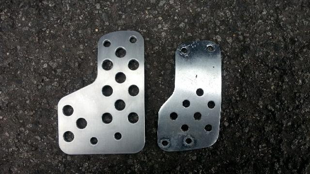

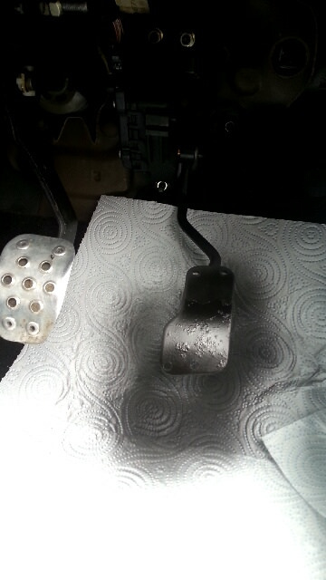

Decided to drill out the rivets of my accelerator pedal and gave it a lick of paint as some peeled off when I removed the old pedal. Won't be seen apart from through the holes of the new heal toe anyway.

I didn't have the correct rivets to re-fit, but some are on their way.

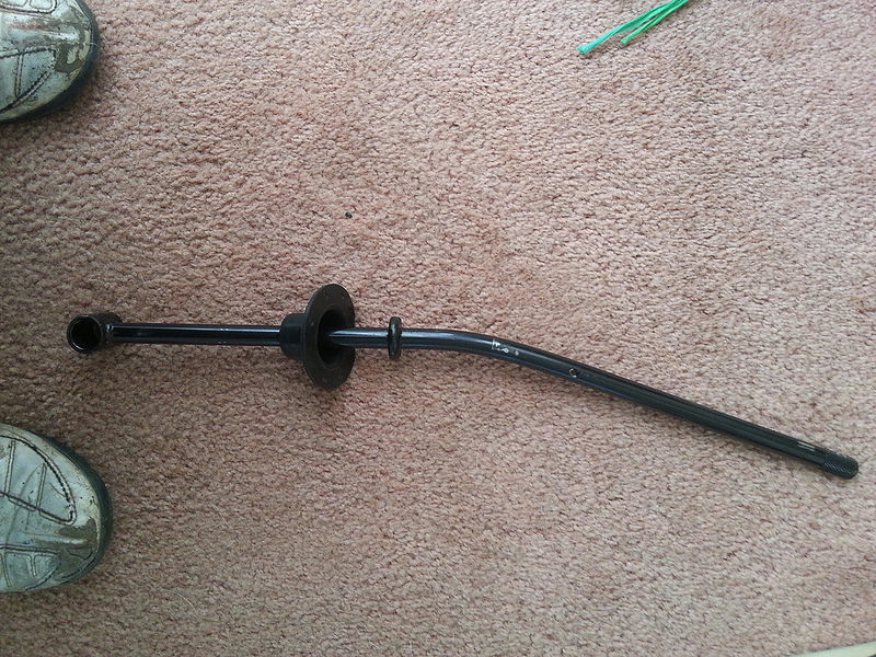

Modification of my scenic shifter is also on the way, with a bend added. Just need to extend and weld the bottom next then I can re-assemble.
