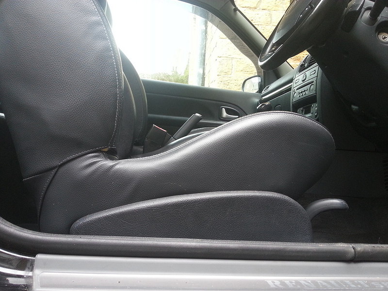

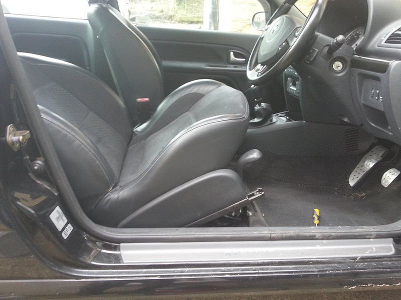

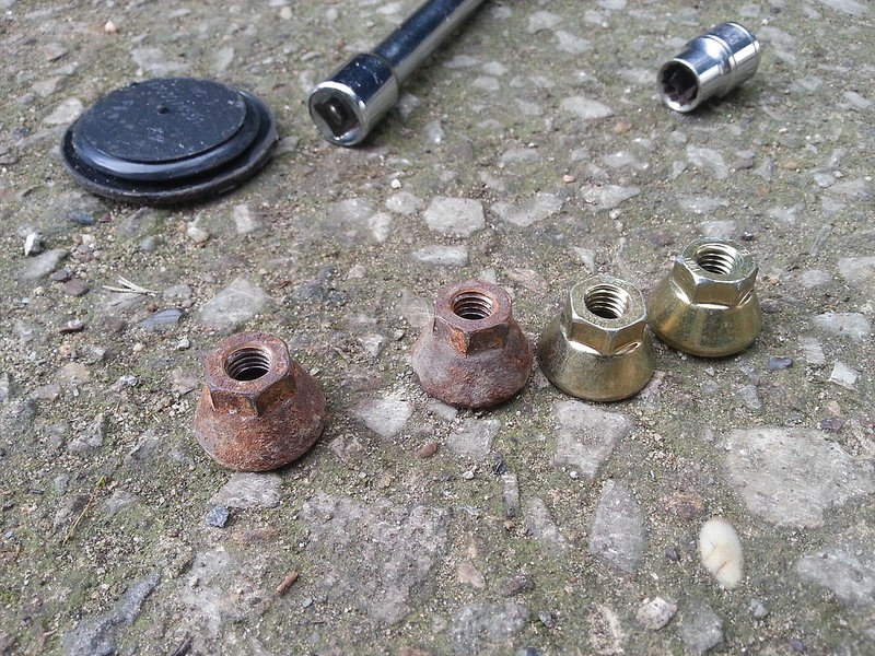

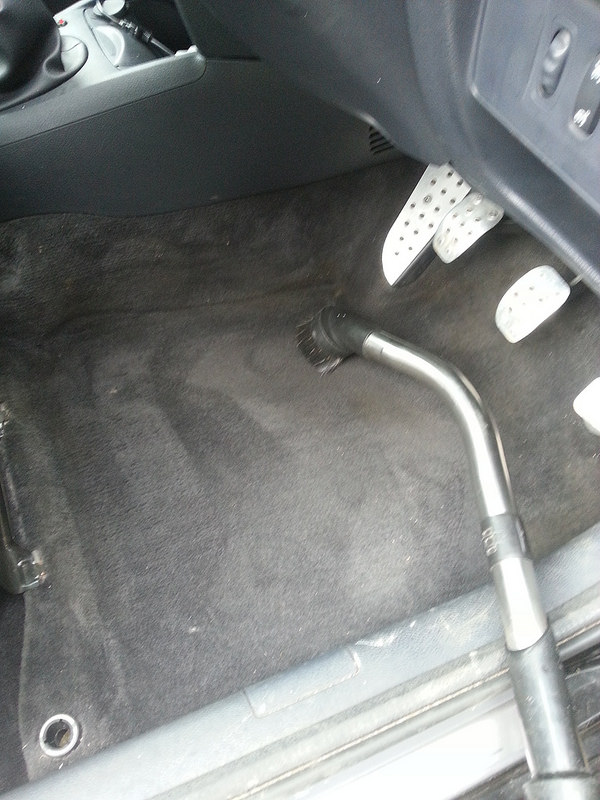

The sun was shining today so tackled the job of lowering my drivers seat a little as it's like i'm sat on top of the car.
Removed the nuts, the exposed ones putting up more of a fight than the others.
Seems stupid how they're just open to the elements? I wire brushed the seat studs anyway and later refitted with lots of copper grease, so hopefully easier next time.
20170217_131711 by Louis Walker, on Flickr
Pivoted the seats
20170217_131919 by Louis Walker, on Flickr
Whilst I was there... Looked to be some mould underneath the drivers seat, so glad i've managed to get rid of that!
20170217_132125 by Louis Walker, on Flickr
Spacers out.
20170217_134753 by Louis Walker, on Flickr
I cut them down on the other side so that I had no exposed metal when looking down but it didn't add anymore height so it's OK.
And back together...
20170217_142139 by Louis Walker, on Flickr
Fairly simple job, but it lowered down a little. Had to re-adjust my rear view mirror so it's clearly lower. I want to go even further down really, but i know that's not happening with standard seats. Does feel nicer to drive though which is a bonus for a free mod. Got my MOT next week though, so will have to tell them not to move my seat.

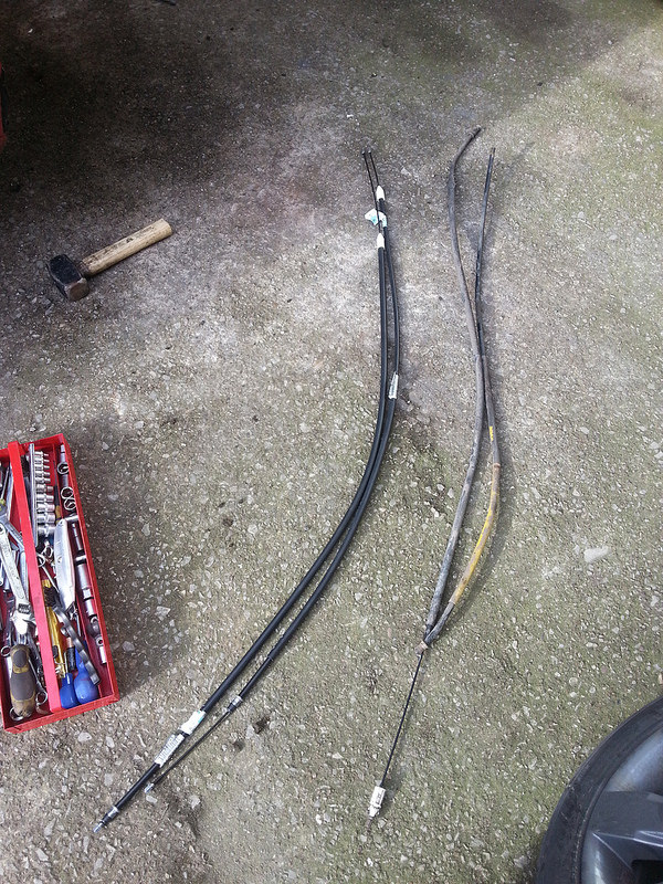

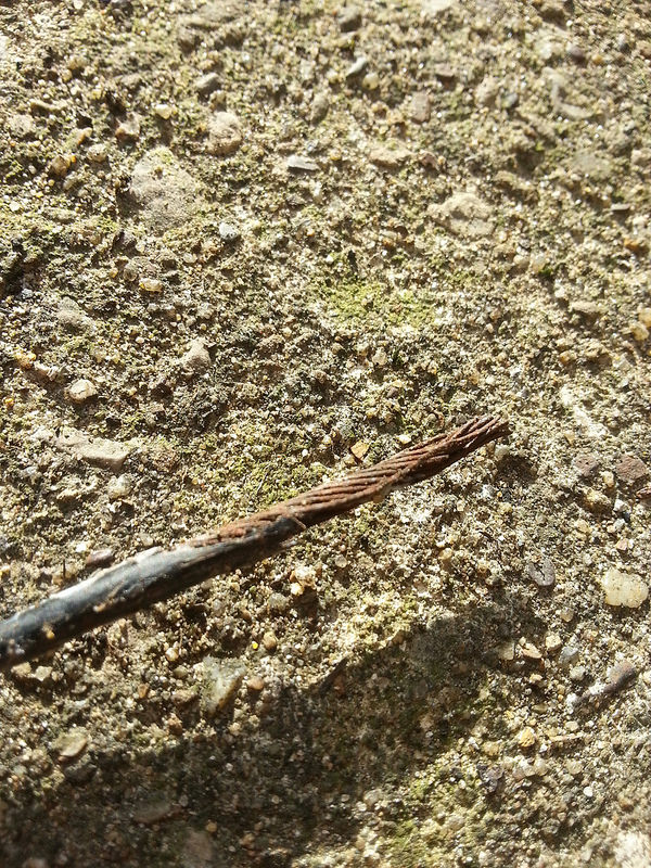

New handbrake cables fitted today. Unfortunately a bolt snapped on the heatshield, and another had been snapped by a PO. Will have to get these drilled out properly as I don't know how much of a good job my cables ties will do.
20170222_141958 by Louis Walker, on Flickr
Yep, snapped.
New and old... Looked like the one that snapped was the original but the other had been replaced not so long ago. I decided to do both anyway, just in case.
20170222_143536 by Louis Walker, on Flickr
No pics of actual fitment, but you get the idea.

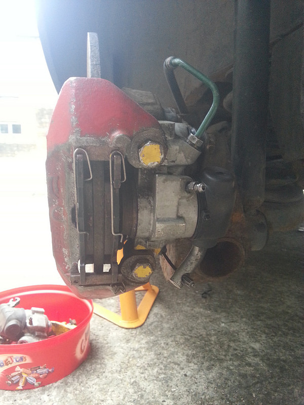

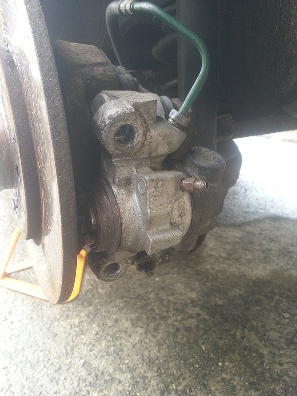

Sooooo, from my last update I got my cat fitted and took the car for MOT. Where I promptly failed on emissions (Lambda high), inefficient rear parking brake (by 1%!) and headlight alignment.
Got the car home, set about rebuilding my rear brakes to see where the problem was as I had just fitted new handbrake cables on both sides so knew this wasn't an issue. Discovered upon stripping down, and advice from other members on the forum, that it was the caliper that needed replacing as the handbrake mechanism inside had seized up as it no longer moved the piston until at the end of its stroke. Then it was only a small bit of movement. Thanks to @optical for showing me his calipers and the workings of the handbrake mechanisms.
20170304_094211 by Louis Walker, on Flickr
Decided to just buy some working 2nd hand calipers from @James363 and save any hassle for the time being.
Cleaned up the NSR as this was the one I was having problems with and managed to get it fitted and bled today as the weather all week has been crap.
New calipers on and all greased up... Going to buy some paint for my calipers when I get chance.

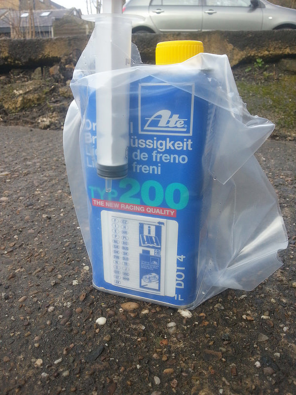

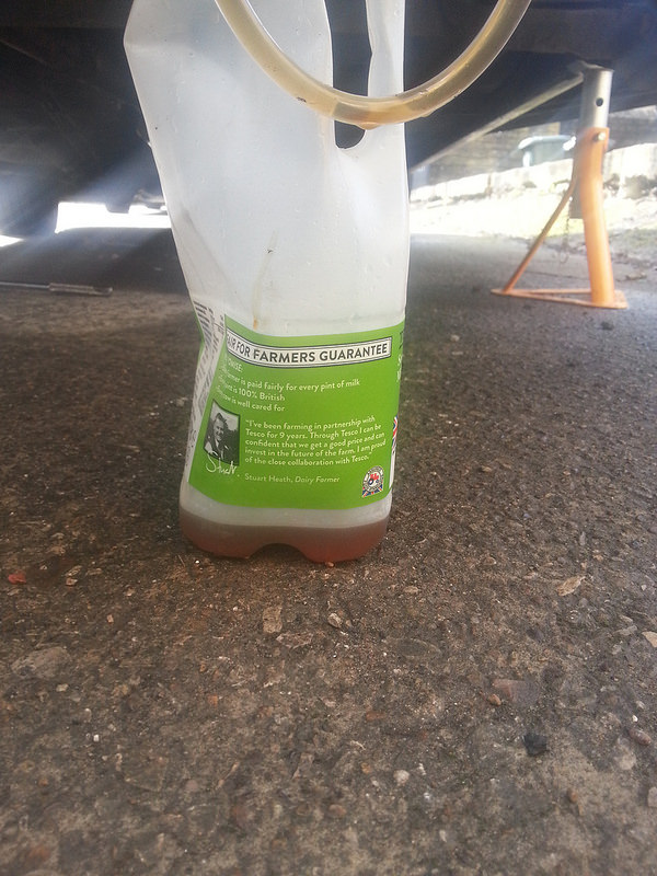

Fresh ATE Typ 200. Going to flush the whole system of the old at some stage this week, but just was a little pushed for time today so settled on bleeding the rears only for now.
20170304_094425 by Louis Walker, on Flickr
The fluid looking a bit crappy. Not sure how long it changes to looking like this though to say when it was last changed. I'm guessing a while? Least it wasn't black. The one man vizibleed was really good for the £3 it cost! Proper bargain.
20170304_115521 by Louis Walker, on Flickr

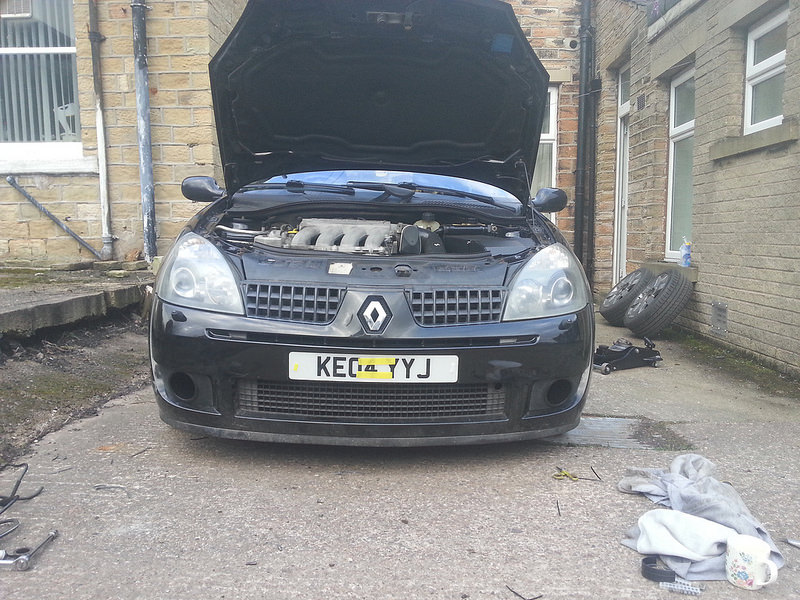

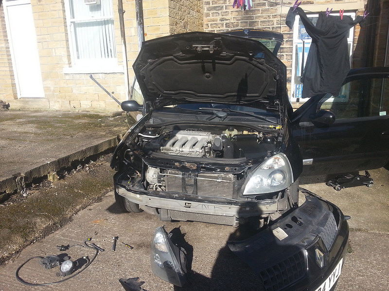

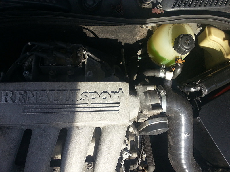

I then set about removing my front bumper to get at my carbon canister solenoid as it continued to tick. Shoved a bolt in both sides of it and silicone it all up so fingers crossed that'll be the end of that!
I also, after seeing @Dr Jekyll's setup, completely removed the inlet pipes that I had just blocked up with bolts from the canister and the solenoid. I looped a bit of piping round and under the throttle body. Makes me happy knowing there's less unnecessary pipes everywhere. Getting the bumper off also allowed me to tie back the wiring properly out of the way.
20170304_135013 by Louis Walker, on Flickr
20170304_133617 by Louis Walker, on Flickr

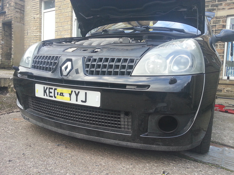

I adjusted the headlight too whilst I was at it so fingers crossed it'll pass, otherwise i'll just get them to align it on the machine.

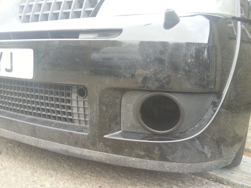

Bass ports had been on order and they came a few weeks back so set about getting these fitted. Fog lights are over-rated and very rarely used anyway so I won't miss them.
20170304_153540 by Louis Walker, on Flickr
20170304_160009 by Louis Walker, on Flickr
20170304_160022 by Louis Walker, on Flickr
Ducting isn't sorted yet, and I'm wanting to add some mesh to them too but this will come at a later stage.

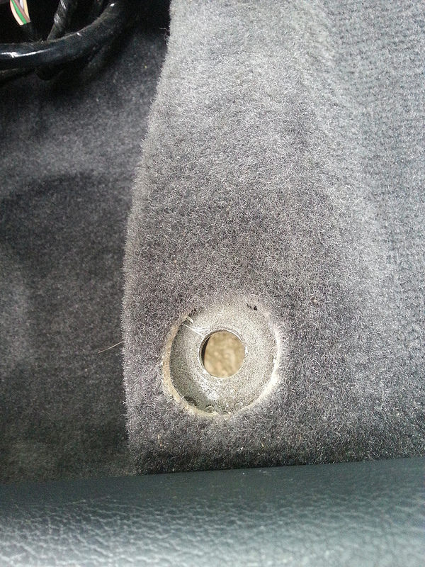

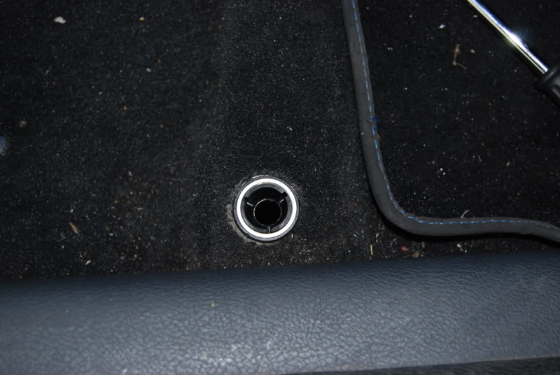

Re seat spacers... so that plastic bit around the hole, is that the spacer? Mine popped out when I fitted the recaros but I put them back. Would have left them out if I knew they were the spacers :(
Louis
I Love Ed Sheeran
Good stuff mate!
Cheers Mark, proper chuffed it passed as it's just a pain in the arse not having the car! Rather work on it to my own deadlines, rather than having to rush for MOT's and work.
Re seat spacers... so that plastic bit around the hole, is that the spacer? Mine popped out when I fitted the recaros but I put them back. Would have left them out if I knew they were the spacers 😧
Yes mate. These are the spacers/antivibration plastics.
Guide here showing front/rear ones. - http://www.cliosport.net/threads/clio-mk2-seat-lowering.394660/
