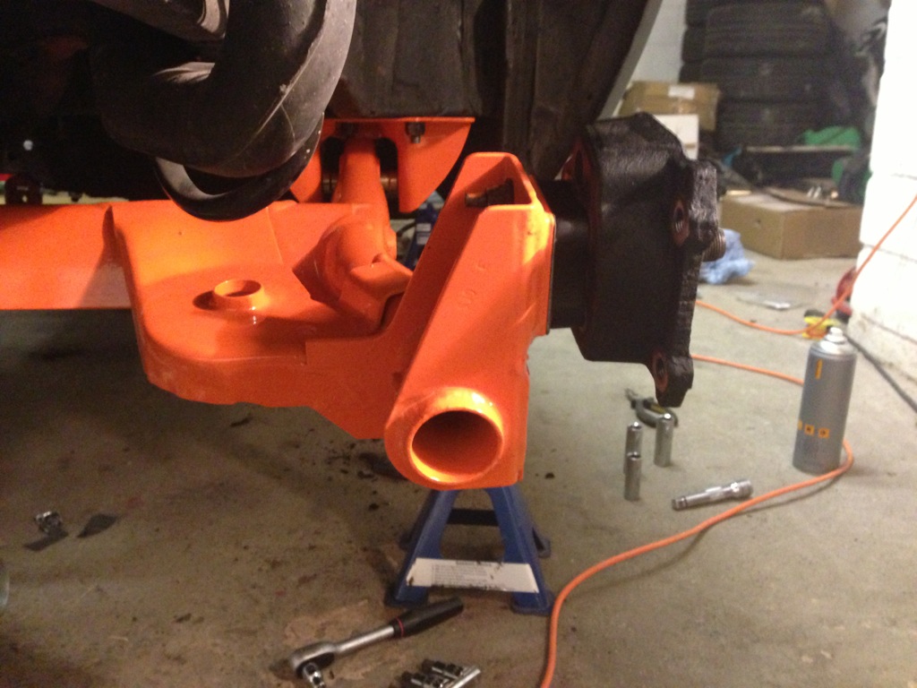

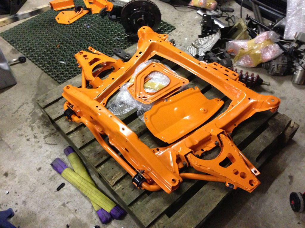

Does anyone know if the steering rack bushes are available separately from buying a new rack? Just putting all the subframe back together but will hold off if I can get new bushes?
Thanks
James

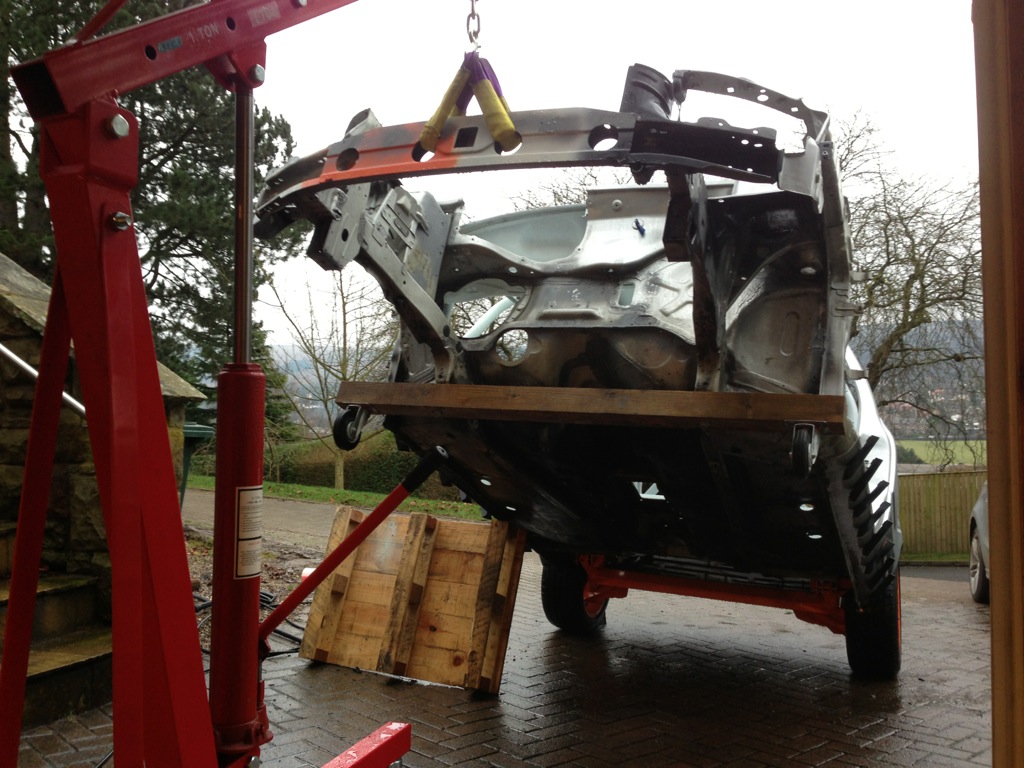

Chipping away Can't wait to drive it again!Cracking on

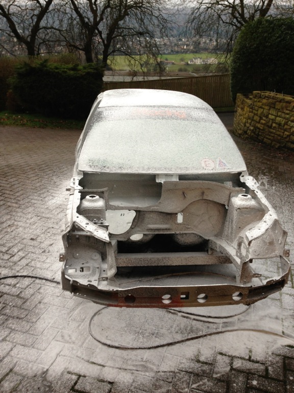

Snow foam a shell
The way forward and it's about the only thing that doesn't dissolve the wrapSnow foam a shell
Tony is a little detailer at heart i'm sure of itTake it he didn't copy that from you guys? Lol
Haha good work !Looking good James. I still haven't worked on mine since Oulton.

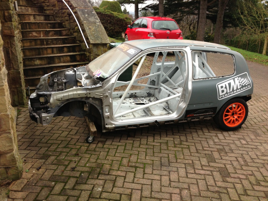

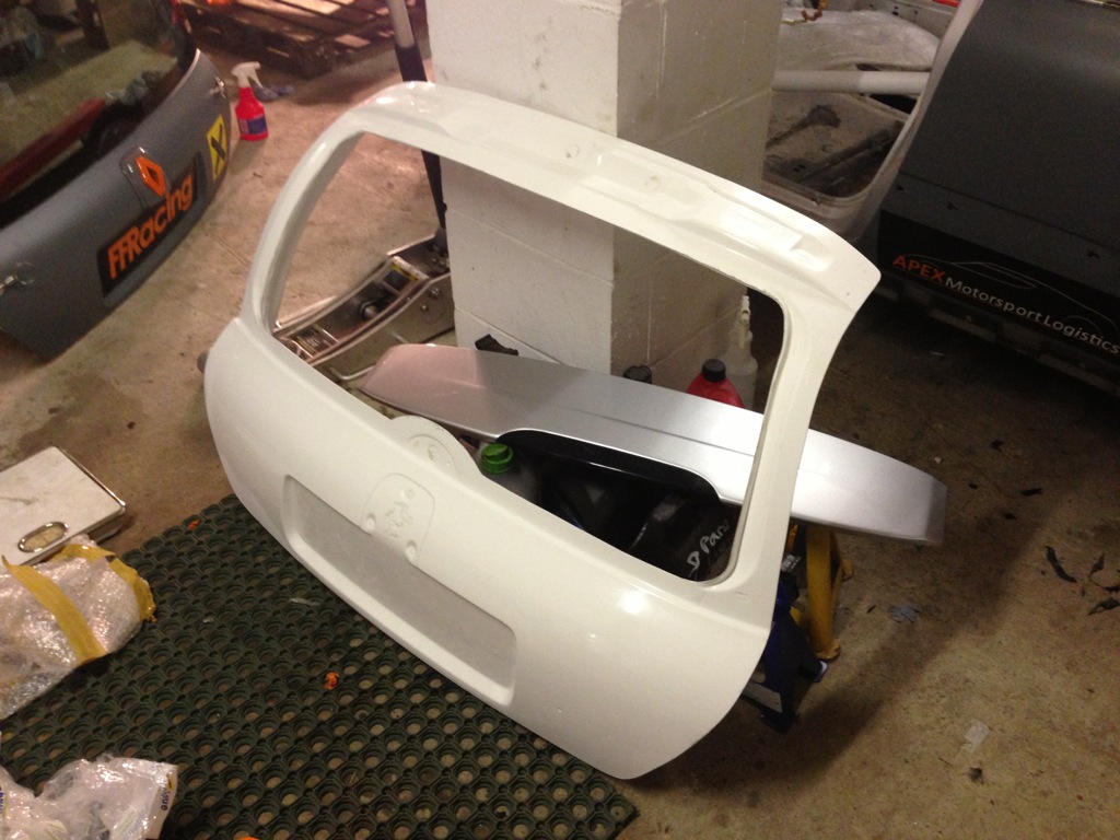

Thanks Colin, Yes I am I weighed it all the other night along with lots of other things and off the top of my head I can't remember but I will check tonight!Good progress James, are you altering the front turrets to accept different mounts for caster ? also what is the weight difference with the fibreglass rear hatch not including the window.
Cheers
Great progress James, looking foreward to the next update, 2 weekends/ghosters should do it for the rebuild.
Regards Russ...........
