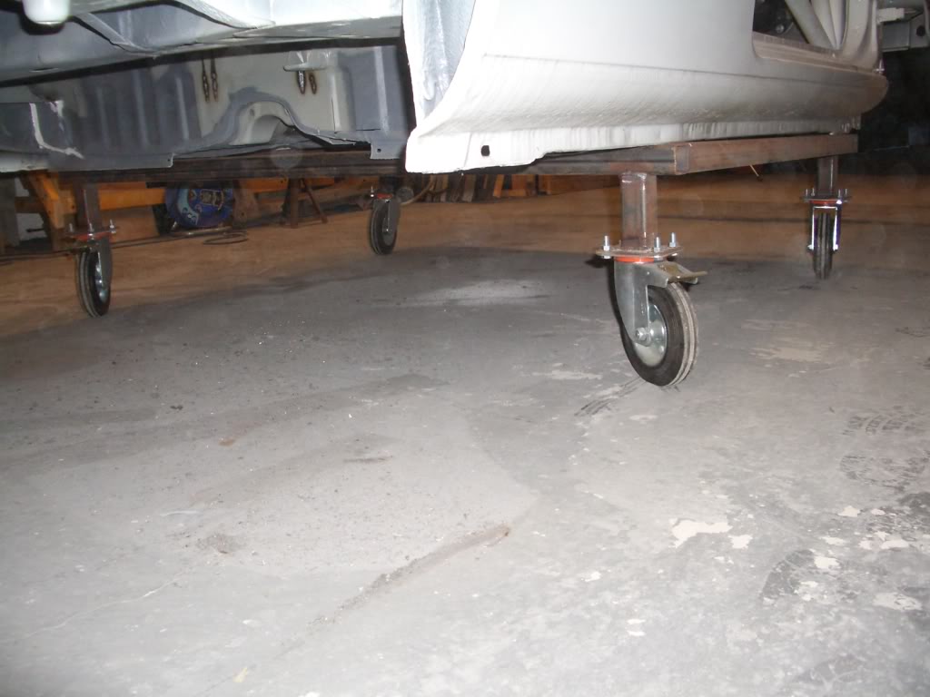

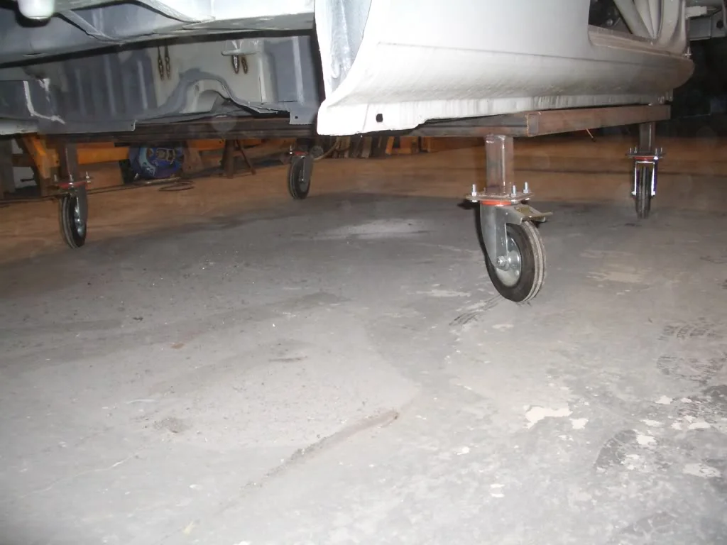

I've been wanting to make a few sets of skates for a while now... what is the max load on those and where did you get them (they don't look like shopping trolley items).
Mick
They are great, the ones I had on before were s**t and broke the first time I pushed the car
The only problem is they dont swivel but I couldn't be fussy as i'm only borrowing them from my welding chap :)
Sorry i'm not sure on the max load but I know my welding chap uses them on his car rotisserie and that has had some bloody heavy cars on it. Think he got them as a second hand ebay purchase so not sure where to buy :(
Look forward to see what your doing with the strut towers ;)
I made this up a while ago, only used it a couple of times, its not attached to the car but it sits on it pretty well, guess you could put a ratchet strap round it if it was going over rough ground.
Used these castors, good for about half a ton
http://www.ebay.co.uk/itm/150613370...l?_from=R40&_sacat=0&_nkw=150613370729&_rdc=1
the swivel wheels i used on my rotisserie came from a BIFFA industrial wheelie bin..... a 13mm spanner and a midnight walk around an indutrial estate should get you a set

I used two of the non locking ones of those castors (same spec anyway) mine broke really quickly, Nylon wheels seem better as they have less grip. Having four will probably help though :)

Hmm, mine seem pretty sturdy, they only need to do another 2-3 shuffles in/out the workshop and they'll be redundant anyway.

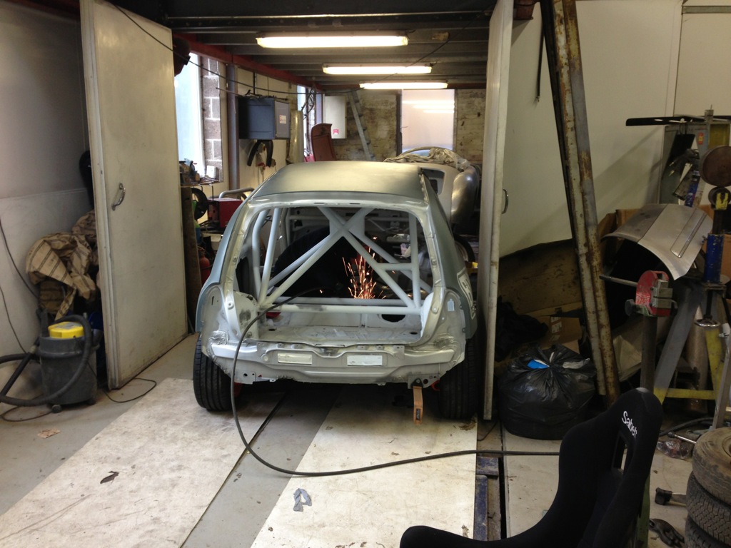

Didn't get the welding done on Saturday as I had to help out with something else but cracked on with it today so most is done such as the new seat rails. The modification to the gearlinkage tunnel threw up a stumbling block when we cut the old tunnel top out as it's double skinned on the most and triple in places. The different skins don't all run together either so that complicated matters. We have ended up with a really neat solution (I forgot to take a photo) It should make the floor stronger and save weight compared to the 8mm steel that was previously used and bodged together with seam sealer. More problems were found with one plate to fireproof the bulkhead wasn't welded in but just held in with seam sealer and parts of the cage hadn't been welded all the way round which would fail scrutineering if it had been spotted!
I'm away now until Thursday but then we will make the final skin for the tunnel, weld it in and crack on with getting it painted before the weekend! Rebuild will start next Monday and I can't wait :)

As said, the bulkhead only needs to be fluid proof so sticking those plates on isn't that bad, a few tacks and then sealed would be the preferred option.
The cage not being fully welded however is really poor! Are you able to get to these areas ok to weld them up properly? I assume they must be tricky to have been left in the first place.
Best thing with the cage would be to rip it out and then weld back in properly on the minimum number of bars you need to be legal for the most stringent series you are ever likely to enter IMHO, extra weight high up that isnt doing anything useful is about the last thing you want in a car.

Yes Kenny can get into it okay to weld it's just a pain to get in and clean the paint off before welding.

LHS, RHS of the dash bar where it joins to the A pillar section of the cage at the back, Underside of the steering rack supports and the LHS A bar that joins to the platform at the rear! Don't get me wrong Stu it wouldn't kill me (I hope) but still not done right and i'm sure you wouldn't do it like that on your car, we got an email from our race series last year saying they were clamping down on continuity of welds round cages after numerous cars failed scrutineering at Spa so glad I spotted it and sorted :)
Yes thats the one's that were seam sealer/mastic'd in, no again not a massive issue but nice to be welded in surely! Only took me 2 mins to do properly and it was the first day i've ever touched a welder
