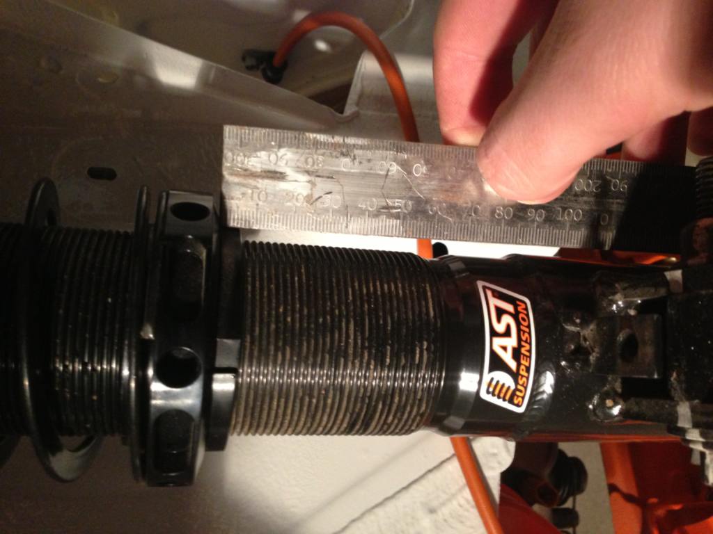

Lol I forgot all week but then remembered late last night so yes the measurement on mine is 58mm from underside of top adjuster to the last thread as per picture :)

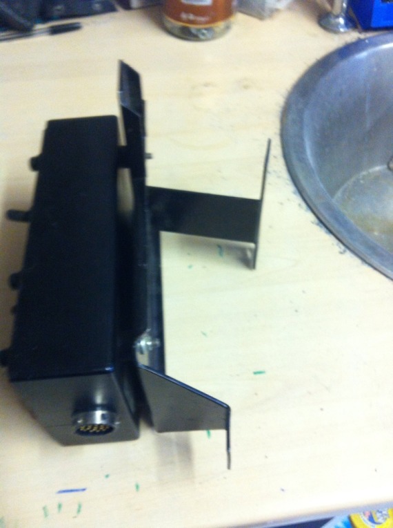

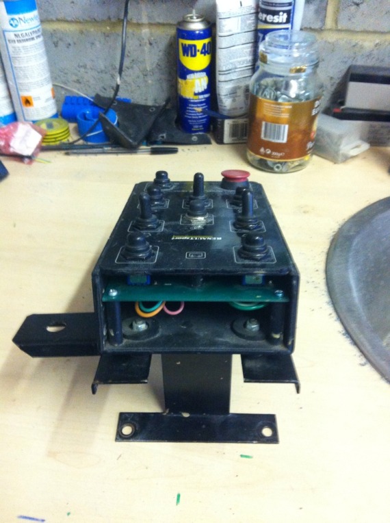

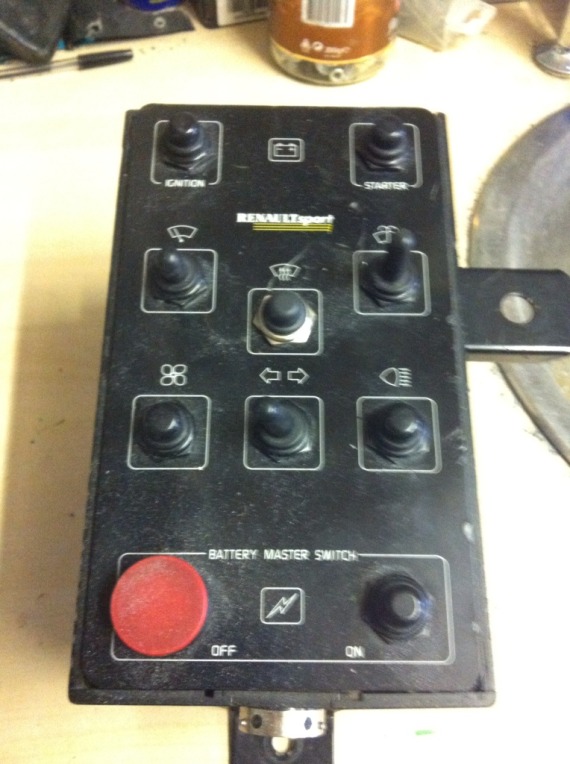

Here are some pics...
As you can see from the pics, there is an end cap missing.
I also have a connector for it and the clio cup wiring diagrams which would help you out.
There is also a bracket on the side for a mechanical cut out switch pull cable should you need it for a fire extinguisher.
PM me an offer

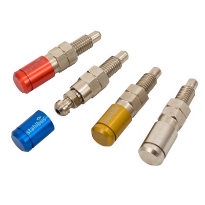

So I have bought a set of the bleed valves which don't require the actual thread to be disturbed each time to bleed them so now just need to find a way to seal all four valves into the caliper permanently and hopefully all will be okay.

The new bleed valves still have to seat on the caliper other wise it will still leak through the threads

Hi James, sorry to hear about the latest bad news. Excuse my ignorance, but if the existing bleed nipples are say M6 (or whatever they are) could you not tap an M7 or M8 hole and fit a bleed nipple with a larger diameter screw but the standard size nipple, I'm sure there must be some available, or if not then a 'widget' to connect a standard size diameter nipple to a M7 or 8 hole?
