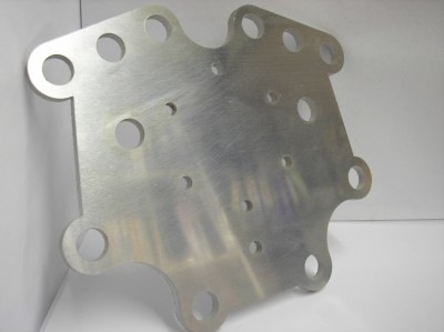

Does anyone know an anodising company that could do me a really quick job?
I've got a bracket arriving special delivery in the morning and I need it ready by Wednesday as its for the switch panel and the switches are all soldered so need it to be able to crack on with the wiring!
Will get it powder coated otherwise but would be better anodised I think.
If anyone can suggest anything it would be much appreciated :)

James, speak to Nick at Camcoats in Warrington. I've just dropped my manifold, turbine housing and downpipe of for ceramic coating but they do some new anodize coating
http://camcoat.com/diamondyze/
Thanks for that mate I will give them a call Monday although I think i'm pushing it with the timescales lol! Thanks again for the help the other day too
James for out Formula Student we had a load of stuff Annodised at a place in Huddersfield (I think). Google will know.
I will have a look thanks Chris it certainly doesn't seem to be as many companies doing it as powder coat
There's a place near me that does it - can't say how fast though! They are good though tbf
Yeah thats the problem with the timescale :(
James don't forget it's bank holiday this coming Friday and Monday, so be careful with the post you'll be down to 4 day week!
Ah yes I had completely forgotten about that! I think for ease I will just drop it off at the powdercoaters :) Although it hasn't even turned up as the postman seems to of been scared by the foot of snow overnight lol
