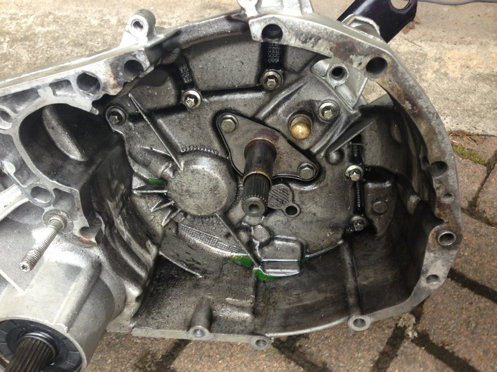

Found the gearbox problem! The bolts that hold the two parts of the casing together are really loose! Doh! Will get it over to Agency and see what the damage is from running probably very low on oil :(

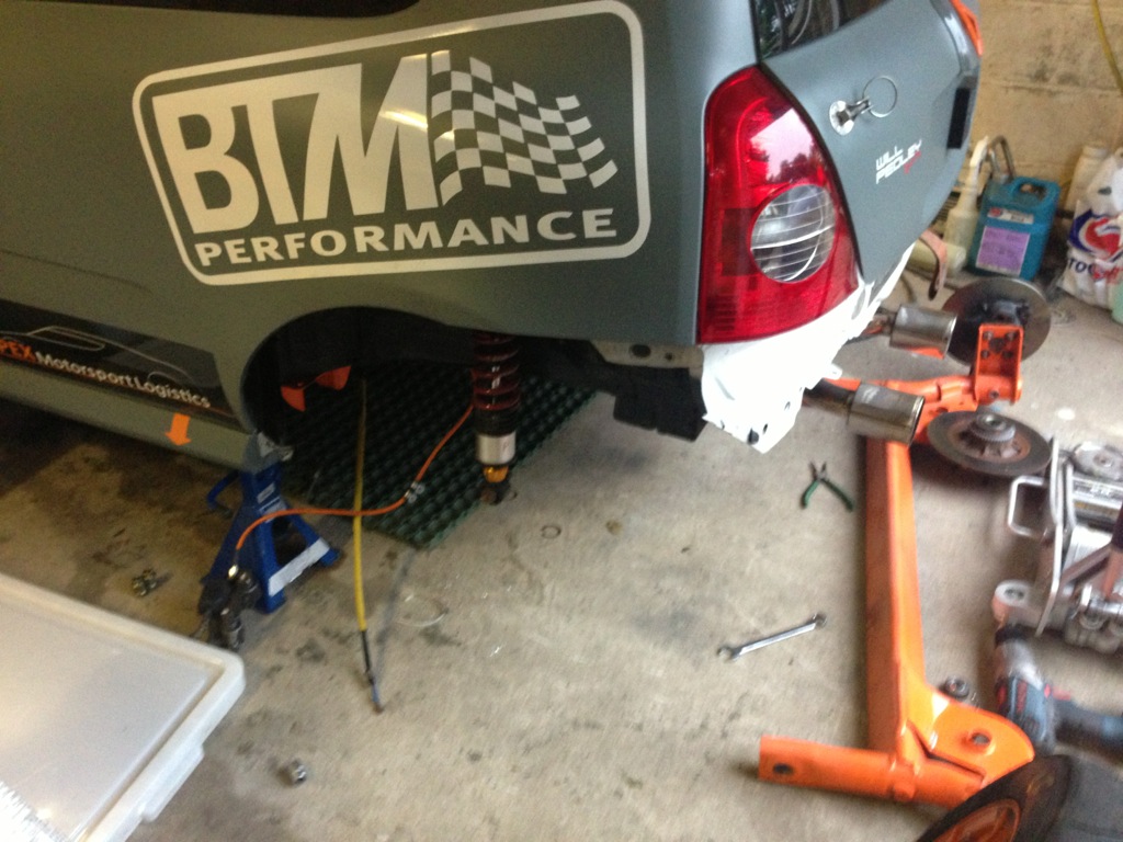

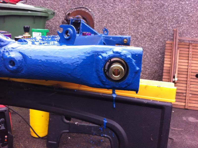

The other odd one is play at the rear beam, basically the beam is fubared :( Still got to work out the cause of the issue but either way need to put a new beam on. Not sure whether to go for another set of the PMS rear beam joints or just go back to renault rear beam bushes.
I am replacing the rear disks and bearings along with changing the wheel studs and nuts all round just to be on the safe side after the impact.

Where exactly is the play in the beam?

The beam itself is mint mate and I'm gutted as its such a square rear beam the problem is the rose joint casings that are in the beam are allowing the bearing to move up and down the casing which is causing the play on the drivers side. My casings are the wrong way round than Pure tell you to do it so I imagine that is what has caused the wear to the casing which has stopped it from being an interference fit.
  Audi A6 & 172 Cup
Circlip on the inside or the outside? Either way I wouldn't have thought it would make that much difference, certainly not enough to cause the housing to wear.
Not 100% sure how they look or fit bu I would guess the housing is pressed + welded in place??
A half decent machine shop should be able to machine the inserts out cleanly....
So the bearings are spinning in the housing??
Or
They can slide within the housing (gap between the shoulder of the housing and the circlip??
either the housing was machined oversized, the bearing was inserted without something like LOCTITE603 , or they use cheap old bearings from McGill motorsport that bind up as soon as you sneeze on them..

I'm a little confused by your bearing issue, do they move side to side in the welded in casing or up and down? I really don't thing putting the casings in round the other way would make any difference as the loads would be the same either way, were the circlips fitted?
Circlip is on the inside of mine so the opposite to what Pure say, I had to switch them round as my beam had a raised section on the other side so they wouldn't of been level. I spoke with Nick at the time and he thought it would be fine but that is all I can think has caused the problem. (Not holding any blame on Pure at all its my own fault)
Yes Stu it is although they don't really need pressing in. I wondered the same but thought they wouldn't be able to deal with the bulk of the rear beam in the machine.
Or
Yes Stu they are sliding within the housing which is causing play in the rear wheel from the 9-3 position. I didn't use any locitite no I just followed the PMS instructions, I'm not sure to be fair but with it sliding around it seems to have removed material from the outside of the bearing as its showing to be down a 10th of a mm compared to the other side.

Yes they are moving side to side in the in the casing so moving between the circlip and the shoulder of the casing. Yes circlips were fitted :)
Were they a press fit when you installed them??
in my opinion there a small bearing to take the loads of the entire beam assembly..
Id definatly get an engineer/machinist to look over it rather than start again... you'd be suprised what can be saved..
No but they were a tight fit but was possible to get them in with a hammer and socket :)

Just worried that although they were a tight fit in mine they didn't need to be pressed in.

Im concerned aswell as first drive of mine with Reigers wasnt great and rear end was very very lively. Im wondering if it's play in the PMS beam set up as it felt like it was rear wheel steering.! Geometry all OK and quite a bit of toe in and quite a soft rear end would all point to an understeering car but you can put it sideways very easily.
Mmmm okay mate thanks i'll keep it in mind :)
The joys of motorsport eh :) No I should be thankful as it could all have been alot worse!
So im clear is it moving up and down (so bearing diameter is smaller and the bush dia) rather than side to side moving (between the bush shoulder and the circlip)?

I'm not sure solid rear beam bearings are really a great idea unless you like a really lively back end (ooh err)
Rear bearing beam should make it more neutral not more lively. Std beam bush would promote a bit of dynamic toe out so lively where solid beam shouldnt.

For those that have the pms rear beam kit fitted, James has spoken to nick @ pms today and on James's car it's purely looking like a complete one off. I spoke to big gash whilst he was on his lunch break today and this is the general gist of what nick told him:
1) He's never ever had an issue with the rear beam kit they offer
2) Ideally the bearing housing should be welded in to the rear beam rather than tig welded ( like James's is) as the heat transfer from mig is greater, causing the housings to shrink slightly and make the bearing an interference fit.
3) Use bearing lock to help secure the bearing in the housing (pms do this on all of their spherical conversion kits apparently), and if James fits new bearings into his rear beam now and uses bearing lock, it will be fine and shouldn't suffer from this issue again.
I'm sure James will be on later to fill in any gaps that I've missed off.
I run this kit on my track car and have done since 2010. I'm still on the original bearings supplied in the kit, and when I raised it up to check them today all was fine. I ragged it hard enough to near enough pull the car off the axle stands! Mines had quite a hard time as well tbh and seen a good 4k's worth of road mileage, over 700 miles of track work with at least 300 miles of that being covered at the nordschleife.
