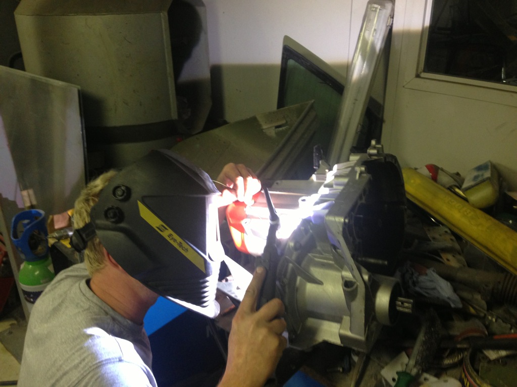

Rear beam sorted :)
Managed to win a trackday for Rockingham at the weekend but obviously my car wasn't going to be ready and with me working everyday until Sunday it was looking very unlikely. While at Cadwell Ian had offered to bring my gearbox back up from Agency on his way up North. Really kindly he collected it yesterday from Agency and brought it up today! Owe Ian big time thank you very much mate :) It's amazing how many kind people I have met on this forum and peoples generosity never ceases to amaze me!
Got home with the box and set about getting it fitted and in the car. Had a quick once over the box, Agency had given it a really good clean so nice and easy to look around and check it. Then with my typical luck I found a hairline crack in the paint, I scraped the paint away and sure enough it went through the casing into a wet part of the box. Got my finger through where the passenger side driveshaft goes and I can feel the crack on the inside and also could push oil through the crack so its definitely f**ked. Proper goosed and fed up now :(

I'd imagine your box has seen more heat than the welding would cause anyway tbh. It nearly burnt my hand when I touched the casing at mallory. The only issue I can see in getting it welded is getting it clean enough for the tig to weld without spitting its dummy out. It's very sensitive as to how clean the area is.
To use the quicksteel you need to rough the area up and give it something to key to and leave it to go off. It will dry rock hard and stick like s**t to a blanket. I'm 99% confident it'll work and remain leak free.
​Out there somewhere is a scania r560 that had some severe corrosion issues on the block face and it kept causing a head gasket to leak. The area was cleaned and filled with quicksteel, then flatted off with a file and finished with a whetstone. Head bolted back on and the result was no leaks......... The guy kept it for another 18 months and sold it on. In that time it covered a further 350,000kms with mainly 44tonne on its back. Lol!
  Audi A6 & 172 Cup
2nd that, I've also used it in some pretty unfavourable situations and been amazed at how well it works.
I used it on a hole in the gearbox casing on my 306 - it did last about 6 months but then spat it out. To be fair though it was like a 3mm hole rather than just a hairline crack

Rear beam sorted :)

That's a bummer James, though good you found the crack before putting all back together. Not much help but I may be taking mine down over the next 10 days or so, so could take and bring back, if you can get a casing and box to me or I could pick up on way (some place on way) down and drop off.

Which part of the casing is it?? We've got a couple of old boxes, one of which is in bits...
Thanks everyone and also thanks to everyone who has offered me gearboxes, unfortunately it turns out I have to get a 182 jc5 130 box as the casings are different as they run different bearings :( If anyone knows of a decent 182 casing or cheap gearbox please let me know. I have asked around today and half the people I ask said no to welding the crack in situ and the others said yes so I have taken the risk and had it welded up.

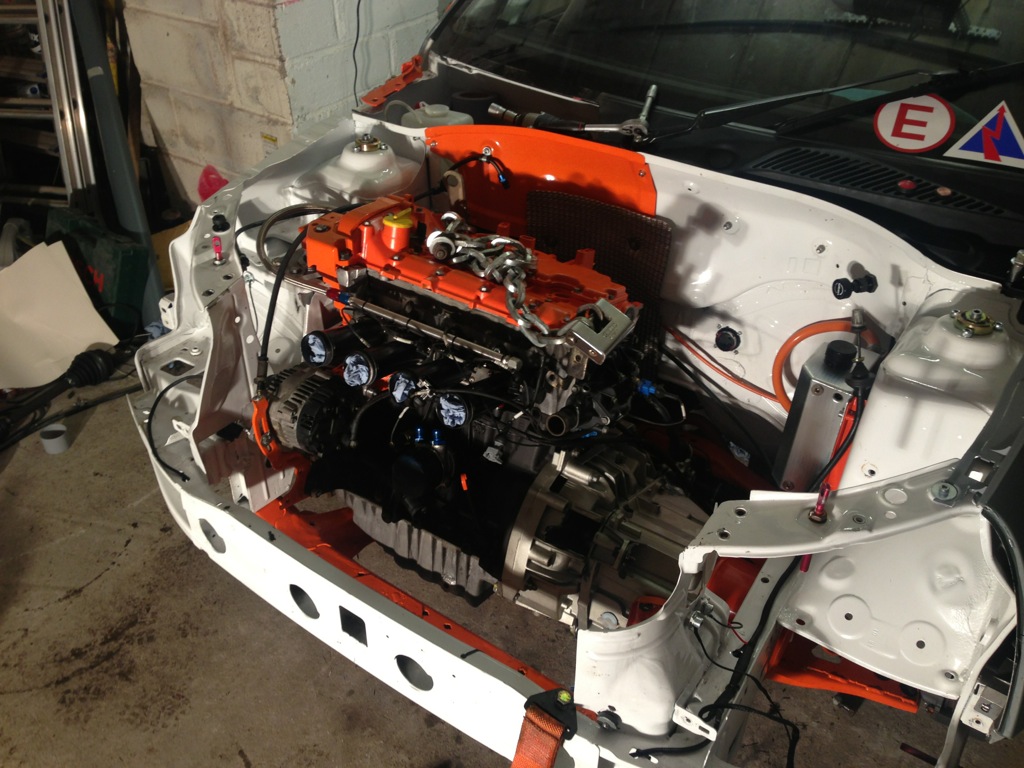

This means the gearbox and engine are now back in the car and I just need to fit the Rad, do the fluids and then put the rest of the car back together after the off. Fingers crossed it'll all be okay :)
A picture of it half way through putting it back together
It was near the top above where the crownwheel is :(
Should be ok welding ive done plenty of castings over the years.. drill a tiny hole at the end of each crack, grind it out, clean her up and burn it in... she'll be reeet
