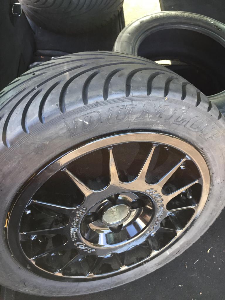

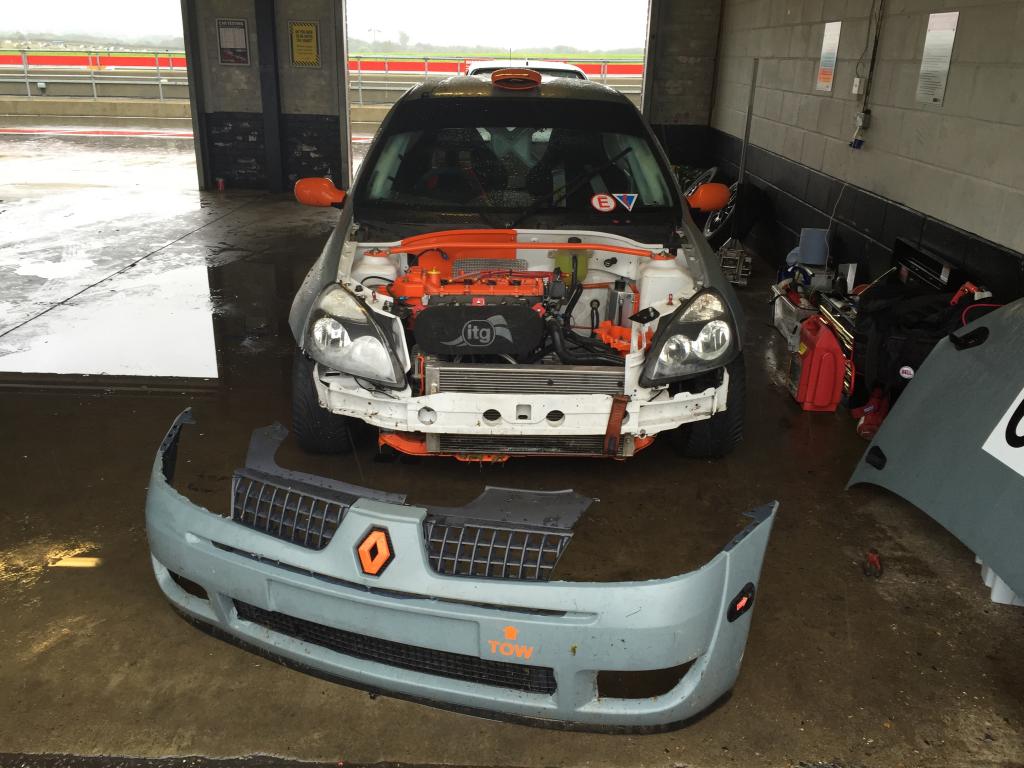

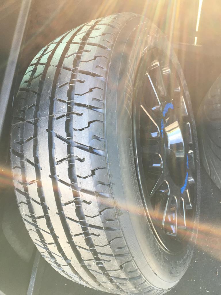

Did Snetterton yesterday in the Clio as a bit of a last minute trackday, the weather looked rubbish so thought the clio would be most suited! Since Silverstone in the wet the week before myself and Porkie decided we needed some proper tyres for wet weather so we’ve gone halves on a set of proper dunlop race wets and a set of Avon road tyres.

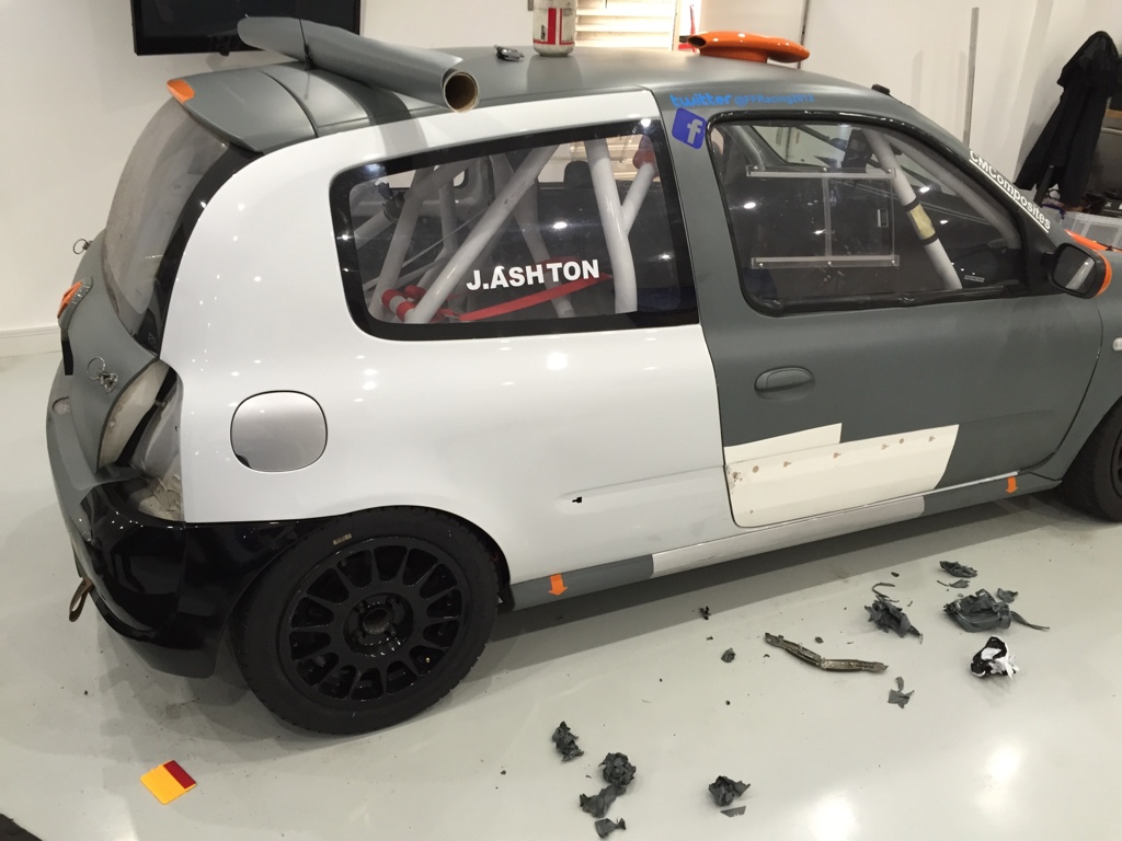

Upon arriving at Snetterton the wets were definitely going to be getting tested. The circuit didn’t open till nearly lunchtime due to high volumes of standing water. I went out and the Dunlop wets were great so much grip and that was even without working them hard and building up temperature. Unfortunatly there was a lot of standing water to the point that on the sighting laps I said they should cancel the day but they wouldn’t so seeing as how the money was paid we wanted to get some track-time. Unfortunately hit a big patch of standing water going into Agostini and the car just locked up, did everything I could... Cadence braked, tried turning in to scrub some speed and increase my distance from the barriers but it just wasn’t happening. When we then went on the grass I presumed it would start slowing down and we should get away with it but sure enough the car just sped up on the grass and built up speed until we hit the tyre wall. Apex Motorsport Lee was in the car with me and we were pretty much at everything I tried to do just wouldn’t slow the car down and then we just sat around and waited for the inevitable hit. We went in quite hard and felt harder to me than Cadwell tyre wall incident so probably around 40MPH but the tyre wall did quite a good job of dampening the speed. It sheared the rad mounts off and damaged the core of the rad and has twisted the front cross member and obviously done the front bumper, headlight and bonnet but thankfully I hadn’t got around to swapping them after Cadwell so not really the end of the world.
We got the car patched up and did a few more sessions but it wasn’t really enjoyable being veered all over the track on standing water so threw in the towel early and went home pretty much in one piece thankfully!

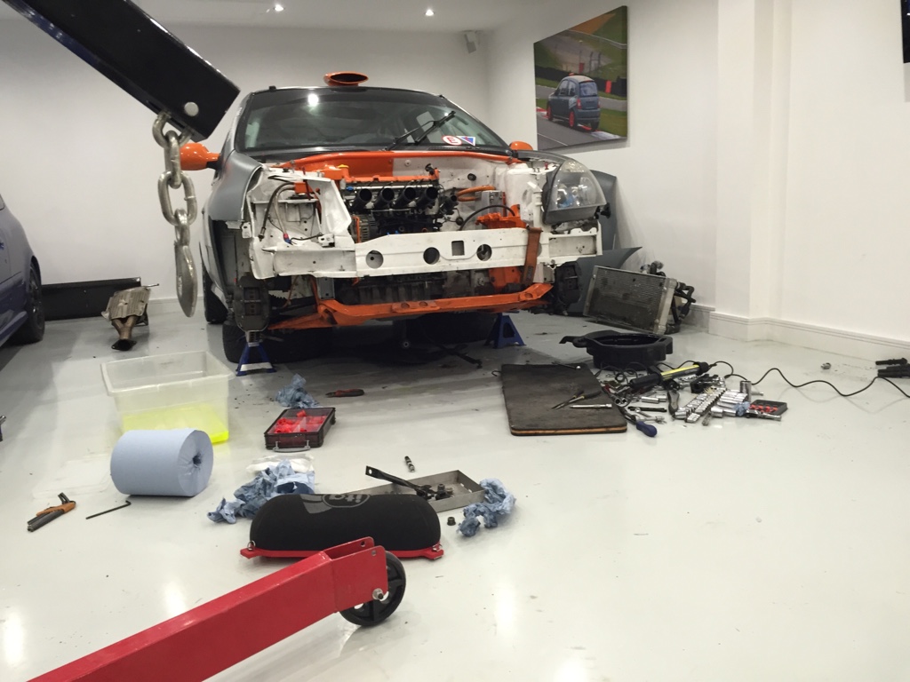

So plan is to get the engine out this week and fit the stronger clutch and then needs a few panels at the front, bit of wrapping and geo and then hopefully its good for the Birkett :)

Sorry to hear about another fender bender James. Those dunlop sp wets are what I used to run on the Leon and are awesome, the amount of water they disperse is rediculous.

Thanks Russ :)
Yes pretty impressive but the standing water just got too much in the end :(

Joking aside sorry to see another tyre wall has been visited bud, at least it wasn't worse :) Tyres look good!

Clutch fitted but oh my days the pedal is so stiff! I’ve got a feeling it might snap the clutch cable but will have to see.

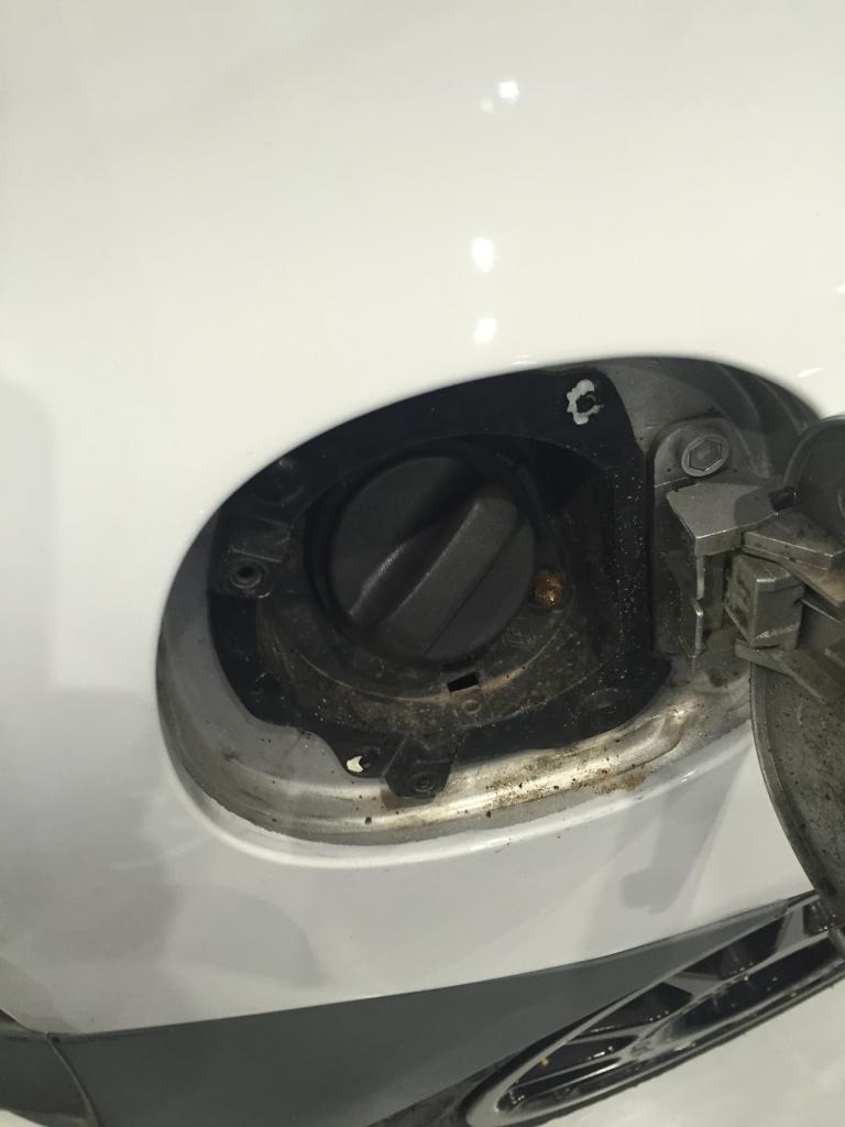

Finally 3 and a half years into the car and forgetting the old key for the fuel cap I’ve got a non locking cap! Seriously nearly everytime we take the car anywhere I turn round to go back and get the key lol!

Good idea regarding the fuel cap, is it a Renault item?
The cap from a Mk3 clio has no lock and fits perfectly.

Sorry to hear about the bump at snet....Looks like you've had a similar impact to what Ryan managed in quali for yesterday's tin tops race. He ripped the bumper skin off, it's currently cable tied in place!

Which Dunlop tyres are they that you're using for wet running? We've got some Nankang NS2R's, but they're only good when it's quite wet...so the normal Dunlop DZ03G's are still our intermediate tyre essentially.

I did wonder what had happened as I looked on TSL and saw you guys had only managed 6 laps :(

They are just a cut slick for wet that dunlop do so not suitable for our kind of racing. Me and a friend bought some for our winter track days so the rain doesn’t stop the fun :)

So, I've thrown the key away for the car, after fitting the button start! Never even thought about the fuel cap!
Luckily, I used to be a car thief, so will pick the lock and get in!

The fuel cap can be opened with almost anything that can fit in it! We took a little bit of steel, filed it in to an approximate key shape with a handle and have left it in there!
James...see you Saturday! I'm well excited
Hammer a large GS into the lock... turn..... you now have a fuel cap that can be operated with any GS, if you're stuck.

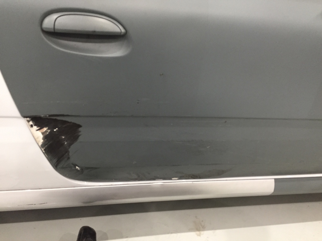

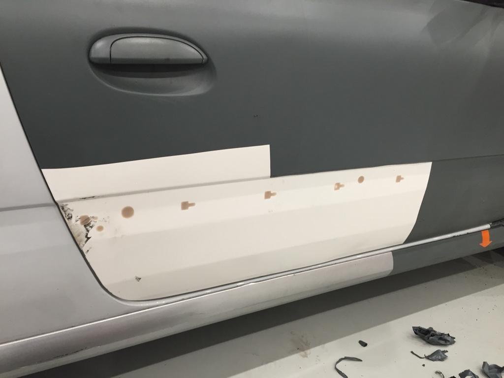

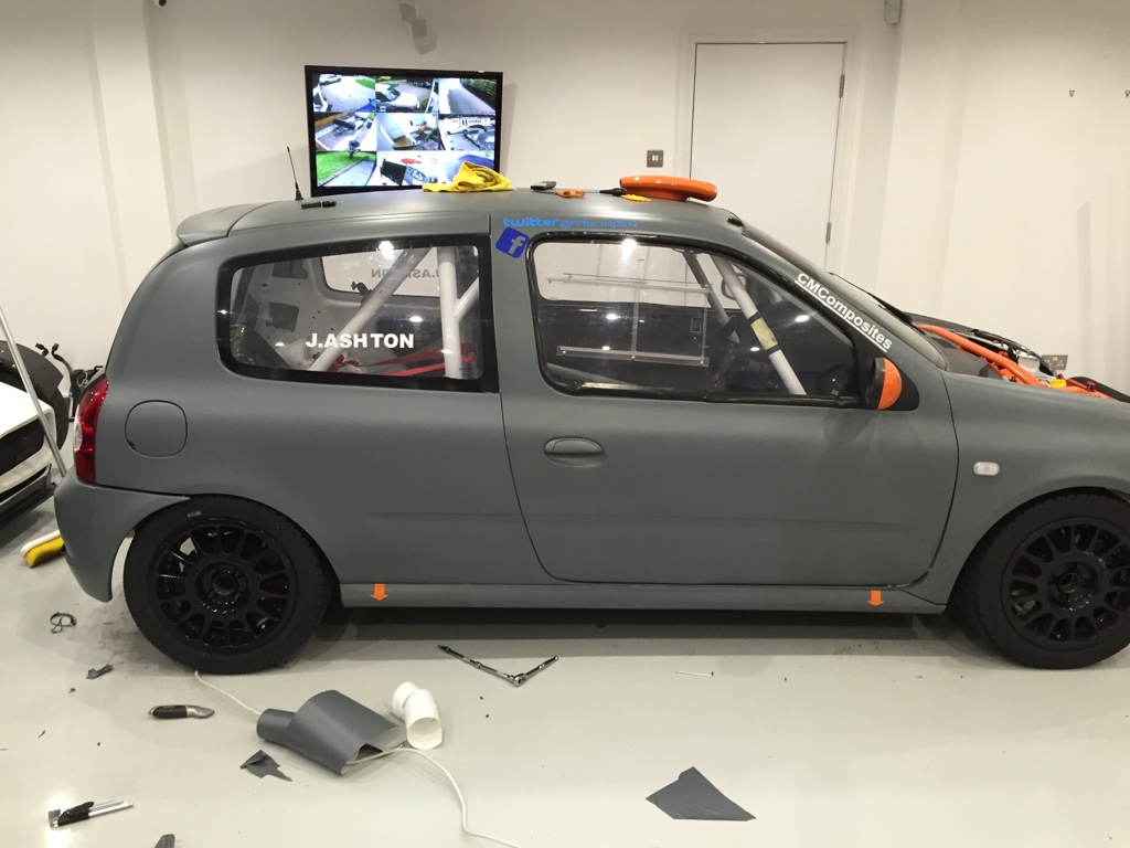

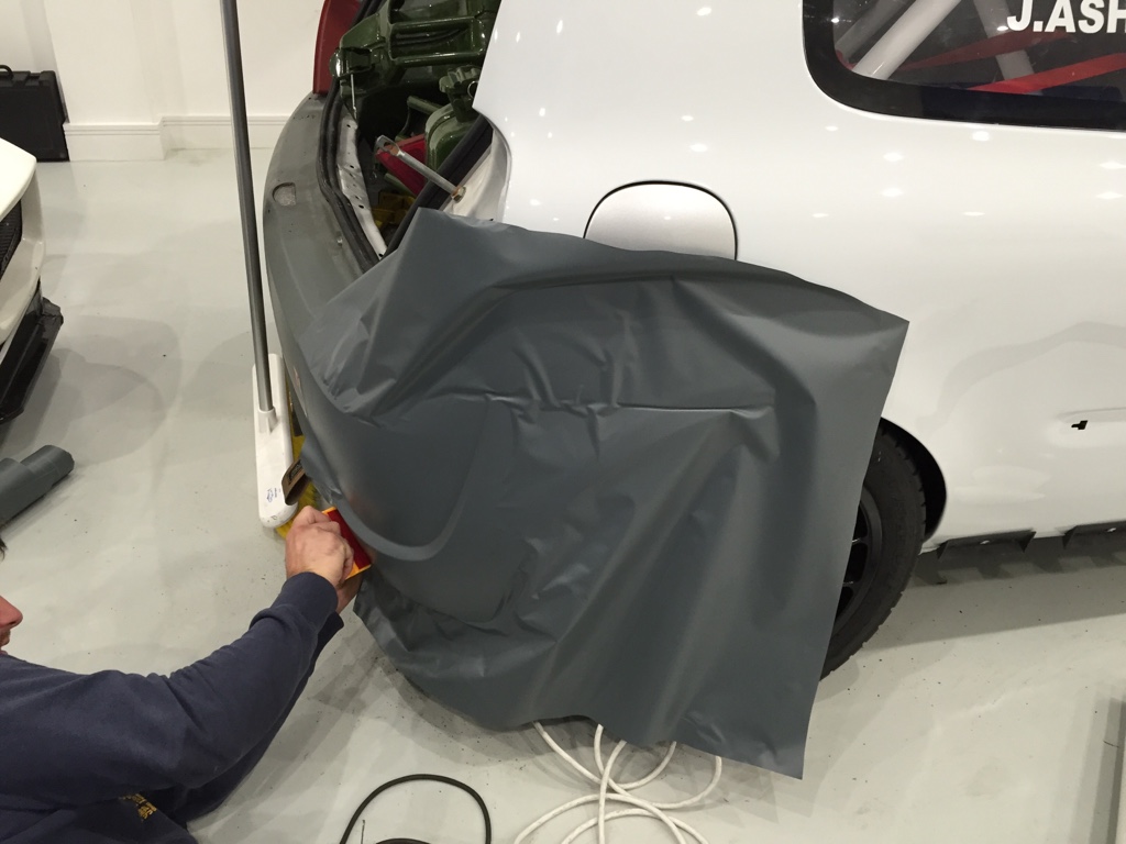

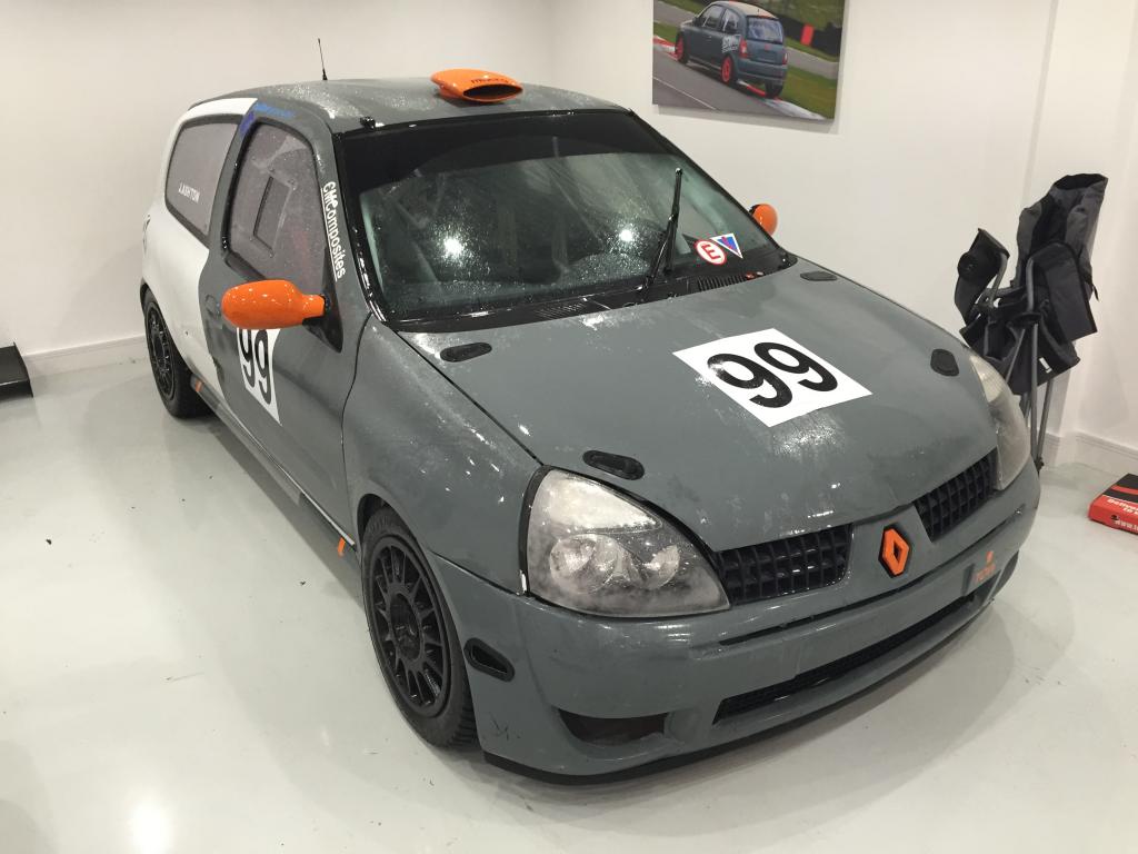

Wrapping the car today to make it look a bit more presentable albeit I've done it in a very pikey/temporary way!
Patchwork quilt
@LeeP86 being helpful ;)
Just waiting for the new bumper and bonnet arriving from CMComposites this afternoon and then wrap those :)
