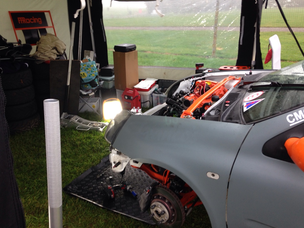

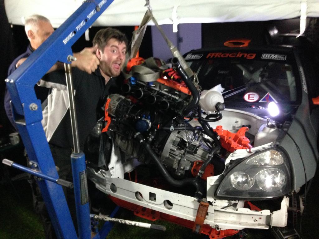

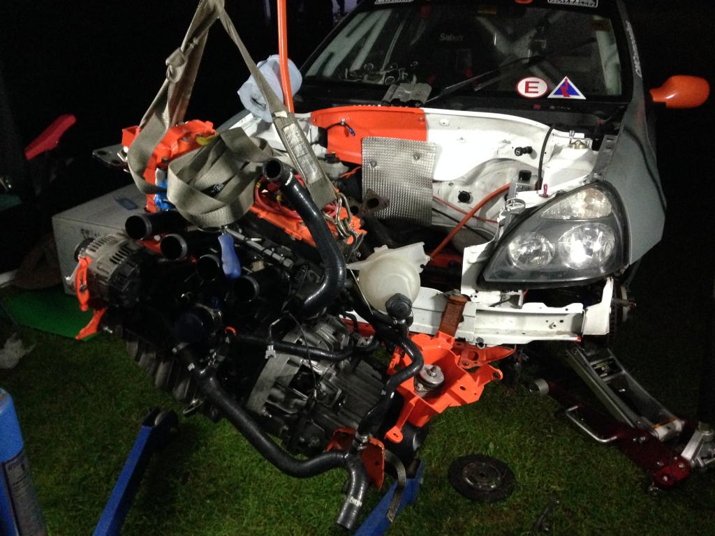

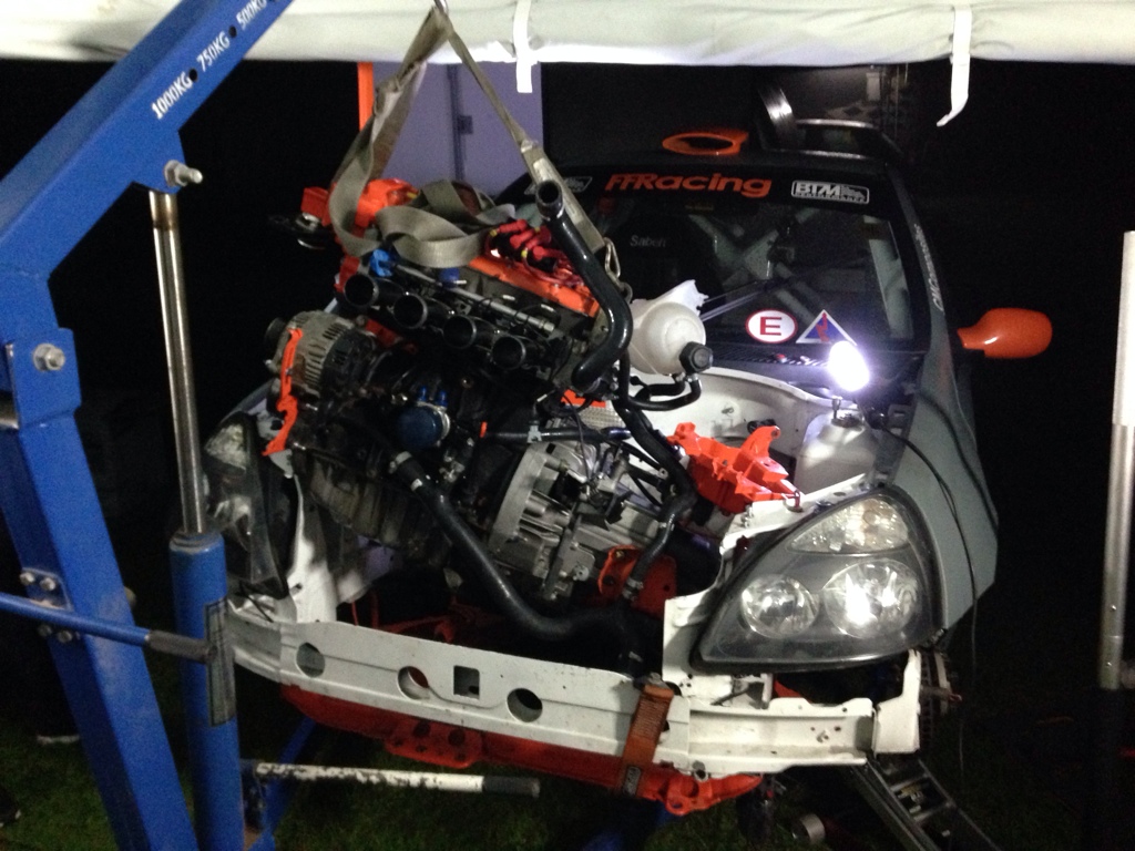

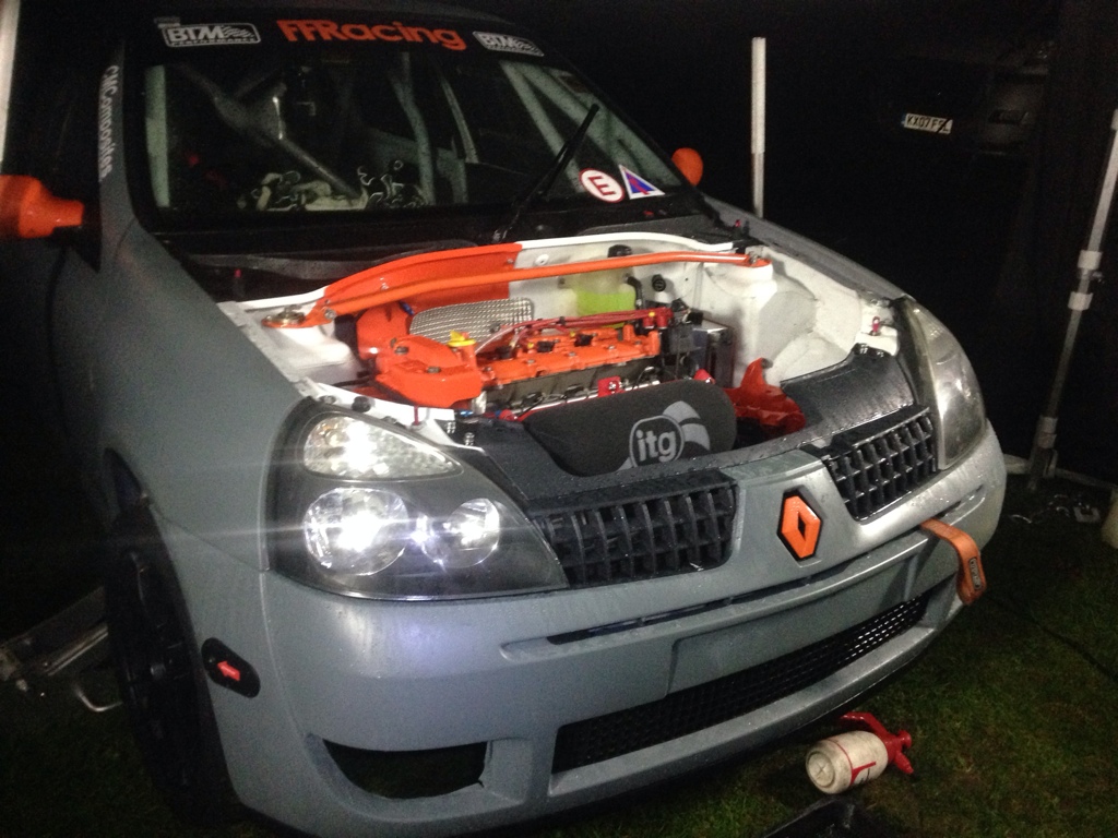

So testing didn’t really go to plan, New brake pads causing vibrations and the new tyres not working well were annoying but coming into the Mountain complex I went over a kerb in 2nd gear and suddenly lost all drive. I presumed it was the gearbox what with its less than perfect track record. So 8 laps into testing and that was the day over. It would of been all too easy to load the trailer up and call it a day but i’d taken 4 days of work for the weekend and to get the car ready so I wasn’t going to give in easily! Started to ring around some friends and Chip based less than an hour away was a great shout by another friend of mine (thanks Steve) Chip being his usual generous self offered me a selection of gearboxes of which I chose to go no diff but better gearing rather than worse gearing with a diff. I also went through the symptoms with Chip who suggested it could be the clutch so he also provided me a 2nd hand clutch and an engine crane. Thankfully Lee from Apex had been doing a job down south and it was only about an hour out of his route back to Cadwell to go and collect the parts. He’d started work at 6am and it wasn’t looking like it was going to be an early night.

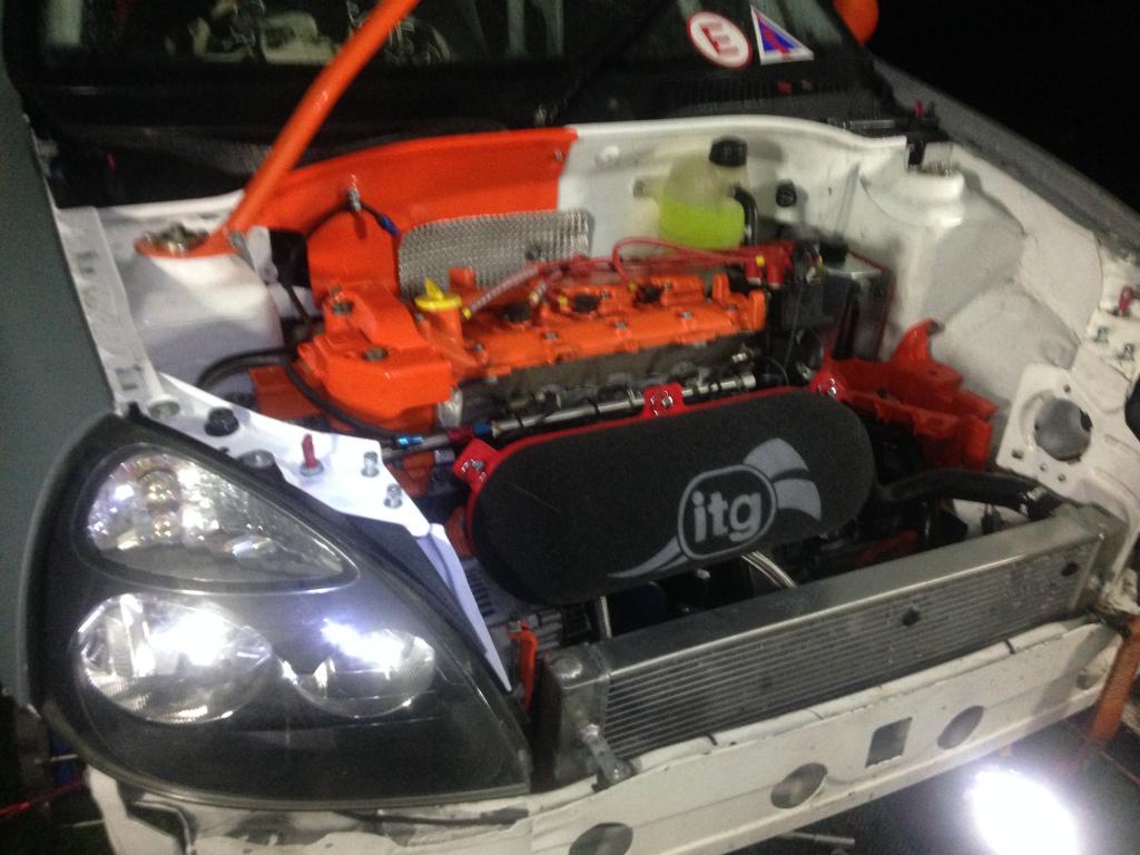

Once the parts were arranged I got out of my race suit and into some scruffy clothes to get the car stripped down ready for the parts arriving. Thankfully for the weekend I had bought a generator and some site lights, without these we would have really struggled to get the job done. Lee arrived a couple of hours later with the parts just as it was getting dark. Engine crane came straight out of the trailer and into action. With the engine on the floor and me splitting the gearbox from the engine thoughts turned to food. Tony very kindly suggested cooking while me and Lee carried on with the help of David Clark and his friend (Sorry I didn’t catch your name
) I selected the gears under the box and tuned the input shaft and all felt fine. Then we saw metal shavings in the bell housing, took the clutch off and sure enough the centre splined section of the friction plate had shattered away from the friction material so was just spinning and not giving any drive. So time to put the clutch back in that Chip had donated and put the normal box in too. The food Tony made was amazing and then it was time to get the engine back in the car and running. It took about 75 minutes from the engine sat on the floor to being back in and finished. That wasn’t even going mental at it. Huge thanks to everyone for the moral support and mostly to my buddy Lee for helping out after such a long day! You couldn’t ask for anyone more helpful!

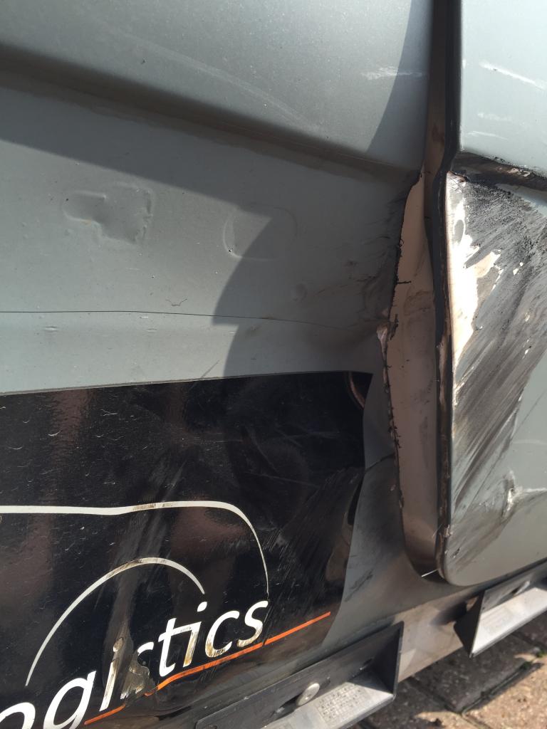

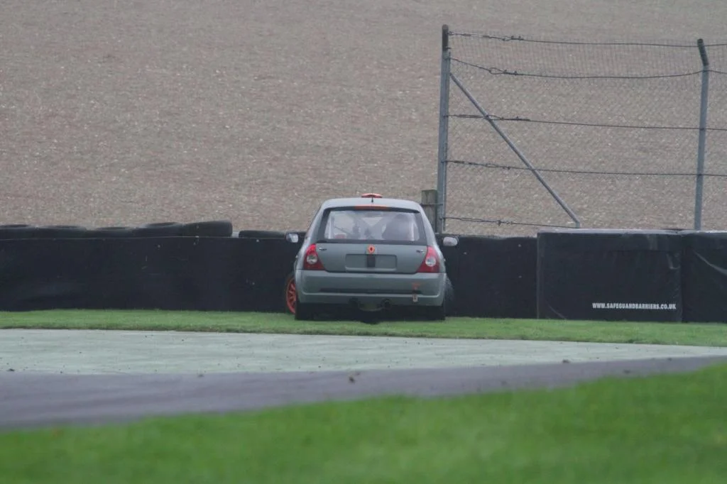

Fortunately my warm up lap the lap before was good enough for pole by a second. In the hot lap I was already up by 3 seconds but didn’t really matter now I was on Pole for the Tricolore series. After the red flag I did an outlaw and caught up to a slowing (trying to find a gap in the traffic) Nippon front runners I went past him and had a big lock up and couldn’t avoid hitting the tyre wall. This took off the front bumper, damaged the rad and a few other bits but Lee managed to get it patched up nicely. Managed to reverse it out and carry on but not enough time to set a better time with the traffic.

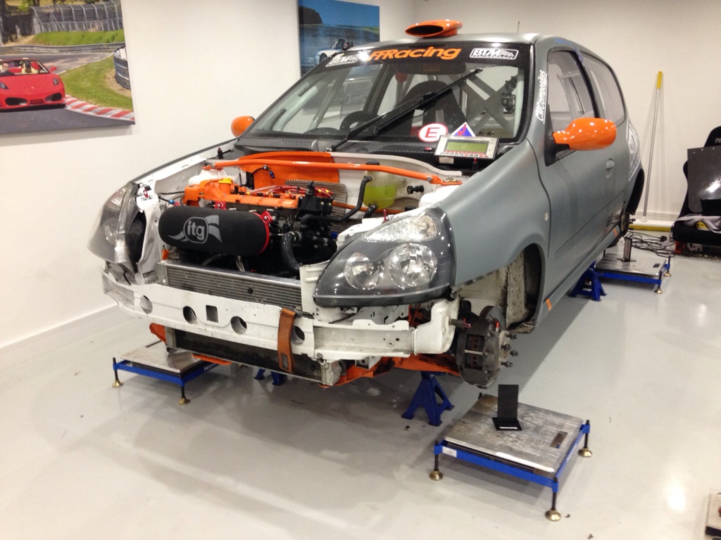

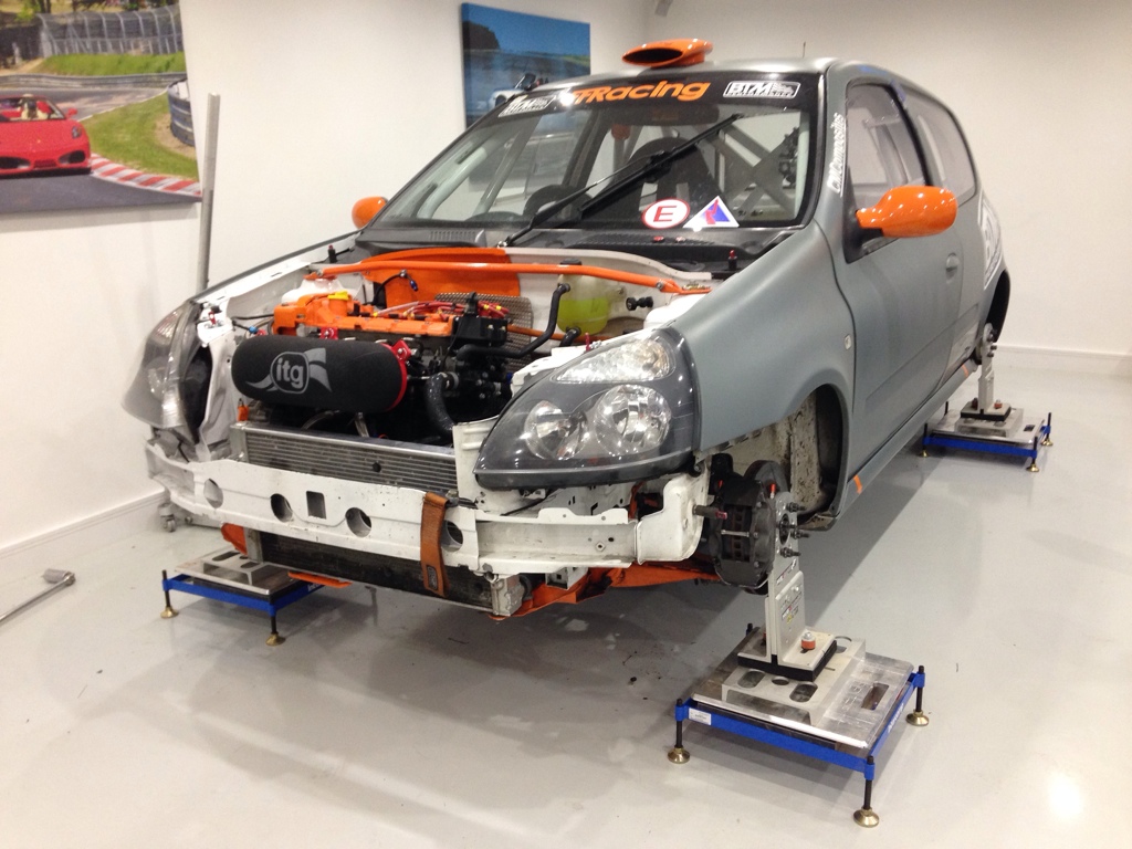

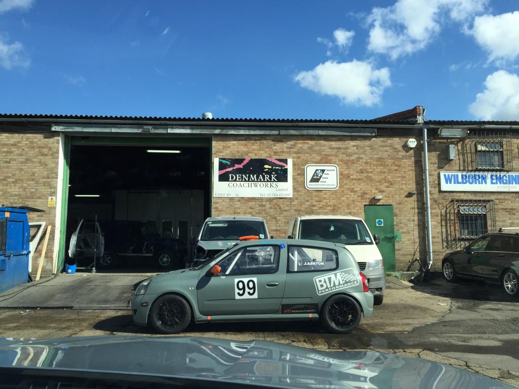

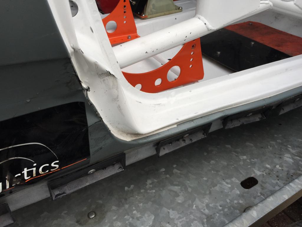

So moving forwards the engine and box need to come out to swap to my uprated clutch and repair the car from my antics. Need yet another set of catches for the front bumper, New bonnet and some wrapping. Then sort the side think the door should be repairable where its cracked and the car is at the bodyshop at the moment. The impact has shortened the drivers side from where its gone in but its going on the jig so will be pulled back straight hopefully which will correct this. Thankfully that explains the lively rear end after the accident as the impact didn’t touch any of the wheels so was an odd one. Then just a matter of re wrap it and put a new side skirt on
Looking forward to getting it back fixed as was annoying walking past it everyday this week looking so battered!
At the bodyshop
