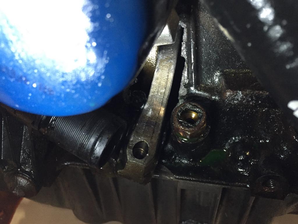

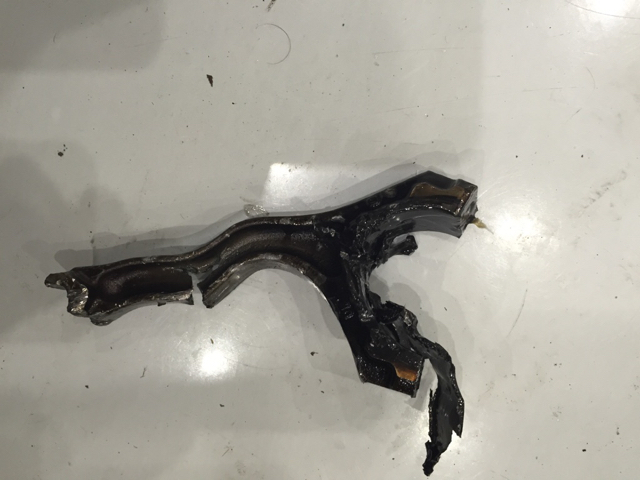

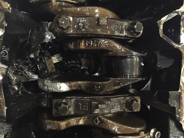

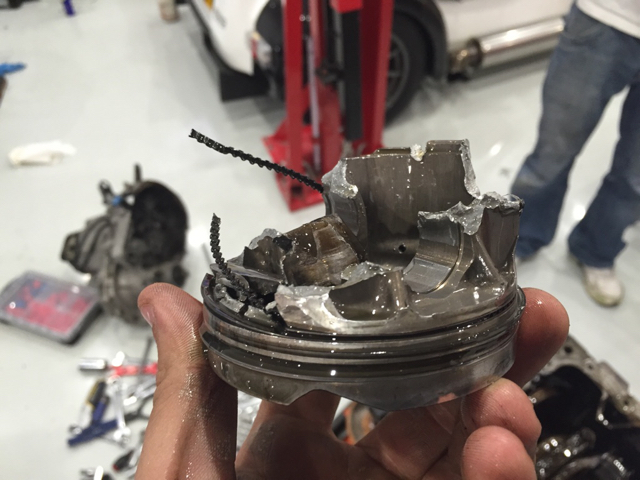

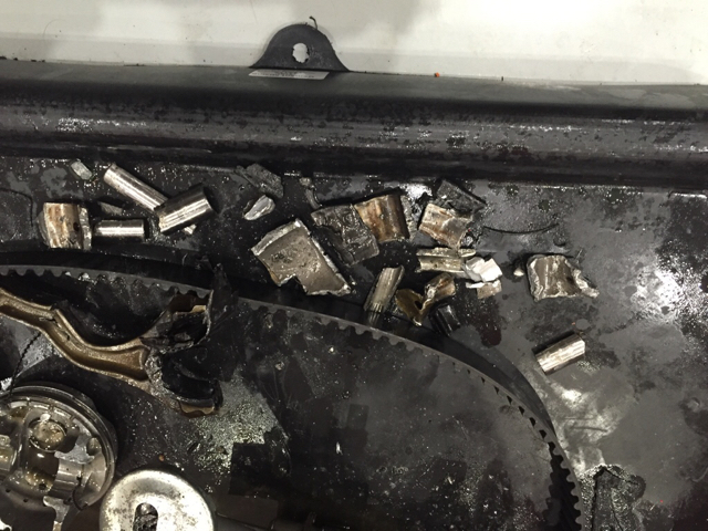

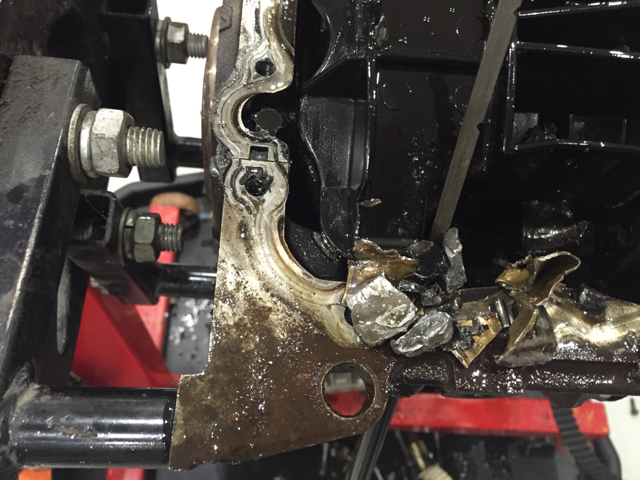

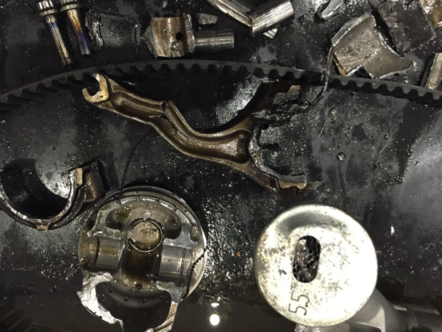

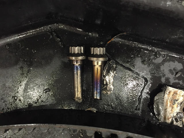

Forgive my ignorance. But what's actually happened there? Obviously the rod wanted to make a break for freedom, but what do you think caused it / what failed first?
Looks bloody messy!
Garage looks messy I'd never leave it in that state :tongueclosed:
At least Dan stayed and helped clean up :p
Looks bloody messy!

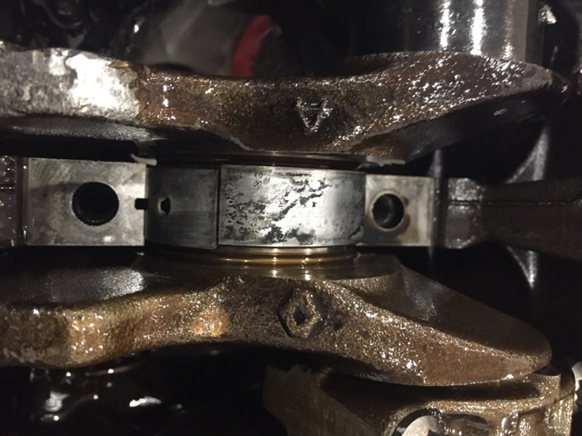

Thankfully for once it's pretty clear,
The centre main bearing has spun, this then blocks the hole for the oil feed to the crank and the rod on number 2 gets starved of oil and overheats (goes blue) and throws the rod when it's get to a certain temperature which is why the ARP's are blue and sheared.
All the data backs this up with a sudden increase in oil temp as it was trying to quench the overheating bearing.
No obvious sign of a pressure drop in the session to start the bearing spinning but it's a very common failure.
Solution is to tag the main bearing but if the bearing wants to still turn with enough force it will.
Proper job indeedy. Answers the 'salvage' question though...😂

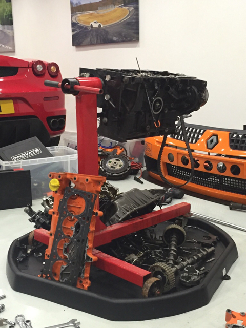

Head and cams have survived surprisingly :)

By the time the oil temp has started to rise it's game over mate as the bearing has already spun and destroyed the crank and rod bearings closely followed by blueing the conrods.
