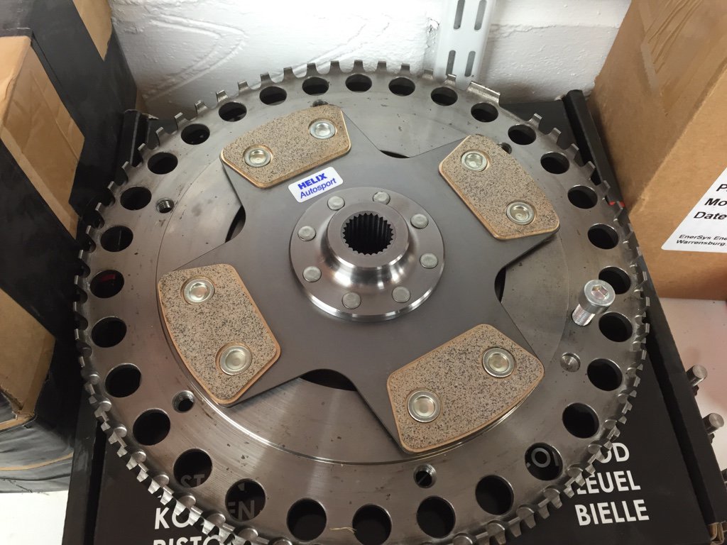

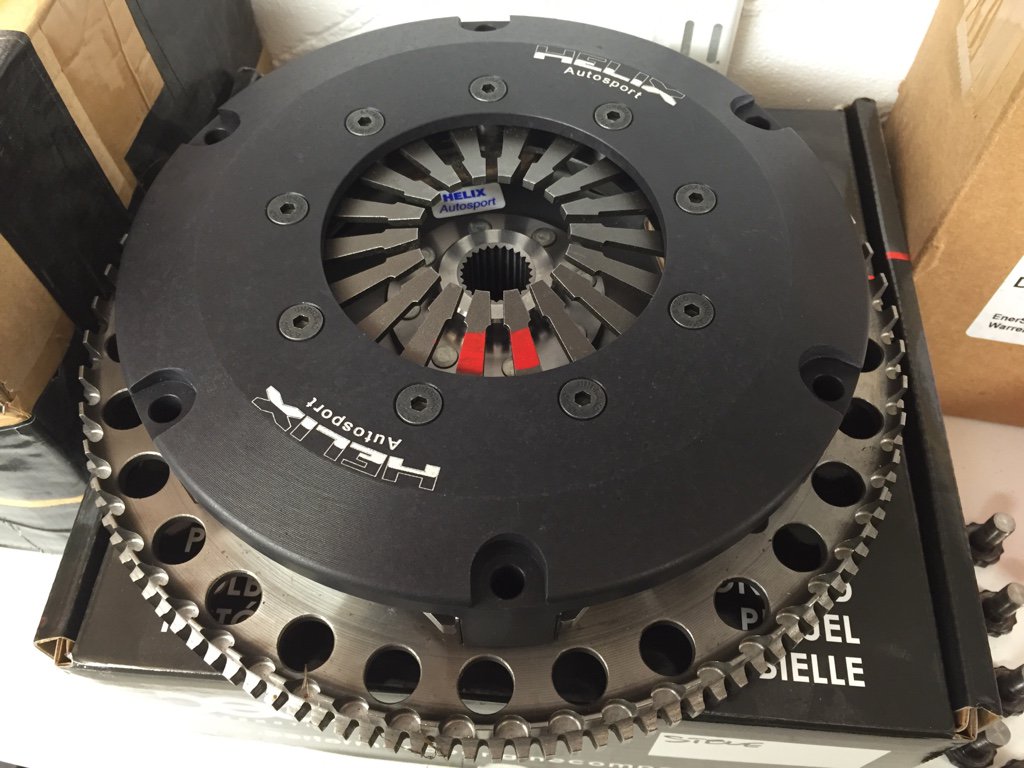

Dug this out this afternoon from my spares collection. Think after the clutch issue the other week it's time to get this in and hopefully eliminate any future clutch issues. So hopefully sometime before the Birkett will pull the engine and swap it over :smile:

What power and torque will it be running? I have a friend who got me the bits but I can get a price for you if you need? I think depending on your power level you would probably go 6 paddle and twin plate. What's the application? Rally, race, road?
  Clio 2 sport
we will drive on road (germany)
sought 300hp+
we do not know whether we have a F4R730 rebuild or the meg engine
gearbox ND0 or JC5 or ... are just accumulate information
