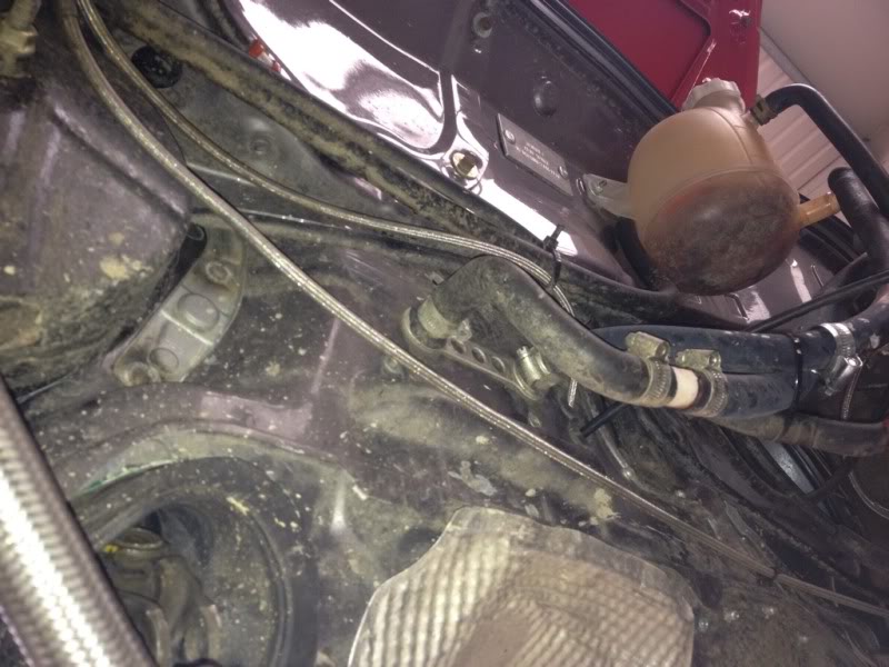

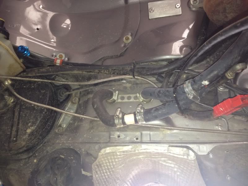

Apparently there is a 13mm connection in the forge hoses further down so going to tee into that as it's the same size as the inlet! Jay I will need coolant refill advice when I get to it pretty please ;)
will explain on bbm when your doing it

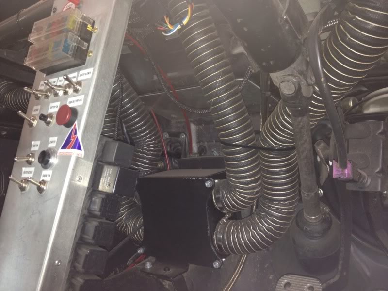

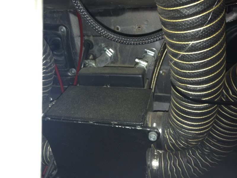

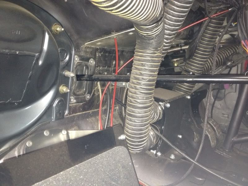

I fitted on of these on the bulkhead and ran the standard heater hoses up to it , mounted the heater inside so the heater pipes line up with the bulkhead pipes and just ran 2 small pipes to link it up
http://www.t7design.co.uk/index.php?main_page=product_info&cPath=69&products_id=183
Here is looking into the engine bay
And the heater box fitted in the car

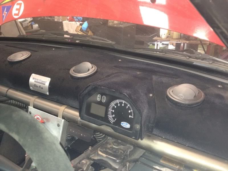

And the vents I cut into the dash top
You can buy pipe and different shape and size vents from the guy selling the heaters , I think it cost about £200 ish for everything I needed

I used the original water pipes (one of them I shortened and used a reducer elbow to drop the size of) to go to a bulkhead fitting that drops the size down and then from there Im just going to run some 13mm heater pipe to the heater itself.

My vents turn so you can aim them at specific area's , in Llandow it didn't mist up for me at all , it did for my son but he must have knocked the vent shut , that and he was doing a lot of heavy breathing trying to keep up with his old man lol
Yeah thats what I just thought actually I could do the same and then direct them to the side windows if needed :) Haha I can imagine he was ;)
