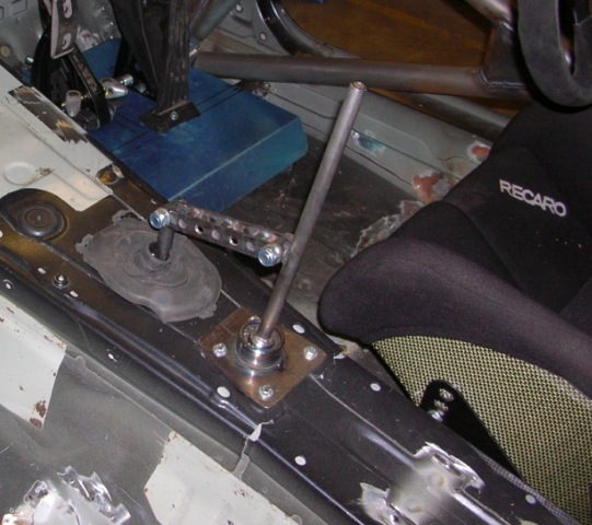

The last and in my opinion major thing to sort is the gear linkage. We put the stock linkage back in for Llandow but in the modified position, we did this to clarify the gearbox was okay after the clutch issue. Thankfully it was but this now leaves me with the linkage to sort out. With the linkage being relocated 18” further back in the car it has brought a lot of play in the gearstick side to side which means it is very difficult to tell between 1[SUP]st[/SUP], 3[SUP]rd[/SUP] and 5[SUP]th[/SUP]. I also now have the issue that when a shorter driver wants to drive the car it is impossible for them because the gearstick is behind them. Unfortunately the original place for the linkage is too far forwards for me to reach so I am trying to engineer a compromise. If anyone has any ideas then they would be appreciated :) I have thought of a solution as below but we are not sure if it will work.

I would just accept cutting out that tiny bit of crossmember under the car and hence allow you to sit the gearstick midway between where you have it now and where it started out, thats what I have done on my mk1 and it really isnt much metal you have to remove, would be easy to add an extra brace underneath or similar if this concerned you.

That gear linkage looks like it would work for all forward gears but how would you engage reverse?
Re: James/BigAsh 182 Race Car by TDF... It doesn't get much better than this! *Pic He

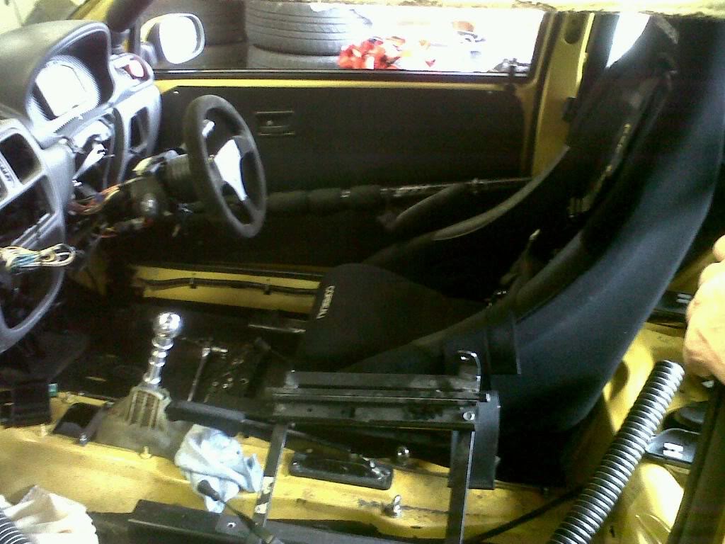

The gearstick on the Clios really is designed for short girls lol
Mines a stretch to get into all the gears and I'm still about 2-3" too far forward for my liking - but if I move the seat back I can't reach the gears
I'll be interested to see what you come up with :)

Thats exactly the problem I had with mine, where I wanted the seat to suit my legs, meant that the gear lever was then too far forward, especially for my mrs who is longer in the leg than the arm relatively speaking.
Yeah I will have a proper look when I get the car back :) I'm going to try refreshing the front end of the linkage and see if that gets rid of some of the slop. Thanks yeah I will probably do that!

I would have to run the same linkage *cage* as stock so would retain the same cable pull but would have to lean forward to get it I think.
