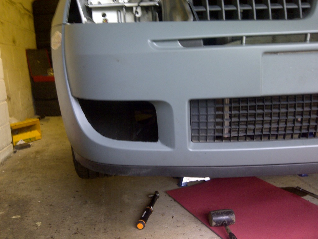

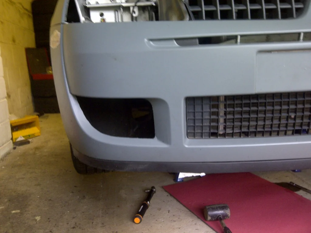

Not much to update really, My garage has leaked water while we have had the heavy rain which has somehow got into the electrics so I have spent the last few nights and today re-wiring the whole garage! Waiting to hear back from Nitron on Monday to know what is happening with that! Got all my hopes pinned on them really as AST never got back to me the couple of times I spoke with them when they said they would call me back which is a shame! Getting a bit tight for time really so hopefully get sorted soon.
Been working through a few other jobs on the car, got rid of some of the slop in the gear linkage by replacing some of the parts. Realised that the pin between the linkage and the gearbox was a short shift one so that could have been what was causing the crunching, it was naff quality and was causing quite a lot of play so that has been replaced by OEM. Since the linkage has been moved back in the car it has never self centred properly and this along with the play meant I sometimes got 1st or 5th instead of 3rd which is pretty risky if I don't realise before pulling the clutch up. I have also struggled with the linkage been too far back in the car so I have rotated the gearstick 180 degree's and it now sit's in a much better position and now bounces back into neutral so along with less play should be a workable solution for the rest of the season until I can relocate it further forward in the car :)
I have cut out the foglight surrounds to get more airflow to the brakes and got a set of aerocatches to fit to the bumper. Got some spare 182 stub axles so will refit the correct ones tomorrow. Then the car is just going to sit on axle stands until some new suspension turns up. I will update once I know what is happening with the suspension as that will affect the plans for the next month or so with the car!
I will get some photo's tomorrow when i'm working on the car to show the bit's and bob's I have been doing :)

Have you just cut the whole fog light area out?
I'm planning on doing that with mine this week because I can't be bothered trying to find cup racer air ducts lol
Yeah I have done for now mate :) I think it looks good although I'm slightly worried as to how much stuff could find it's way in and towards the belt's. I think I might get the fibreglass out and start making a cover to go around the rad and stop anything from getting into the belts :)
