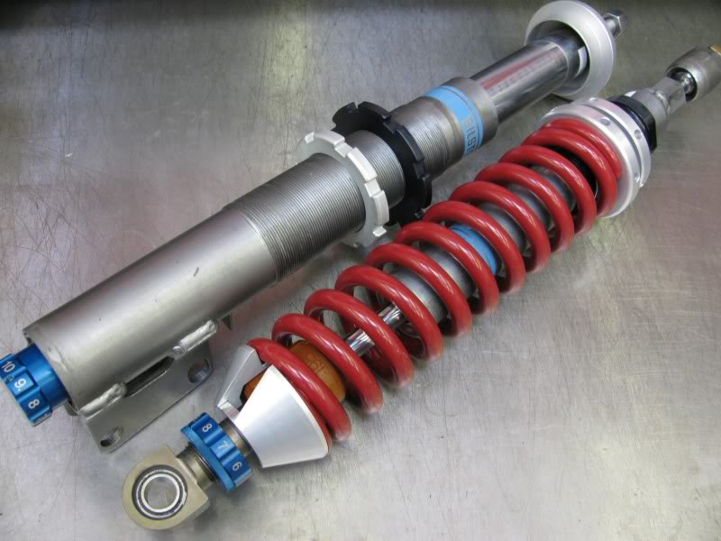

The first issue is that while the KW suspension is very good it just isn’t racecar suspension and doesn’t have the scope to be made into such. The spring rates were very soft, the valving not suitable, the adjustment been very limited and it seemingly didn’t take well to the continued abuse. The failure seems to have been caused by the damping adjuster going over it’s limit and breaking down which explains why when we put the stiffer springs on that I still thought it was softer. This led to the damper bottoming out and subsequently led to the failure of the bearing. They have been replaced by KW and will be up for sale once I receive them back.

Over the last month or so I have been investigating various suspension options. The AST’s are the only real off the shelf option available which I found hard to believe. I spent a long time researching and kept coming back to the fact that people found AST customer services far from ideal so I discounted that option and went in search of something else. One of the manufatures I contacted was Nitron who were already in development with the Clio so this seemed like a great option we made good progress and I was going to be supplied with a kit but unfortunately this didn’t work out and frankly they were messing me around and i've had enough of that with this car so it was back to the drawing board. I then heard that AST had issued a new distributer for the Renault sport products with an aim to improve the customer services. Cooksport are now the excusive retailer for the AST’s and I have been dealing with Josh for a couple of weeks. The first time I spoke with him I explained the situation and that I needed to get sorted soon and didn’t want to have a faff trying to get sorted. He was really helpful and got straight onto AST Holland and said I could have some week commencing 13[SUP]th[/SUP] August. He didn’t rush me into anything and gave me time to think so I went and explored some more options. I spoke with Fred who has been very kind to me and he offered me a possible solution. I also got in touch with Dan@519 to see if he could offer a solution and he kindly got in touch with Spax. It was very kind of them both to go out of their way to try and help me and I really appreciate their help. In the end I have decided that the quickest solution and also a proven one is to go with the AST’s. I got a phone call today from Josh to say that AST Holland can ship them directly to me and they have now valved them to suit along with the springs and could be with me next week so this afternoon I went ahead and ordered them :)
It seems I can finally get the car back on track and see how it works with the new suspension. It’s a shame that I spent so much time and money trying to get somewhere with the KW’s but I have learnt from that raft of mistakes and won’t do it again as it will take a long time for my wallet to forget them!

Nothing is ever straight forward, it is pretty bizarre that the AST's are the only off the shelf option!
Jonny the only option for the mk2 is the B14s which I'd put in the same category as the KWs if not worse due to the lack of adjustable damping. They're good, but they're not race suspension. Anything that's remotely usable on the road is a compromise, FACT
Glad you've gone down the AST route, you know they're proven so aside from the customer service aspect which will be sorted soon enough, they are a safe and quick bet! ;) What ones did you go for?
Also regarding the full nut/bolt refresh, is it really worth it? Surely just spanner checking/torquing all the bolts would show the weak parts, on top of that isn't the things like bearings and moveable parts that's been the weak point?
The cup racer ones I mean ;)
Hassle of finding parts and modifying them to make it all fit, plus John at R-Sports words... 'The cup racer suspension is rubbish, after all it was just a generic/control suspension used so it wasn't ment to be good stuff. Just stuff that works and sets an even playing field'
He did say if you were to go for anything, go for the Clio GroupN Tarmac rally car suspension. Fully adjustable, though the price would make you wince!

I can imagine Nick. Much more options for setup and most likely stronger.
Have to agree with Nick on the re-bolt James, seems a little ott.
Which AST setup we talking by the way? Sportline 2 I assume if you're not thinking three way

I'll edit it for BIGASH as he missed a bit, if he doesn't like the AST's then he's having these bad boys :D

the lower strut tubes are interchangable, cost is the price of a 2nd hand 182 LOL
