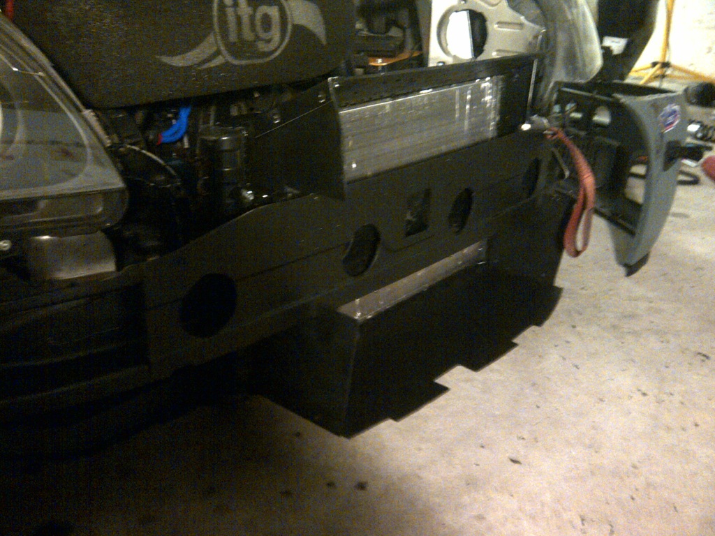

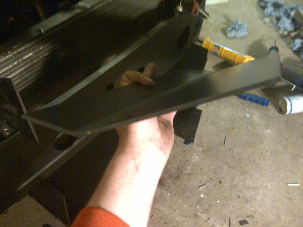

  • Coolant temps had been at over 130 degree’s for most of the race
    • I checked the readings on the sensor and all was okay, an issue with the ECU meant I couldn’t check the peak readings. Took the car for a compression test and dyno at RS-Tuning where all was as expected and no damage had been done
      • Shrouding was made to go around the radiator and divert all the air into the rad, holes were also drilled into the bumper and crossmemeber just to aid airflow

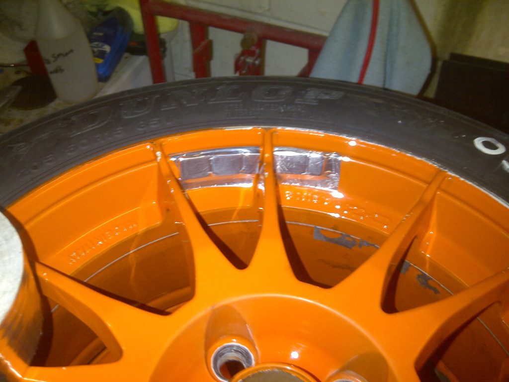

  • Wheel vibration
    • Couldn’t fully balance wheels due to clearance with Alcon’s
      • Balance on the outside edge of wheel and secure with aluminum tape.

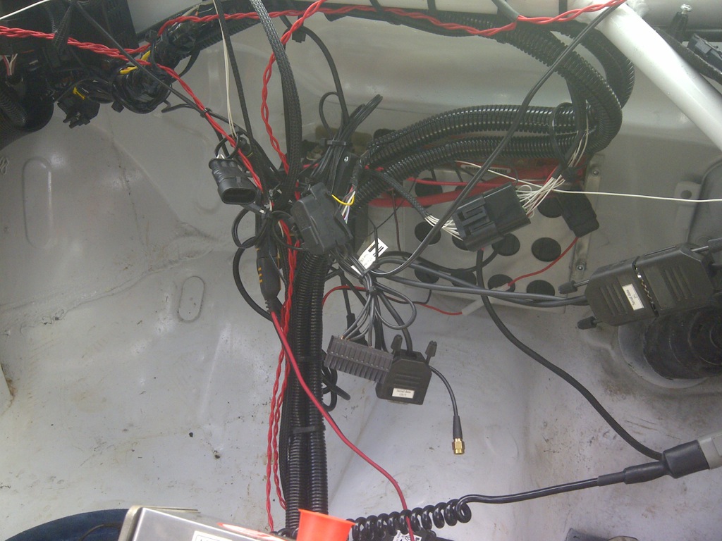

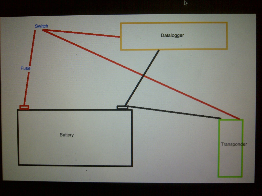

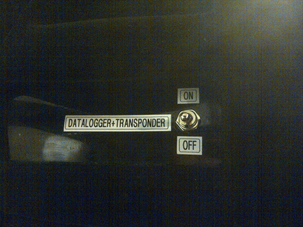

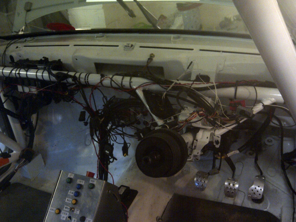

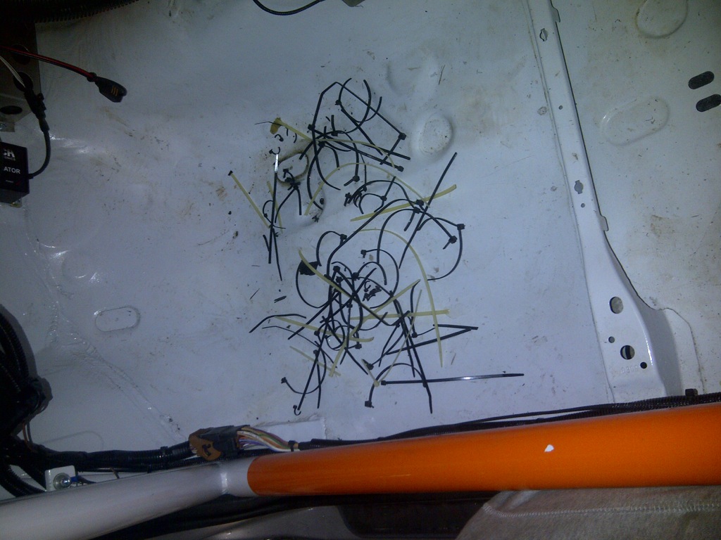

  • Transponder draining battery when engine not running and datalogger turning off in pitstop so no speedo
    • Hardwire both to battery and then fit separate switch

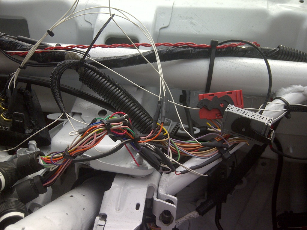

My childish wiring diagram ;)
While under the dashboard I was faced with this mess!!
Then tried to tidy it up a little

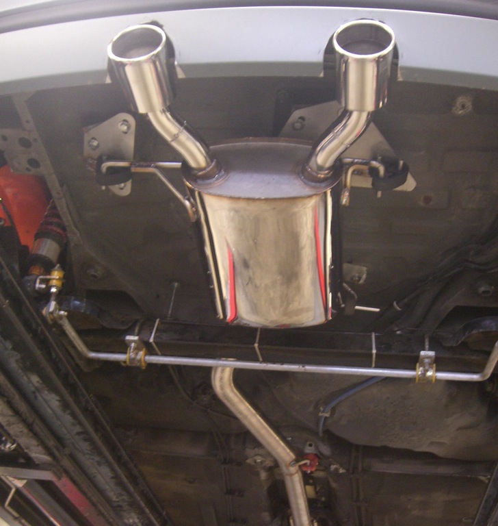

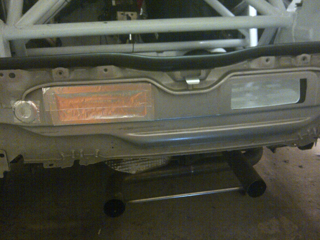

Exhaust time:
After the Teeside day I was taking the car home to prep it ready for the following few days on track. This involved a quick spanner over everything as I was having so much fun at Teeside I gave it quite a beating! All was okay apart from a tiny bit of weeping still from the PAS but not much I could do about that now.
I removed the old exhaust ready for the new one to be fitted.
I arrived at JP exhausts to drop the car off and the plan was to collect it on the way to Oulton on Friday morning for testing. I met Will at JP who talked me through the exhaust and how they were going to run the system you could tell his passion for the job and he showed me a few of the other cars he had just been doing, the work was simply stunning! The exhaust for mine was the new BTM system that they make which is normally run with a small mid silencer but I asked for this to be removed. My old system didn’t run a middle mount and drooped down quite a lot so used to catch on the trailer.
I went back to collect the car on the Friday morning and was shown round the exhaust by Will on the ramp the quality of the work was astounding! He had got the system nicely up under the car so it wouldn’t catch on the trailer, he had refitted my mid mount and also fitted the exhaust with the two bespoke rear mounts which remove the standard crap Renault mounts from the equation. The whole exhaust is TIG welded and is just a work of art! The sound is out of the world too so was a great start to the trip :)

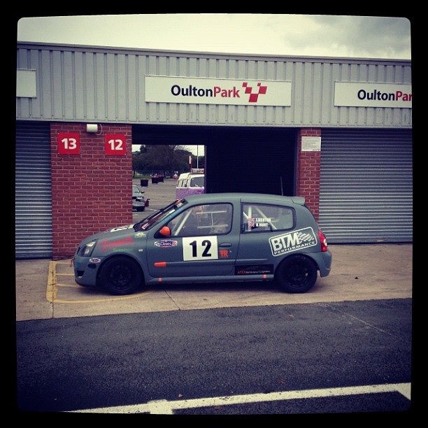

Oulton Park CSCC Race Day
The race morning started off wet but I thought it had dried up for our session so I sent Howard out to qualify first on the dunlops. I should of looked over the pitwall and seen the damp line as it was 888’s territory not the dunlops. He went out and did some very sideways laps and came in to report the car just had no grip. I wanted to change the tyres but we were going to loose too much time. I proceeded to get in the car but then saw the safety car had been sent out so I shouted to swap the tyres which we did fairly quickly and got me down to the bottom of the pits for the session going green again.
The tyres were stone cold and there was lots of traffic so was just taking it easy to get some heat in ready for pushing at the end. Little did I know that we were near the end of the session. I started to push coming upto druids to get ready for a quick lap and got passed Lisa and Toby in the Puma but as I came to the start/finish line the chequred flag was out. I was gutted as I hadn’t got a proper lap in and thought we would be near the bottom of the times. Luckily we had still managed to get 7[SUP]th[/SUP] position which I was very happy with.
[video=youtube_share;lr22ytnwalE]http://youtu.be/lr22ytnwalE[/video]
The car was then checked over ready for the race and the Dunlops bolted back on seen as how the circuit was now drying up quickly.
I was going to start the race as I had set the fastest time in quali but I knew what with my rubbish starts it would be tricky to keep position. There were also plenty of quick cars behind. Sat in the waiting area I was chatting with Jay and Mike who both tried to calm me down so thanks guys :) I was getting reall nervous but once on the warm up lap all was okay!

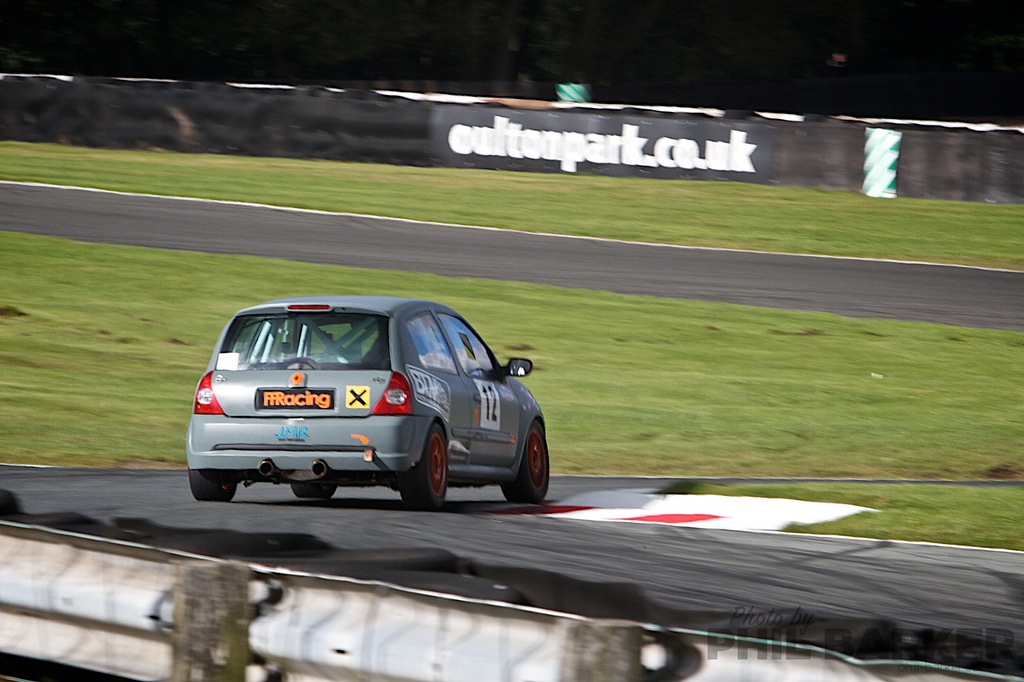

I lined up on my grid slot and looked around at the competitors around me. Jay had already warned me he would be past me by the first corner and sure enough he was! I had made a poor start but not as bad as some of my previous ones lol. Going into the first corner the back end swung right round and luckily I managed correct it with a little help by the hit of a puma! Coming into cascades the saxo which I knew was quick left a Clio with Alcon sized gap so I obliged and then settled down for the next few laps and regained a few positions that I had lost at the start.
Unfortunately the video broke after me flying the car over the kerbs and the rear cam was full by the end of the outlap!
I stayed out for most of the open pit window and then did my stop. I totally f**ked up with undoing the belts, then didn’t turn the car off properly so when Howard got in he couldn’t restart it. Finally we got the car started and he was off. We dropped back a bit due to the poor stop but I have to take full blame for it as we should of practiced it. Howard was seemingly struggling still to push which I don’t blame him for as with the sticky 205 dunlops and no PAS the car was pretty horrid to drive on the limit. Near the end of the race he had obviously started to get comfortable and the times started to drop which held off Lisa and Toby in the Puma so I was really happy that we got comparable lap times and we finished the race in 11[SUP]th[/SUP].
[video=youtube_share;GieVfS-Ig8M]http://youtu.be/GieVfS-Ig8M[/video]
The quickest race laptime was over a second slower than testing and that was with the dunlops but that was due to the lack of powersteering I think.
Looking at the data after the race I was doing well round the whole circuit apart from the entry to druids where Howard was 15mph quicker than me so if you combine are sectors together even without the PAS we were well under the 2 minuite lap times which bodes well looking to next season.
