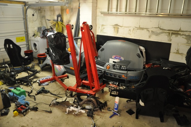

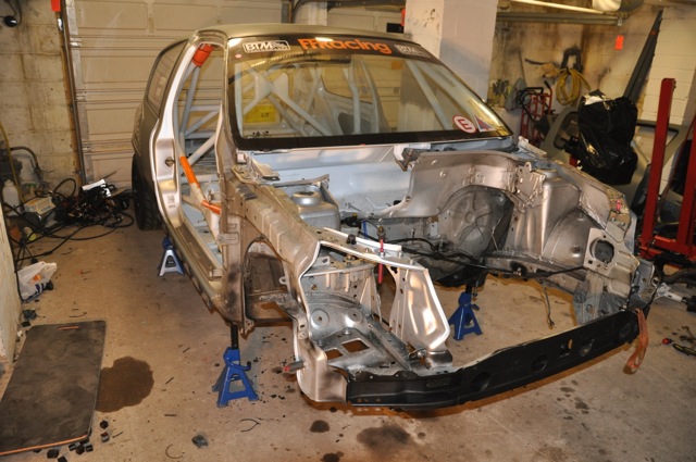

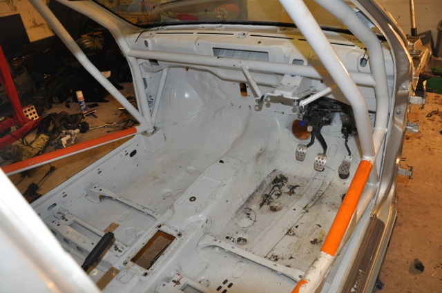

Car is now in bits

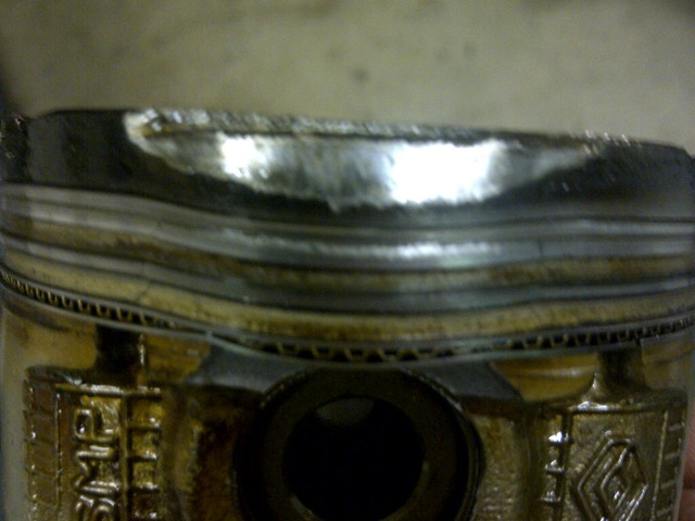

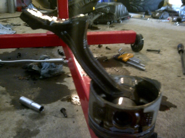

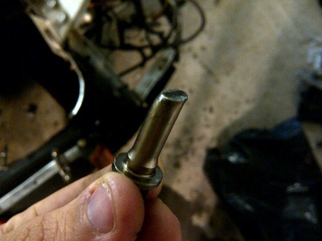

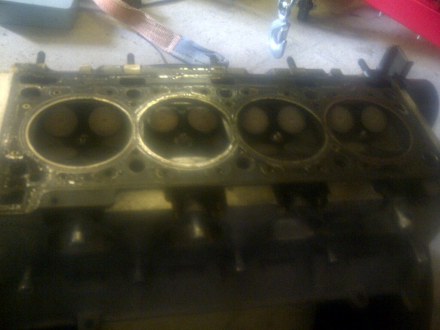

I managed to get the rest of the engine apart and have now found the complete ARP that had come out of the knackered rod and the one that has sheared in two from the other side of that rod. The piston has then obviously gone upto the top of the bore and smacked the head as the piston has crumpled and the valves on that cylinder are bent.

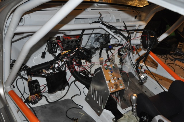

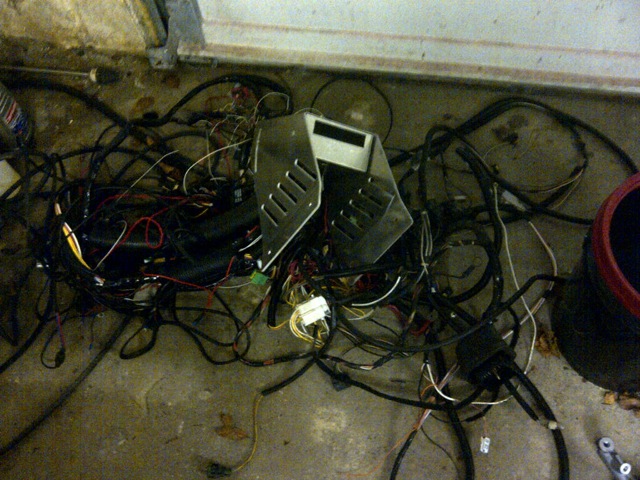

The next job was to get the wiring loom out, unfortunately it has obviously been wired up in the car so connections have been made around the cage and it was then impossible to get it out without cutting it. The loom will be re-done for next season as this really isn't what I was expecting from spending in excess of 3k on wiring.
I have taken nearly everything off the car now. Little details like the battery was bolted to the bulkhead but you couldn't get to the nuts without taking the engine out are obviously not good if a battery fails in a race weekend so loads of little jobs like this will be done properly when it all goes back together. Some parts will be going for powder coating and the engine bay/underside of the car will be getting sprayed so it is much easier to wipe down and check for leaks instead of the current finish.
I need to find someone local who can weld to a decent standard as the seat rails and gear linkage position need moving along with some changes to the suspension mountings.
I will be then respraying the inside of the car before re-assembling everything, the Clio DCI PAS will be then getting fitted and I will be modifying the pedal box due to a few issues I have had with it this year. It really is just going to be a winter of small modifications just learning from the past year.

Whats the length of that arp compared tot he other half of a cap?
That should tell you if it just snapped, or wound out first.

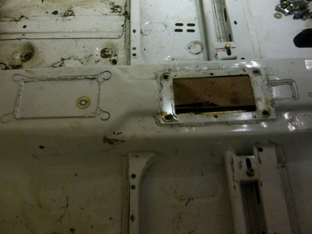

Does anyone one know which pins on the fuel pump are + and - as there are 4 and I don't want to put 12v through the sensor for obvious reasons
I need to drain the tank as it's nearly full and need to then drop the tank before rolling the car to work on the underside
Thanks
I drained my tank before dropping. I was worried it would distort as I undid the bolts as it had so much fuel in it.
Couldn't get a pipe in there due to the anti siphon stuff had to remove the bottom hose hold the flap open with a screw driver with a bucket underneath it lol.
I was covered in fuel by the end of it.
  182cup & 172 racecar
If you dont want to syphon it, take the pump out and use one of those pipes with a valve in from Halfords, just shake it up and down to start it off.
That is a good point actually Mark! Mmm where is there a bottom pipe?
Somebody :headno: decided to weld a roll cage over it so it can't be removed without dropping the tank lol!
PMSL!!!! What's in the way? bars or flat plates?
The main hoop is further back in my car and the straight bar that runs along the rear squab area is directly above the fuel pump area, I could probably break the pump and then get it round but dont fancy doing that lol! I will just go and try with some bits of wire and a battery on the connector :)
